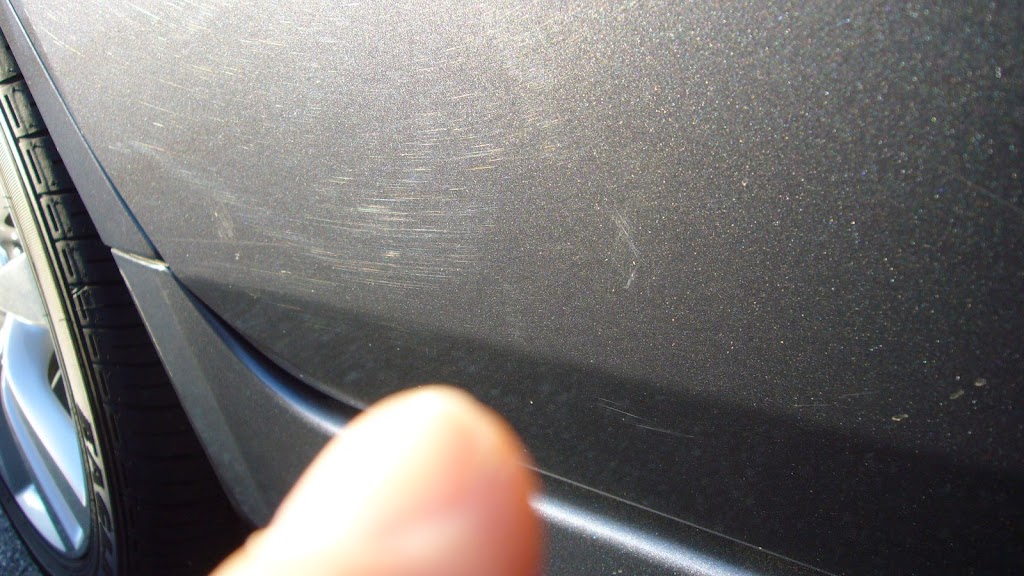

    Fortunately, all the of the swirls on the paint seem minor and are smooth to the touch barring the bumper. I can feel the swirls there.
    Bumper Shots:

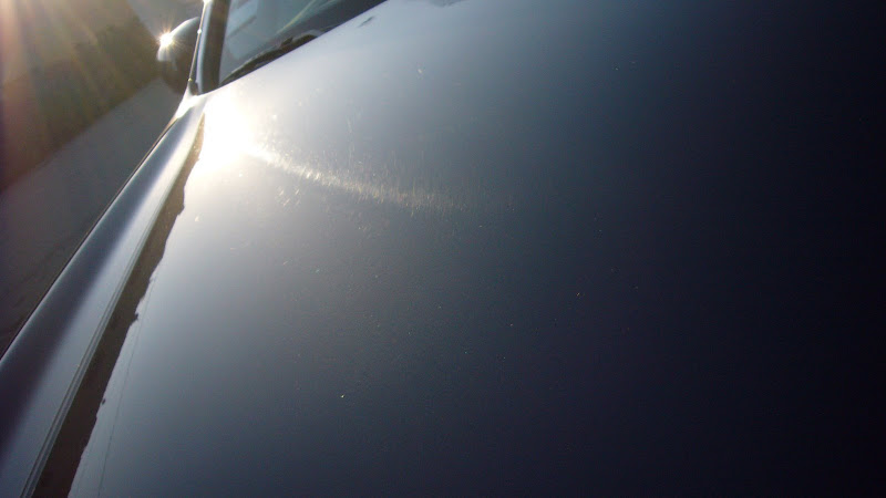

    Hood:

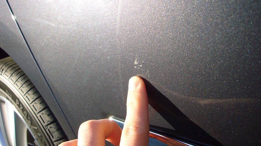

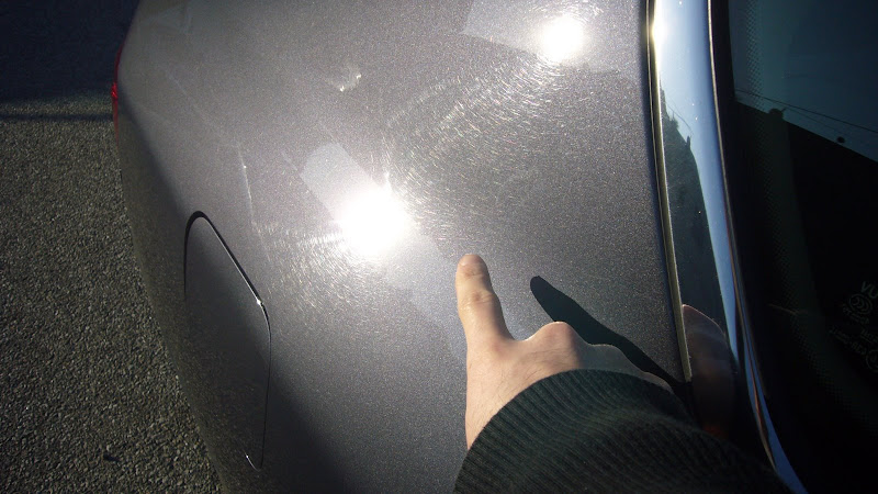

    Rear Right Panels:
    I believe this scratch below can be taken off easily with the M205. The clear coat is not depressed and it feels I can flake it off with my finger nails.
    Some more minor scratches below

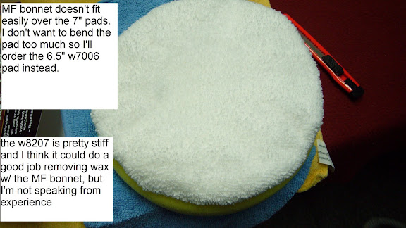

                  Originally posted by humblepie View Post
                  It appears the M105 never got added to the order (late change request) so I'll have to separately purchase a cutting pad w7207 w/ the M105 at a later time.
                  I read that w7207 isn't recommended with a DA polisher due to hazing so I will just use it for the MF Bonnets instead.

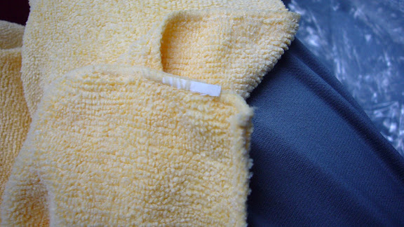

                    If you're on the web album you can really zoom into the picture see the texture of each MF product. I couldn't tell the difference b/t the supreme shine and the cheap MF towel from ADS. If i order more I'll definitely go w/ the cheaper ones.
                    I made sure to remove every last bit of the tag
                        On a side note, it's too bad I can't edit my post #3 and 4 now. Oh well, I'll just recompile my findings in a separate post after I'm all done. I hate having to dig through multiple pages for a worklog.
                        If you want to use the M105 with the DA then use it with a yellow polishing pad, either the W-8006 or the W8207 polishing pads. Meguiar's doesn't actually recommend using any of our paint cleaners or compounds with microfiber bonnets, bonnets are usually used for removing wax.
                          Sorry I was being vague. What I meant to append was "... use it for the MF Bonnets instead (to remove wax)"
