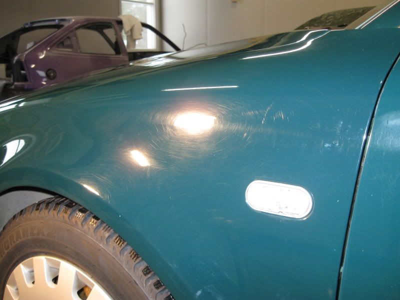

                              • #30
                                Re: M105 with a DA. Why not?
                                before:
                                50/50 fender done, door waiting:
                                another 50/50
                                final result: 1 coat gold class, 2 coat chemical guys butter wet wax, plastics trim detailer and tyres hyper dressing
