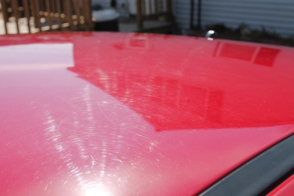

    Okay, so I recently had my car repainted after an auto collision. Long story short, he painted it well enough (mirror needs to be repainted, the rest appears fine) and he told me he would bring it back to a good shine. He said he would remove all the swirl marks and make it look brand new again. I believed him, and waited anxiously. The day before I brought it home I saw it under some fluorescent lights, and had a sinking suspicion that he had used a glaze on the finish and I think I was right. Here are what it looks like after 3 weeks waiting for the paint to full cure. I believe the shop to have used a wool buffing pad, and tons glaze.
    This vehicle is a 2006 Mitsubishi Eclipse. The only paint correction done is applying Ultimate Compound by hand, half-heatedly last summer, and then the shop beating the paint with a wool pad.
    All of the spots are water marks from the spray down I did an hour before I took the photos. Pay attention to scratches/swirl marks. The above are just two of the many photographs I took. As you can see, the damage is pretty bad. There are deep semi-deep scratches in the paint in several areas. Mostly on the hood, and one on the rear hatch. They offered to fix this for me, but I think I will walk away and do it myself, the correct way.

    Well first of all wool pad is not made for DA, so forget it.
    Second if fillers could hide that i guess m105 and a polishing pad on the da will work to remove that.
    And third those scratches you will need to sand wool or mf sustem them in order to dissapear, but dont trust me ask a pro here like mario or michael.

        This is an easy fix. You need to get the MF System. that will take out 90% of those scratches with ease.
        Foam pads won't fix this, well a little but not enough. You can try but I'm thinking you won't be happy. And Ultimate Compound is a "light" compound. It's derived from M105 and it's very aggressive.

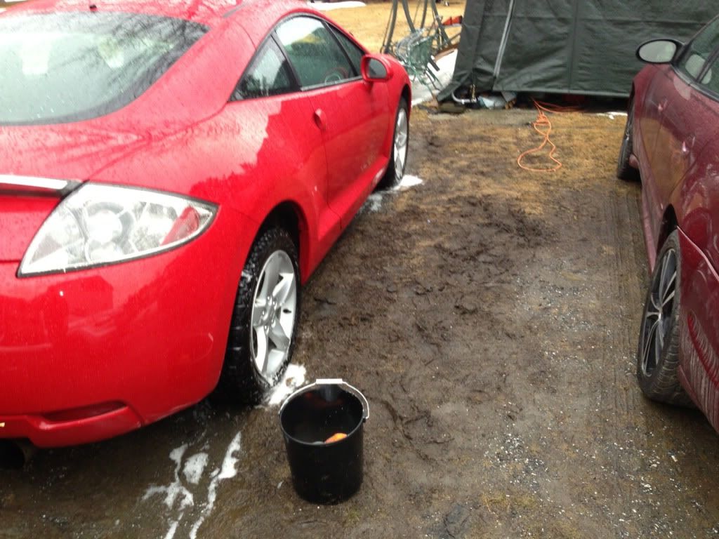

                        Okay, so here is the update.
                        I decided I had a decent window of time to get the process started.
                        I was able to wash the car, and get UC on the car and apply a coat of the Ez Creme glaze before I got rained out.
                        So, I washed it with dawn dish soap, then with Turtle Ice to make sure it was clean enough. I did not do the wheels, which I should have, but I can wash those tomorrow morning.
                        I put a clay bar to the paint, which was still in great shape, as it went over smooth as glass from the last time I did the clay bar.
                        Now to the actual event. I took the yellow pad and the UC and went over the entire car on speed 5. I didn't use any prep stuff, I just rubbed some UC on the pad to moisten it up. I placed about 3 dime size amounts for each panel. I did the hood in 2 parts, the roof in 2 parts, then each quarter panel and each door as a separate panel. I did 3 passes each way, up and down, then side to side.
                        I was not able to remove every single scratch and swirl mark, but it got almost all of them out. I am very satisfied with the results based on the effort, and a comparison of doing it by hand last year. I must say the results are night and day between hand application and machine.
                        It took the car from a dull sheen to a vibrant shine. You can still see some swirls and some scratches here and there, but for the most part the abundance of swirls is gone. You would have to get very close to see them on the car.
                        I think if I were to have used the Microfiber system instead, I am sure it would have taken them all out. In any event, I really have no complaints for the 2.5 hours it took to run the buffer over the car. I am sure if I would have allowed myself more time, and used more pressure and passes I could have removed nearly all of them, but my main concern was taken care of. Granted, I did the check with a halogen work light at night time, I am sure the results will be the same.

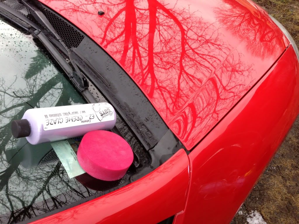

                        On to the glaze.
                        The Ez Creme glaze is pretty good stuff, I find it well worth the price. At almost $1 an ounce, I think it is well worth it.
                        Went on easy, even through the sprinkling rain. I was able to get a light coat on and wipe it off through the rain drops before I had to stop. Wipe is the key word, there is no buffing involved, it really just wipes off.
                        I went outside an hour later to pick up my cords and bucket, and the beading from the Glaze alone was fantastic. I was surprised.

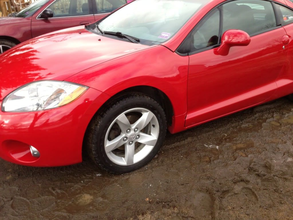

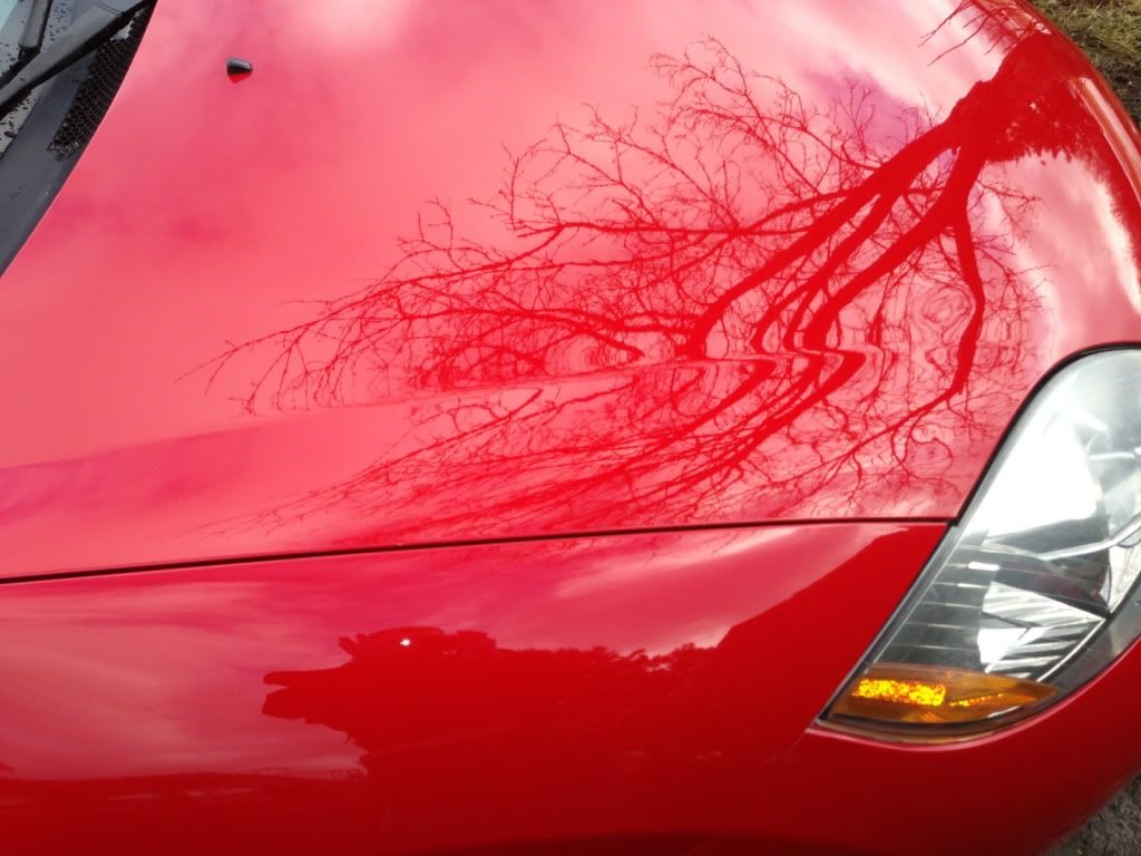

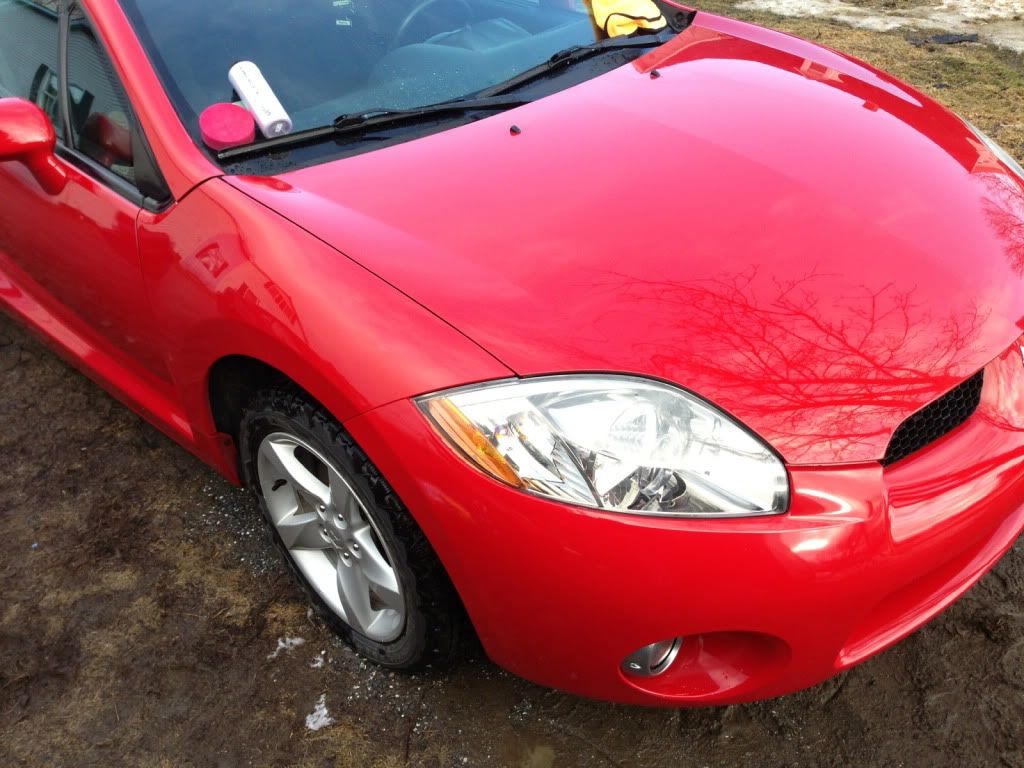

                            Here are the photos: More to come shortly as I am still doing the detail.
                            This is the beading from the EX-Glaze alone. No other product was applied.
                            Washing the tires, since I forgot to do it first thing. Ha.
                            Second coat of EZ-Glaze
                            Ez-Glaze wiped off.
                            Application 1 of JetSeal
                            Wipe off of JetSeal (Application 1)
                            Next will be application of wax, after last application of JetSeal, and the final buff off of wax.
                            Additional products used were ArmourAll Wheel Protectant, and Meguiars Endurance Tire Spray (I like the gel FAR better then the spray)
                            I plan to get the black trip after the last application of JetSeal with Mothers Back to Black.

                              The conditions you're detailing in (muddy ground) aren't ideal. Do you have nowhere else to do it?
