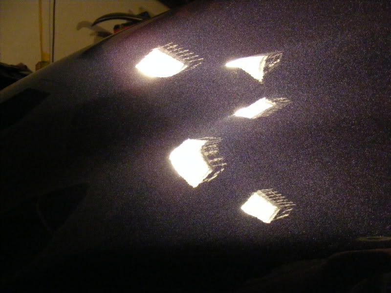

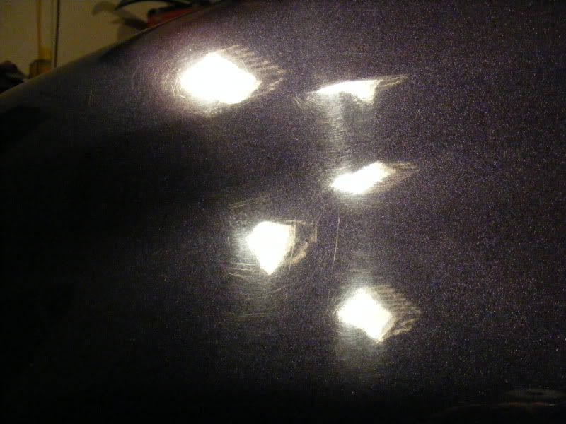

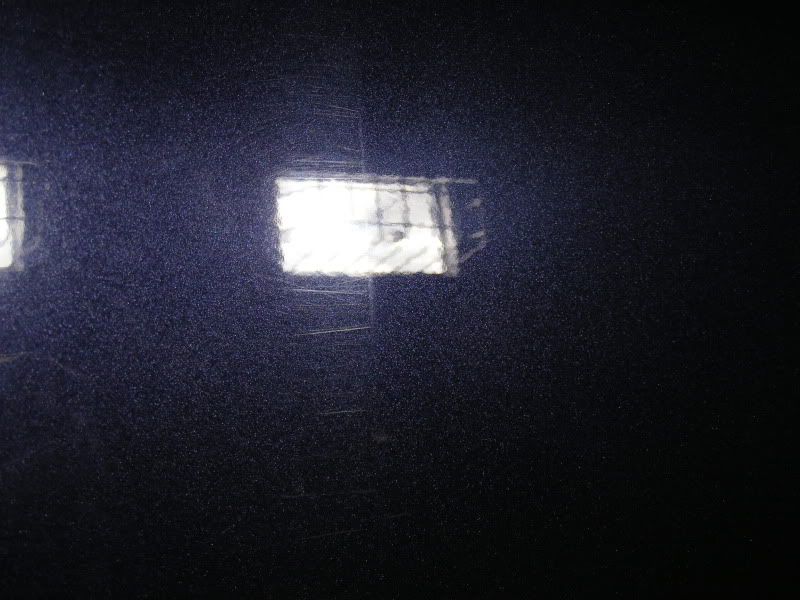

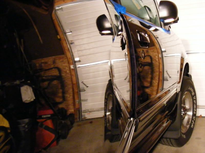

    I do have to say that the DA MF is amazing. No MOL post is complete without pics, so of course, I went from this:
    to this:
    And this:
    to this:
    50/50
    The stuff is amazing!
