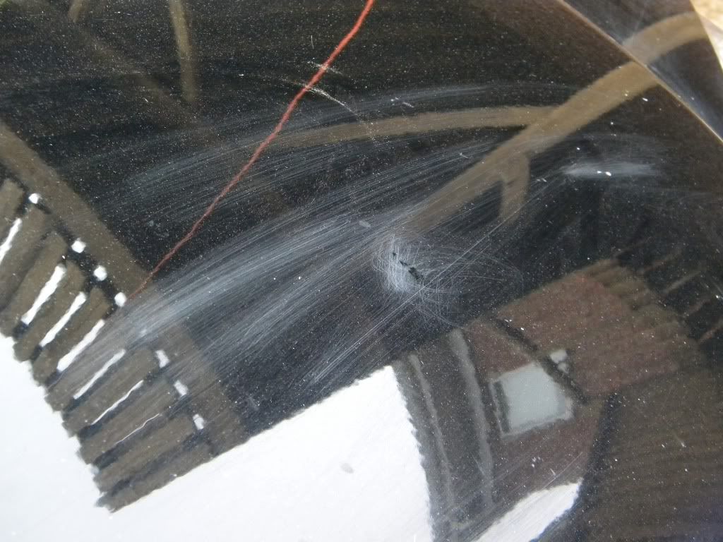

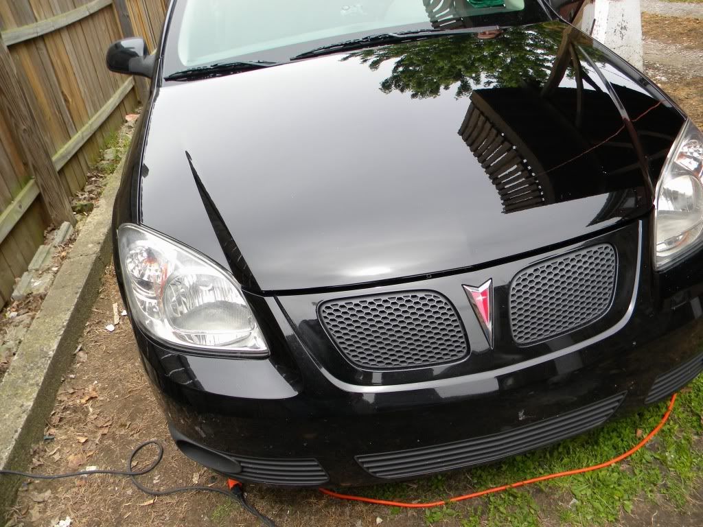

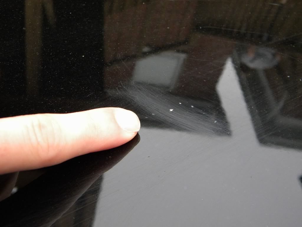

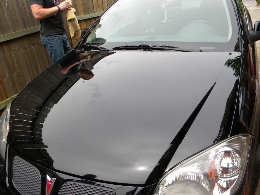

    i only corrected the hood on this detail.
    this car belongs to a woman my wife works with and she asked if i could fix some "scratches". she told me and i quote, "i washed it with something under the sink". so i have a pretty good idea of what was used. after seeing the results she now wants the whole car detailed.
    this was a 30-45 min job, i used trusty M105 on w4000 pad with rotary, followed by M205 with W8207 Polishing pad.
    the deeper scratches needed to be wetsanded but that is yet something i have practiced, so the deeper scratches left by finger pressure are less visible but still present
