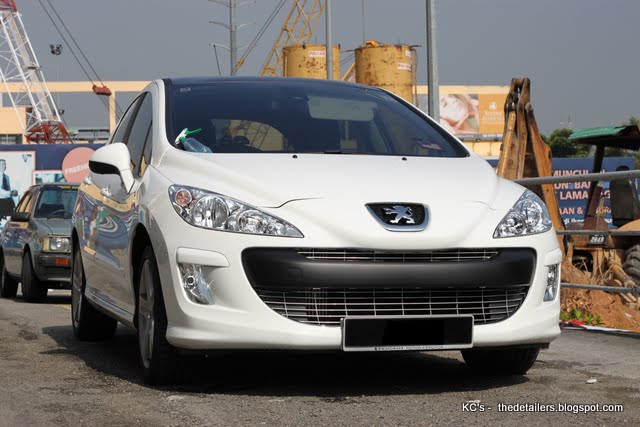

how to keep the white car white?
Malaysia is known for its tropical climate - plenty of heat & plenty of rain & plenty of acid rain = TA DA -------most severe acid rain
in the world

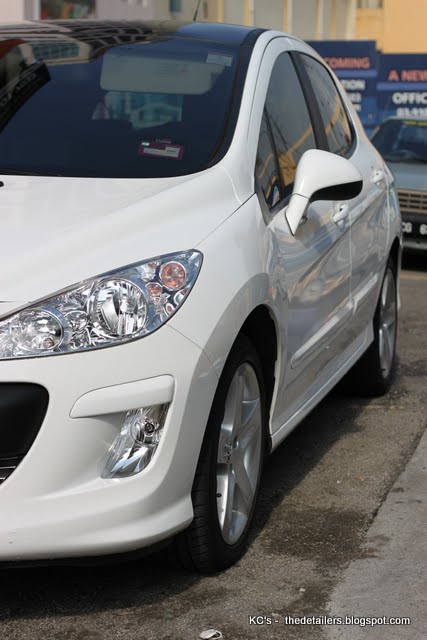

how to keep the white car white it is too much a challenge to keep our ride clean & looking cool....not easy & quite hard to achieve it...ended up....we let other help us to do it.... for we know the best that we can ever do for our car is to take ownership of it......
good looking ride - just slightly 2 months old
my buddy actually calls ask me to help him to preps & protect this new investment
great looking ! clean ! detail??? especially under bright sun light - nothing will hide - so much so if you are trying to find swirls on a white car under the sun will eventually blind your sight...for those of you had -
i remember i did an E60 white & shot some pic under the sun, just before i sleep my eyes blink blink - comes watery - too much sun light entered into my retina - be careful !!! use proper shade or old negative to cut the glare of your camera view finder & proper sun glasses
cant complaint much!!

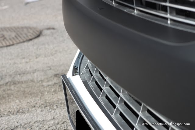

ehhhh....dirty car....any underlying issue?? will soon check it out...on the plastic bumper
unwashed wheels & brake dust

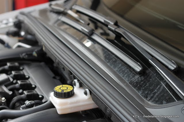

the heart of the ride
the inductor

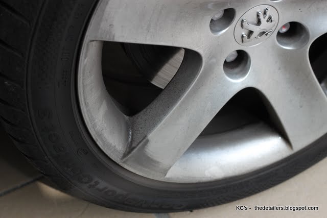

unwashed wheels
close up

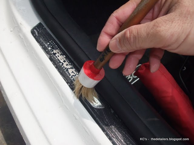

washing begins with OPC - 1:5 part dilutions & wheel brushes for hard to reach area
useful esp - wheels area

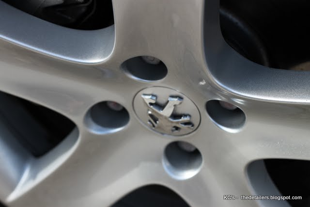

now the wheels cleaning begins
before
closer
tada

door jams area
opc work great for removing grease stains

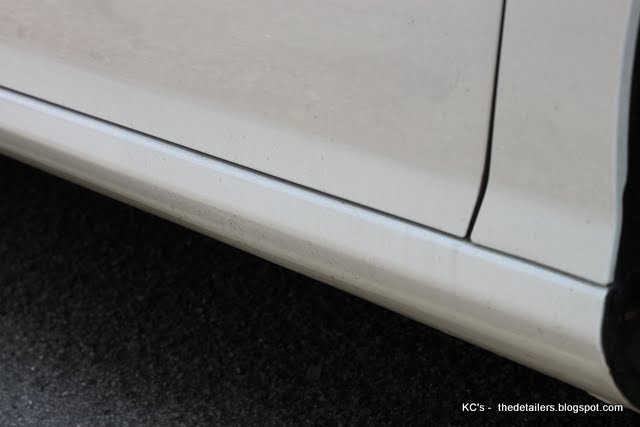

side skirt before
after wash - close up

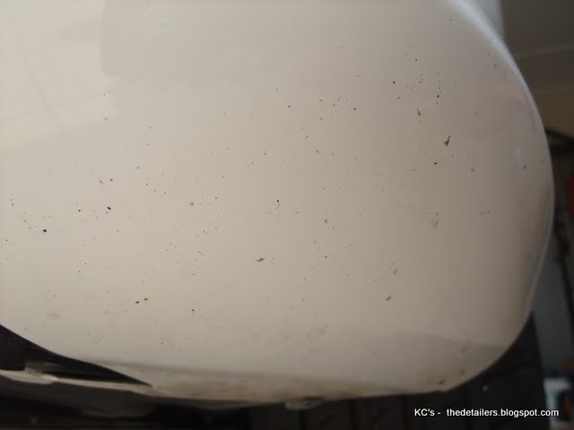

more - tars stains - tiny little splints like in our skins- can be quite an irritant
some found at the front bumper
rear lower bumper on the white car

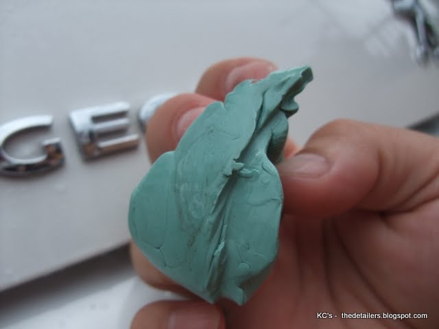

and i actually took 2 hours to clay them off
eg

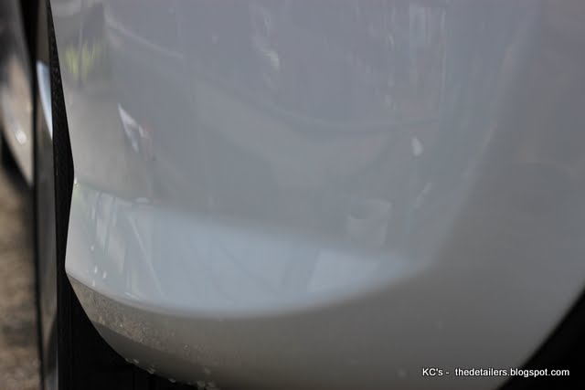

tars spots on the left wheel arch area
clay on
gone off

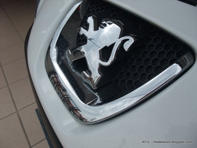

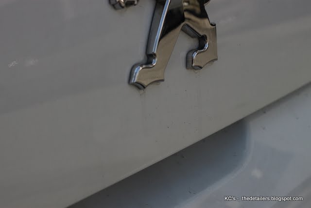

stains found on the emblem
imagine is just a 2 months old ride
lets clay them off
ta da

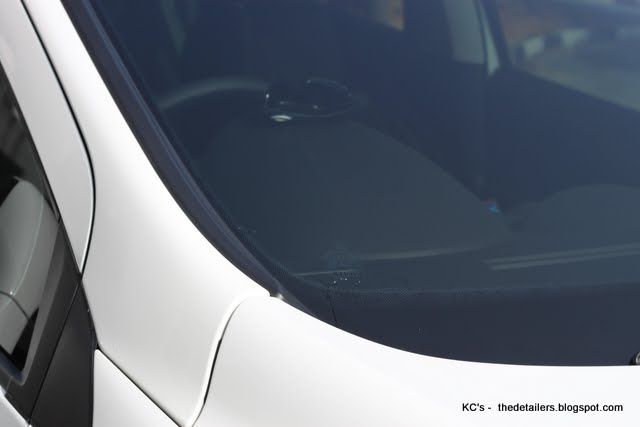

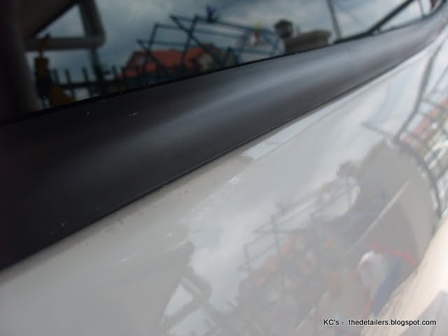

more hidden stain beneath the rear windows
lets do the clay

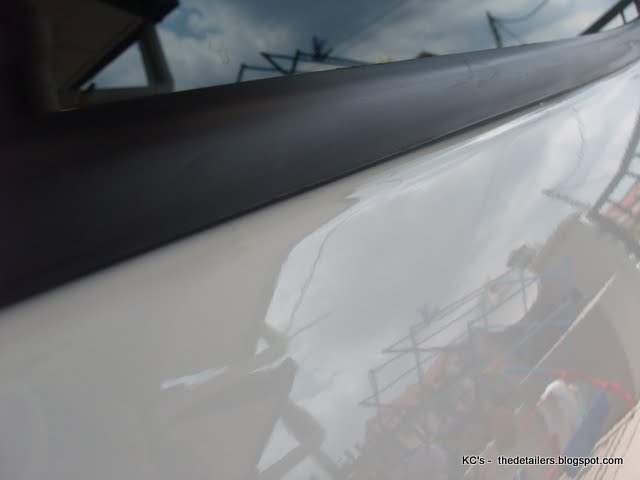

side window water stains
after clayed
needn't to use force - as some road side car wash would use aggressive acidic cleaners & scrubs with force

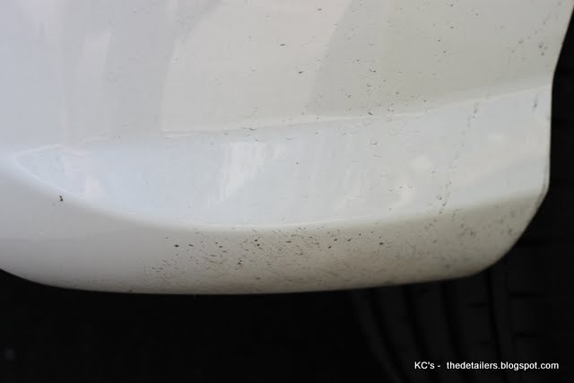

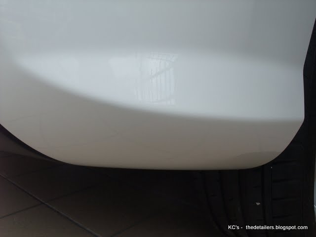

tars stain beneath the rear bumper
ta da

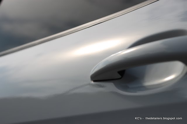

paint condition - side door area
hood
orange peel

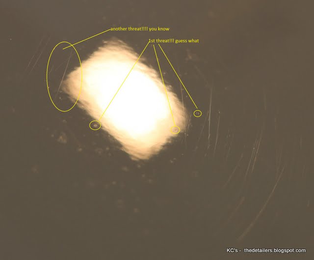

what we miss under the bright sun light
the real issue is :-
closer
I have never seen anything in this velocity - only managed to be picked up by extreme close up (with the help of prime lenses)
5 hours just gone & for the next 20 hours (over the spans on 2 days) - major paint correction work being carried with great care & meticulously detail before opti coating it for good

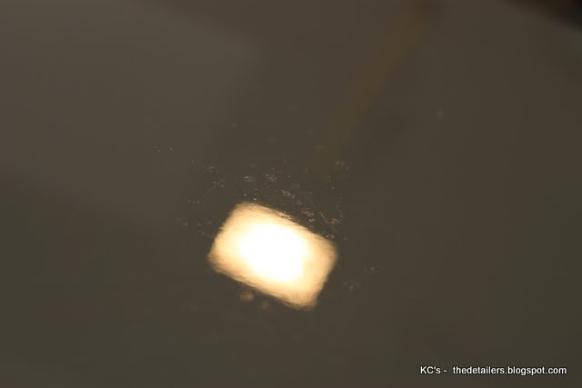

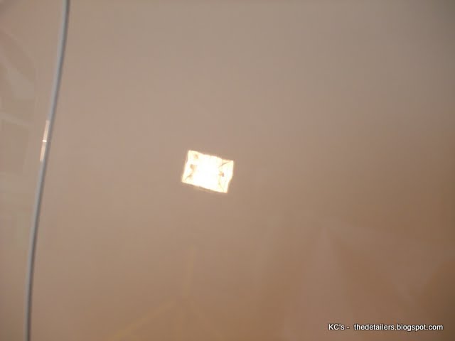

paint before - water spots
after
50/50% comparrission pic

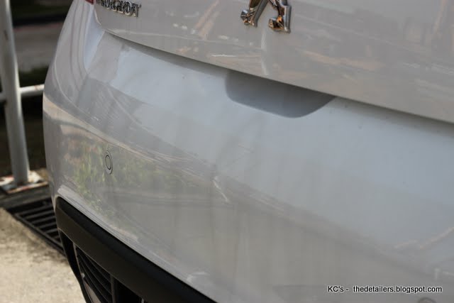

rear bumper
now
after
