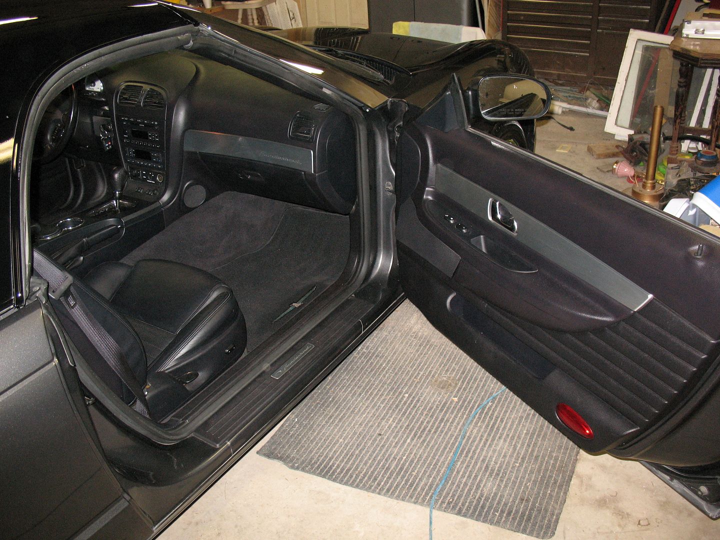

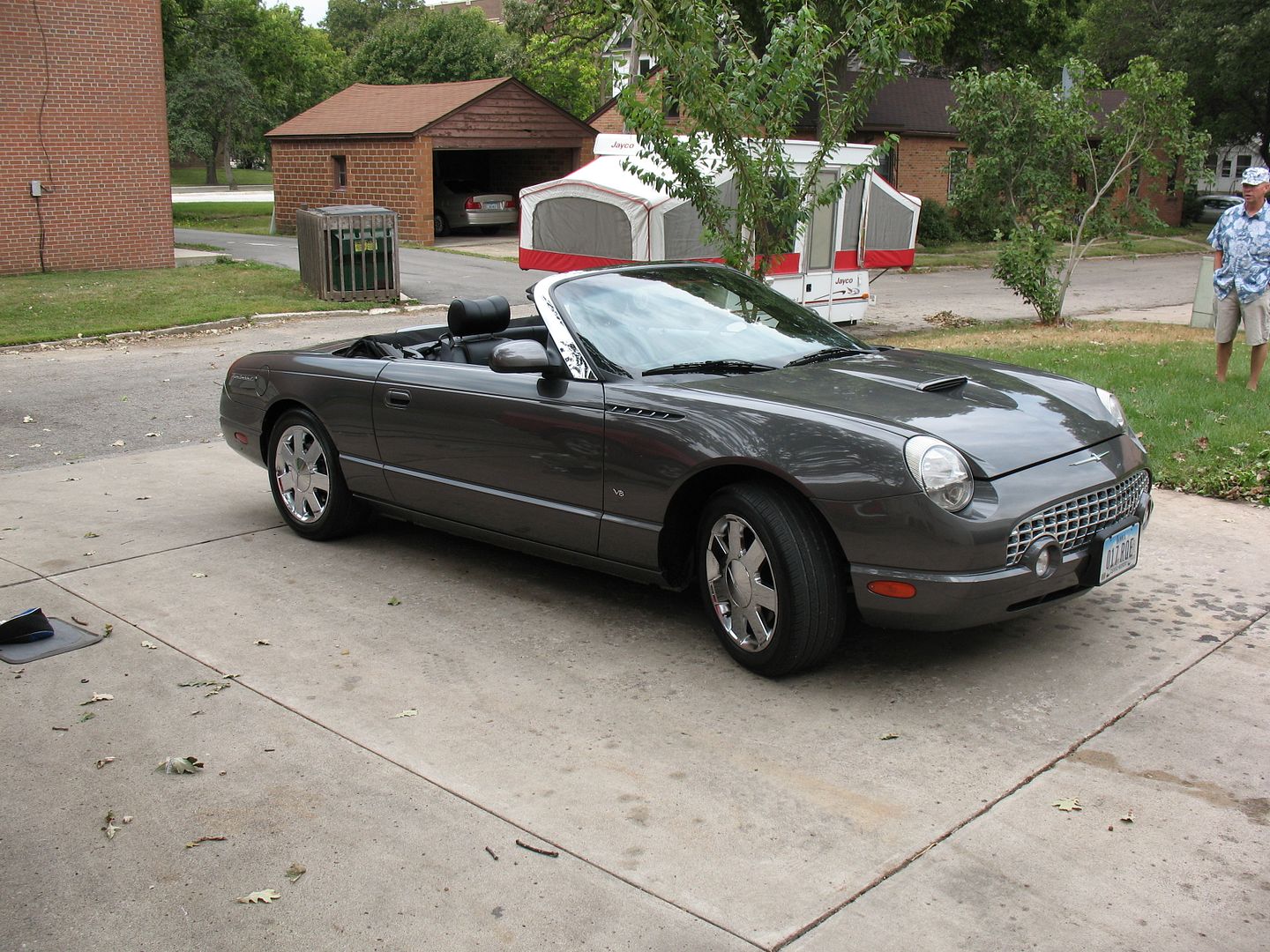

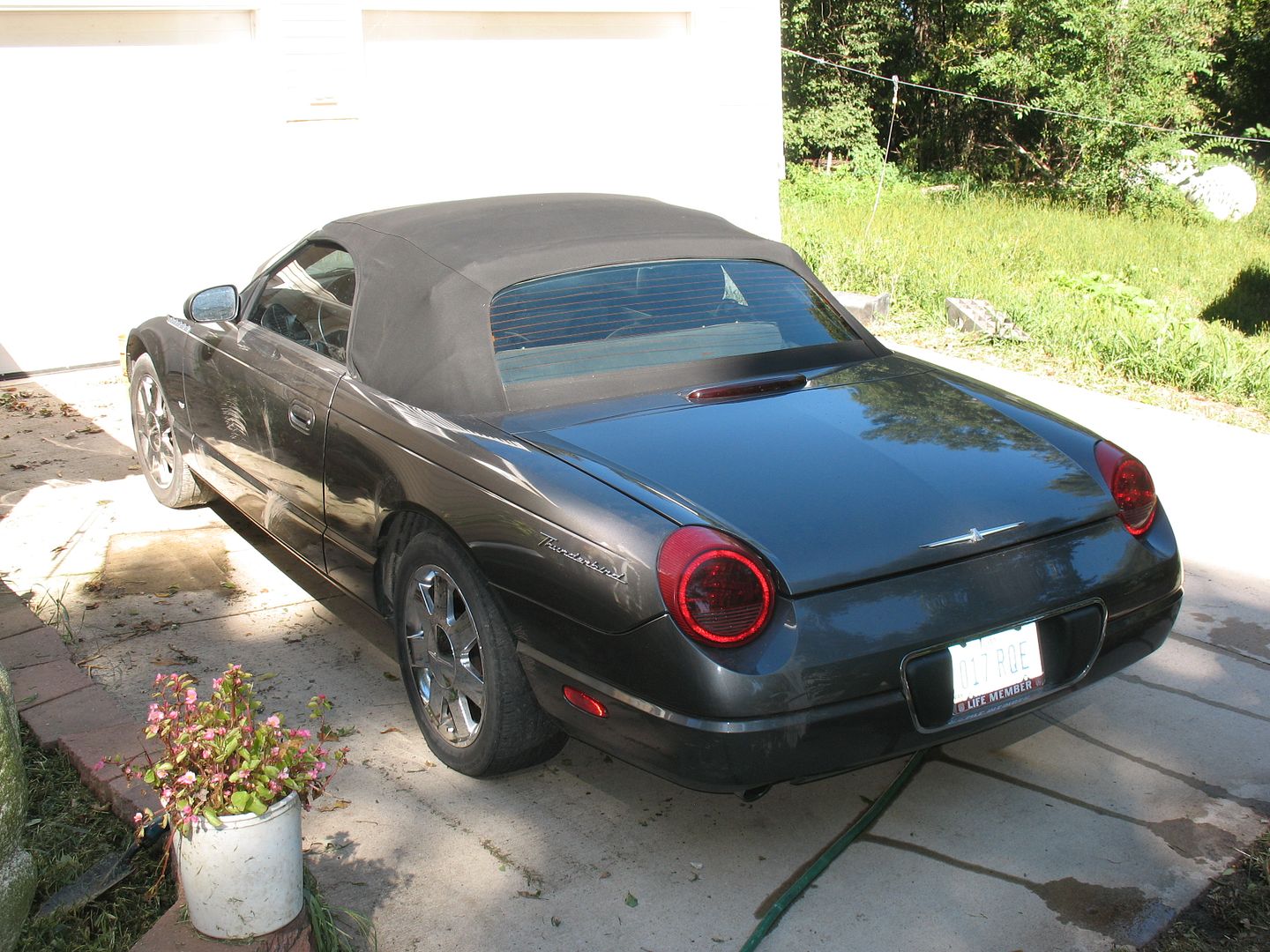

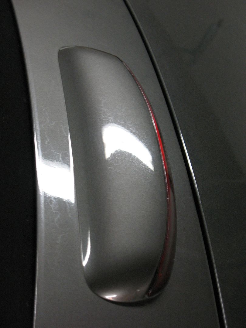

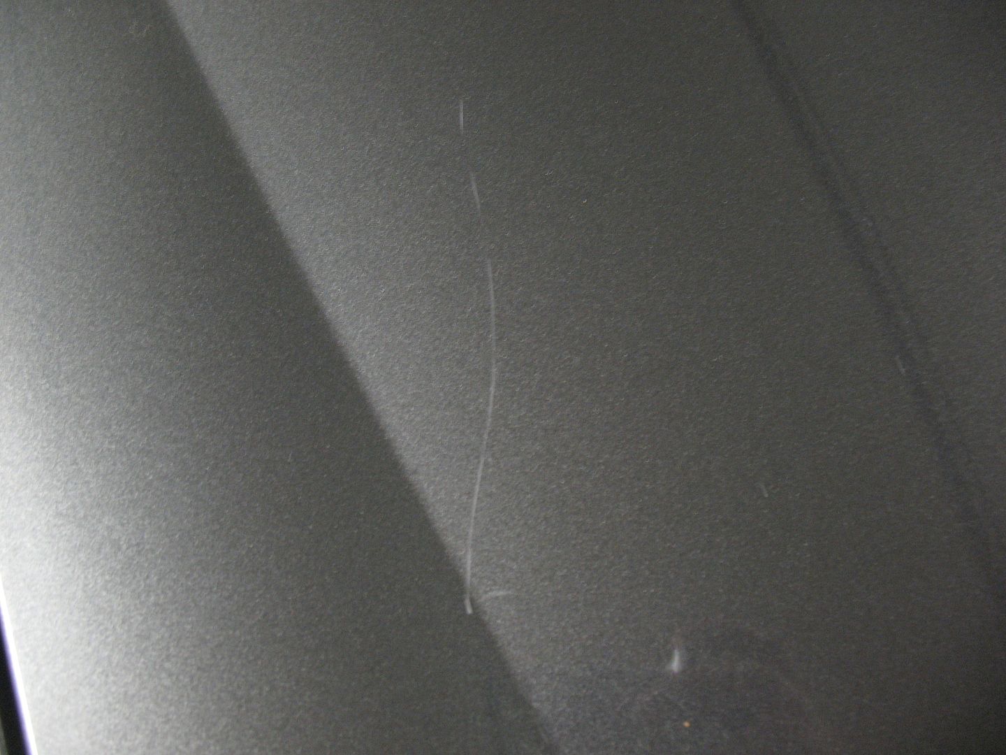

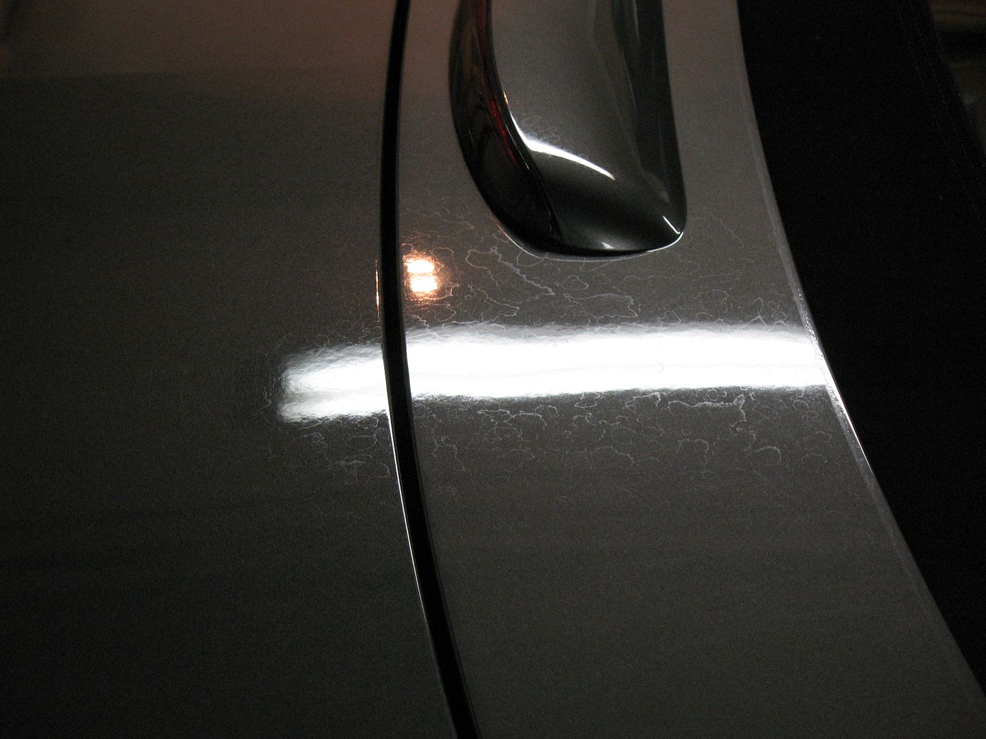

Ok guys, so last weekend i did a full detail on a good friends of mine 2003 T-Bird so he could sell it. The car is originally from Texas and when it came up here it was never driven in the winter on snow/ice. The only real concerns he had were water spots on the car which i suspect came from the salt water engulfed Houston, Texas as well as some scratches etc. Anyway, heres my Process as well as a handful of pics, majority of the pics were inside and the few that were outside after finished were unfortunately in cloudy conditions.

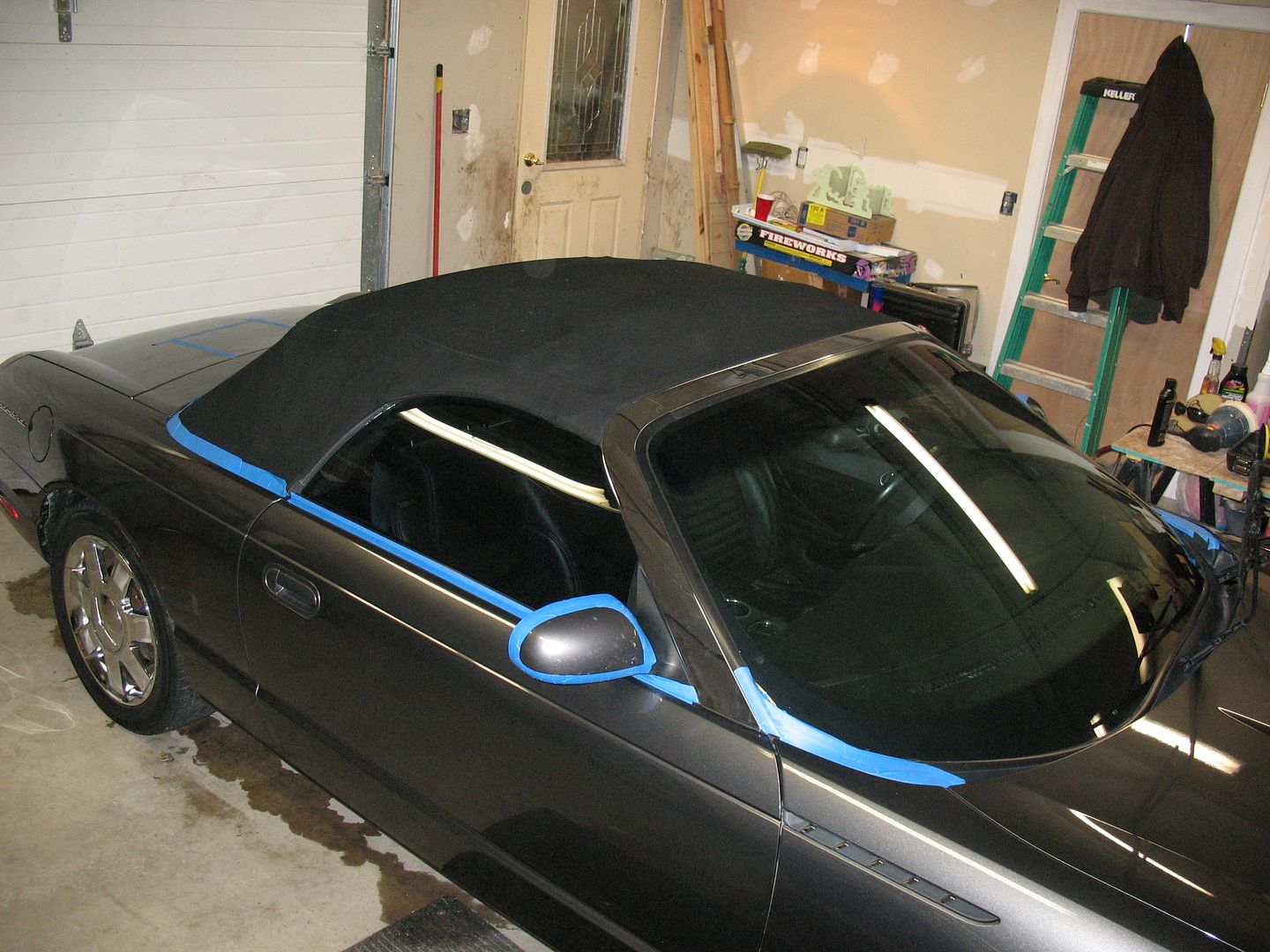

Prep:

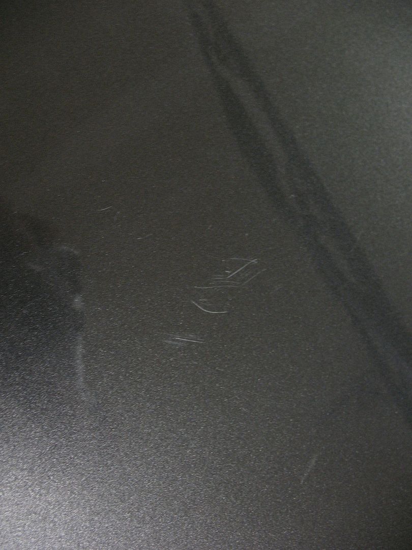

Correction:

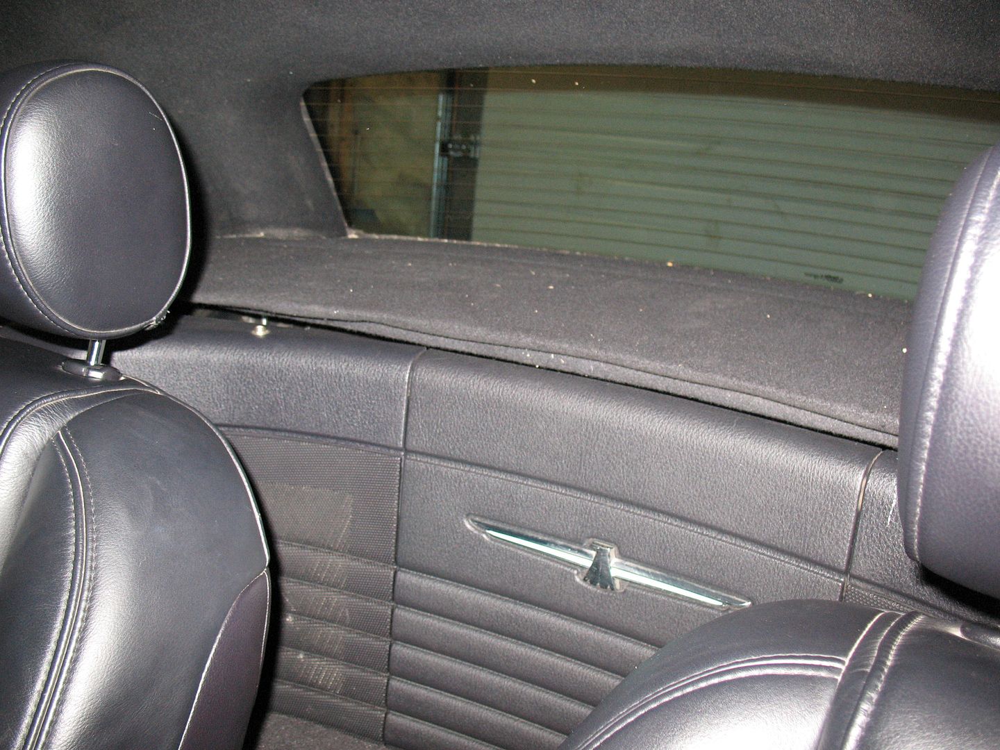

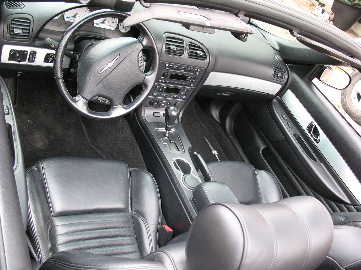

Interior (includes trunk)

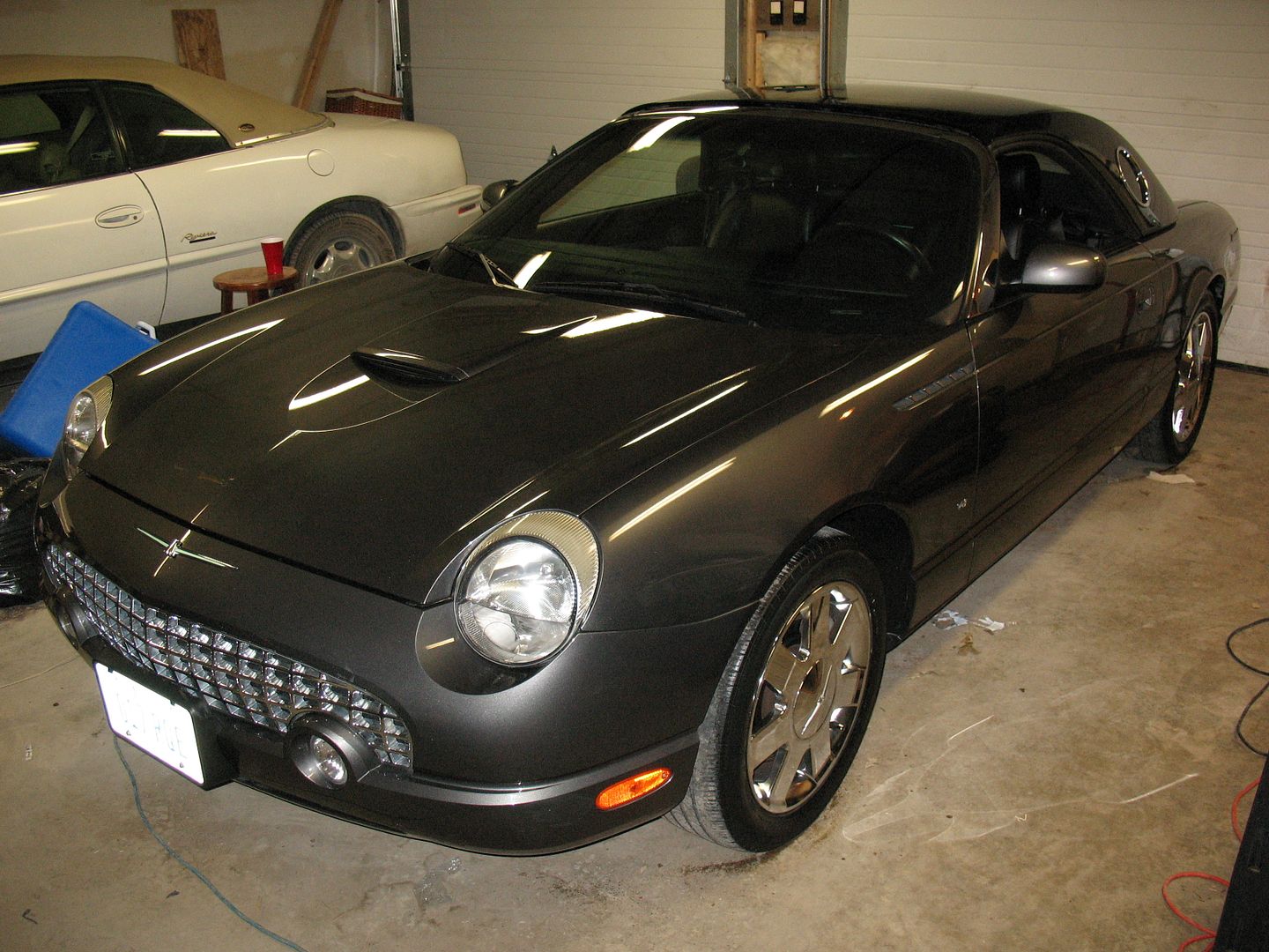

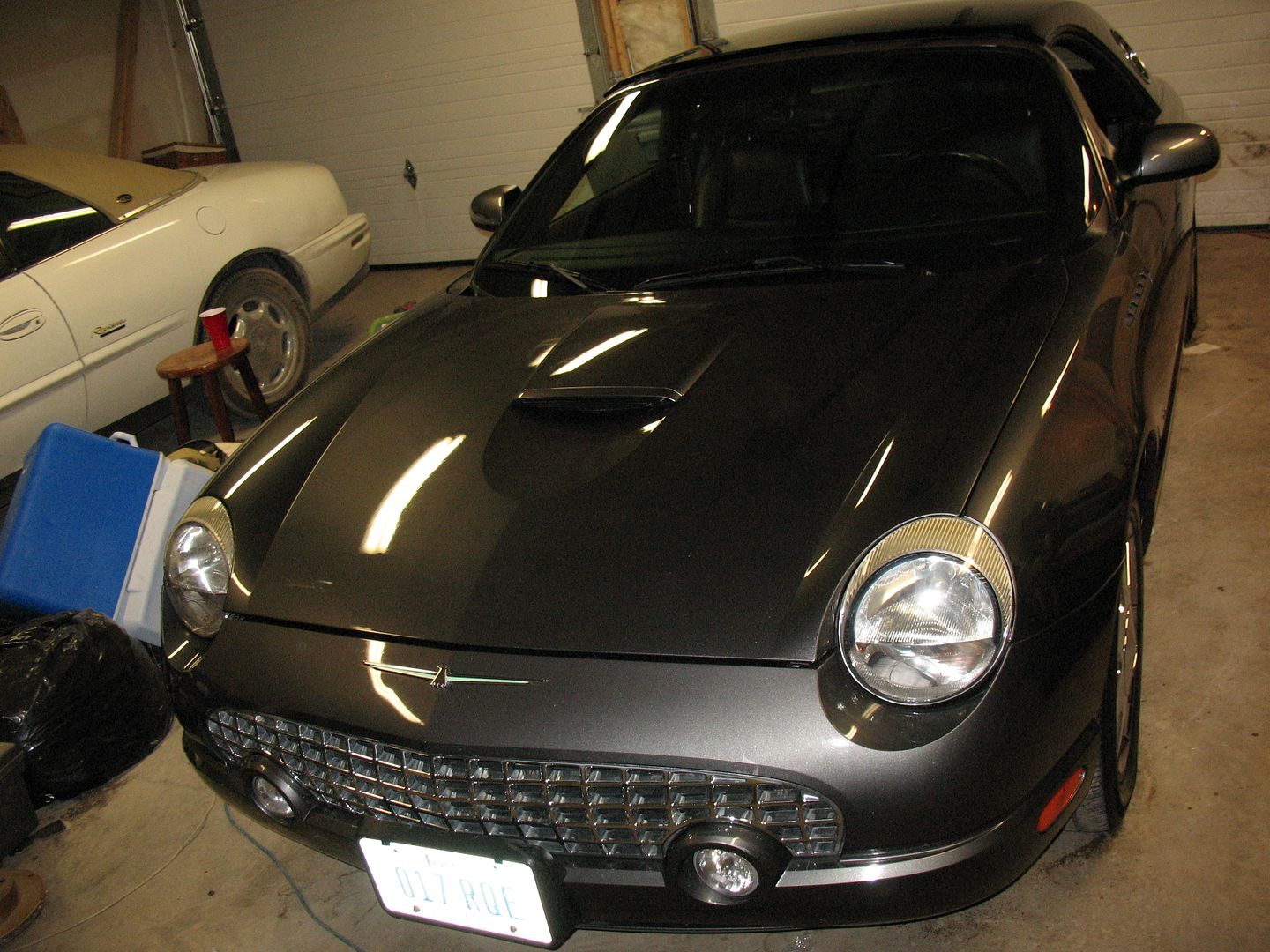

I think that's the majority of the process, im sure there's some small stuff im missing but regardless, heres some before, during and after pics.

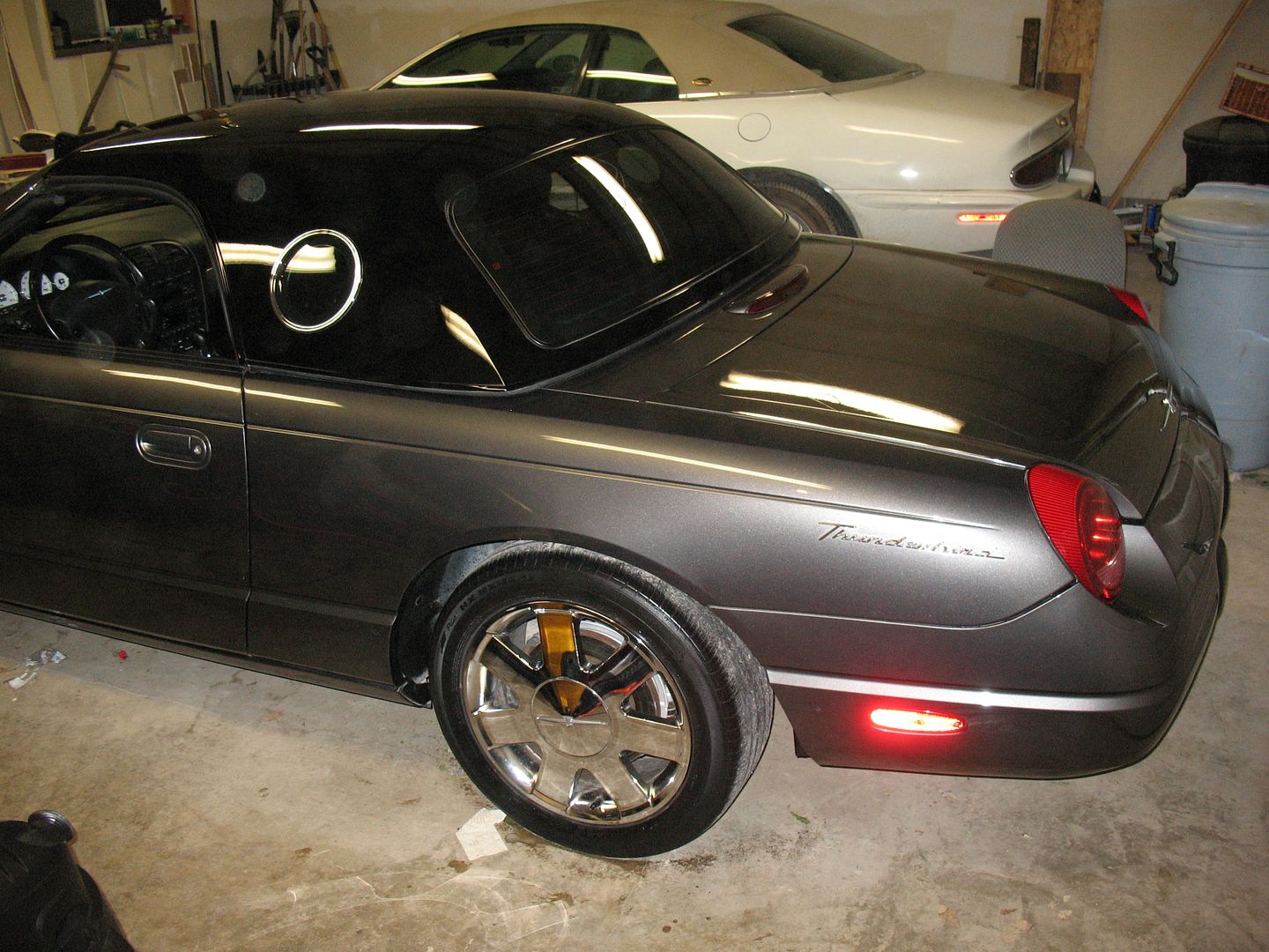

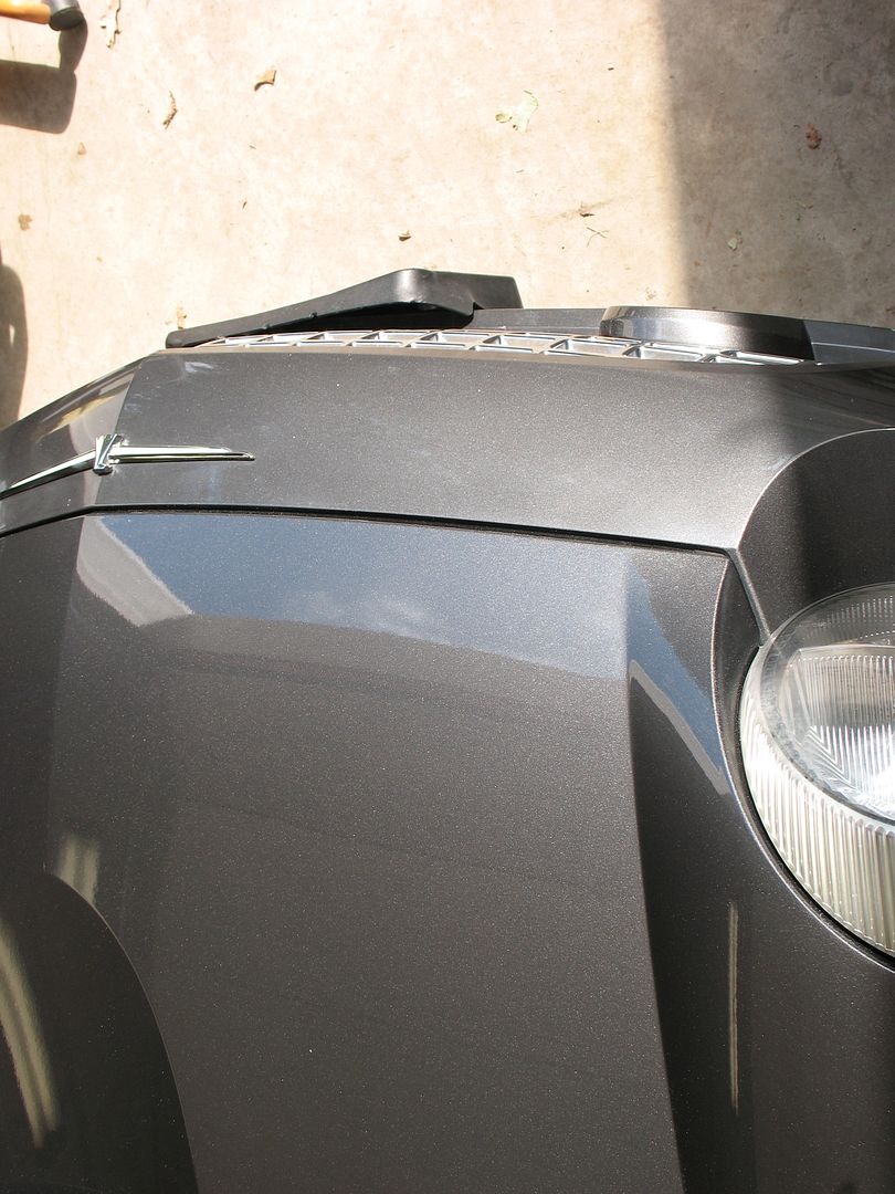

During:
UC and 205 on Hood, only UC on bumper cover, notice difference in flake and pop after 205!

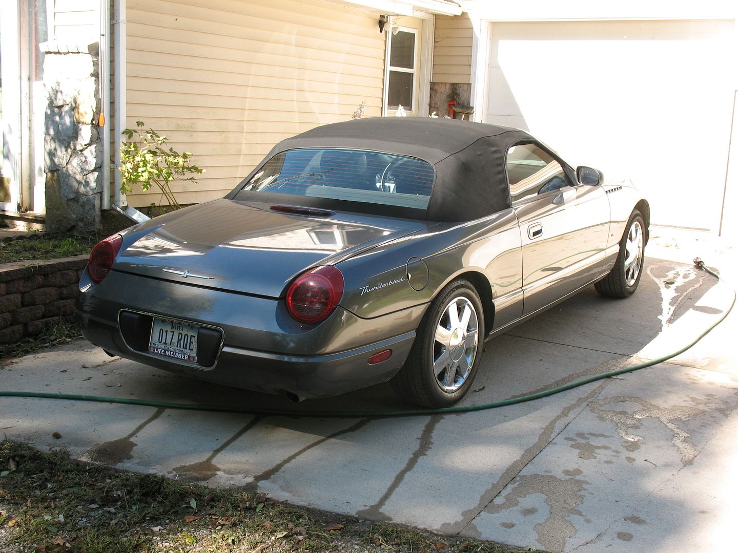

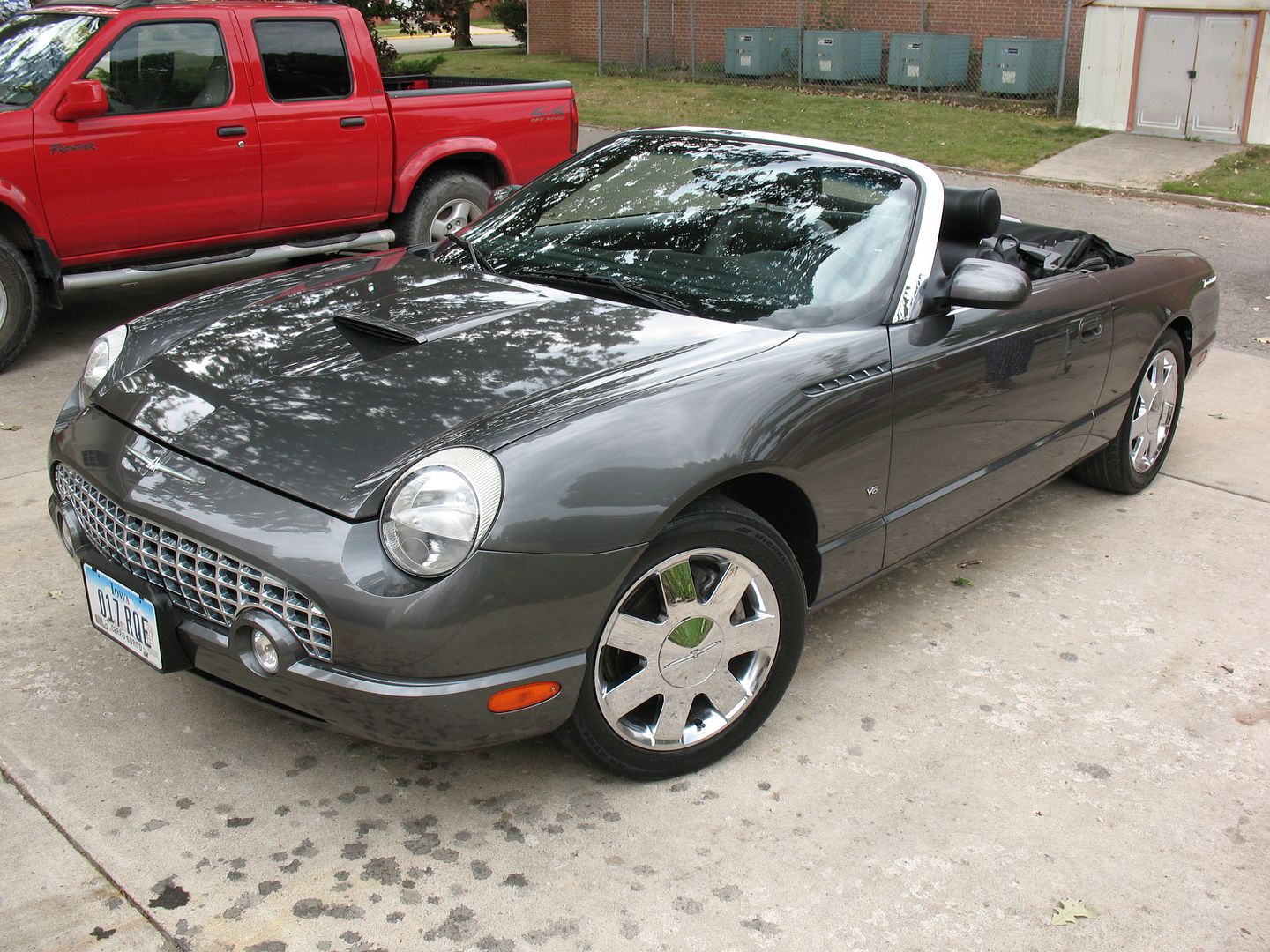

Finished:
Needless to say, my parents ended up buying the car after i detailed it, so now i can spend even more time and really finesse the car to make it PERFECT as its another vehicle in our garage now!

- Taped up rubbers, cloth, plastics etc.
Correction:
- Ultimate Compound on a W8207 Polishing Pad, Speed 6, Hood, trunk lid got multiple passes
- M205 on a W9207 Finishing Pad, Speed 6, Hood, trunk lid got multiple passes
LSP (wax/sealant)
- M21 on a W9207 Finishing Pad, Speed 3, 2 passes on whole vehicle, cure time of 30-45 in between coats.

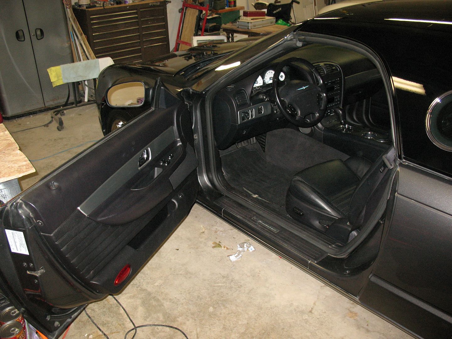

- Vacuum entire interior
- Treat problem spots on carpet (only 1 or 2) with APC+
- Clean dash, door panels, consoles etc. with APC+
- Protect with QID
- Clean leather seats with Megs Aloe Leather cleaner and conditioner
- Glass cleaned inside and out with SIG
- All door/trunk jambs cleaned with M135 Syn. Spray detailer.
During:
Finished:
