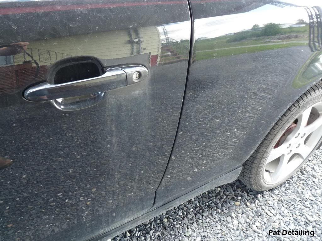

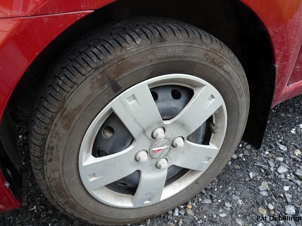

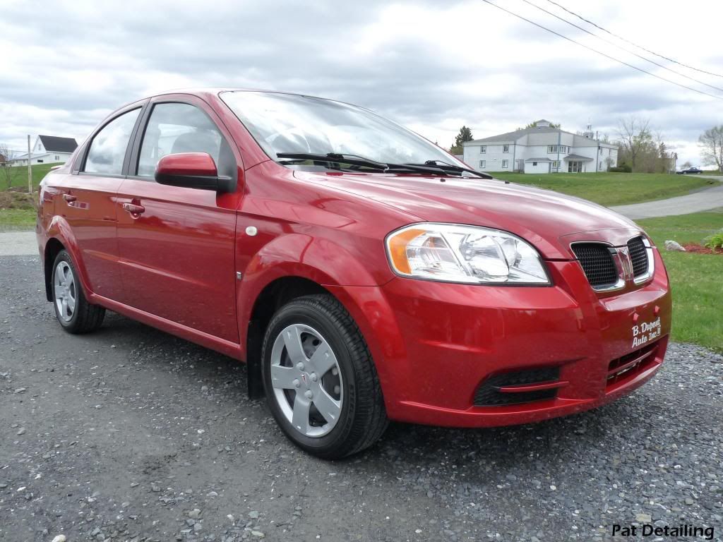

    2008 Pontiac Wave sedan (8966 km)
    Wheels, weels and tires cleaned with APC, washed with NXT soap, 1 coat of NXT wax, 1 coat of #26 Yellow Wax, vaccum, all interior cleaned with water and some APC+ then dressed with Quick Interior Detailer, glass cleaned with NXT, final wipe with #135 synthetic spray, Gold Class tires gel on the tires.
    Befores :
    Afters :
    Sorry, I forgot to take pics of the interior after.

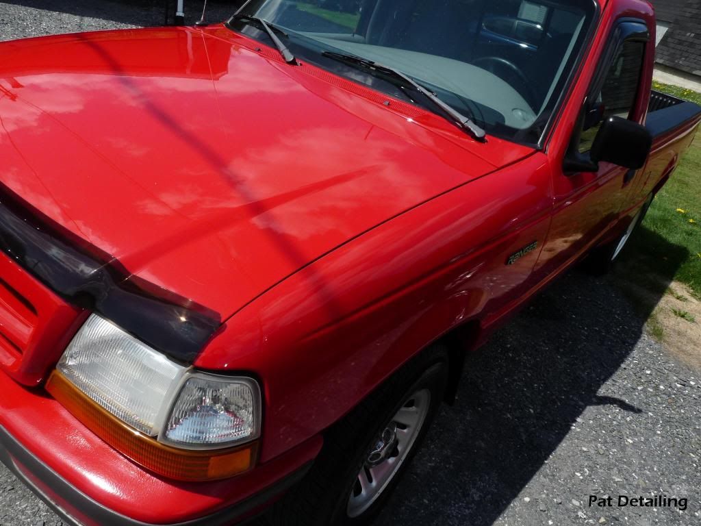

    2) 2003 Ford Ranger Edge 4x4 (115158 km)
    Wheels, weels and tires cleaned with APC, washed with NXT, several scratches treated with #105 and orange pad, polished with #80 and white pad, 1 coat of Gold Class Carnauba Plus wax, spray #135, ASD on all plastic trim and wheel wells, Black Magic Tire Wet on tires (didn’t like this stuff at all, gave it to the customer as a « gift », quick interior vaccum
    Sorry, no befores of this Ranger (was not this bad…)
    Afters :

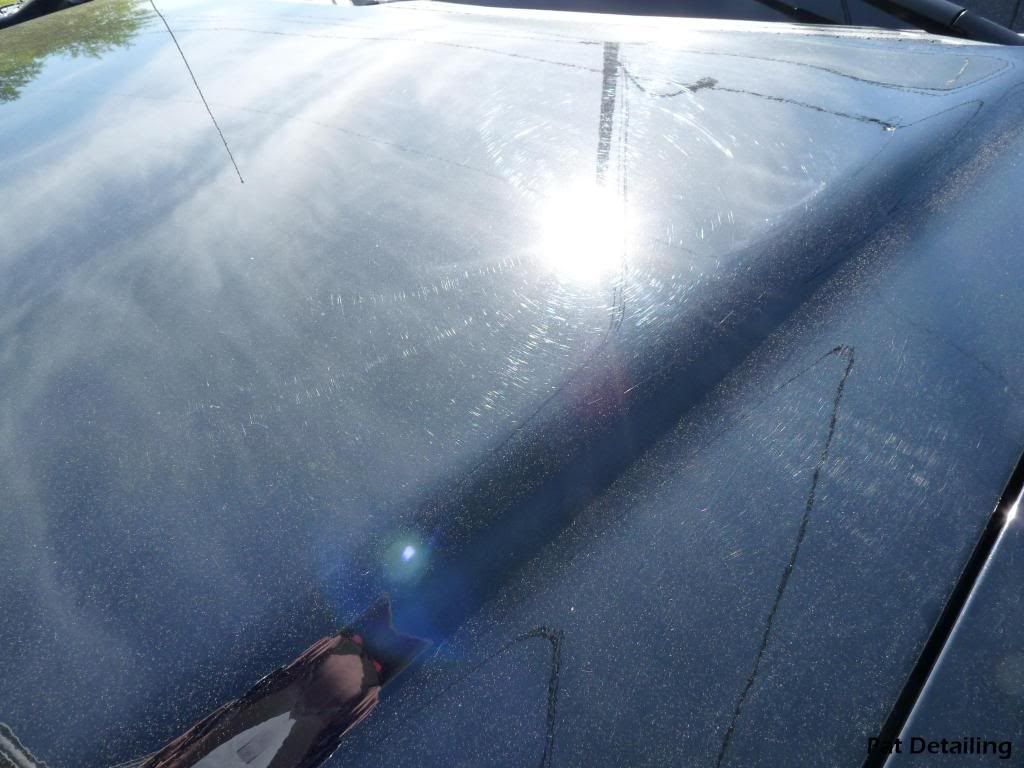

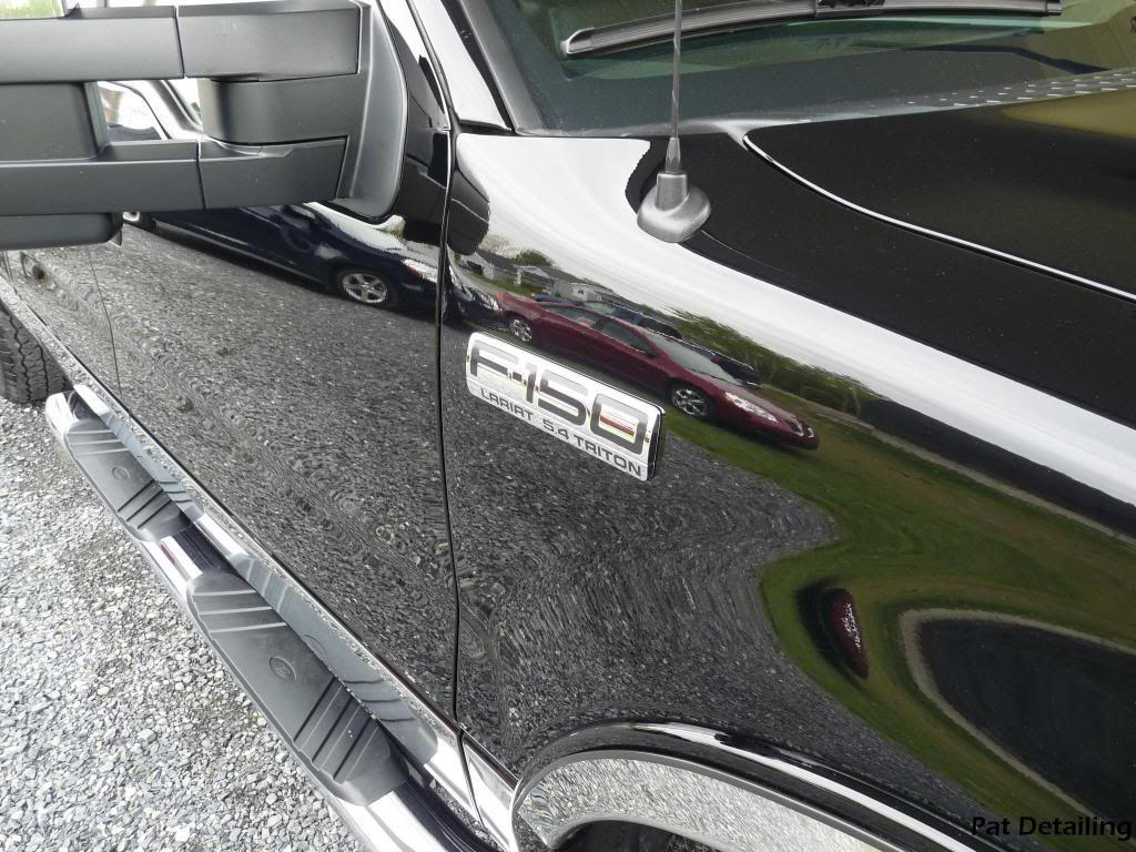

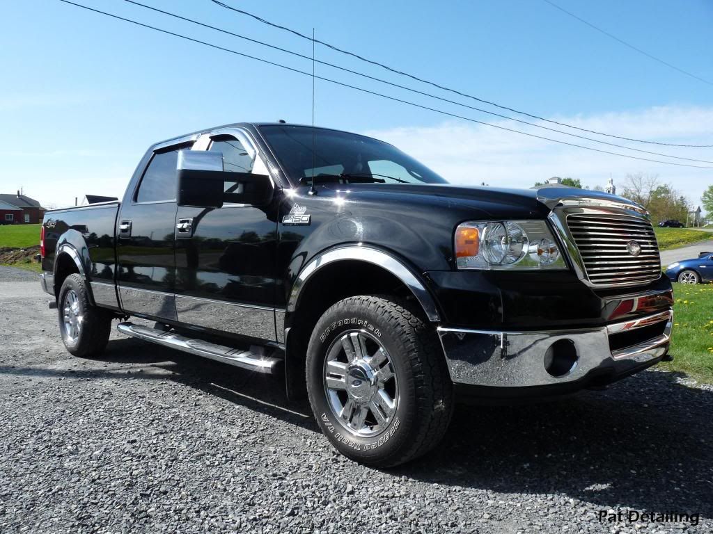

      3) 2008 Ford F150 Lariat 4x4 (39560 km)
      Customer just bought it used at a Ford dealer a few day prior. Looked good from what you can see on this picture.
      But once you get closer, it doesn’t look at good…
      Once I got the paint cleaned it was even worst. Looks like fillers were used to cover the swirls.
      Process :
      Rims, wells, tires cleaned with a mix of NXT soap and APC, washed with NXT and APC to remove the fillers), clayed, polished the whole truck with #105, then #205, 1 coat of #7 Show Car Glaze, 1 coat of Gold Class Carnauba Plus wax, spray #135, Ultimate Protectant on all exterior trims, Armor All Extreme Shine tire gel on tires, ASD on flaps and wheel wells, quick vaccum, glass cleaned with NXT, quick wipe down with Quick Interior Detailer
      Afters :
      Sorry, it began to rain once I was done, but the client was in awe in front of this truck.

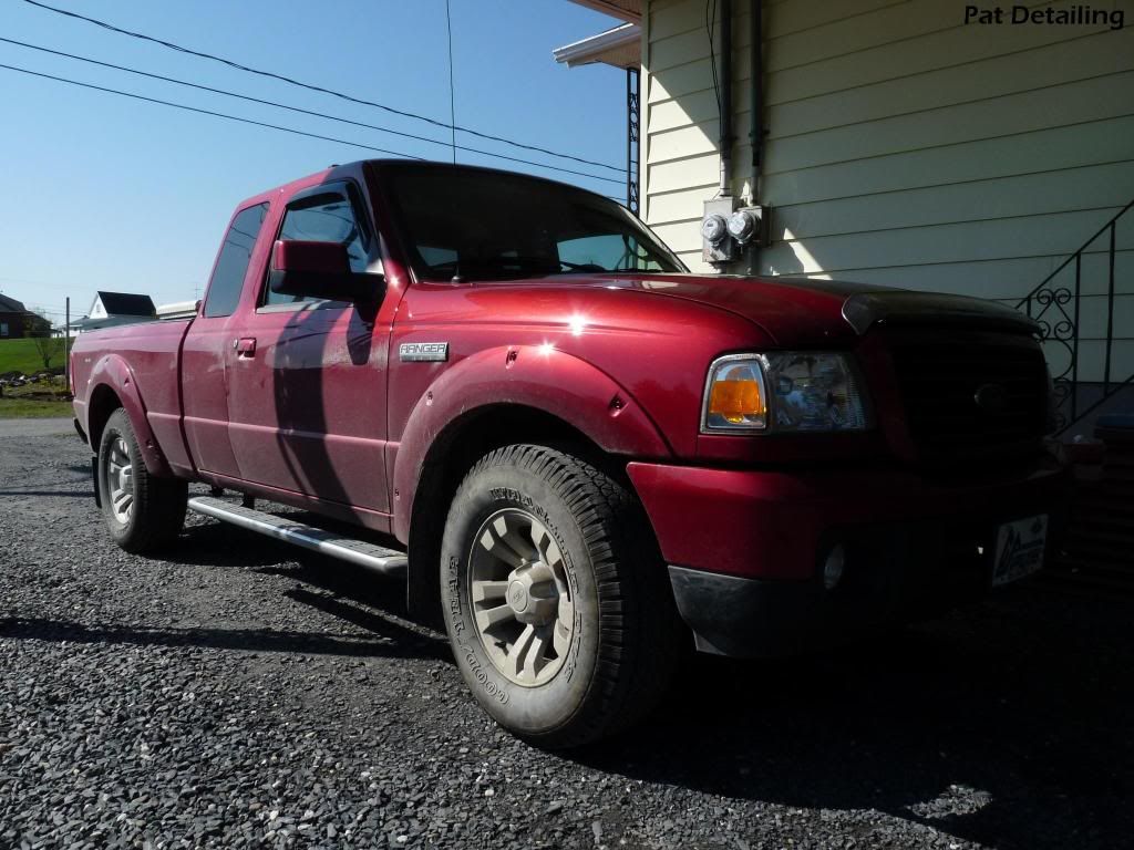

        4) 2008 Ford Ranger Sport 4x4 (56187 km)
        This was a complete mess. I was told to do what I can in the interior, but not spend too much time there because that the truck it is used on road construction and will get dirty all over again.
        Process :
        Rims, wells and tires cleaned with APC, washed with Ultimate Wash and Wax, ASD on trims, flaps and tires, vacuum, glass cleaned with NXT, plastics cleaned with water and some APC+, no dressing as per customer request
        Befores :
        Afters :

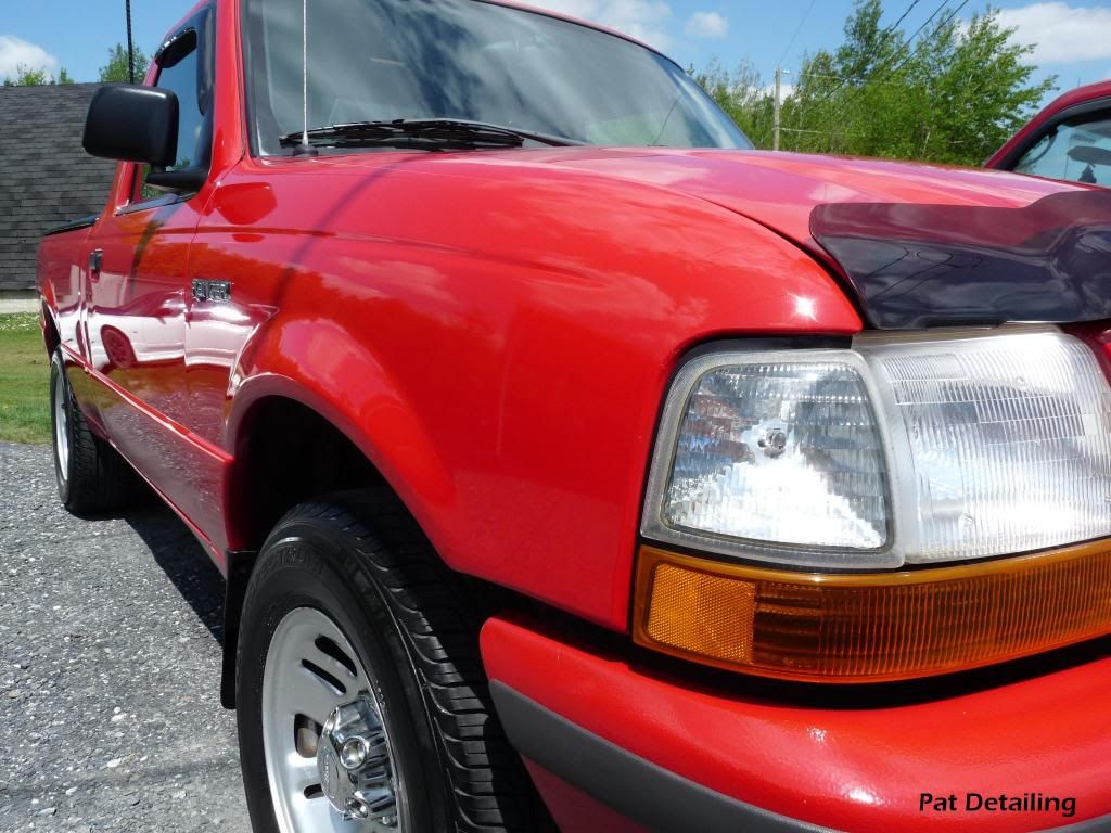

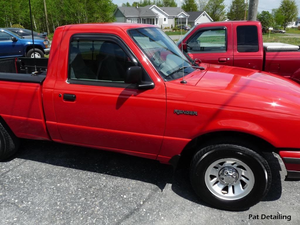

          5) 1998 Ford Ranger Sport 2x4 (106987 miles)
          No before pictures as the truck was very cleaned to begin with. Customer only wanted the paint to be polished to remove the swirls and shine up the paint.
          Tires and weels cleaned with APC, body and rims washed with NXT, clayed, polished with #105, then #205, 1 coat on #7 Show Car Glaze, 1 coat of Gold Class Carnauba Plus wax, spray #135, ASD on trims and flaps, Armor All Extreme Tire gel on tires. I did not touch the interior.
          Afters :

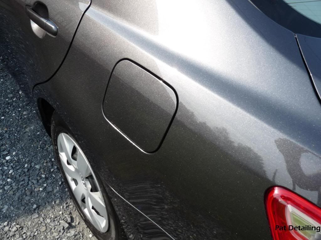

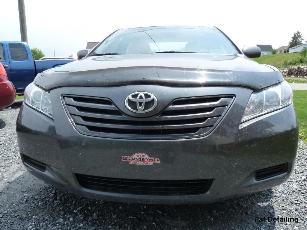

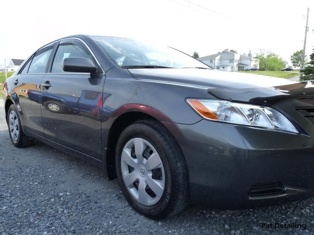

            6) 2008 Toyota Camry LE (51427 km)
            Wheels, weels and tires cleaned with APC, washed with NXT, clayed, one coat of #21 synthetic sealant, spray #135, vaccum, glass cleaned with NXT, plastics cleaned with water and APC+ then dressed with Quick Interior Detailer, ASD on flaps and weels, Armor All Extreme Shine Tire gel on tires.
            Befores :
            Afters :

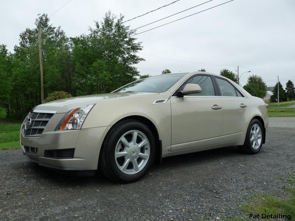

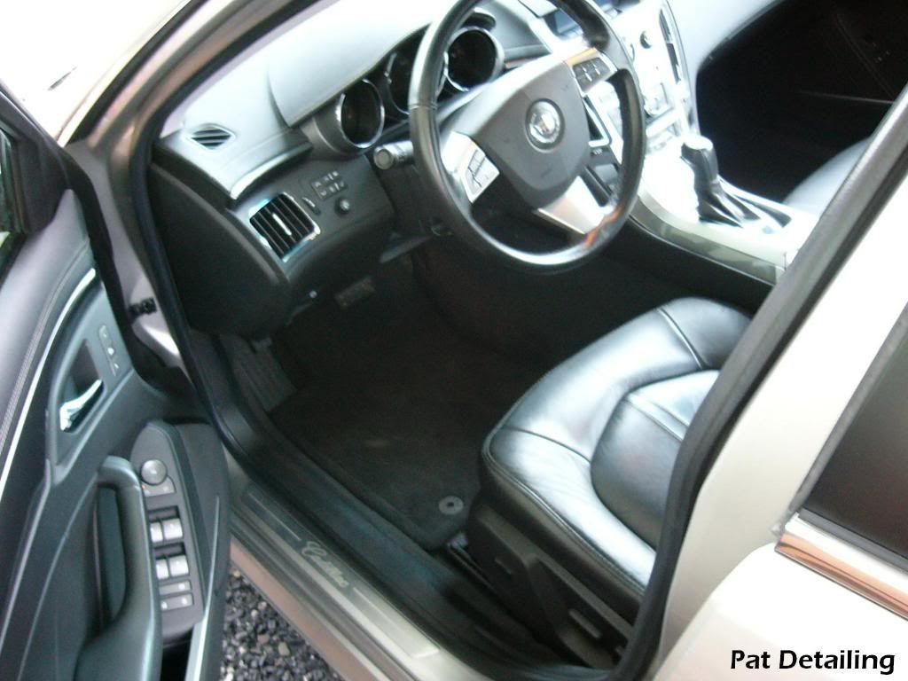

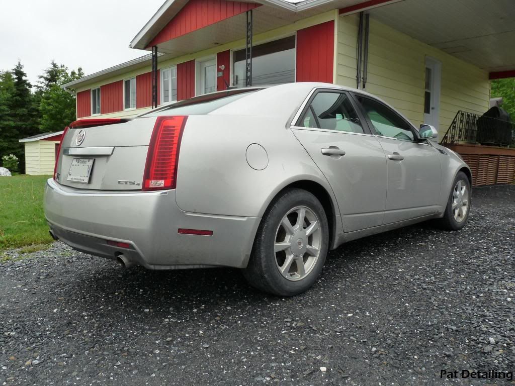

                  9) 2009 Cadillac CTS 4 (18597 km)
                  Rims, weels and tires cleaned with APC, washed with Gold Class soap, clayed, rewashed with Gold Class, #80 Speed Glaze, one coat of Gold Class Carnauba Plus wax, spray #135, vacuum, plastic cleaned with water and APC+ then dressed with Quick Interior Detailer, leather seats threated with Gold Class Leather cleaner and conditionner, glass cleaned with NXT, ASD on flaps and weels, Hot Shine Tire gel on tires
                  Befores :
                  (Sorry i twas raining quit hard)
                  Afters :

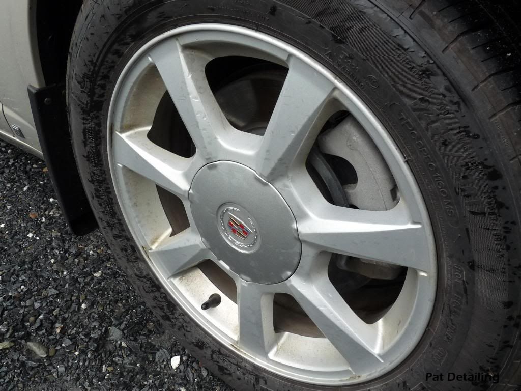

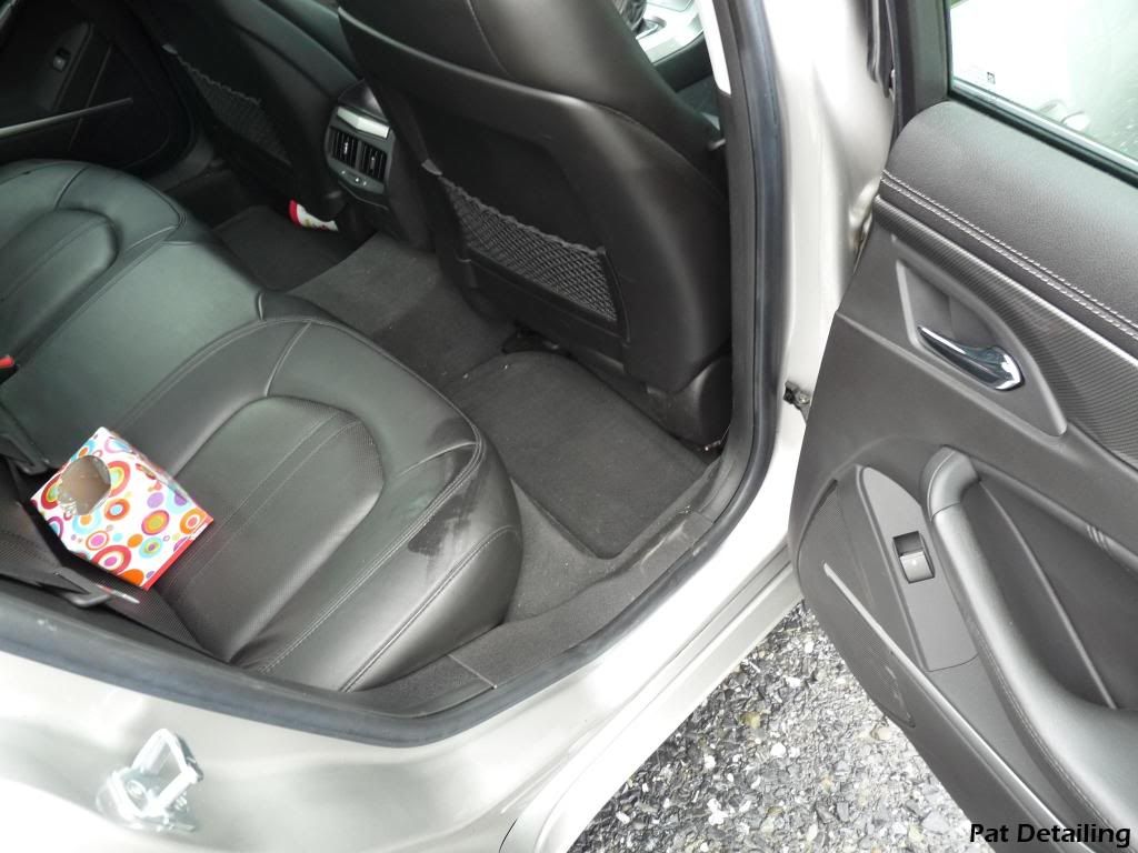

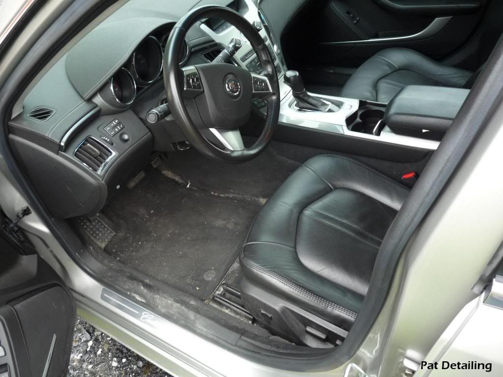

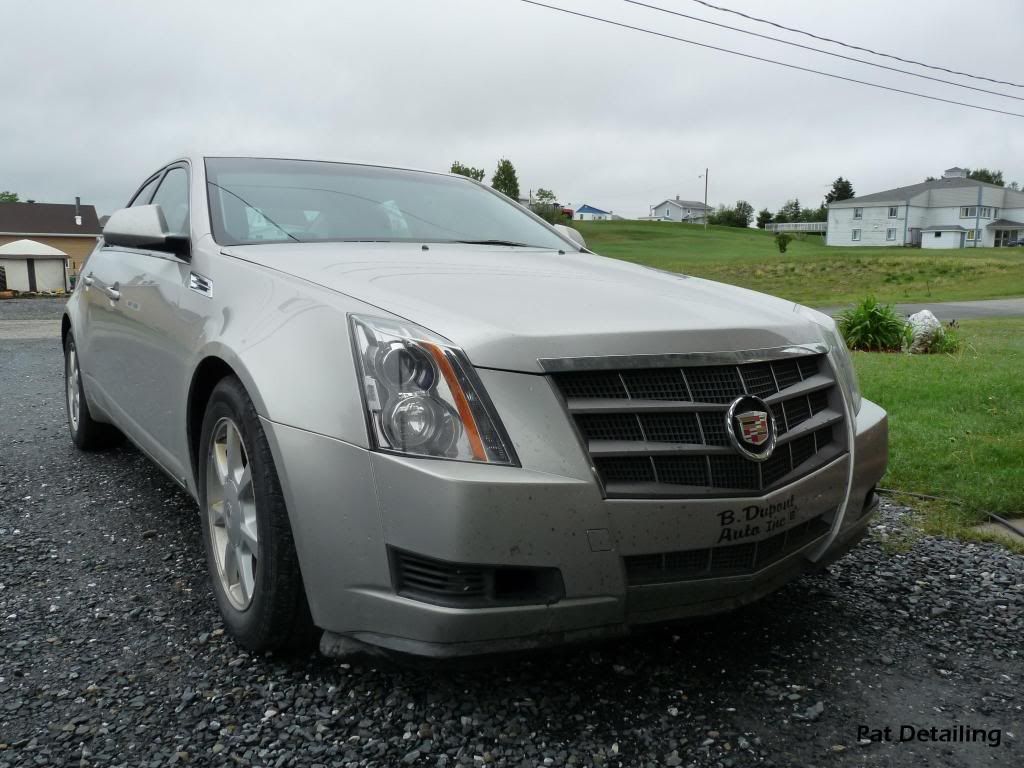

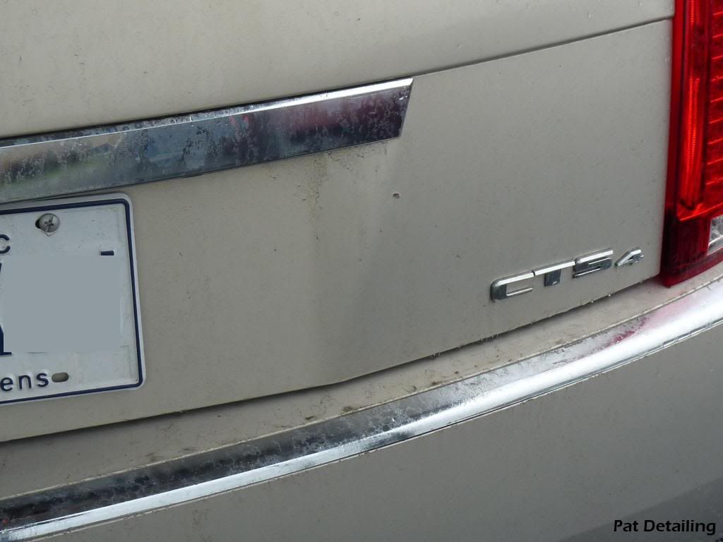

                    2008 Cadillac CTS 4 (56450 km)
                    Trashed car, it looked more like a 200 000 km car than a 50 000 one.
                    They took over this lease in spring on 2009 and I don’t believe that they cleaned the car since then.
                    Wheels, wells and tires cleaned with APC (didn’t had Wheel Brigthener in hand, but would have needed it!), washed with APC, clayed, 1 coat of NXT wax, vacuum, glass cleaned with NXT, plastic and seats cleaned with water and APC+ then dressed with Quick Interior Detainer, ASD on trims, Armor All Extreme Tire gel on tires
                    The paint would have needed to be polished, but customer didn’t want to.
                    Befores :
                    Afters :
                    (Sorry i twas raining again when I was done)

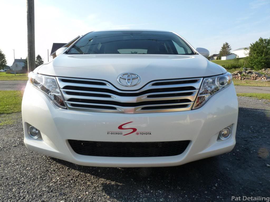

                        13) 2009 Toyota Venza AWD (27773 km)
                        Only had the car for 3 hours. The main goal was to remove the heavy brake dust on the sides and back of the car.
                        Wheels, weels and tires cleaned with APC, washed with NXT, I then tried to clay, but it was not fast enough for the time I had so I tried the « Fall out Liquid Cleaner » by BodyPro that I had in the closed, but never used it. It made all the brake dust come right on in seconds. I then rewashed with Gold Class soap, 1 coat of #21 Synthetic Sealant, ASD on tires, weels and trims
                        No before of this Venza.
                        Afters :

                          What's with all the fancy dealer stickers on the fronts of the vehicles. Must be a trend in your town.
                            Re: It's been a busy summer, part 1
                            You weren't kidding about being busy, Good Job on all cars
                              All beautiful work!!
                              Quick question, I noticed dealership names on the front of cars? Is that common in Canada or something? I'd be annoyed if I had that on the front of mine
