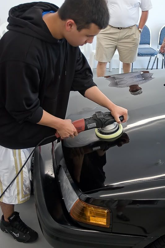

    I was using my old worn pads so that could be why. I stated to use about 15lbs pressure and it was not enough pressure to stop the PC from rotating which is what I use as a measure of when your pressing too hard. I had a mark on the back of the backing plate so they could see when it was spinning.
    Pad in this pic is compressed in the same manner yet my pad was always rotating durring the demo's...

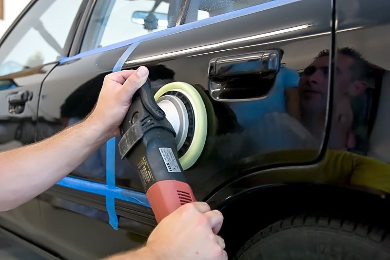

    In this picture too.

    Amount of compression of the pads I perceive from these pictures indicates too much pressure is being used with Flex.
