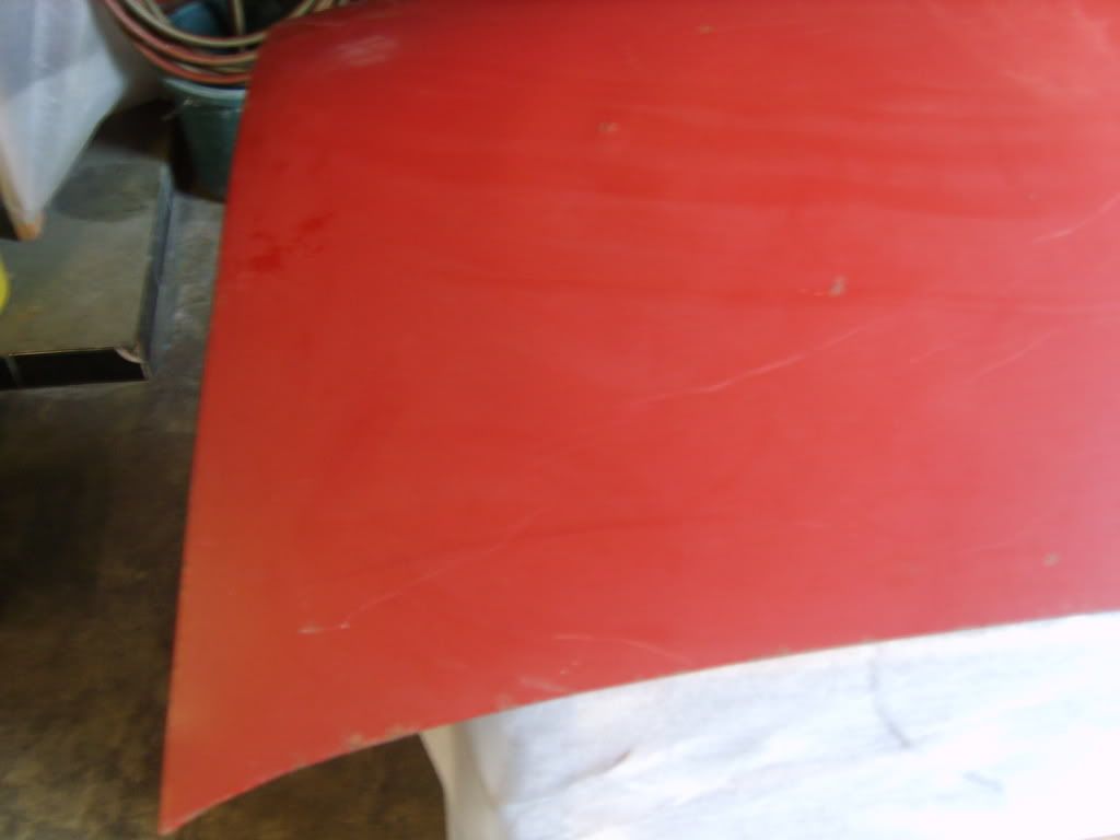

BEFORE

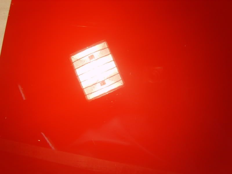

AFTER 1 PASS WITH M84

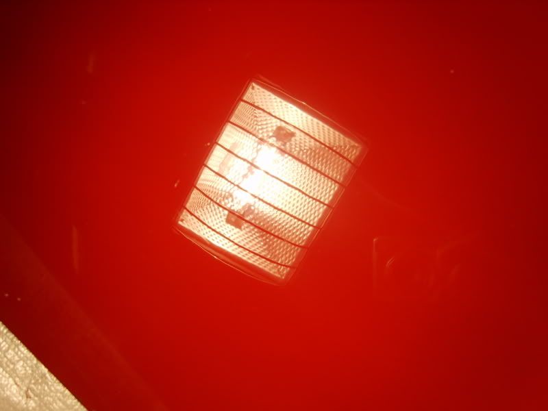

AFTER 1 PASS WITH M83

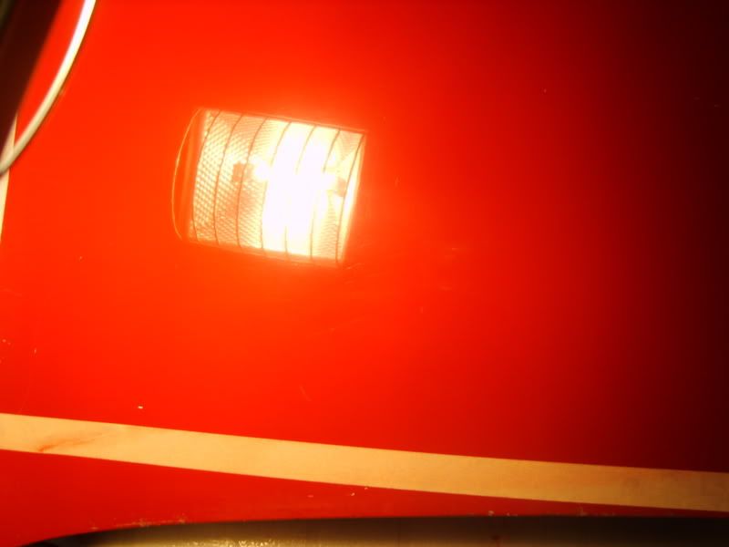

AFTER 1 PASS WITH M80

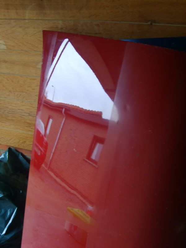

This is how it came out when it was finished

BEFORE
