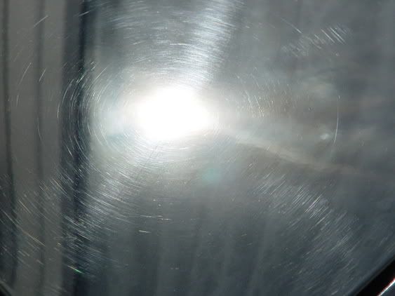

    Heres the Befores:
    and a close up of the one above

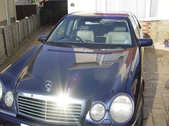

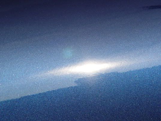

    And the afters, Still swirls but a good improvement

      it was stiil pretty swirled and if i'd had say a couple of days with it i could of gotten swirl free.
      But for 4 1/2 hours work i'm pleased.
