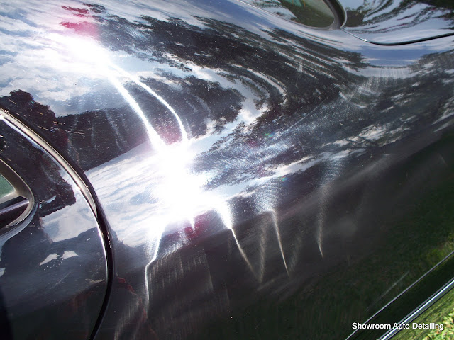

    I get these all the time, it's 60% of my business fixing DISM's. Here's an example. I won't mention the name, but this particular car came from a dealer in Houston that only sells high end cars, and the one in the picture is one of their lower end cars. When I looked at there website and saw the caliber of cars, I thought I hope there not doing this to all the Exotics that roll through there.

    They sure don't come that way from the factory. You got what is called....DISO. Dealer Installed Swirl Option.
    plus 1. Those things should be almost as good as they can get. With that said I always recommend a clay bar treatment if not a little polishing to my customers when they get a brand new vehicle. Most of the time new cars have not been cared for properly while on the lot. A lot of people test driving, sales people in a hurry. All of this can and will lead to the aforementioned DSIO
