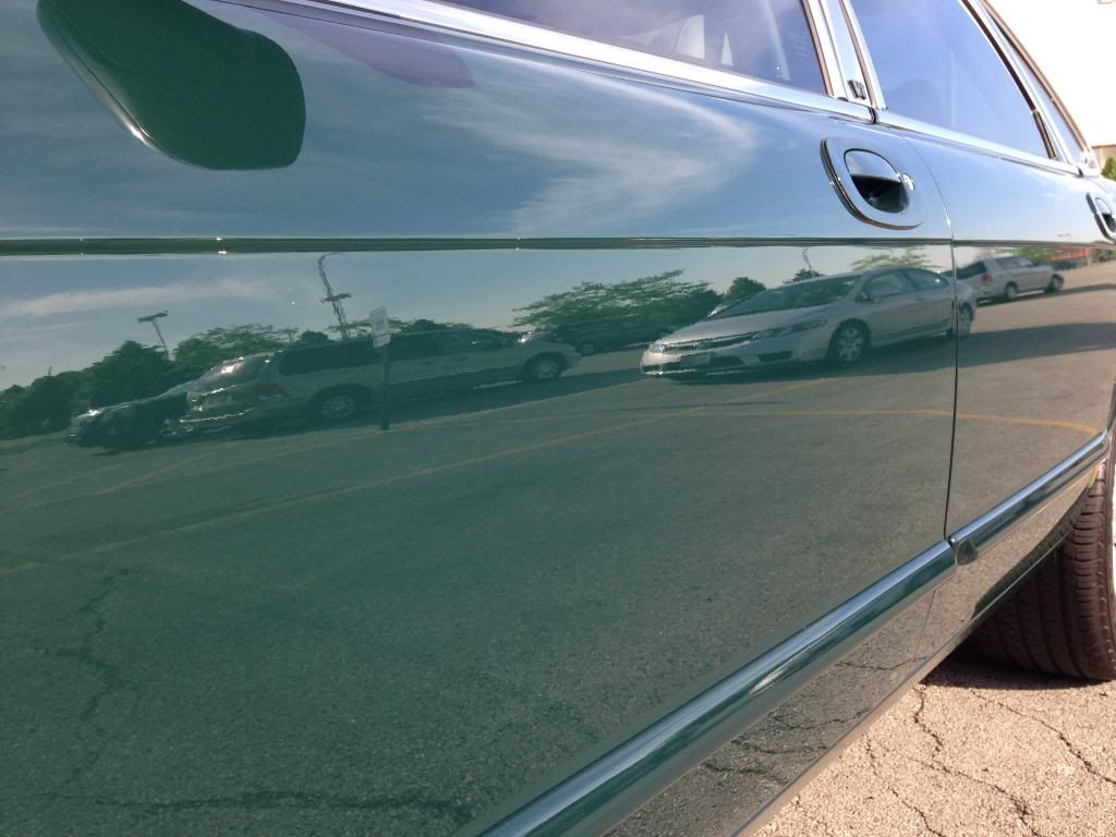

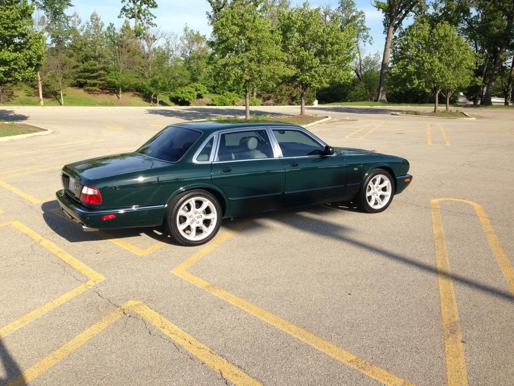

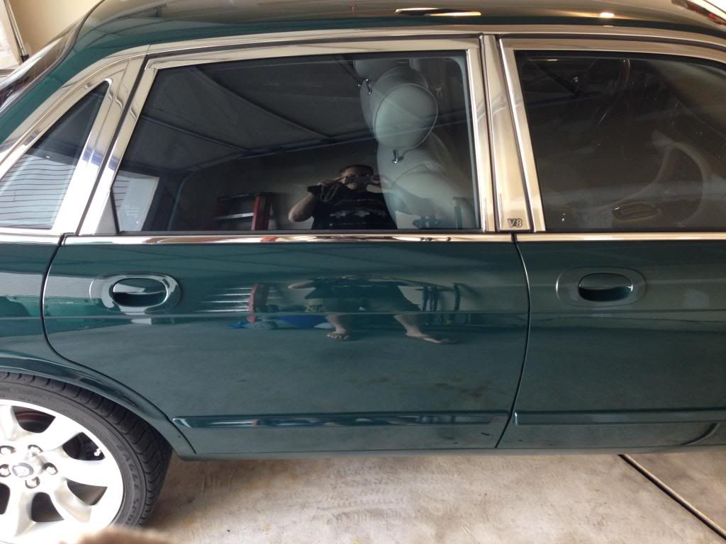

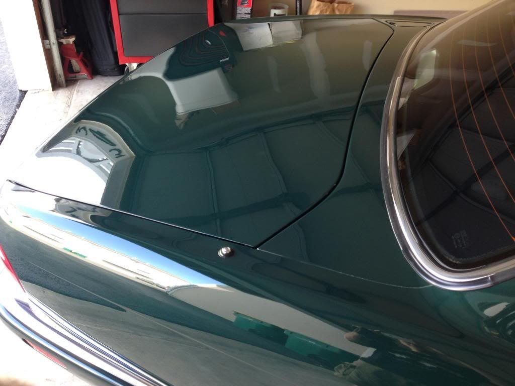

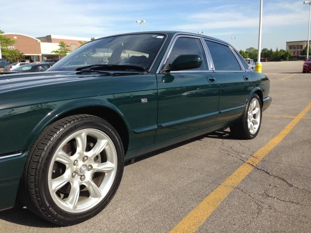

                  Here are some after pics. The work made the paint look amazing, I thought it look good before, but did not think it could have come out this good. The only bad things now, is it (to me anyway) points out the glaring issues with the paint( it is starting to check in a few spots on the hood, roof and trunk as well as previous bird dropping damage 0 ) however it is 14 years old and the first 6 years of its life was in Texas and who knows how well they tended to it. I picked it up with 43k miles on the clock. She now has 89k.
                  This is a before shot, unfortunately, it looks good in this pic, but up close it was a mess of small scratches, spider webs, you name it and the clarity was very much lacking up close.
                  Here are some "after" shots. Still probably cant tell as they were all taken with my phone. The first one is showing bird drop etching that I don't believe can be fixed...although I didn't try the red pad on her, I think its to the "bone"
                  Same spots on trunk lid near the right front of the trunck
                  Looks almost black from a distance!
                  And final shot before you are totally sick of my car, I really need to find someone willing to shoot below the moldings on the car to get rid of this, although the car could use a repaint, that is not in my budget anytime soon.
                  Thank you again everyone!
                  Chris

                      Wow it turned out amazing. Would of liked to see some before shots, but looks great. I couldn't really tell from the pics but the inside barrels of the rims looked a little dirty. I don't know if ur aware of it or I'm wrong about it. In case I'm not and u don't already know but u night want to pick up a Daytona speed master wheel brush. That will make it easy to clean and give ur detail that extra pop. Again assuming u never clean the inside of ur rims.
                      Anyhow look into the damf. Dual action micro fiber pads. It's an amazing system and better than the red cutting foam pad. But being ur 1st detail after a long break it looks amazing.

                        Good eye! No, I didn't clean them, I usually take them off about once a quarter or so to clean the backs but if that brush is as good as you say I'll buy it. Will I need a different backing pad for the DAMF? Too, just looking at the pic with the bird droppings, do you think that is repairable or does it look cooked?

                            Thanks Brett! What do you think about the bird droppings? Maybe you can look at the car yourself and tell me what you think?
                            Chris
                            Thanks
                            • #29
                              I don't have alot of experience with paint correction. But that 1st pic, is it 2 spots I'm seeing? Maybe we can get murr or guz to chime in on their opinions. Or even mr stoops himself as those guys are far more experienced and knowledgable than I am. Cuz my thought would b to try the the damf system if the other pads and compound didnt work
