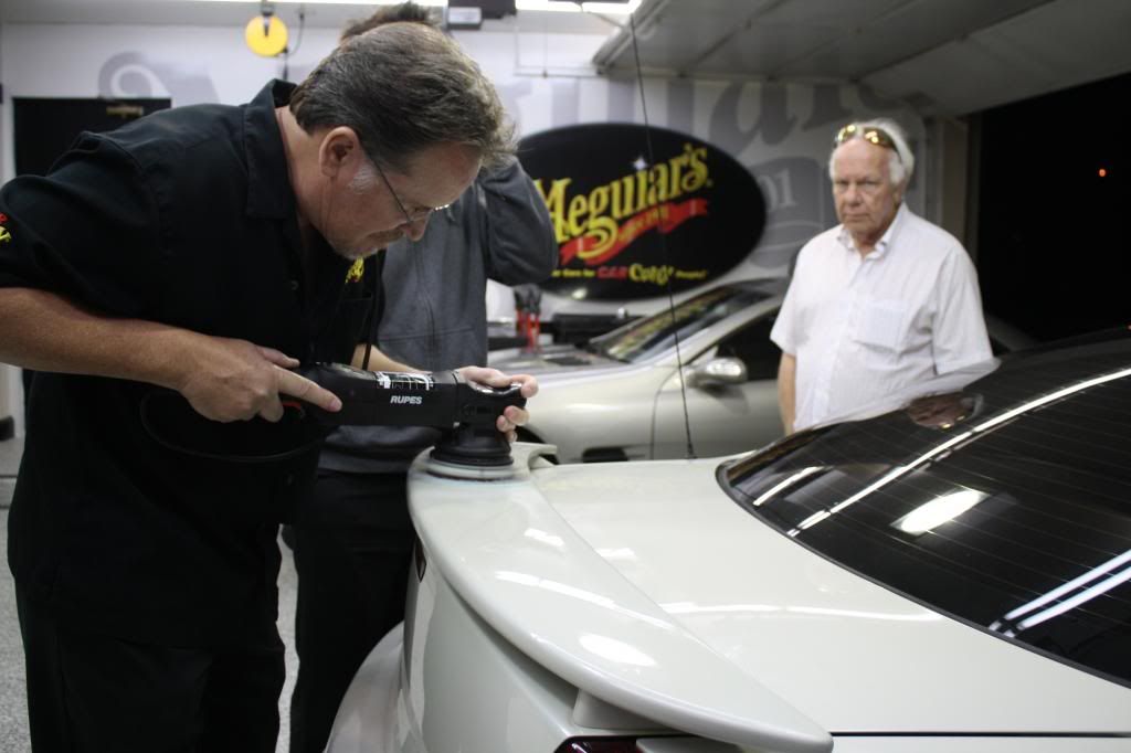

    ^ I forgot what combo was used here? Feedback please

    Did the method that Michael is working with on that photo do anything? It looks like he is using a microfiber pad. A microfiber pad may be what you need. There is also the new xtra cut microfiber pad. I'm not usre of what compound you are using but you could try M105 or M101 on a microfiber pad.

      Combo used: My Rupes 21, dmc5, and worked with M100... they key was the arm speed and the backing plate rotation speed..... remember how SLOOOOOOOWWW i was moving?
      In this case some deep and prolonged abrasion was needed to break the hard resin barrier of the opti-coat and reach the paint level so the defects could be accessed.

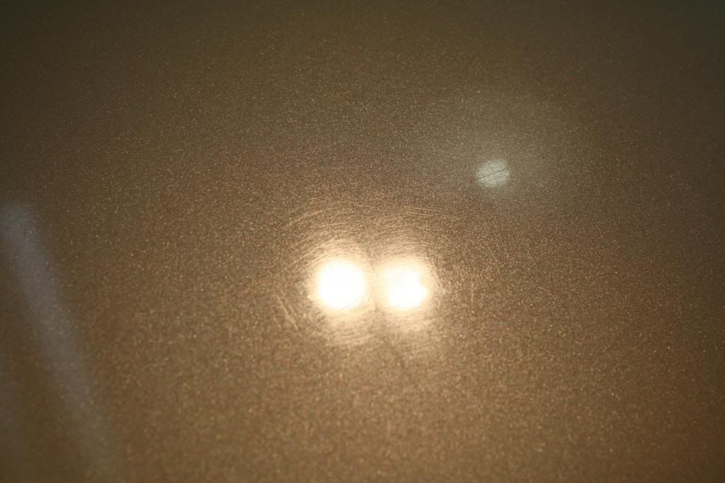

        Mike did go very aggressive. (had to the paint was that hard) He used the xtra cut disc and some M100. I went as aggressive as I could when I tried correcting the paint on my own, but didn't even remove a light swirl.
        I actually used Lake Country Hybrid Wool pad and 3M Heavy Duty Rubbing compound and wasn't able to correct anything. (was the most aggressive I had available at the time)
        haha and yes the car was opti coated
        Also, I thought my car looked pretty good. Even in the sun it looked good, street lights, gas station lights. You could find a swirl here or there, but man don't take your car in the Meguiar's Garage. Their lights show EVERYTHING! lol
