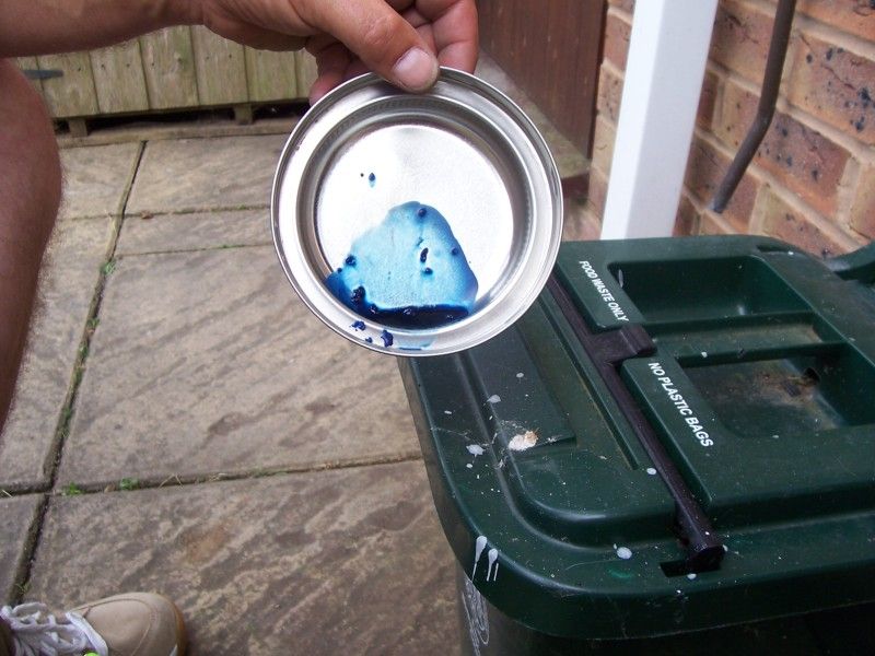

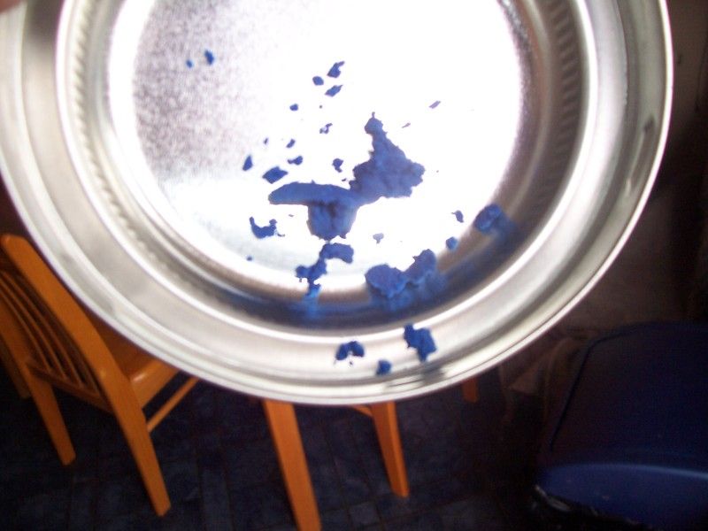

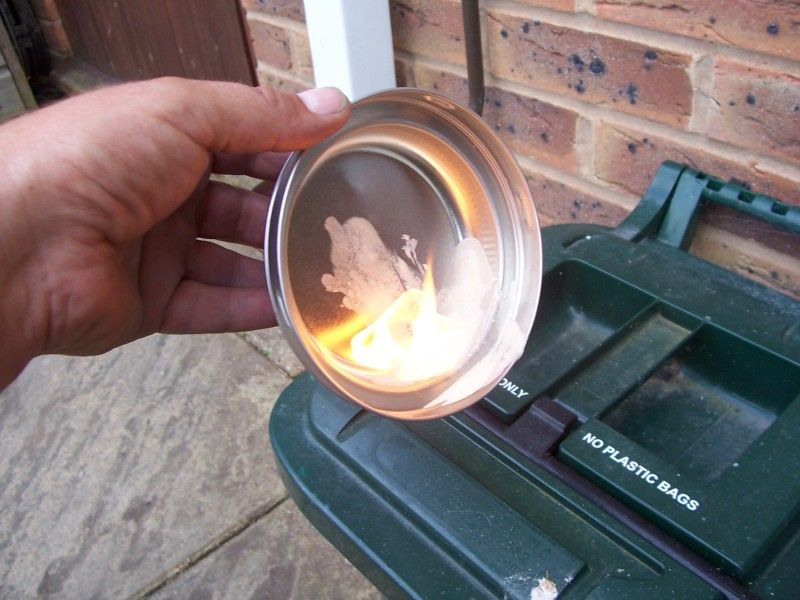

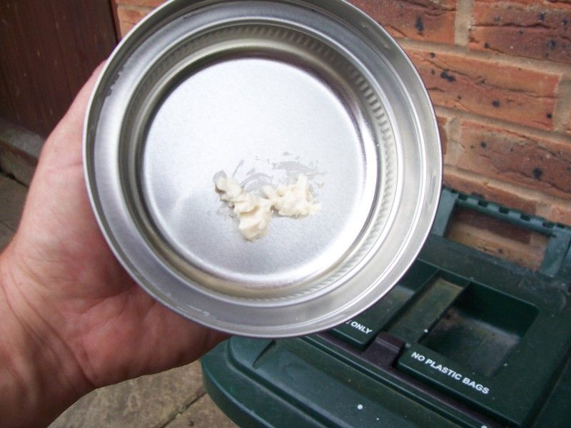

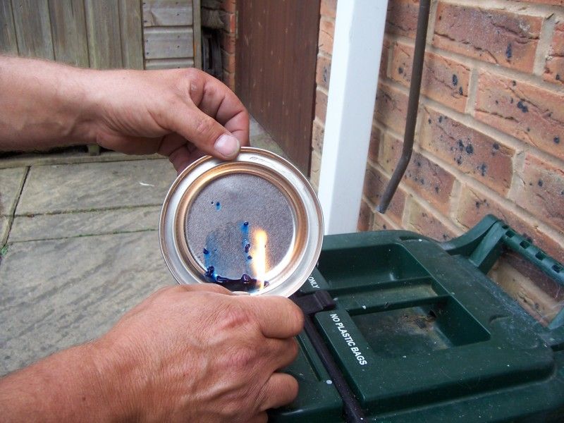

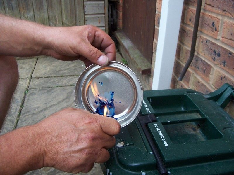

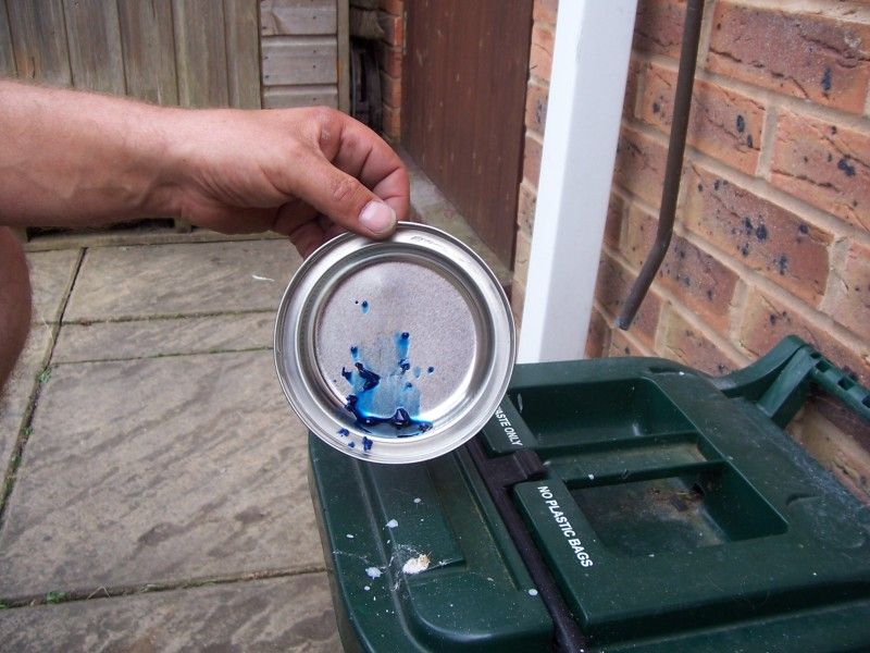

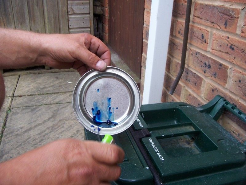

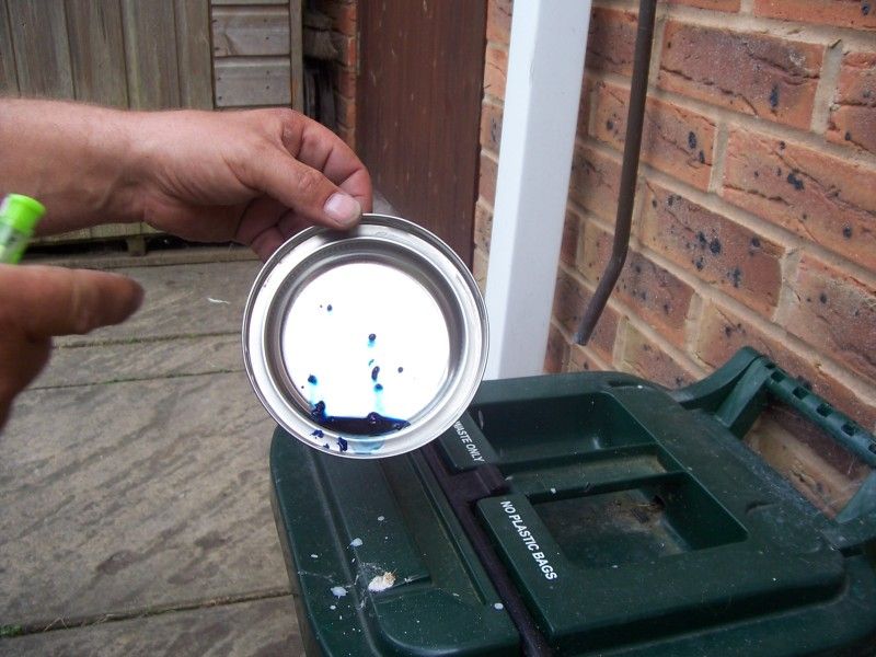

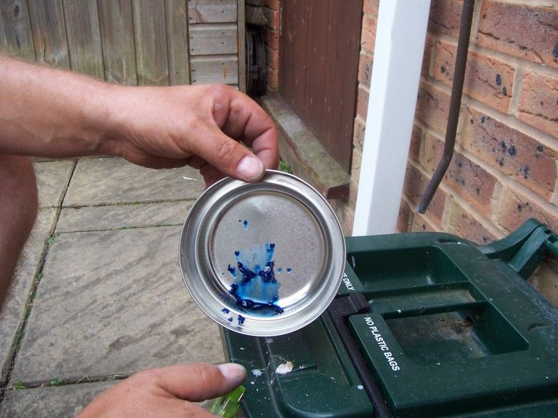

                Ok so how volatile and aggressive is the solvent in NXT2 , yes i know it has a warning of combustion on it but just HOW aggressive and combustible is it when compared to Dodo juice blue velvet. The very wax i had been using prior to NXT2 with no mineral etching.
                Lets set fire to a small amount of each and see.
                Firstly the NXT2.
                Instant combustion.
                Now tho Dodo juice Blue velvet ( my last scrapings ).
                Try as i did the Dodo would not burn and once solidified was good to use again, unlike the NXT2
                I'm not trying to stir up a hornets nest here and hope it isn't percieved that way.
                Me , i'm going to keep the heavy combustibles in the fuel tank ......certainly where my paint type is concerned.
