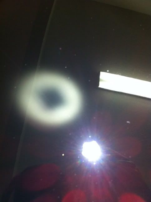

    Today I made a pass with M105 on a Lake Country Orange pad, followed up with M205 on a Lake Country White pad. The results are MUCH better than I was expecting and I'm pretty pleased thus far. However, it does look like I'm having some marring that isn't going away.
    Should I follow up with the M205 on a black finish pad? or should I follow up with an application of M80 (I love they way it finishes). Any suggestions would be great.

            From the pictures it looks like hazing. Honda paint is extremely soft so you rarely have to go as aggressive as m105. Try using a finer polish or softer pad. Keep the speed low(4-4.5") with slow arm movement and light pressure.

                            Here a few updates. The first picture is after making ~5 passes with the M205 on a LC Black pad with a speed of 4.5. Definitely an improvement.
                            This picture is on the M205/Black Pad test spot after an application of 3M Imperial Hand Glaze applied by hand. The hazing appears to be almost non existent at this point. Perhaps a finer polish should be used.
                            I'm still open to thoughts and suggestions. I'm going to make a run to O'Reilly's, Advance, and AutoZone to see what I can get my hands on.
                            Thanks for everyone's help.
