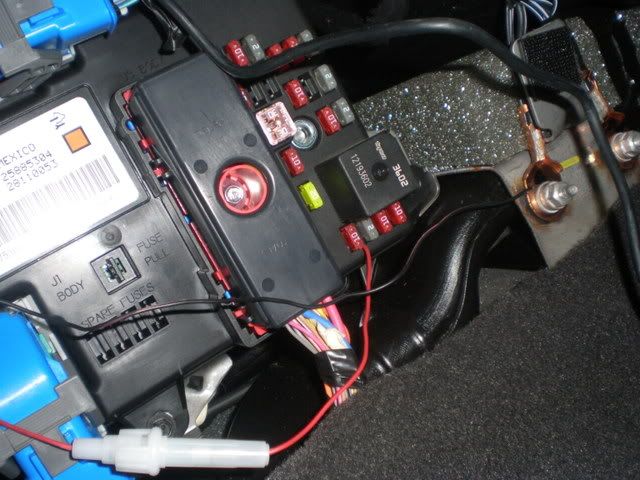

    Question 2: I'm trying to put two strips of LED. I know LEDs have polarity and have tried reversing the two ends of the wire. I put the hot in the fusebox in an spare slot, and the ground on another part of the car - no light. Hot in the spare slot and ground on negative of battery - no light. I used an ammeter to the negative of the battery - there is current. LED hooked directly to a DC battery - LED lights up. LEDs are 12V, and worked on my friend's car. Anyone know how to fix this?

    Question two though, since you have a known good LED strip, and you are connecting directly to power, I would assume it's a ground problem, maybe try a different ground, or area for a ground. It's can be very difficult to find a good ground on some newer vehicles. Also, you say you are connecting to a fuse box. Make sure you are connecting to something that has power when you need it, not just key on, for instance. And, you say you are putting hot wire in SPARE slot of fuse box, if you are going by your manual, spare is just an extra fuse holder, no power to it. Hope that helps, best I can do without being there and seeing the setup.

      Check the ground. Sometimes they aren't as good as we think they are.

        I tried ground on the inside of the hood as well, but that didn't work either... And I tried hooking one end of the LED to the foglight fuse, and it didn't work either even when I turned on my foglights.
          What I did was took out a fuse, put the wire in the fuse spot and then put the fuse back it. Obviously you want to make sure whatever slot you put it in, its a always running fuse. Then the ground wire I put on the top of the strut tower. On my car there is a bolt running up to attach ground wires.
          sorry in bit of a hurry.
          Edit, if youre running it inside of the car there should still be a ground wire bolt, I will try to take a picture of how I have mine set up.
            Re: lightbulb and LED woes
            Here is how mine is set up.
              Does it matter if there are two wires on both ends of that 10A fuse?

                  When putting any aftermarket electronics in your vehicle, connected to a factory fuse, be careful which system you are splicing into. If it causes trouble down the road it can void factory warranties. Especially cadillacs, they can be electrical nightmares!
                    If I splice into something like the radio or foglight fuse, if troubles do occur, would swapping into a new fuse simply solve the problem?

                        Not neccasarily, if the circuit you add causes an overload, for instance, it could burn out wiring, modules etc. I was not trying to scare you, just giving you a heads up as I have been a dealership technician for over eight years, and have seen my share of problems created by "splicing" in a non-factory circuit. Fuses are designed to carry the load of the intended circuit, not the addition of others.
