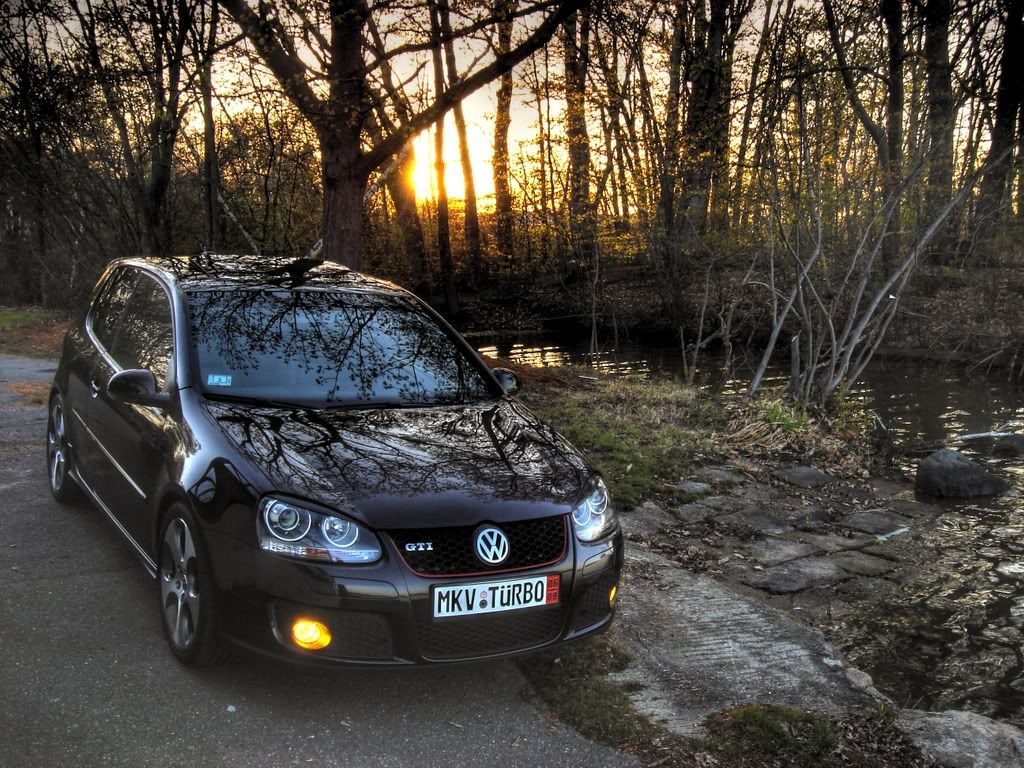

    I take all the waxes off by hand, just easier to apply quickly with the DA polisher. Now the VW has very hard paint and as you all know black paint shows everything. Scratches aren't there... swirls are light, but I am anal enough that I want the paint perfect. What kind/type of pad, polish, and treatment will take away the very fine scratches? Also, it has multiple layers of wax on it as I am always adding before it wears off completely... do I need to strip it down (wax) before hitting the polishing step? ColorX and NXT 2.0 does a fantastic job as it covers blemishes nicely but after a week or so its still smooth but the fine scratches come back. Again I am a perfectionist so the swirls are very light, I'm probably making it sound worse than it is. But I could use some professional advice for a driveway detailer!
    Also, what can I hit the front headlights (plastic) with to take away any road damage? This car is my daily driver and it takes a beating on the front end living in Boston.
    Thanks in advance for any advice you can all offer! Here's a pic to give you an idea... no detail on the paint, but I just want to show the patient! Although I found 2 paint shots... but as you can see, the scratches didn't come out in the pics. And the pics were taken after a full detail anyways!
    Capturing fine swirls is very difficult but here's a how-to article that might help...
    How to capture pictures of swirls in your car's paint
