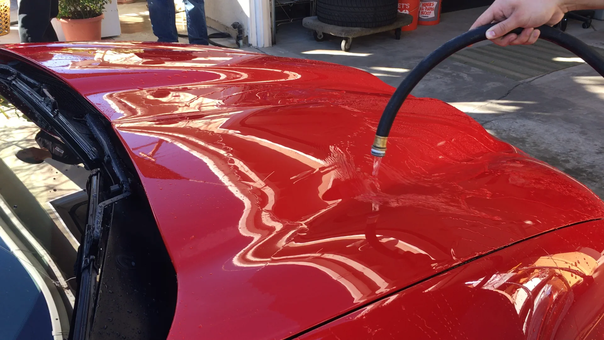

First thing I did was decon the paint with ironx. I followed this write up by Mike Phillips which indicates to apply ironx to the paint prior to washing. Saves a little time this way instead of washing, decon and rinsing. I gave it a go and it worked out great.
I ended up using Hyper Wash in an MTM foam cannon. I used a little over 2 oz's. I also used 1 oz in a bucket and did a 2 bucket wash as well while the foam was still on the paint.
