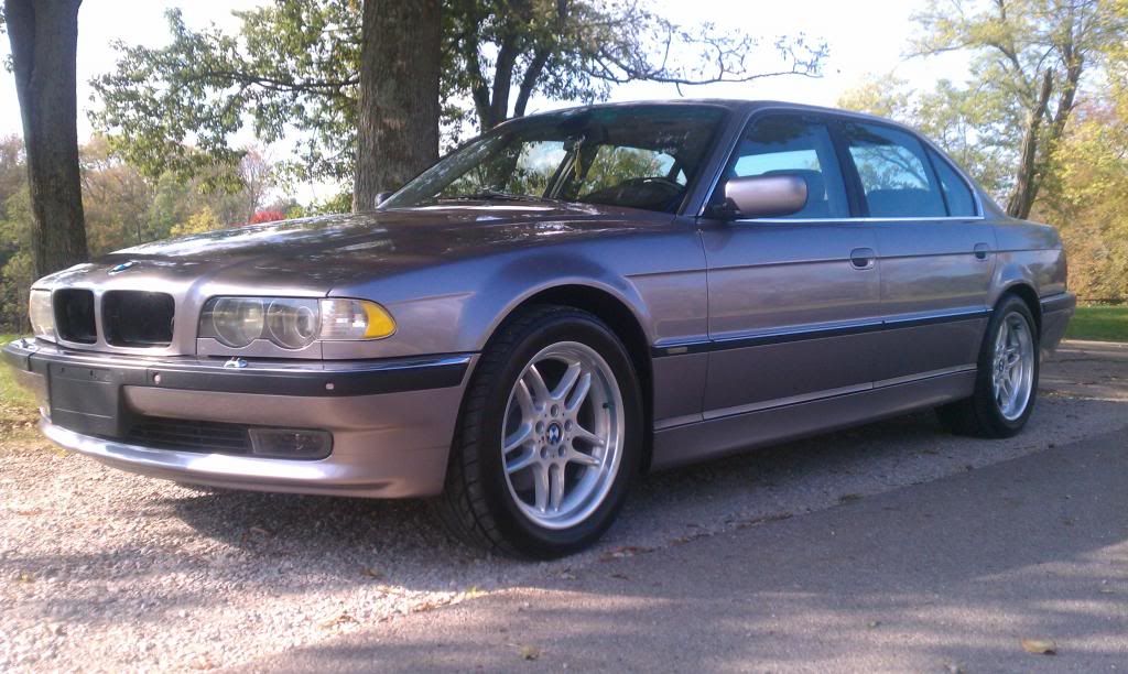

    I picked this absolutely neglected E38 up a few weeks ago. 80k actual miles. runs and drives great. Just needed some TLC. Paint needed restoration, wheels had baked on and etched in brake dust, head light and tail light lenses needing restored, interior was horrendous. After many long nights with my amateur detail, she is finally something that I am proud to drive.

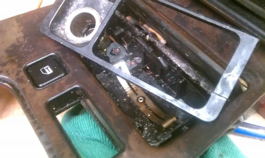

    Interior was a complete scrub down. Pulled as many pieces as I could to flush with hot water. Lots of sticky soda in the console pieces.

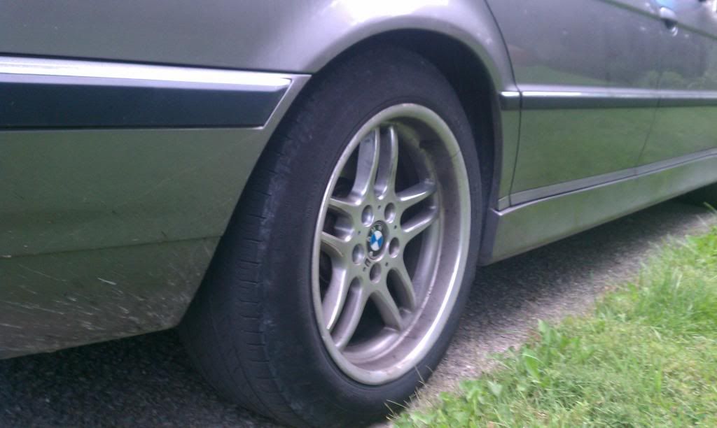

    -wheels- wheel cleaner x 2, 2000 wet sand, M205 polish

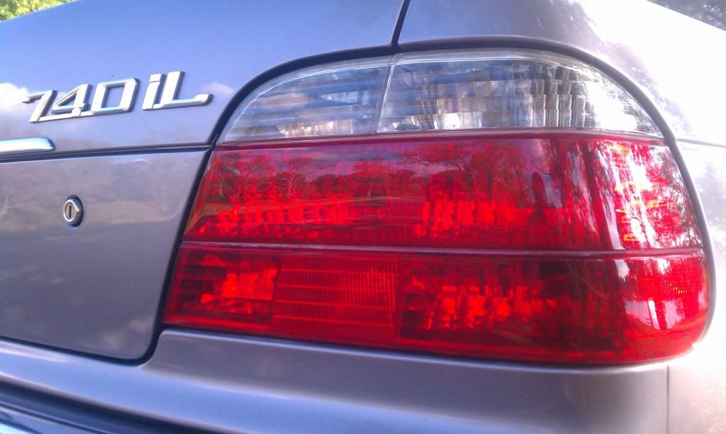

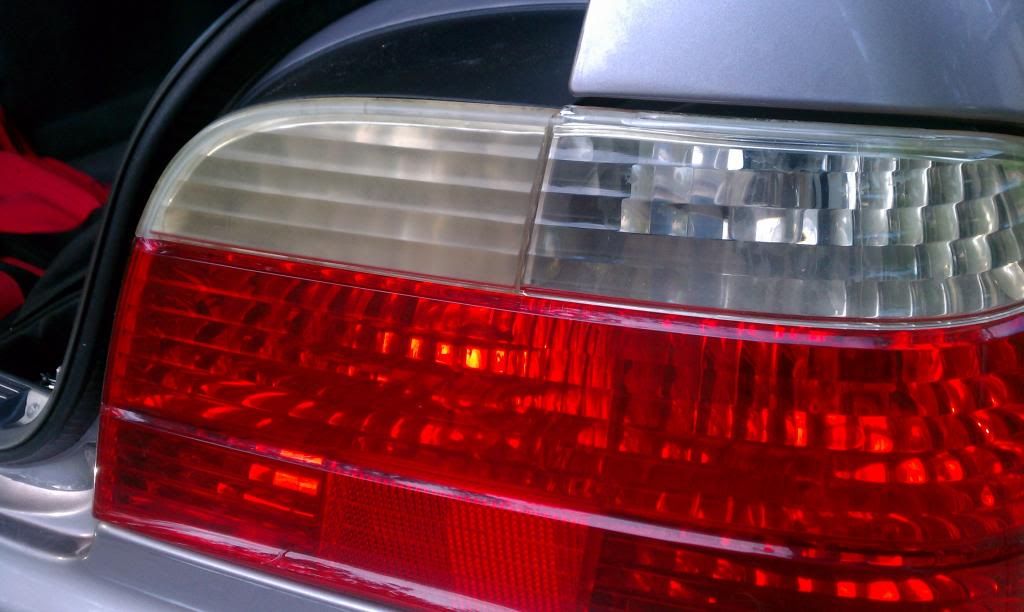

    -head and tail light lenses- wet sand 1000,1500,2000. M105, M205 polish, M27 wax

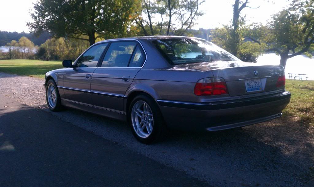

    -paint- wash, clay, wash, M205 with yellow pad, M27 wax.
    It will be a daily driver.

    What an amazing turn around! That poor car was trashed and now it looks like it's been babied it's whole life - nice work! Are we seeing a different tread pattern on the tires in the "after" shots? Those old tires really needed to go.
      Re: 2000 BME 740iL
      Thanks. Tires were swapped with new Nitto 555...255/45 front; 275/40 rear. They fill the wheels a lot nice than the old, dry rotted 235s did.
