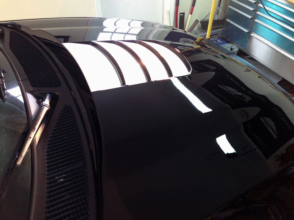

    2003 F150 Two-Tone H-D with minimal correction & gloss enhancement.
    This beautiful truck is on Grand Cayman and it was a pleasure to detail.
    Wash: Two-Bucket method wash with Megs grit guards & wool mitt.
    Decon: Nanoskin AUTOSCRUB Speedy Prep Sponge Fine w/ONR lube.
    Paint correction: Rupes 21 w/Megs M101 & Megs 5" microfiber discs,
    Gloss Enhancement: Griots 6" DA with M205 w/LC white 5" flat pads,
    Engine: Cleaned w/Mothers billet Polish & Megs Plastic & Vinyl Coating.
    Coating Prep: CarPro Eraser wipe-down on all polished paint surfaces.
    Coating: Applied two coats of CQuartz Finest on all the polished paint.
    BEFORE
    AFTER
    NOTE: This is the first time I've done a "mobile" detail. Minimal correction with minor swirls & scratches.
    I was surprised to find that even good quality microfiber towels were causing fine scratches in his hood.
    It was necessary to use a very high quality borderless microfiber towels to remove the polish for inspection.
