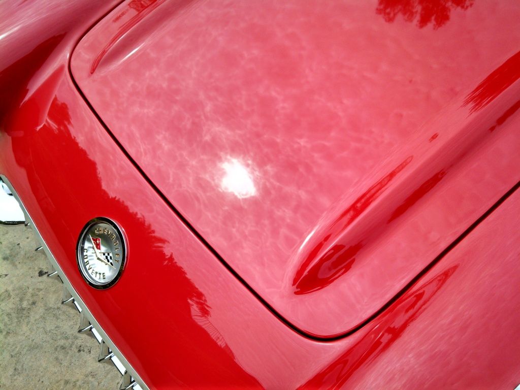

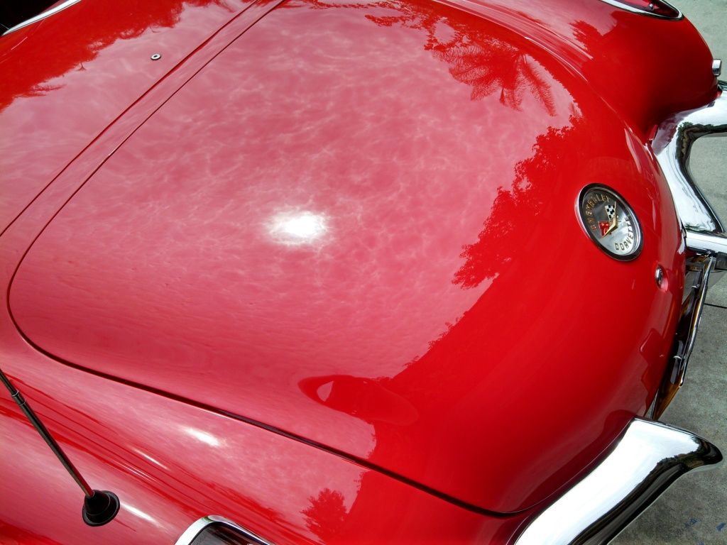

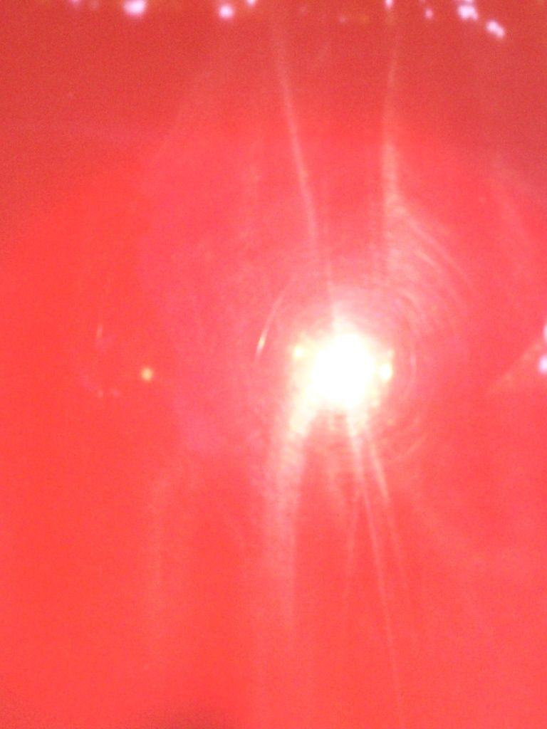

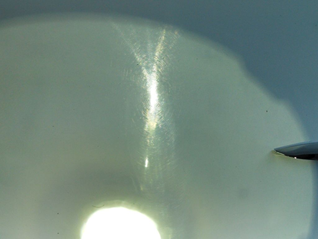

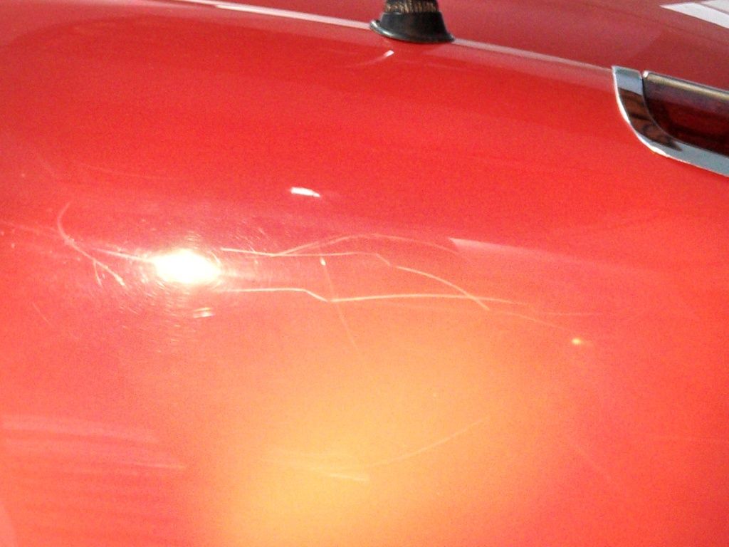

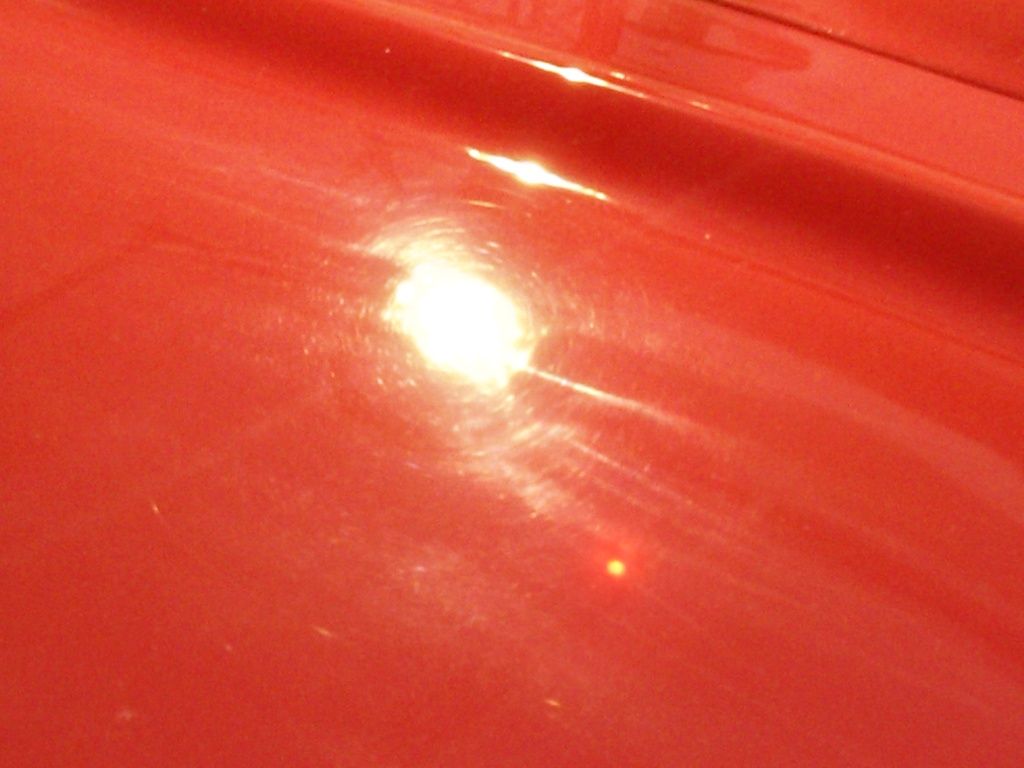

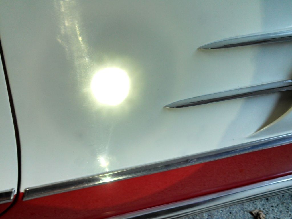

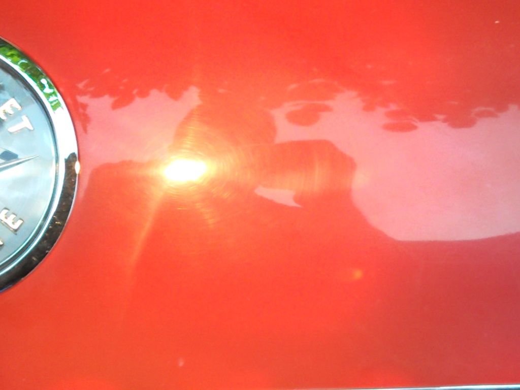

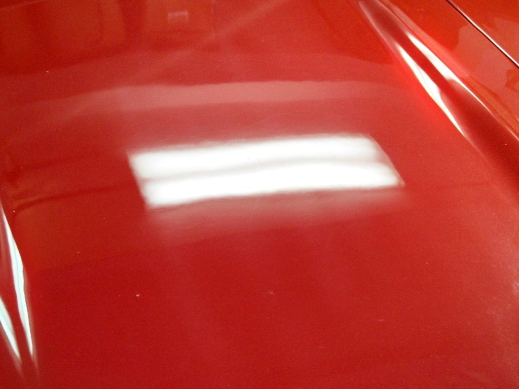

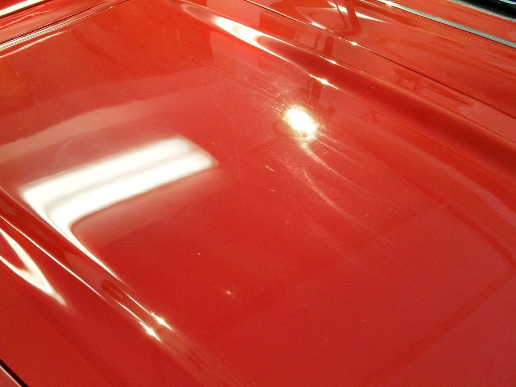

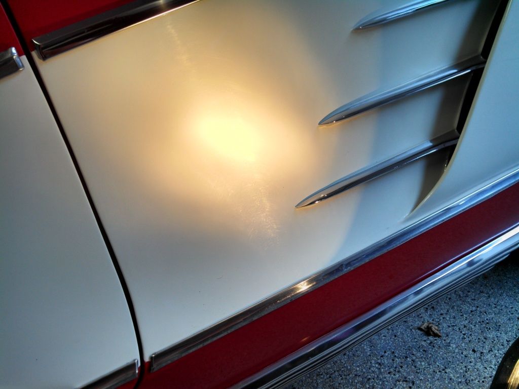

    Orange peel in a few spots, sanding marks left on the hood and the white? COMPLETELY scratched up with sanding marks. Why? Because the panels are CONCAVE and hide defects very well by deflecting light away from your eyes.
    Geesh! Can one body shop do a good job? I've never seen one yet.
    Waterless Washed
    Clayed
    M105
    DeWalt Rotary
    Wool Pad

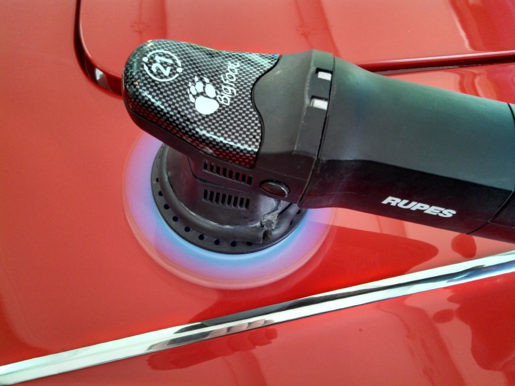

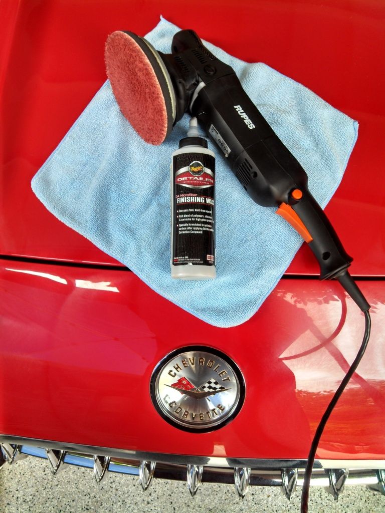

    Rupes 21
    Meguiar's MF Finishing Pad
    Meguiar's D301 Finishing Wax

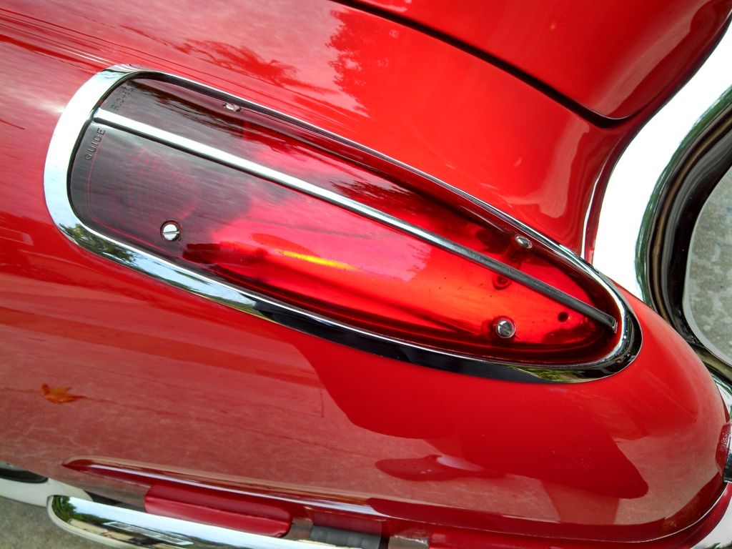

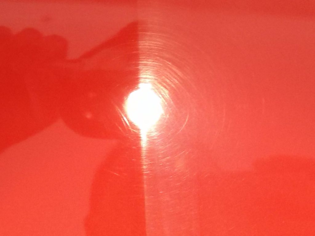

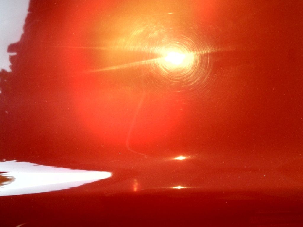

    Lots of marring too

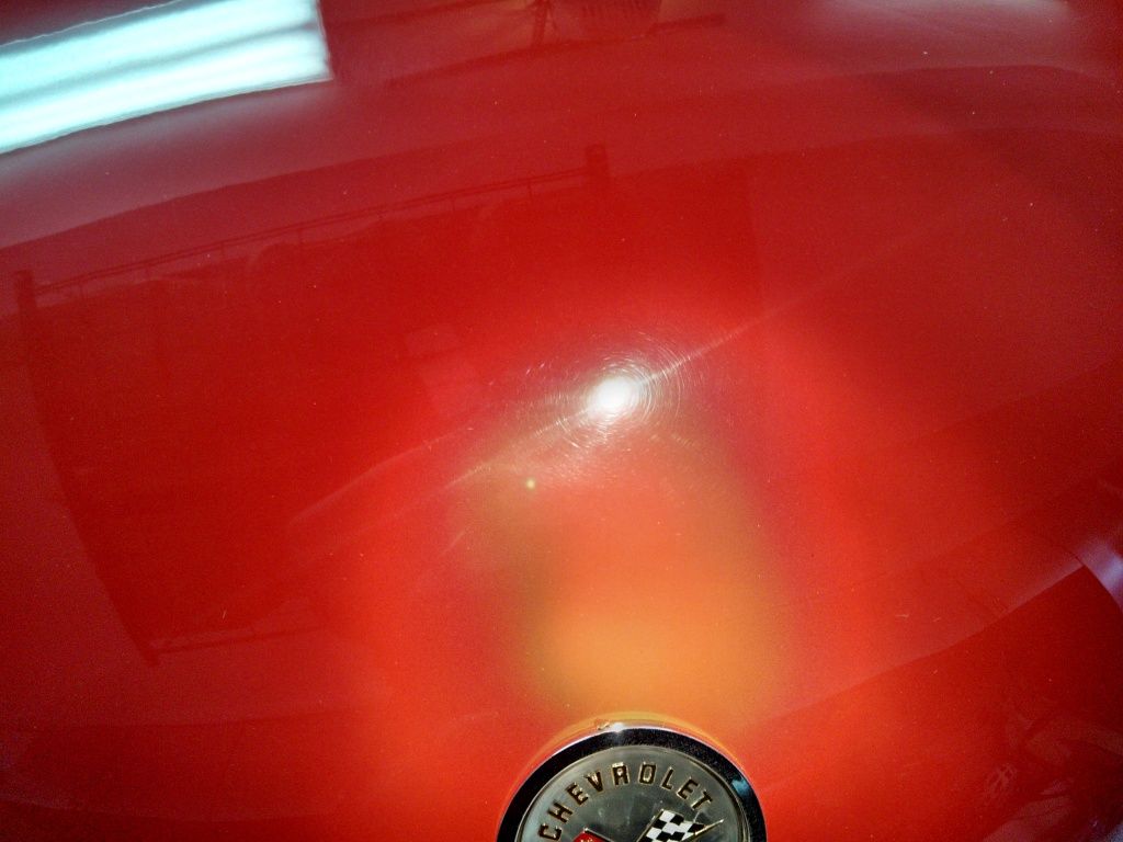

    Buffer trails
    Driver rear marks
    Buffer trails on the all over the trunk
    No shine and sooooo scratched up
    Orange peal too

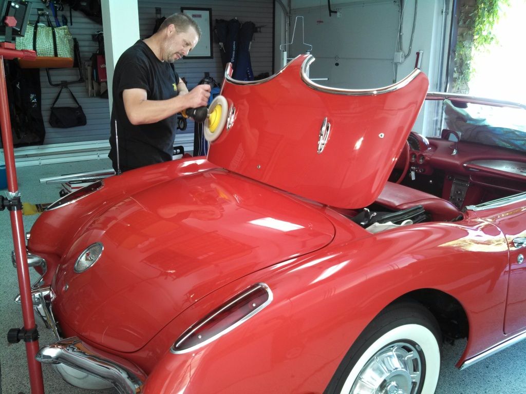

    On to the work

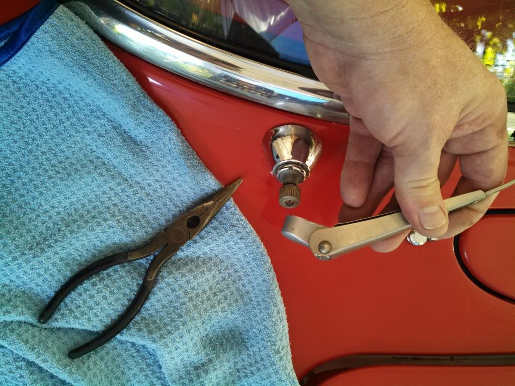

    Remove these flimsy wiper arms. Your rotary will break these off in a heart beat

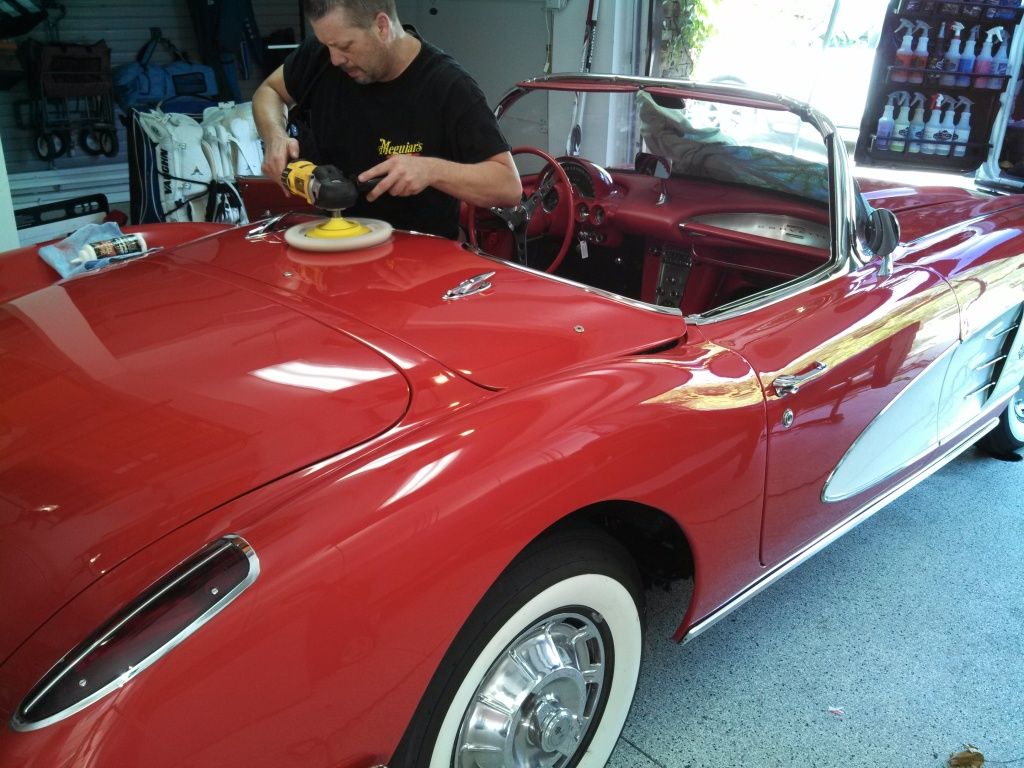

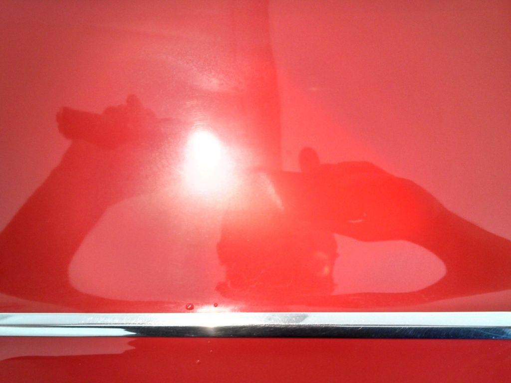

    MF Pad didn't work to well so onto the Wool and Rotary

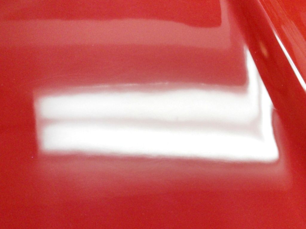

    There we go. Much better results with the Wool and Rotary

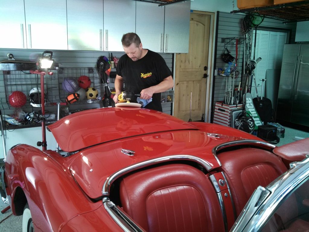

    ACTION SHOT!

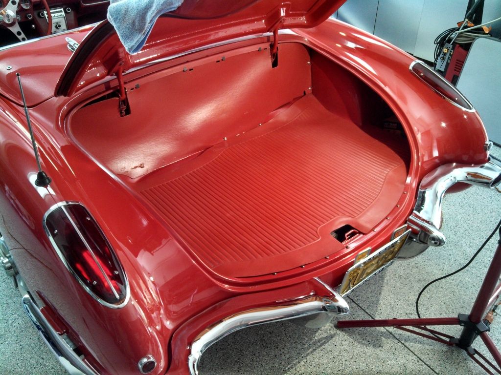

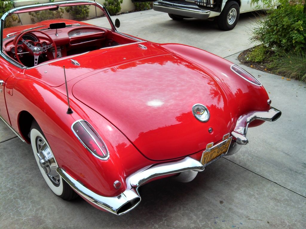

    This little gem has some trunk and no junk
    To elevate the trunk past the lic. plate I put a 3 gal bucket under it.

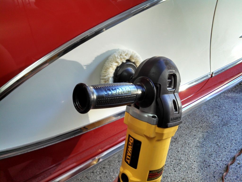

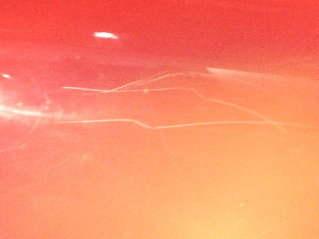

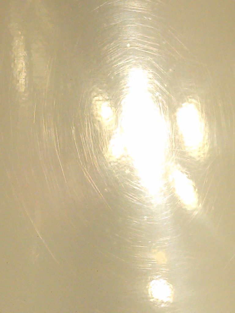

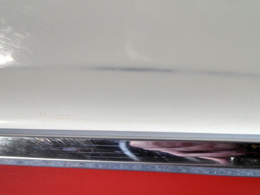

    on to the hard a** white paint
    3" pad to the rescue. About 3 polishes needed to correct these deep scratches

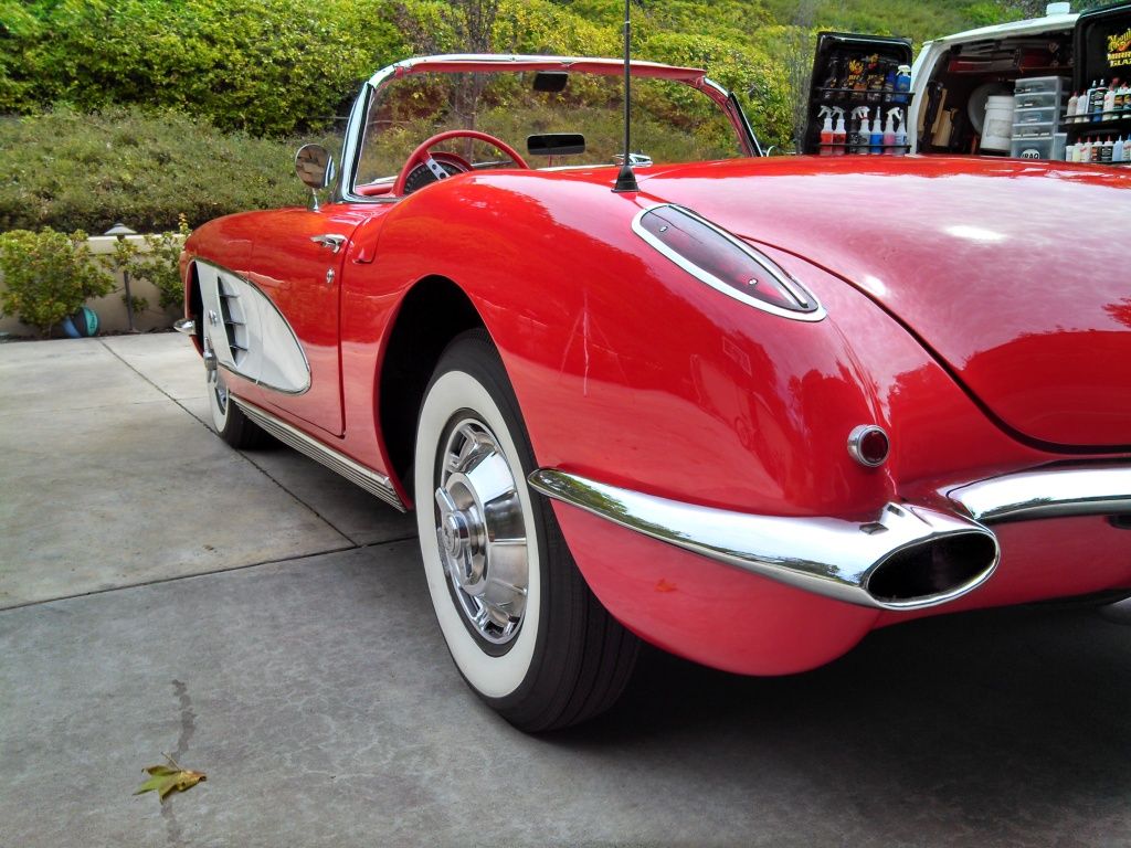

    When I got to the drivers side I found this. A BURN through! Nice body shop work at it's finest!!!!!!!!
    I got the customer to show her. I called it a day after this.

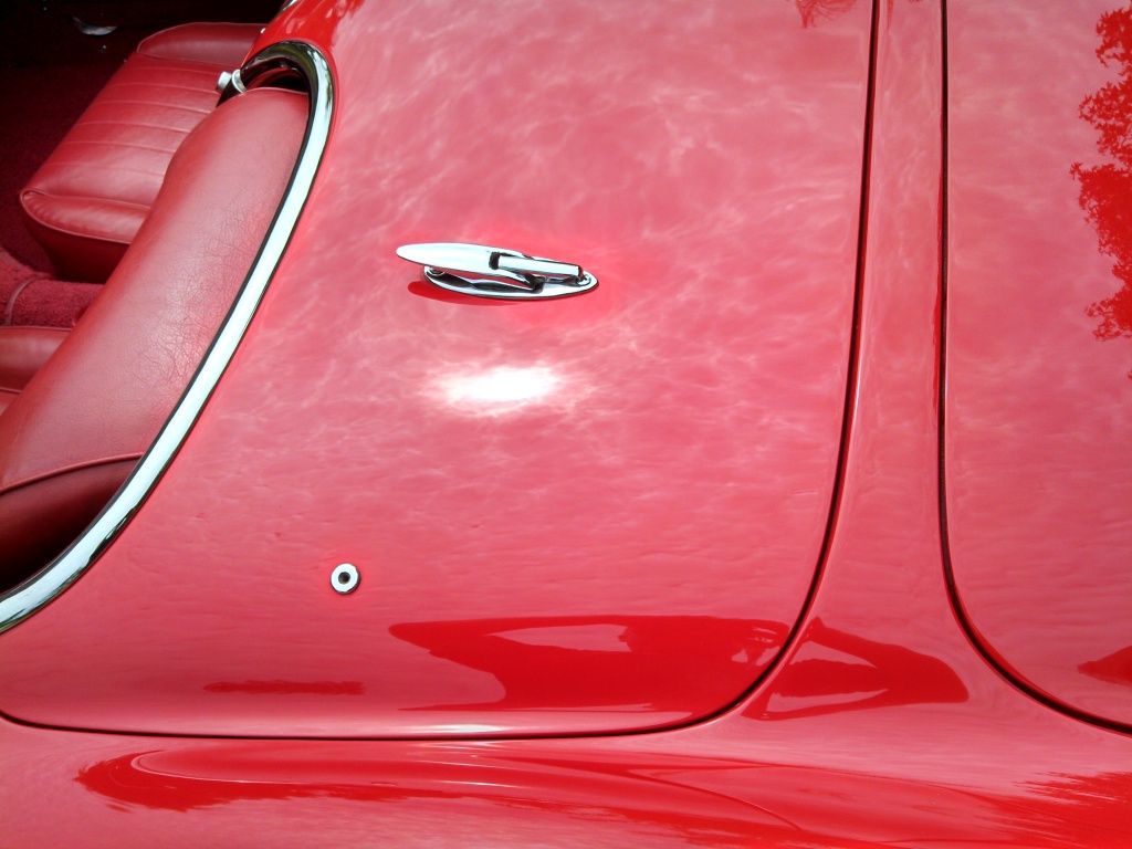

    Next day it was onto waxing/polishing

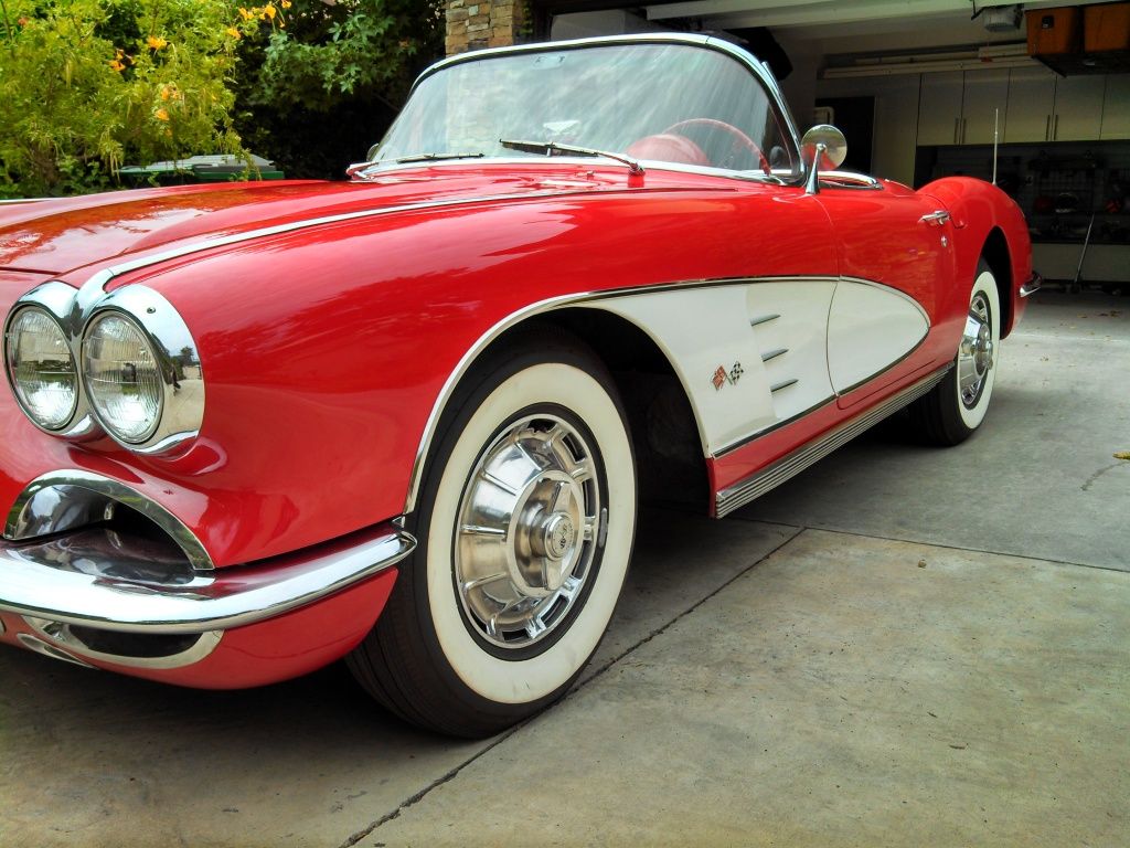

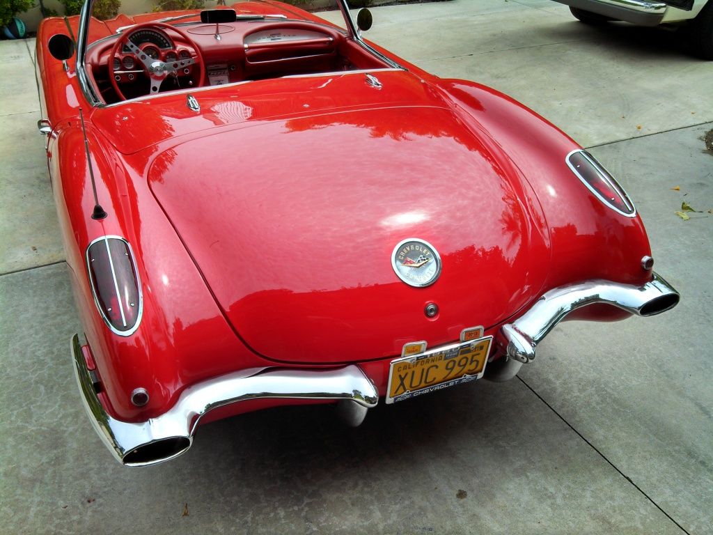

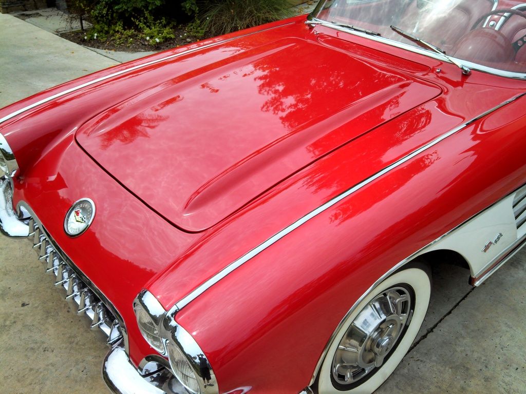

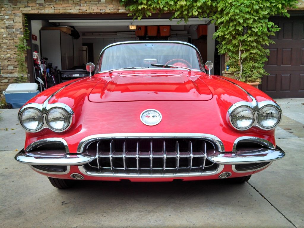

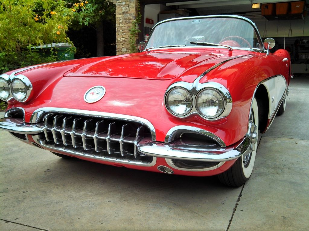

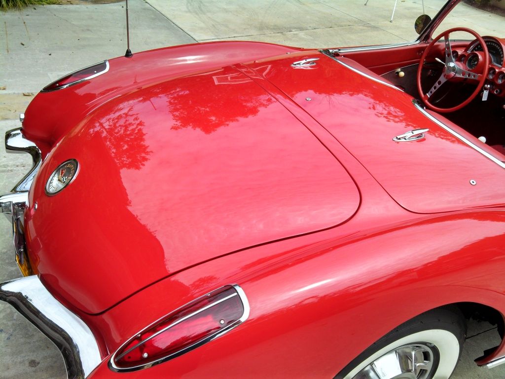

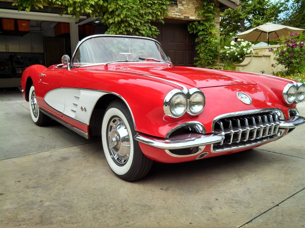

    DONE!

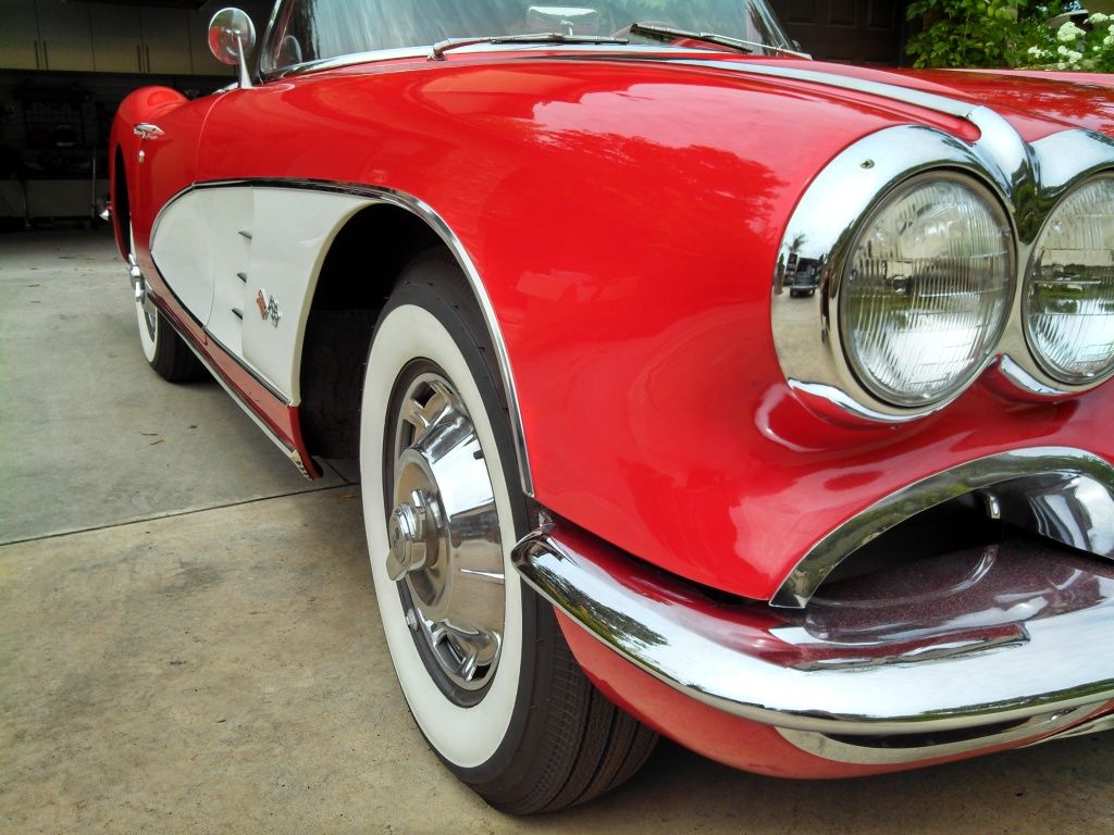

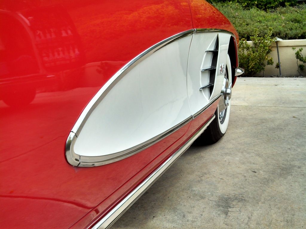

    That's soooooo much better!
    Concave doesn't show the shine either!

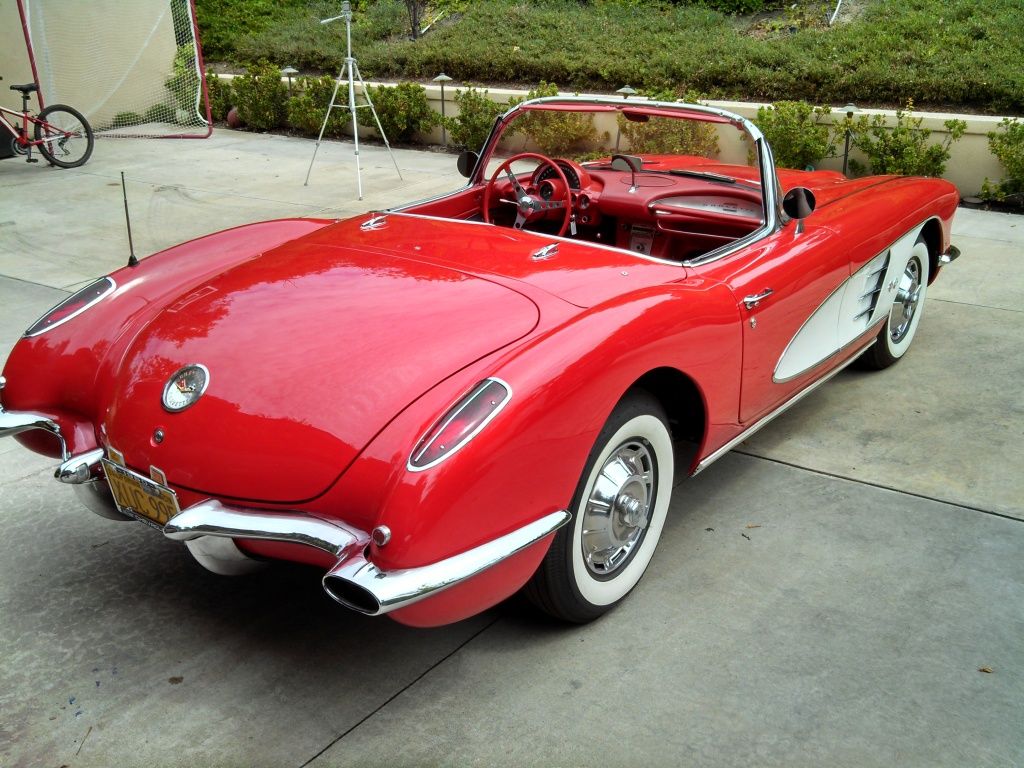

    I love a butt shot! Sexy, Sexy rear end on this beauty!

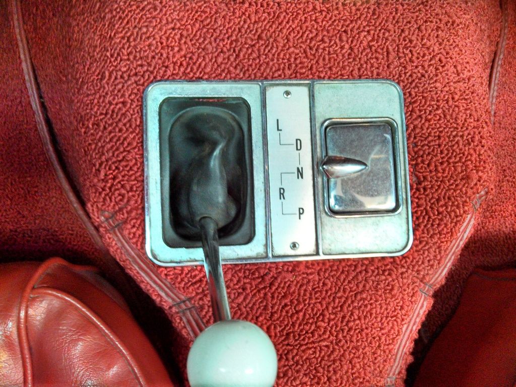

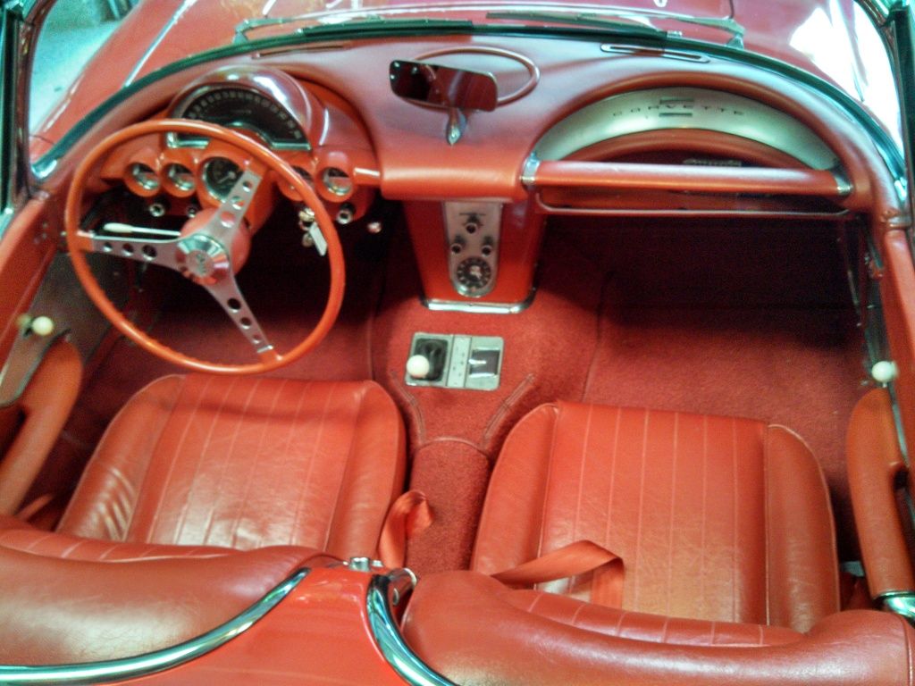

    I love this cockpit!
    My customer said this was a rare version due to the Automatic Tranny and Power Windows

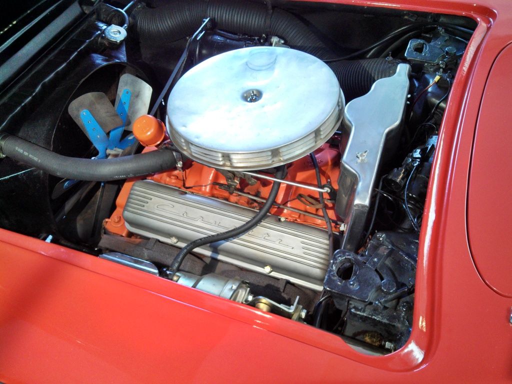

    I had to post the engine too

    Re: "Little Red Corvette" '56 Vette Detailed BY M
    Beautiful job. But.......it looks more like a 1960 Corvette rather than a '56.
      ^^ Check the Lic. Plate, it's a '56.
      DetailingByM.com
        That is not a 56 Vette. 56/57 had single headlights, that is a 1960 Vette. The plate even says 1960.
        BTW, very nice work, it turned out very nice!
        -Bob
          I think it's a '60 too. Googed and didn't see the double lights of the fins behind the front wheels.
          But the customer said it was a '56 and the plate says both!
          I forgot to check and the customer never got back to me when I was writing this post.
          DetailingByM.com
            It would be interesting if someone ran that plate to see what vehicles it had been on. Perhaps he had a 1956 vette at one time and then transferred the plate to the new car. Whatever it is, you did some really great work on a classic. Cool cars are more fun to work on!
