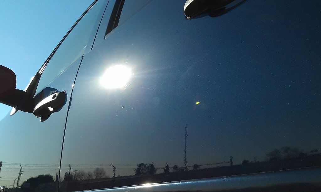

    This truck took everything I had to get it corrected. The paint was the hardest I've come across.
    Literally speed 6, MF cutting pad, M105 and full pressure was the only way to correct this paint.
    13 hrs of polishing and it was done, well the outside was.

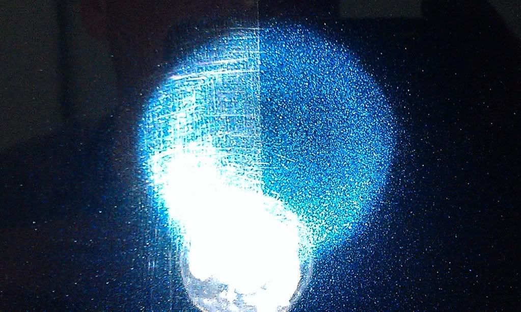

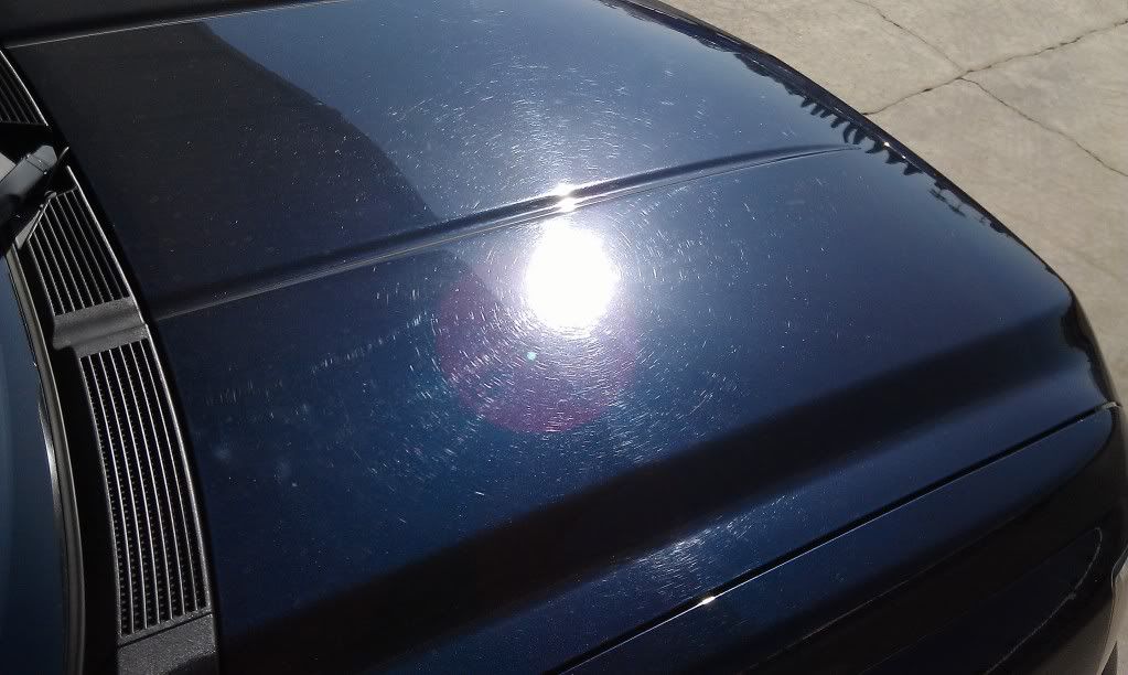

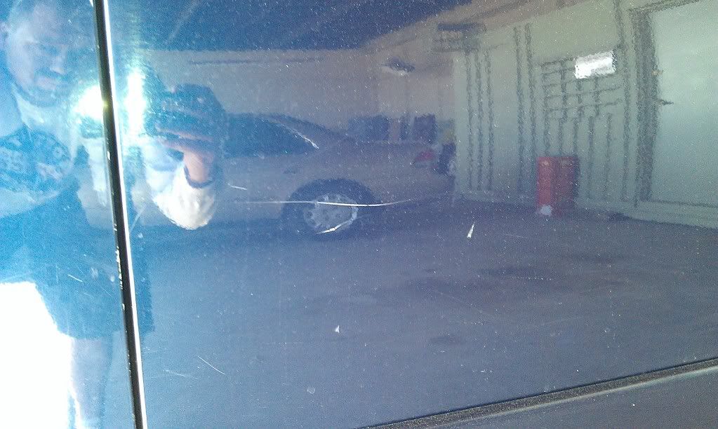

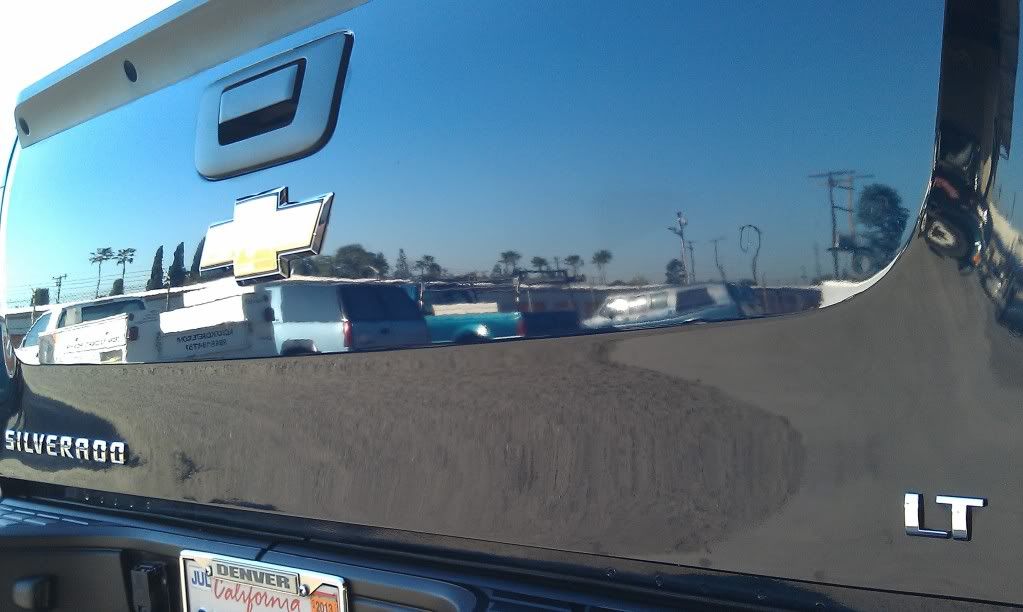

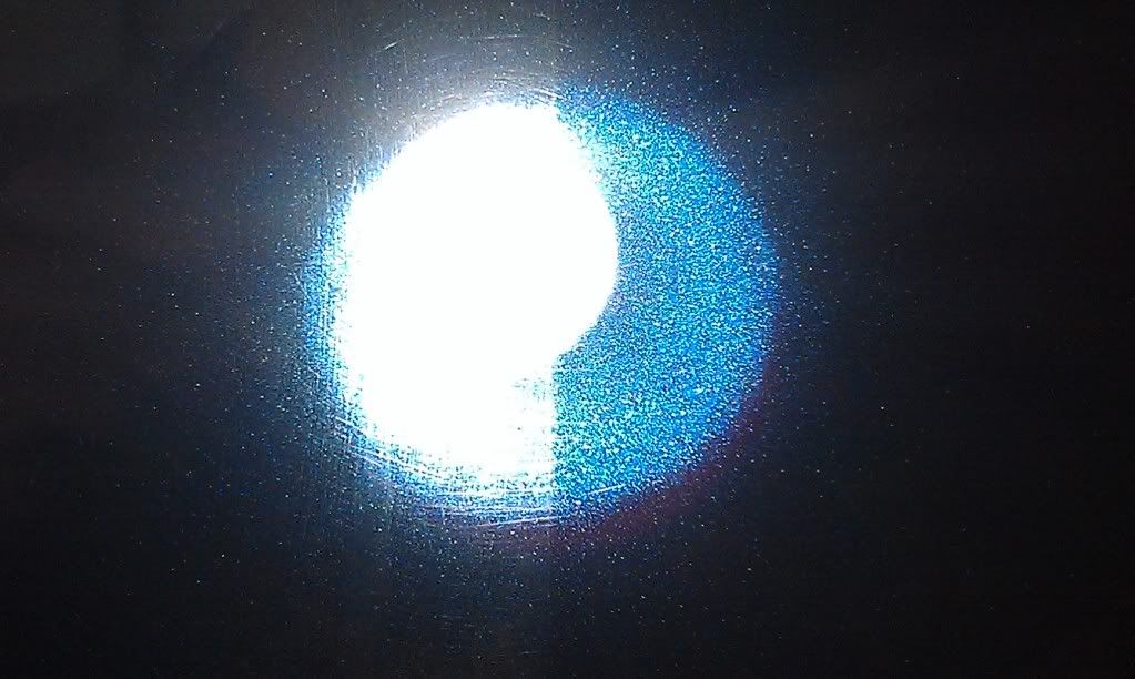

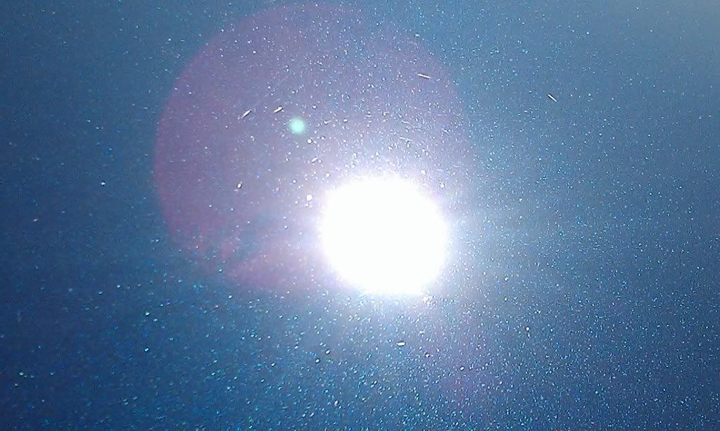

    Here's the before pics with all the scratches that were all over every inch of this truck.

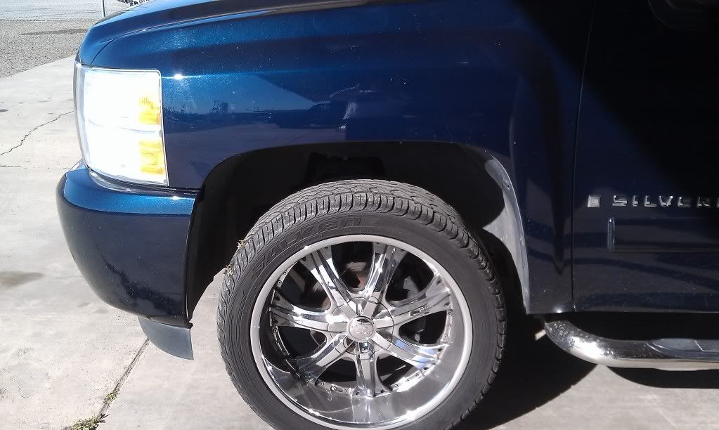

    Here's just a shot of the dirty rim
    Some scratches
    50/50 shot
    That's better!

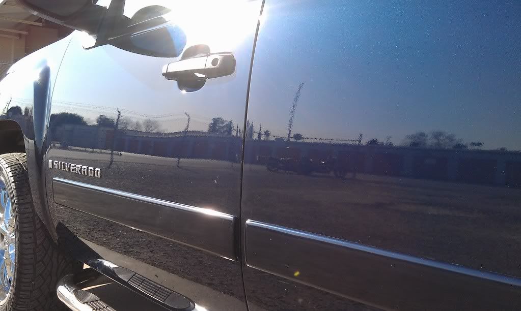

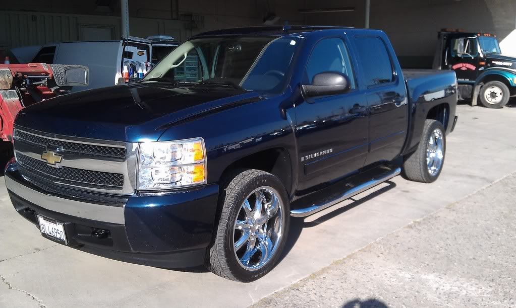

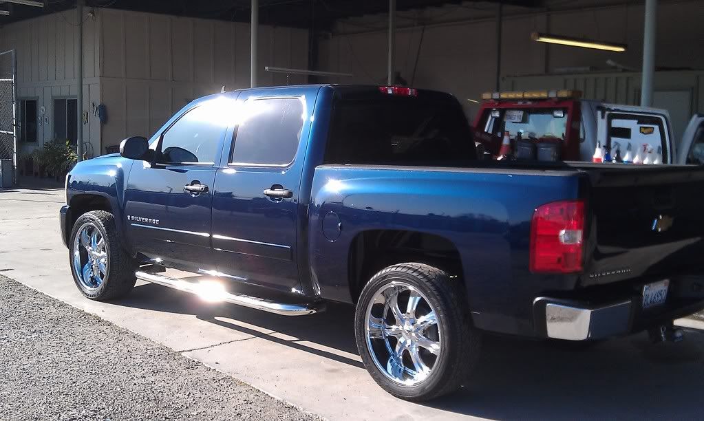

    Here it is all done and shine

        Looks like there's still a few RIDS left, but big improvement..
          Thanks and yes there was some RIDS left, also this truck had alot of chips in the lowers. I recommended close to full correction due to that fact. It's in so much better shape then it was and my customer was very happy.

                Dealing with paint that is that crazy hard is a real pain in the neck, and a heck of a challenge. The black 3 Series BMW we wrote about in this thread had similar paint, and even M105 on the DAMF system did very, very little to improve it. A wool pad on the rotary quickly removed the swirls but also created its own fresh set of marks, but a foam cutting pad on the rotary was literally magic. That BMW was knocked out in about 6 hours that way, but anything else would have been easily double that time, if not triple. And even though at some point you feel like throwing a brick at the stupid vehicle for being so obstinate, there is no greater feeling of satisfaction than making the darn thing finally submit to your will and force a proper shine back out of it.
                Sometimes you just gotta do what you gotta do to get the job done! In this case, given the horrid mess you started with and the final result, we'd say you did a killer job. A couple of RIDS? Hey, on a truck with plenty of stone chips and other scrapes, and that is most definitely NOT a show vehicle, big whoop (and no, Davey, we are NOT picking on you for your comment about the RIDS - honest!!). To take paint that hard, with that level of defects as a starting point on a vehicle that big and end up with money like this:
                Awesome. This shot really shows off the depth and gloss of the paint now. The highlights over the wheel arches and that almost opalescent look to it is just killer. Love it!!
