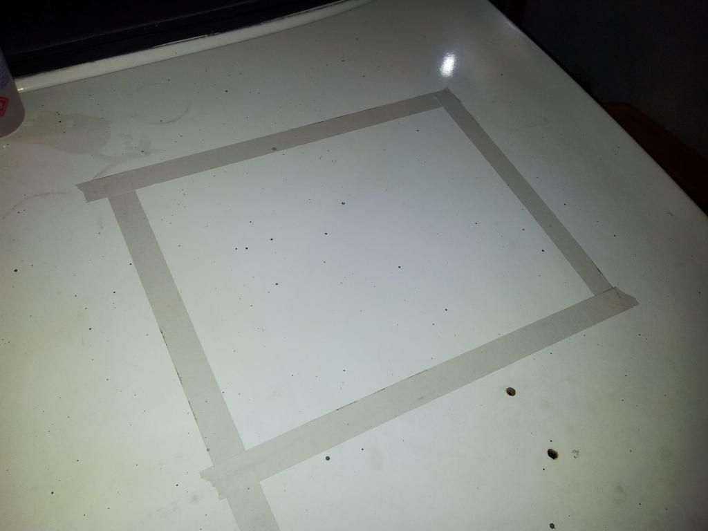

    My 2002 was repainted by the previous owner from its original colorado orange to this chamonix white color with the worst technique and care I've seen. It was then abandoned 12 years outside in the sun and rain (partially below a tree as well). The finish is shameful to say the least.
    So I decided to sand the finish with 1000 and 2000 grit sand paper, then use the Meguiar's DAMF system and the results are better than I expected! I sanded with a lot of force and still I could see a lot of orange peel but what the hell it looks 110% better.
    Let me know what you think.

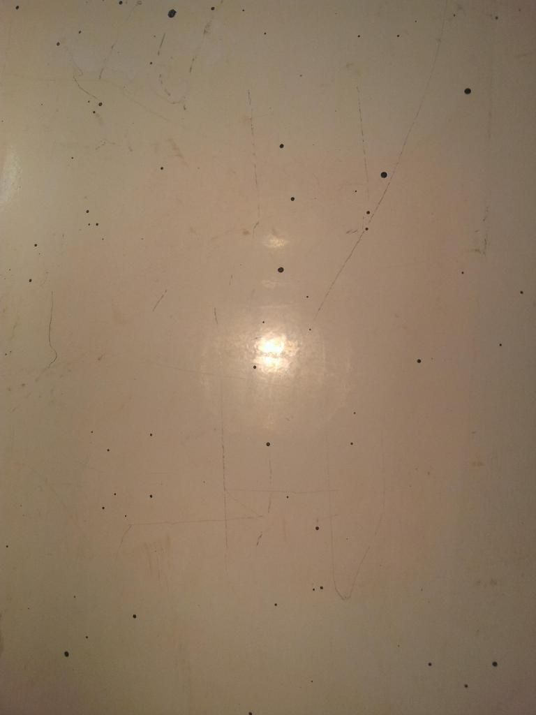

    This is how it was: (The green specks is industrial paint that dripped from the roof....not a very careful painter).

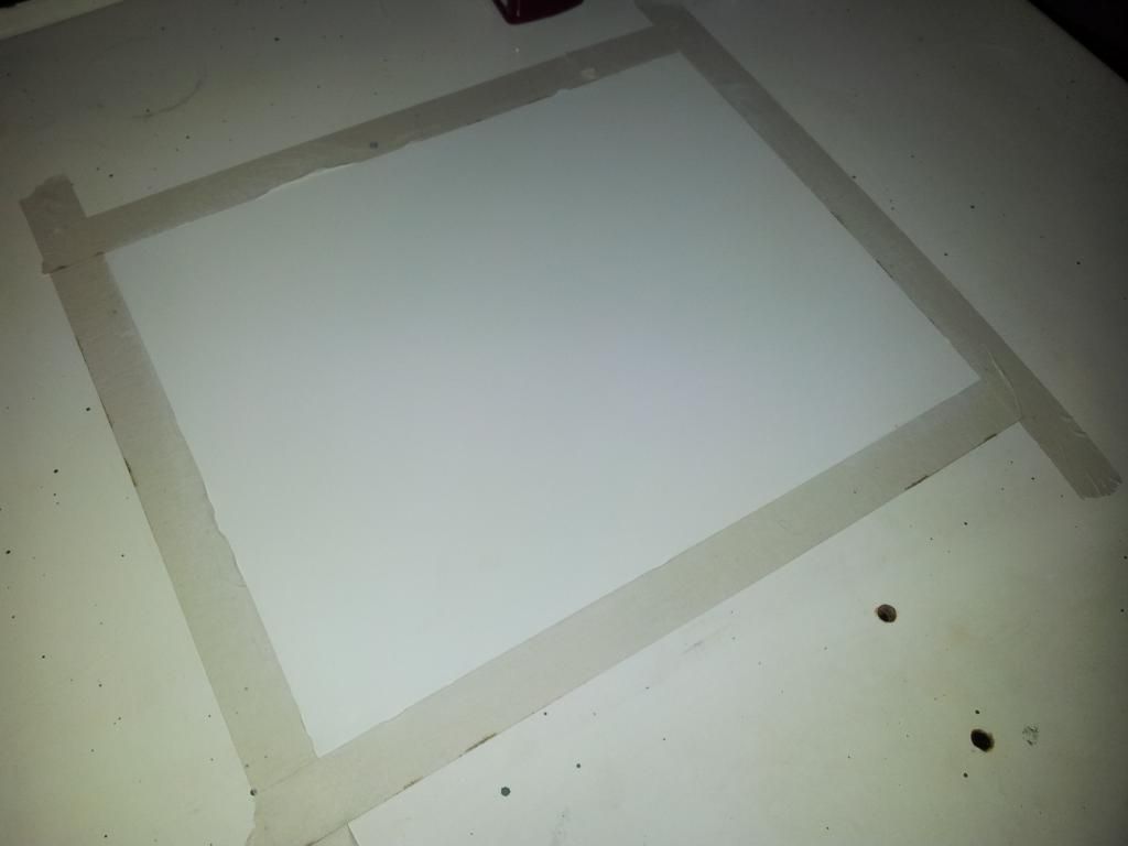

    Removing the paint spots:

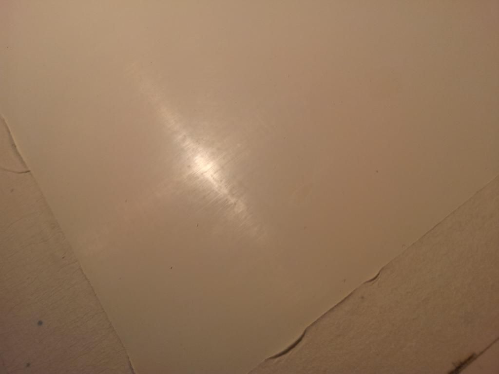

    Clayed:

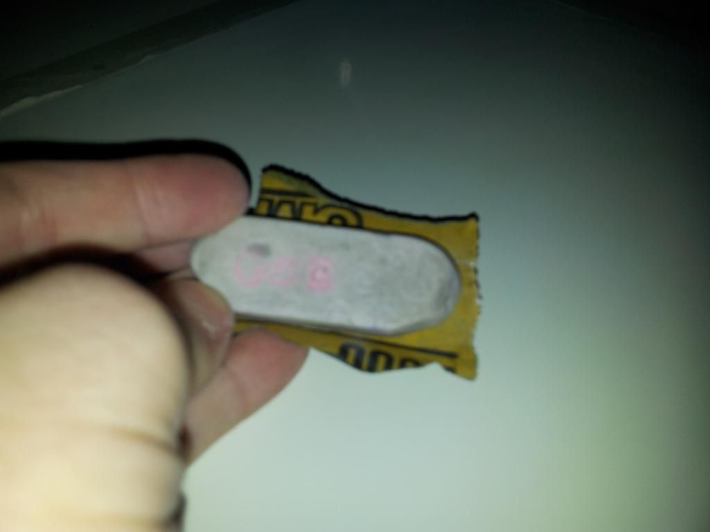

    My super expensive super effective sanding block (don't kill me):

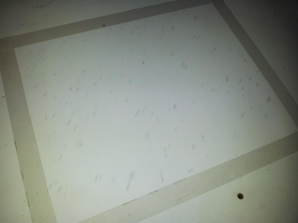

    Sanded: (1000 then 2000)
    So this is how it looked:

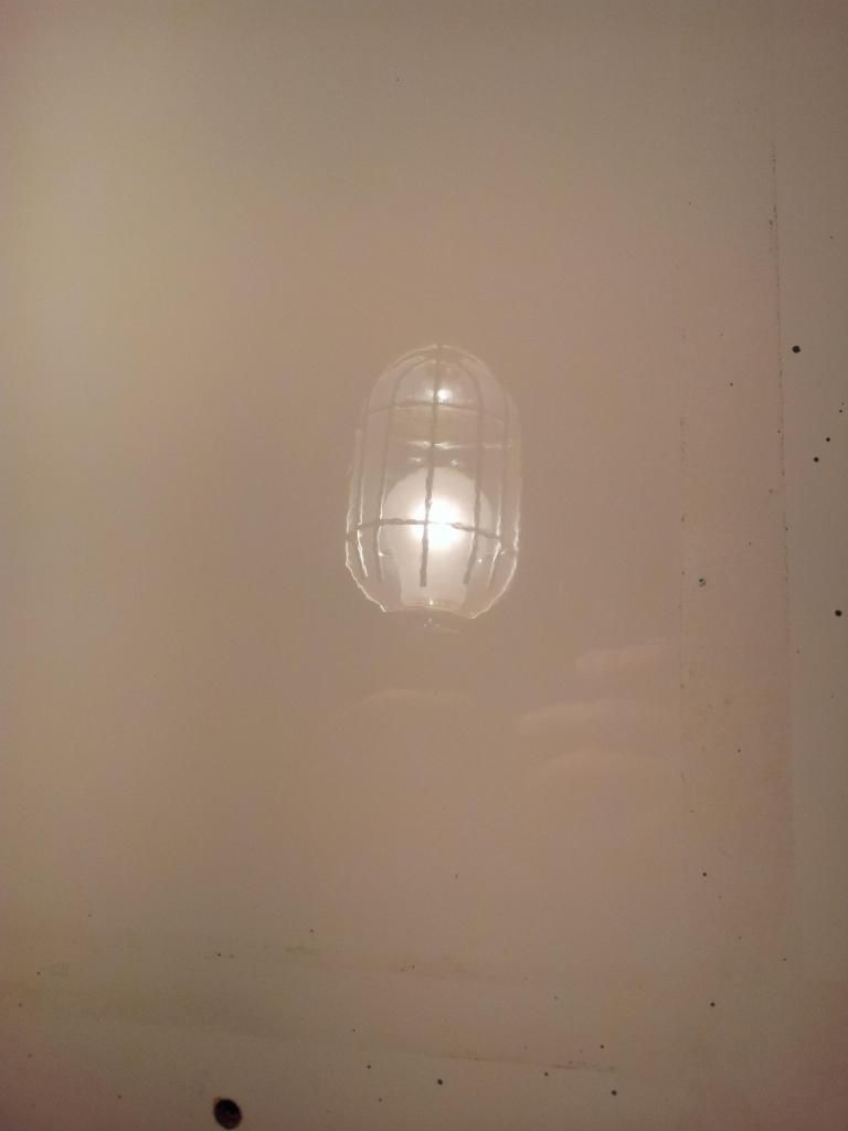

    This is how it looks now: (Far from perfect but so so much better than before I could have gone much further though but didn't deserve the time on a paintjob I'm replacing).
