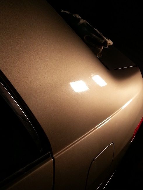

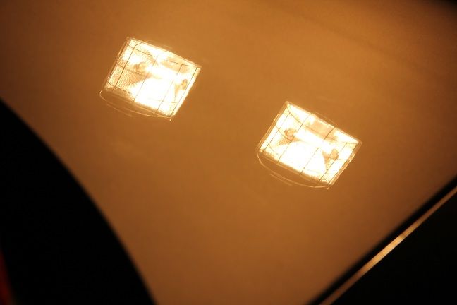

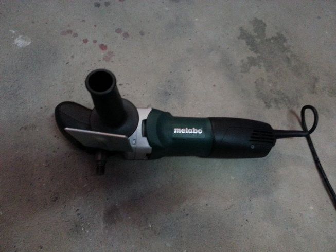

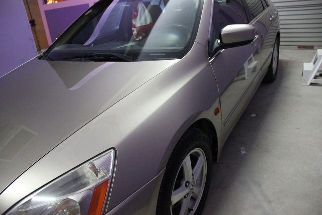

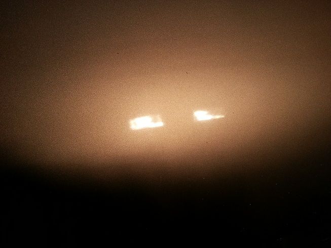

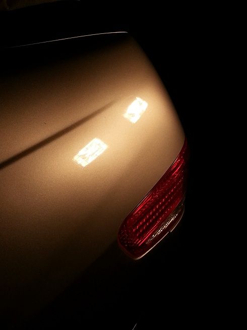

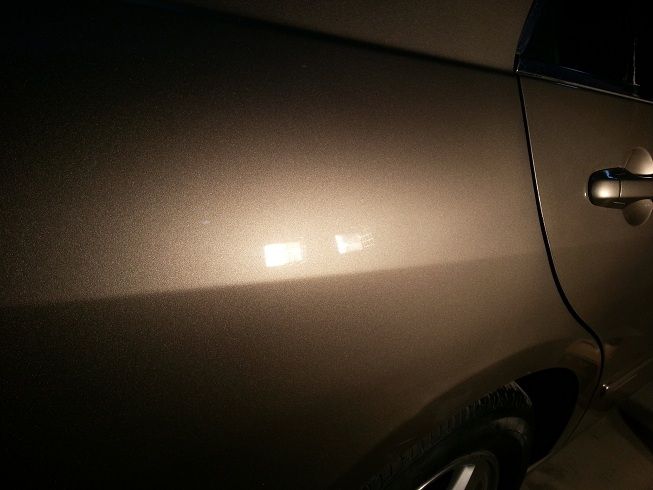

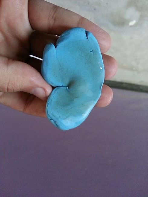

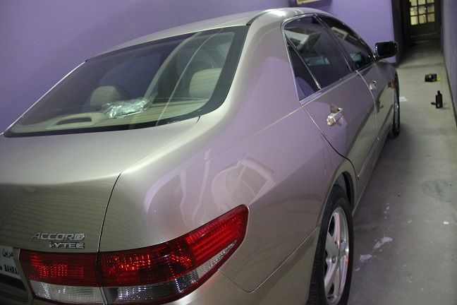

    yup this is my first time touch a machine,i dont know why i was leaning to rotary more than D/A, i picked up Metabo PE 12-175 rotary. German made & lighter than Makita.-washed & dry-Mild clay bar-M83 with cutting pad @1500 RPM-Ultimate polish with polishing pad @1000 RPM-Ultimate wax left for 30 min, removed by auto glym microfiber.there some areas couldn't remove all swirls like the hood,its dull and need more aggressive compund and some areas was perfect.I am really happy with the result. i need more time & practice.Guys give the rotary a try, don't be afraid from burning paint, burning the paint need effort.Pics:The bonnet looks dullAfter clay quart of the bonnetThe Metabo is ready, actually its Mini rotaryhere is the swirlsafter correctionthere still swirls on some areas ,i need more time & practice i think i will step to M105.
