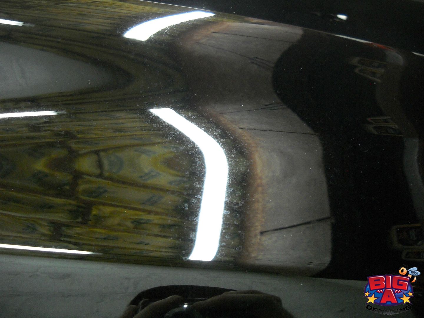

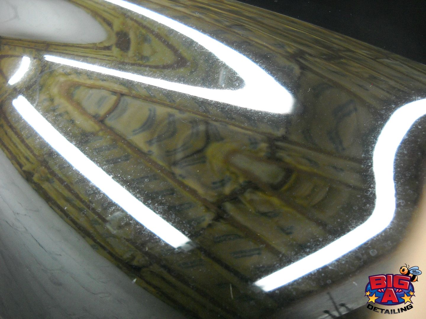

    i was lucky to find these hard water stains all over the car from the customers house sprinklers. they werent mentioned to me until my eyes saw them. i do not like surprises at all but oh well.

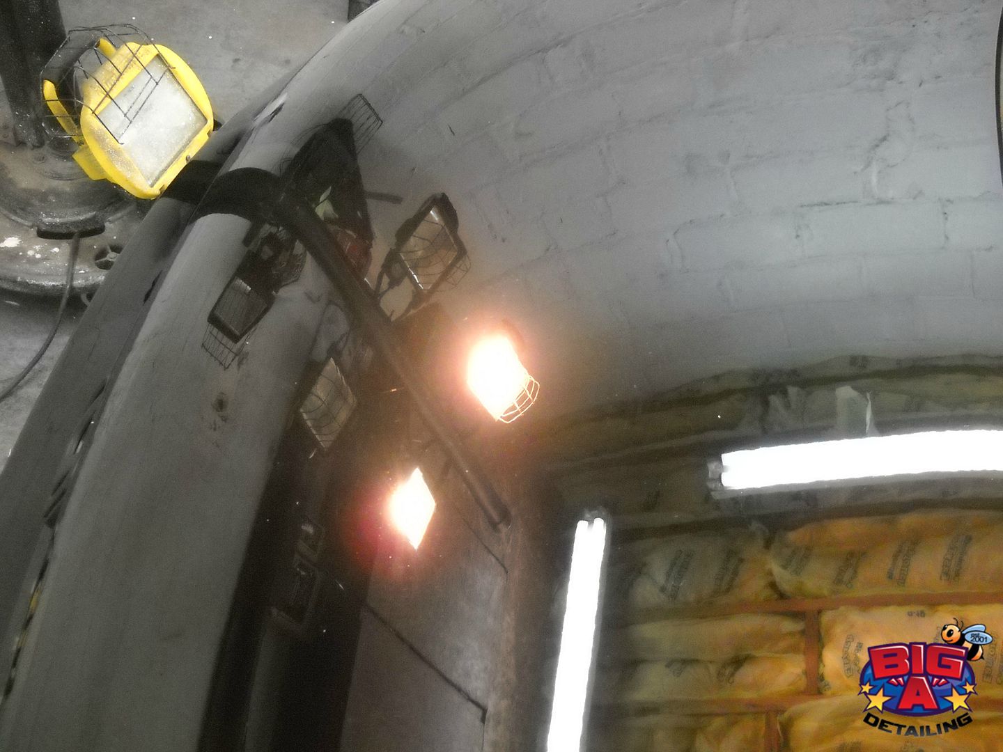

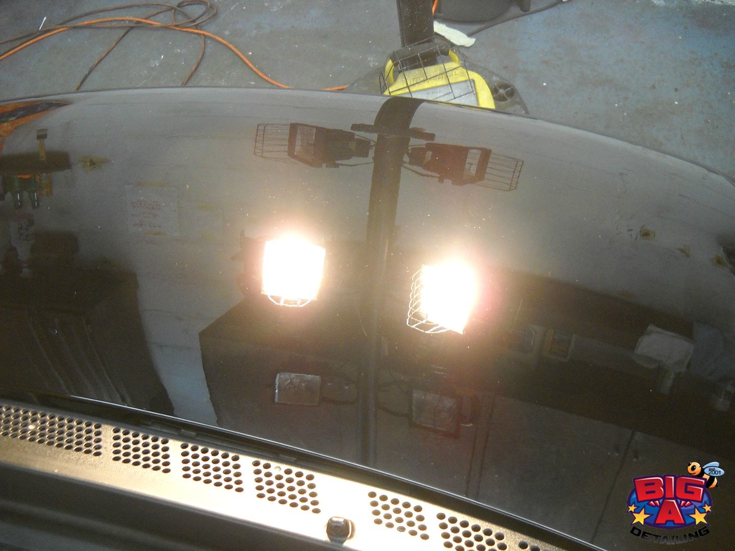

    she had a full respray about a year ago in a mercedes black. no pearl or flake, straight up black. the clear was a bit on the soft side. the hood & trunk were the worst areas so they were done under the halogens.

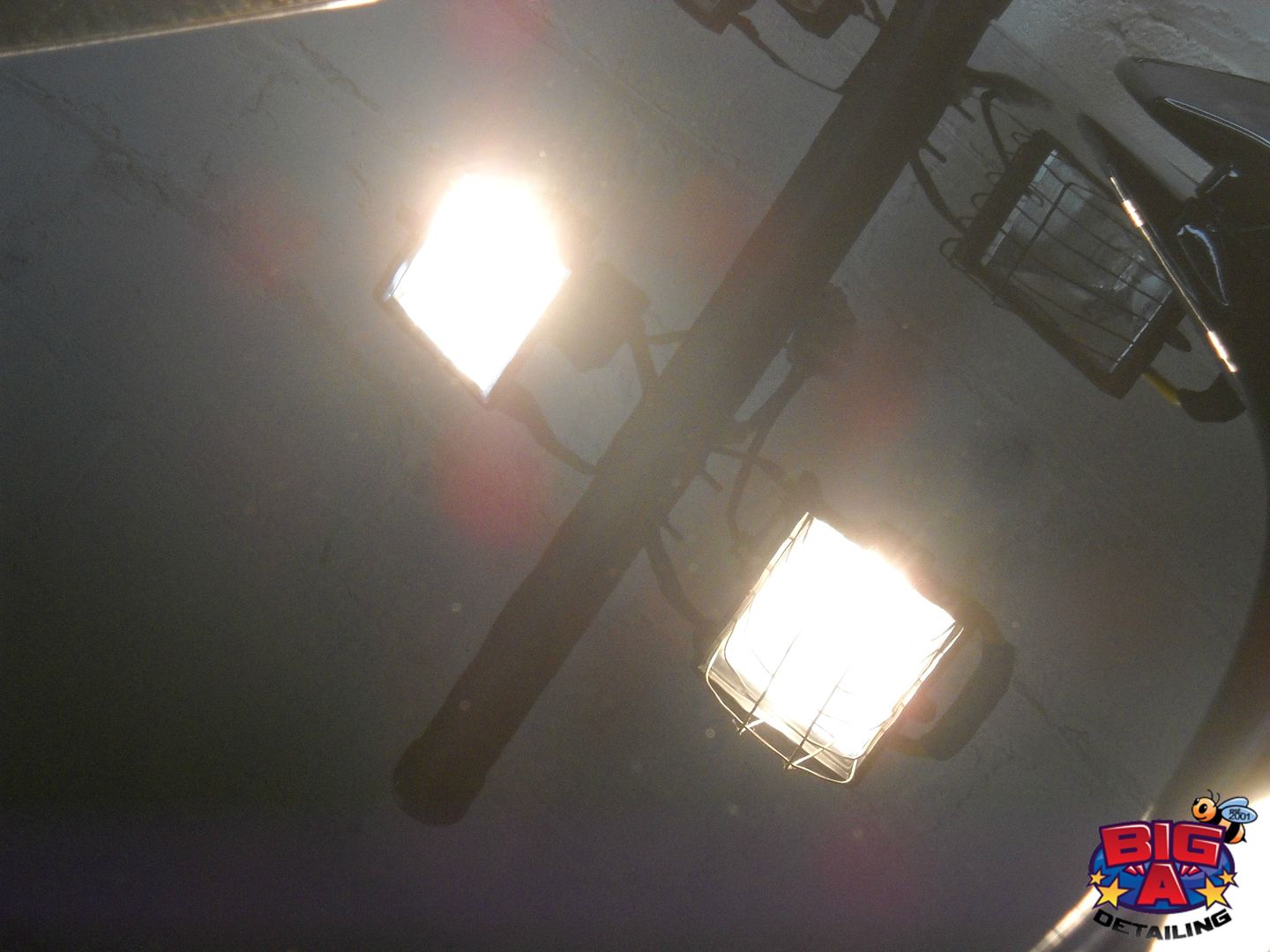

    top of trunk.
    under 1000w halogen light.

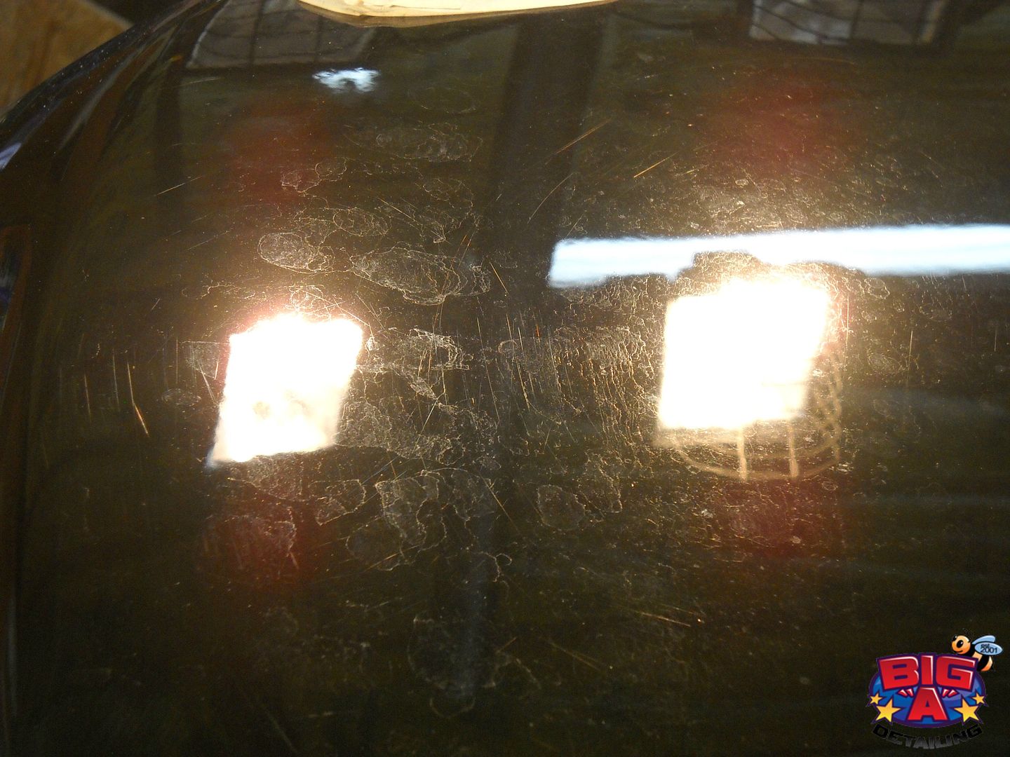

    i started with the hood for my test spot & first 50/50 shot.
    after HD Polish i wasnt happy with the finish it left. the color was a bit cloudy & would need another polishing step to bring the black back to its full potential. i thought, if i needed Menzerna SF4500 to clean that up, maybe i can get away with a 2 step on the rest of the car? i dont see why not so thats exactly what i did.
