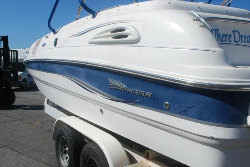

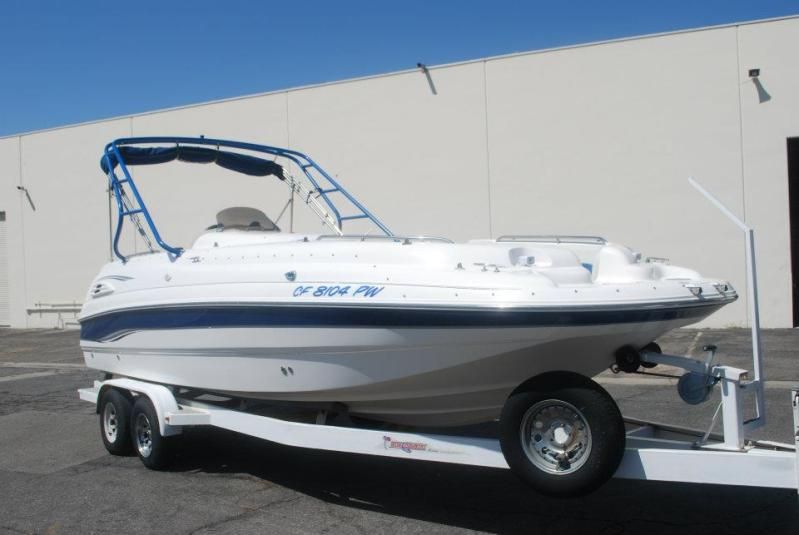

    It has been awhile since I have posted on here but I wanted to share this job with everyone. A storage customer of mine wanted his boat detailed which had been sitting outside for about 2 years. As you can see the whole boat was oxidized and needed major repair.
    Here was our process:
    -Removed all badges and random stickers
    -Wet sanded where the badges were with 1500g by hand
    -One pass with Meguiar's Diamond Cut w/ rotary and wool pad(1200rpm)
    -One pass with Meguiar's Pure Polish w/ DA and yellow polishing pad(speed 4)
    -Finished it off with one pass of Meguiar's Marine Wax w/ DA and black finishing pad(speed 2)

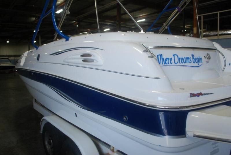

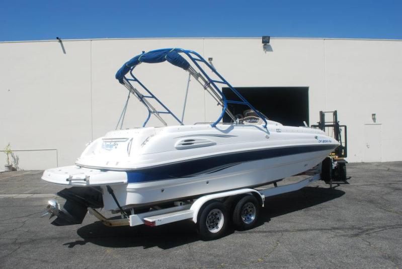

    We also polished and waxed the entire interior as well. Took a few days working on it here and there at the shop but turned out great and the customer was very happy.
    Take a look....

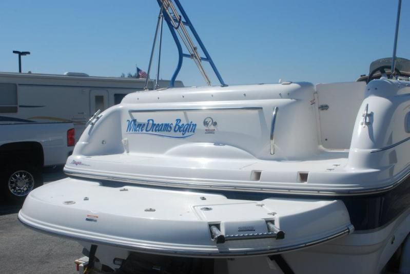

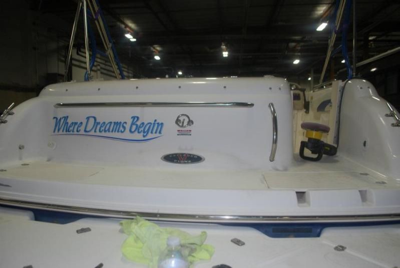

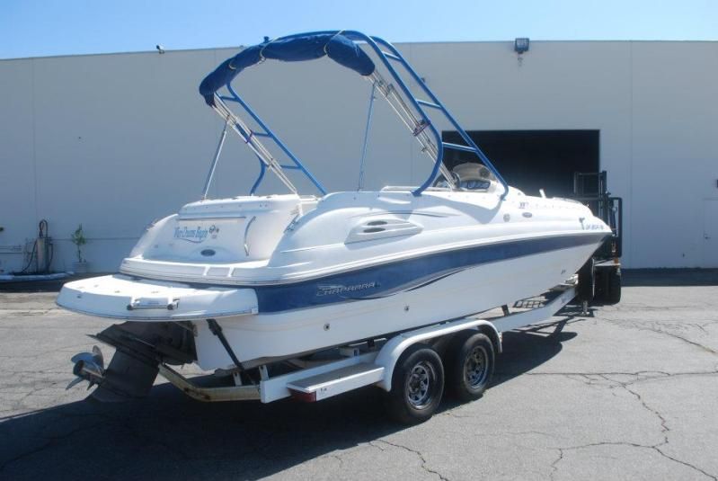

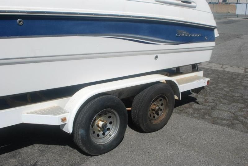

    A few before shots:

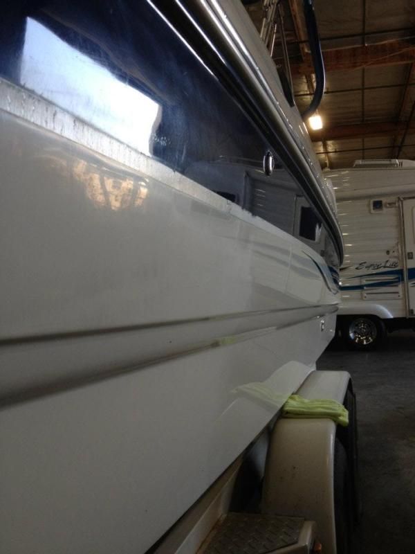

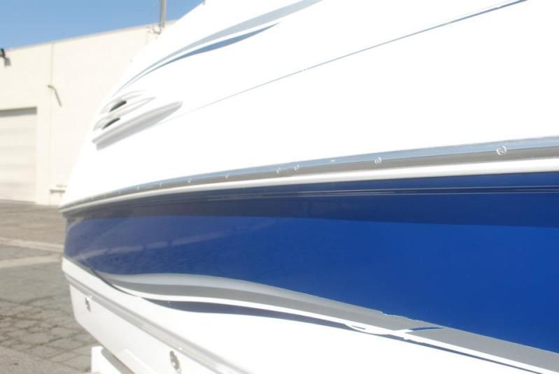

    50/50 shot:

      The 50/50 shot really shows the befores and afters...
