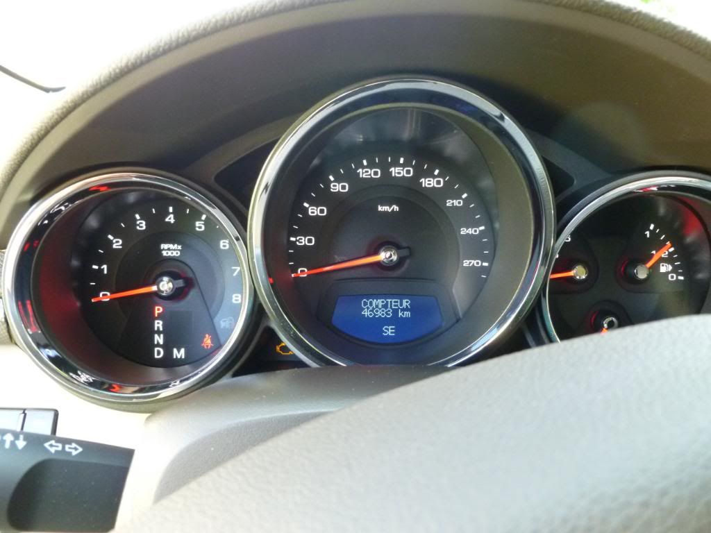

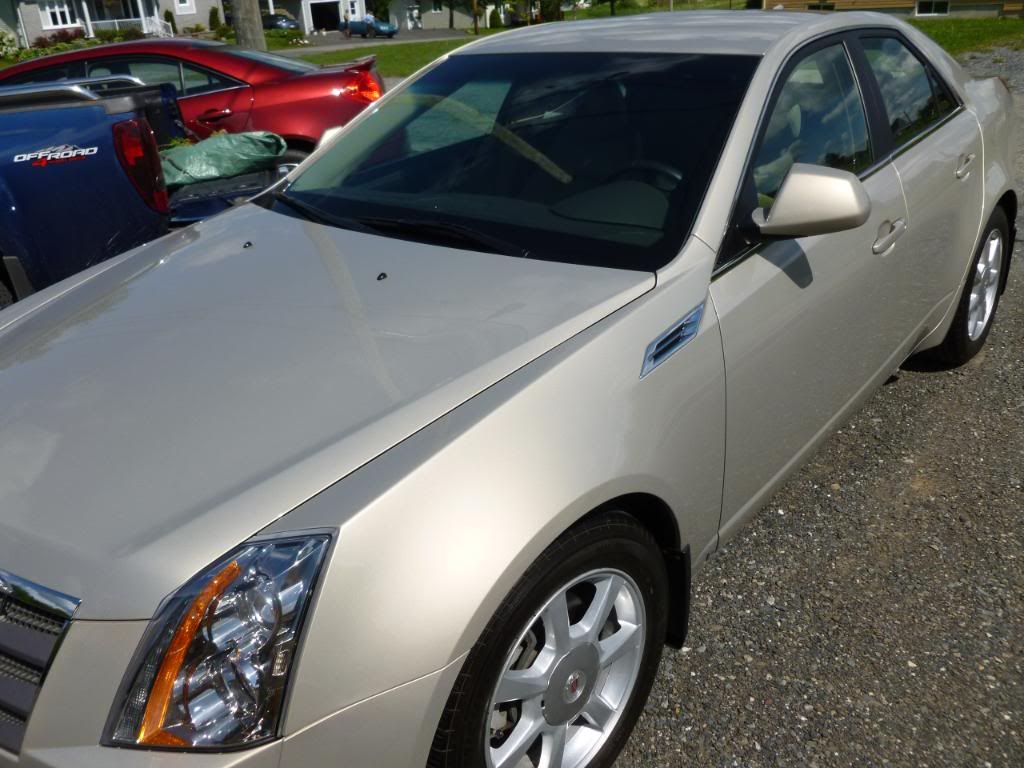

    2009 Cadillac CTS4, 46983 km.
    I see this car every year for a full detail. The owners are proud of their car and it shows.

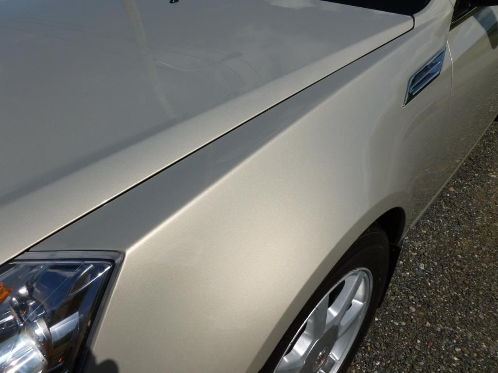

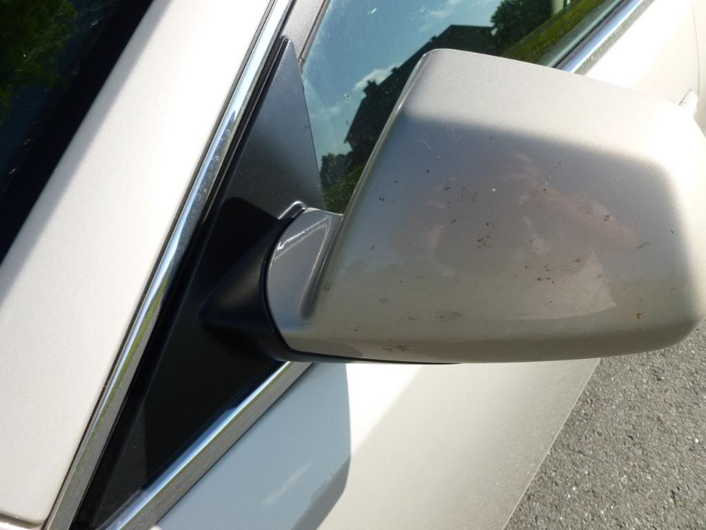

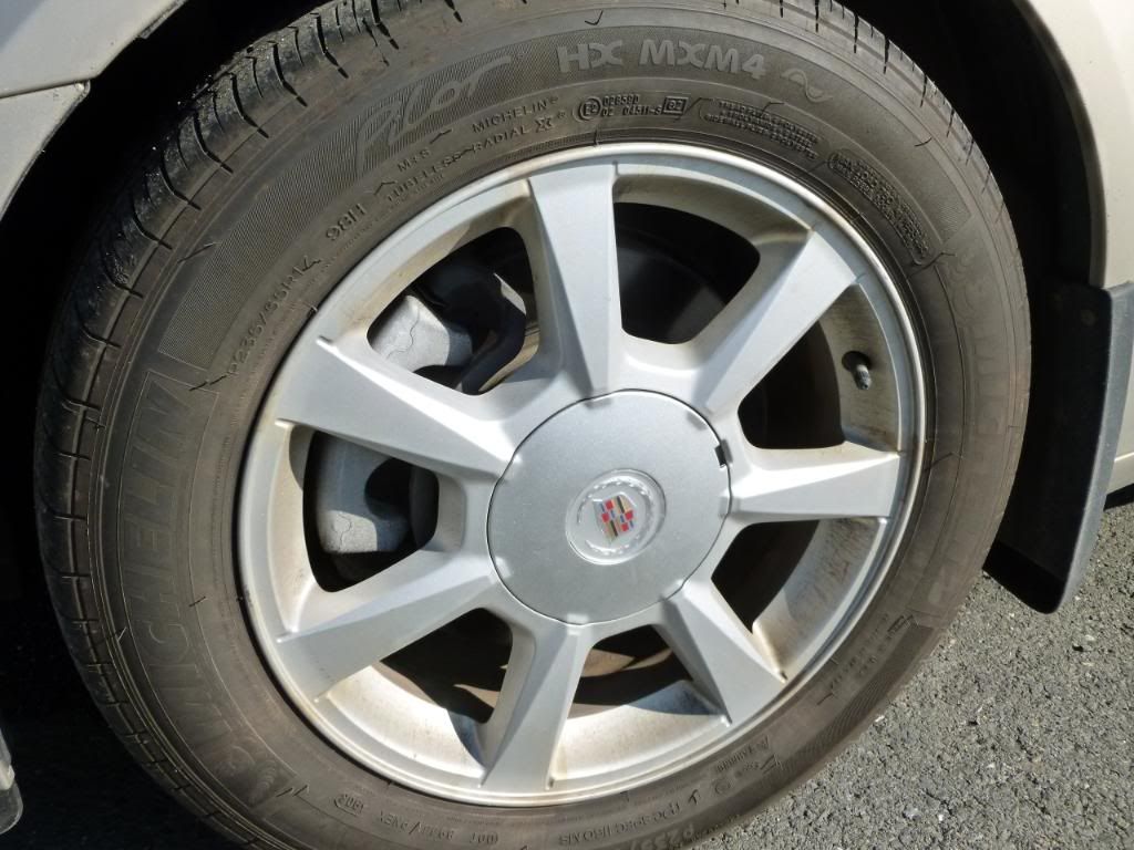

    Before :
    1) Wash rims, tires and wells with APC and Gold Class soap. Had to use Wheel Brightener on the front rims
    2) Wash with Gold Class, including door jambs
    3) Clay with Ricardo Yellow Clay and Last Touch (1/1)
    4) Quick rewash with Gold Class
    5) Dry with and Absorber and Water Magnet
    6) Dry door jambs with mf towels and Xpress Synthetic Wax
    7) Ultimate Polish on green LC pad
    8) #21 Synthetic Sealant 2.0 on red LC pad
    9) Aquapel on the windshield
    10) Ultimate Black on trims and wells
    11) Endurance Tire Spray on the tires

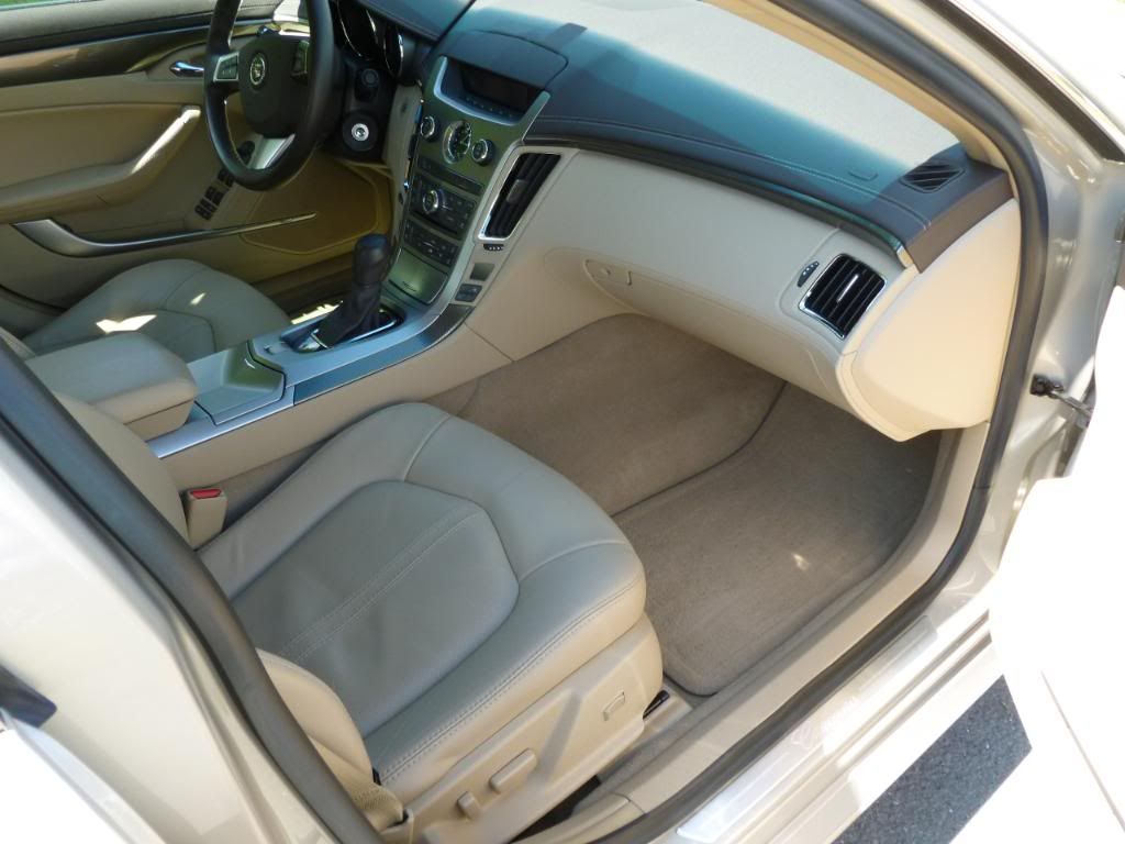

    12) Vacuumed the interior/trunk
    13) Perfect Glass Cleaner to clean the windows
    14) Quick Interior Detailer to wipe down the interior
    15) Gold Class Leather Cleaner/Conditionner on all the leather seats

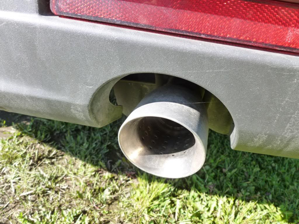

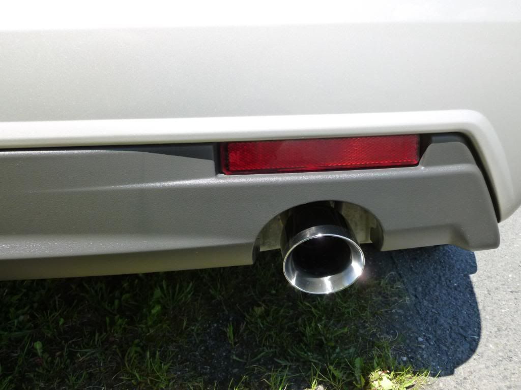

    16) Exhaust tips polished with Chrome Polish from Meg's Motorcycle line
    17) Gold Class Quick Wax as a final wipe just before the owners showed up

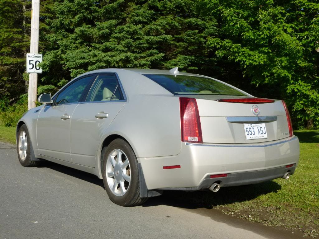

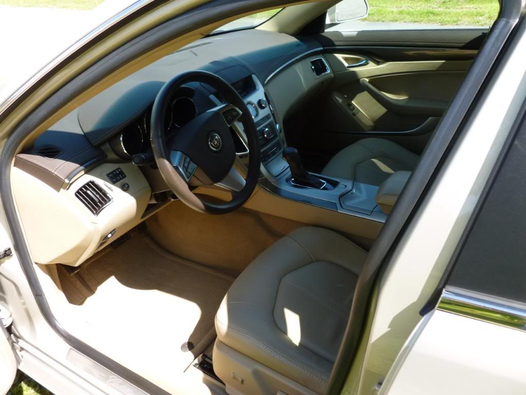

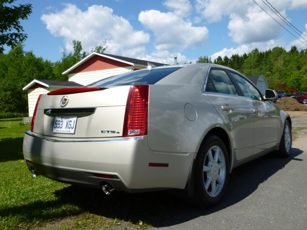

      Re: 2009 Cadillac CTS4 and some other details

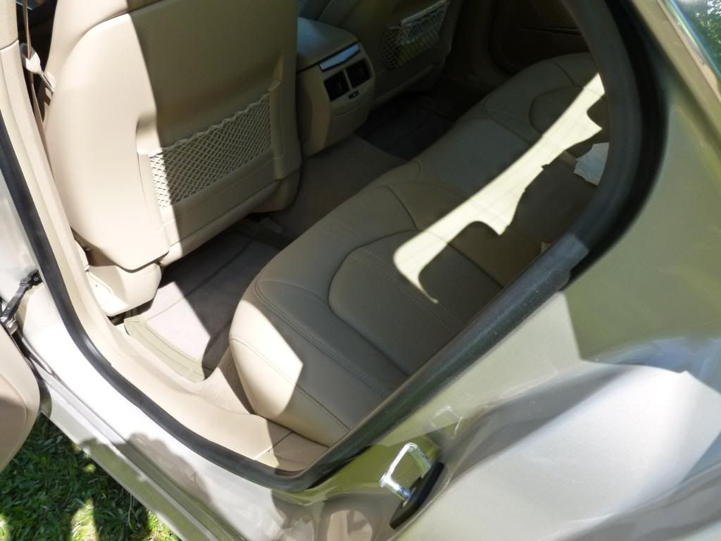

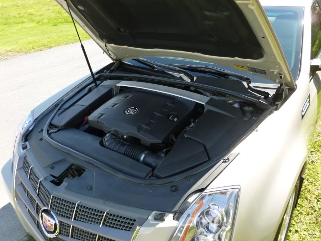

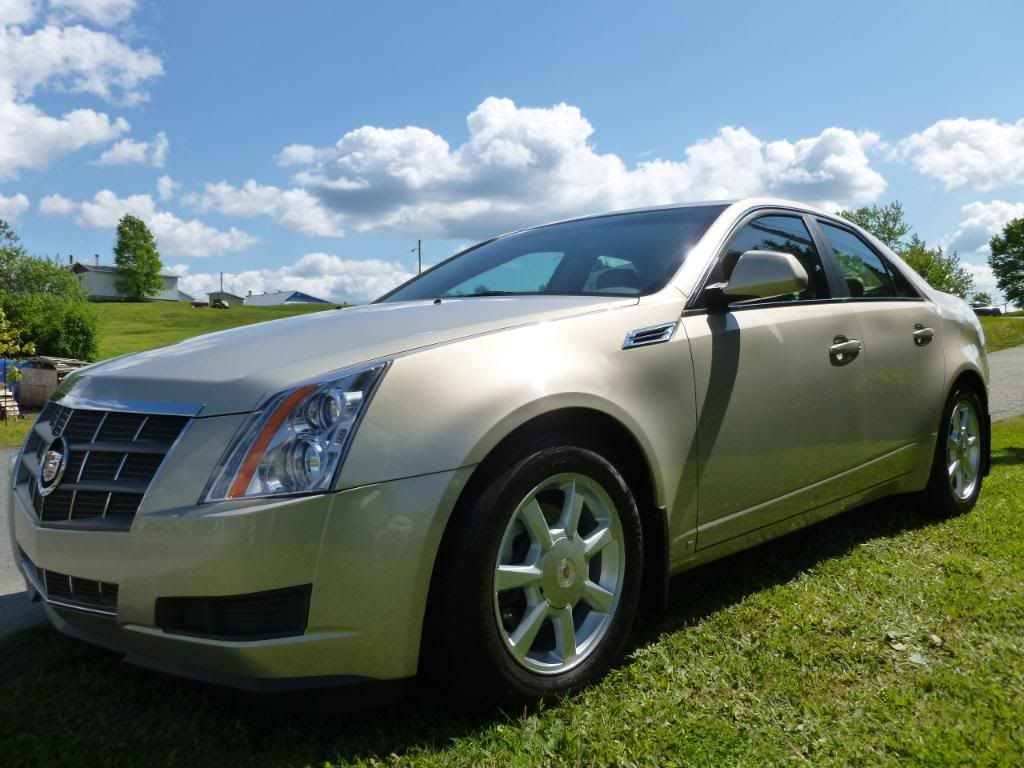

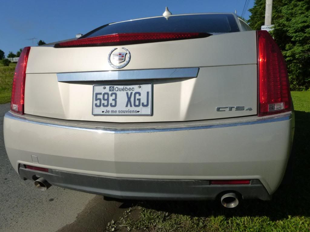

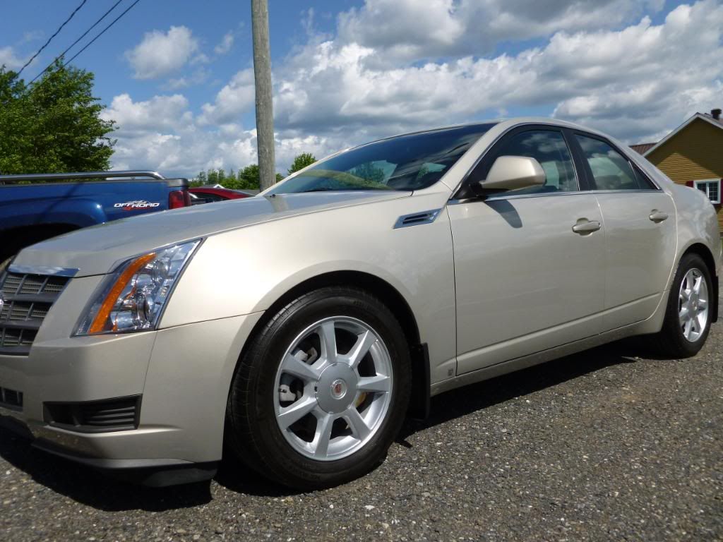

      It was hard and long work, but the owners were happy and it's all what matters to me. Began at 8AM and was done at 3PM, taking a little less than an hour for lunch break.
      After :

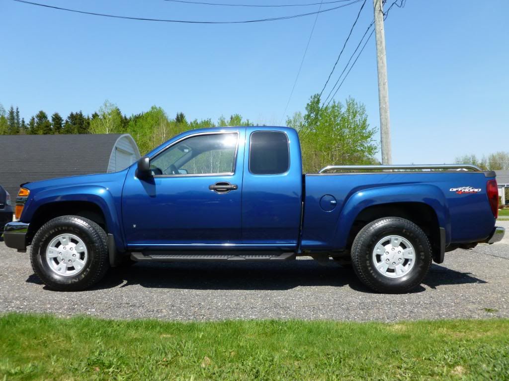

        2006 GMC Canyon SLE, under 50 000 km.
        Washed with Gold Class, clayed, polished with Ultimate Polish, waxed with Ultimate Liquid Wax, dressed tires and wells with ASD. No interior work yet.

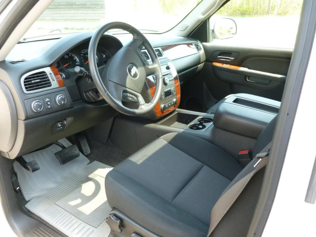

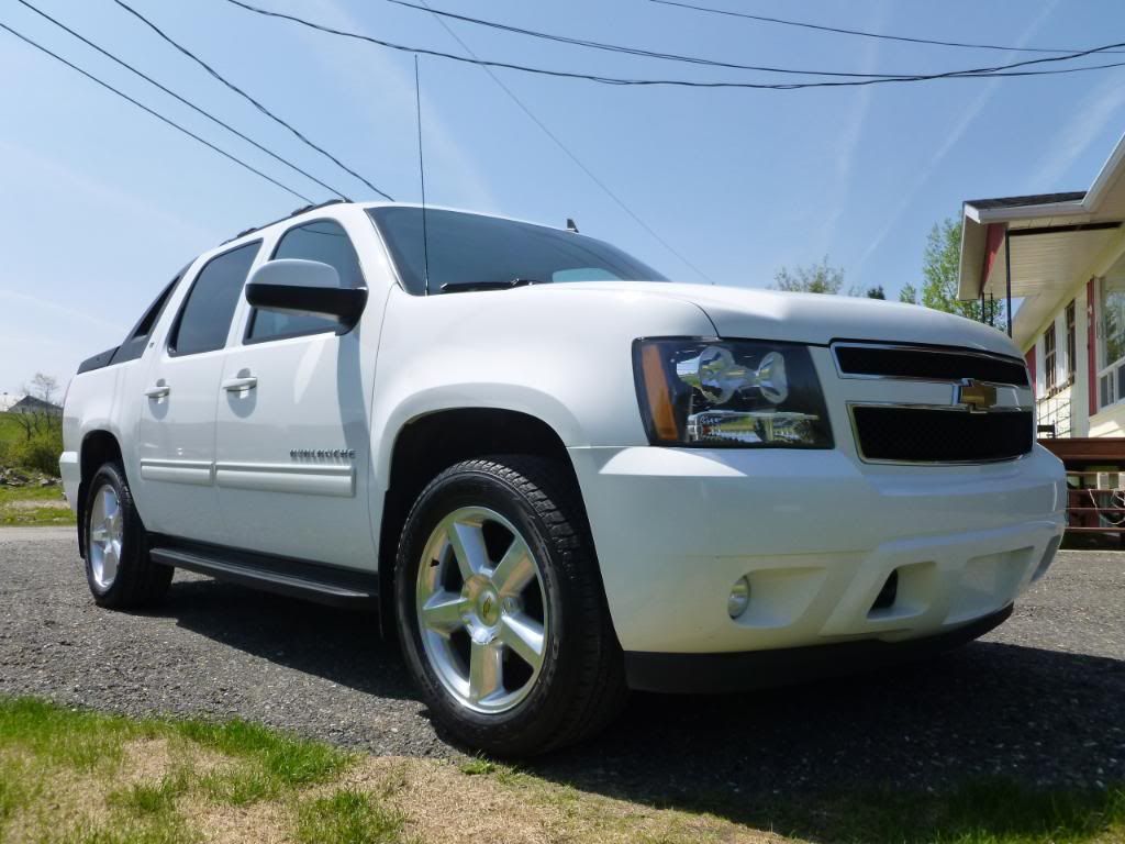

        2010 Chevrolet Avalanche LT, 64120 km.
        Washed with Gold Class, clayed, waxed with Ultimate Liquid Wax, dressed tires and wells with ASD, vacuumed, cleaned glass with NXT Glass Cleaner, interior wiped down with Quick Interior detailer

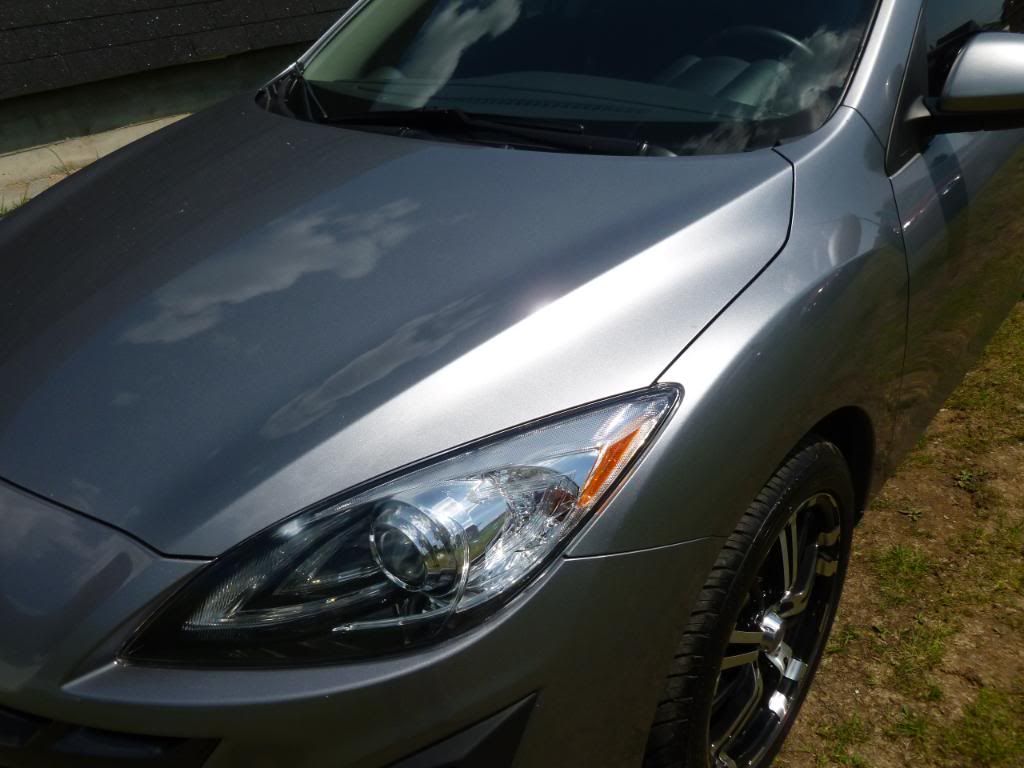

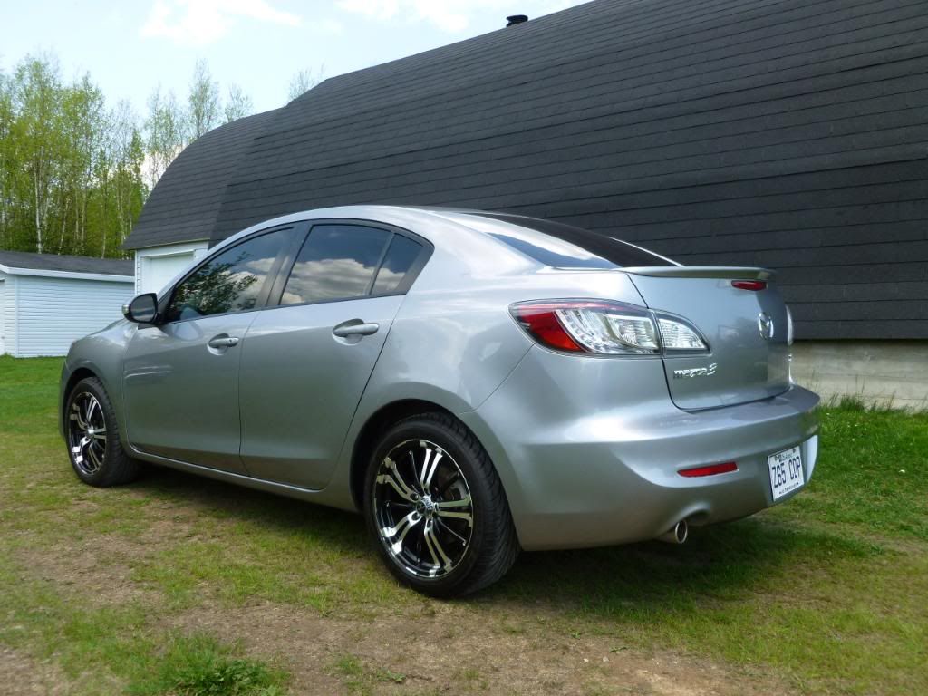

          2010 Mazda 3 GT, about 38 000 km.
          Washed with Gold Class, clayed, M105 on the back bumper, polished with Ultimate Polish, sealed with Optimum OptiSeal, Aquapel, dressed tires with Endurance Tire Spray. No interior work yet.

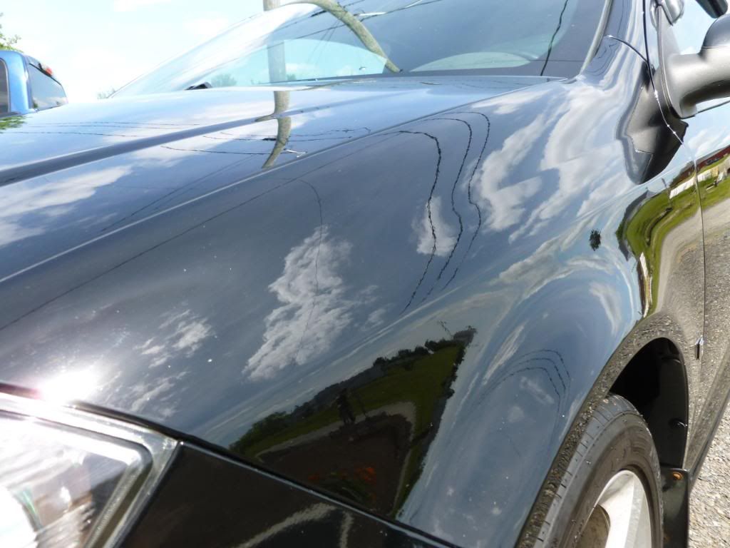

          2008 Pontiac G5 GT, 74500 km
          Here the main goal for the owner was to hide the swirls and scratches before giving the car back to GM in a few days (end of the lease). Washed with Gold Class, ScratchX by hand on some bigger scratches, waxed with D301 Finishing Wax on a green LC pad, Gold Class Quick Wax, dressed tires with ASD. No interior work.
          Not bad for just using D301 !
