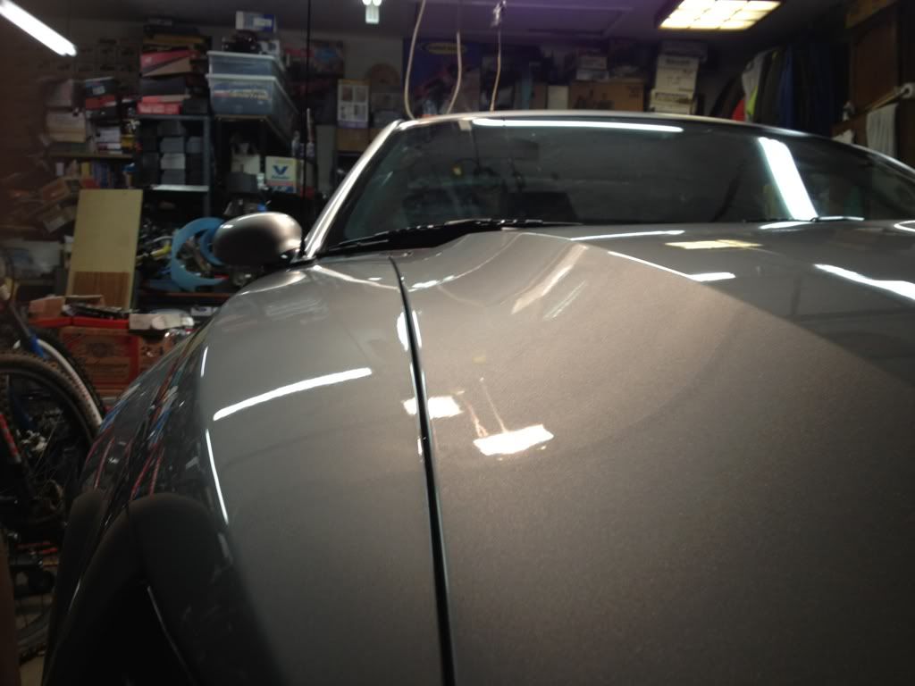

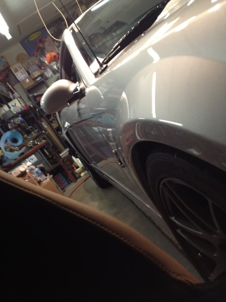

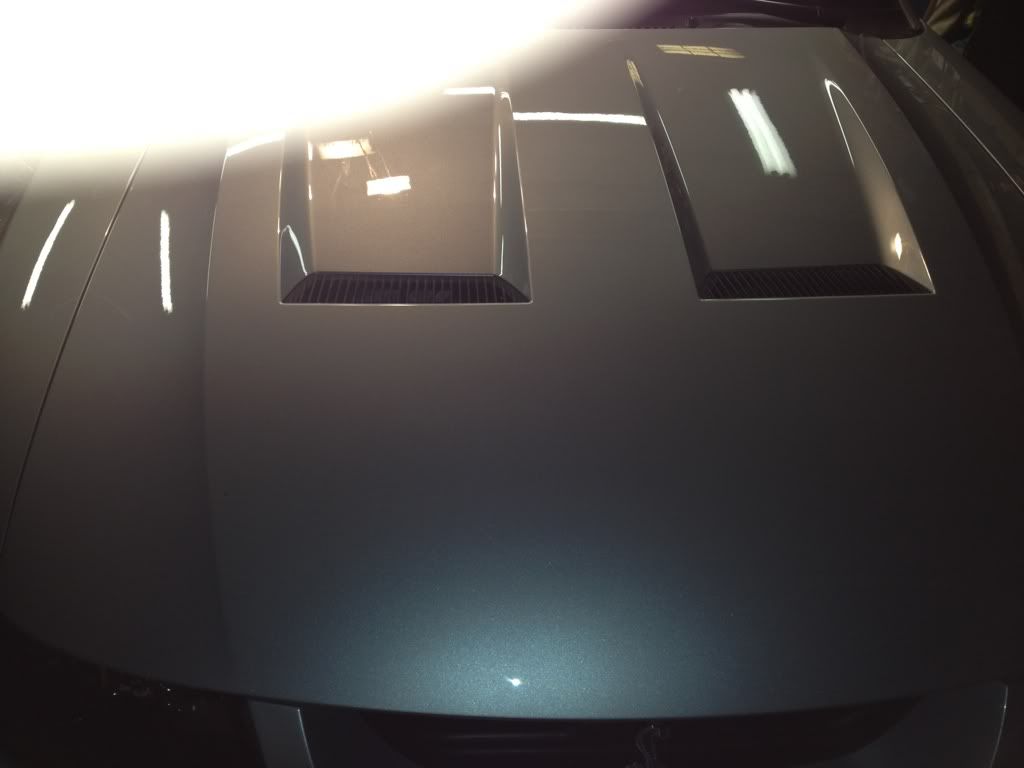

    This car was done for a friend of mine last night. I only have a couple of after shots because I got started late and didnt have time during the process. His car is the same color and year as mine (identical to mine actually except the wheels). He rarely drives it so the paint was in pretty good shape, he was mainly concerned with some swirling. The swirls didnt look bad so I tried a test spot with the 205/yellow pad, but it wasnt enough. So I moved to the 105/red pad. After the test spot I was satisfied and finished the car with the 105 and moved to the 205. After the 205 the paint was free of swirls and I opted to skip using a polish to save some time and applied a coat of UW. By the time I had the wax removed it was 1AM, so I told him to keep the car in the garage and wait at least 1 day before washing it. On to the pics. (taken with my iphone on the HDR setting)
    He was very pleased with the results, I will be doing his Black TL Type-S soon as well. Sorry for the lack of pics, Ill be sure to take more during the next one.
