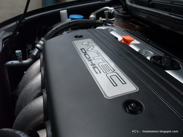

    moving on engine detailing
    opps
    Detailien magic swipe

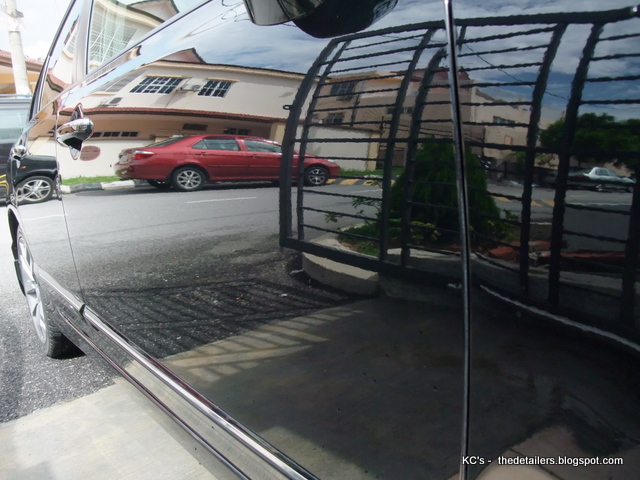

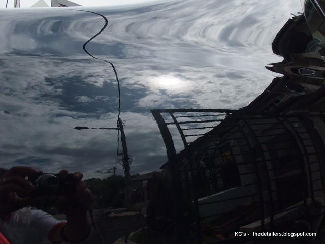

    the real thing under proper lighting is
    dont be just fooled by reflective pictures. as light will shows / reveals everything
    observe this
    close up
    ta da

    under the sun

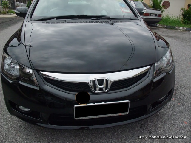

    front hood
    more

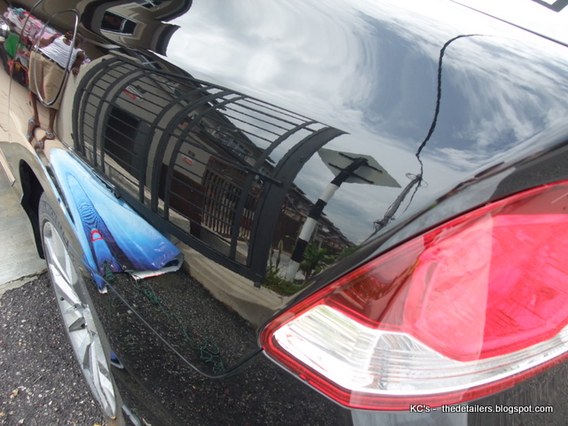

    some finishing pics
    it is always hot & heats kicks in & details melts
    a mirage
    ta da
    see again
    now
    the full picture
    bye bye the hologram & micro marring
