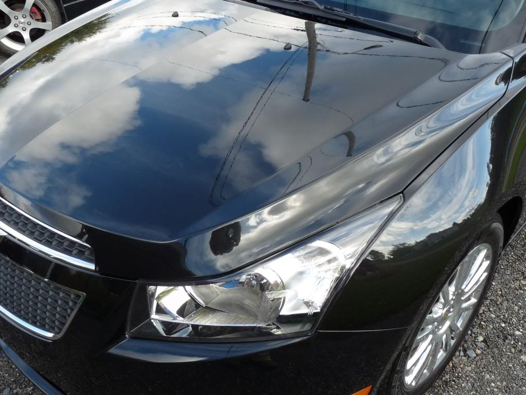

    Polish with Ultimate Polish on a green LC pad
    Wax with Ultimate Liquid Wax on a red LC pad

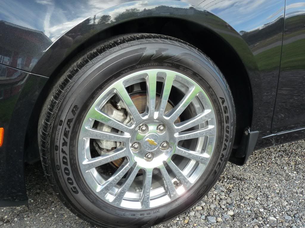

    Endurance Tire Spray on the tires (needed 3 coats to look okay to me)

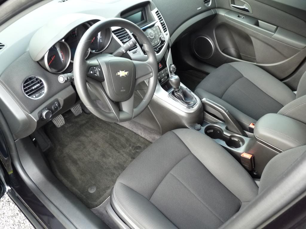

    Vac/dry brush/vac
    Carpet cleaned using Quick Out Carpet Cleaner and APC+
    Windows cleaned with NXT Glass Cleaner
    Quick Interior Detailer to clean and dress the vinyl.

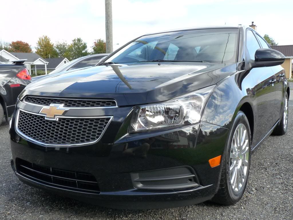

    After :
    Yes, those were polished rims !
    The carpet was not completely dry when I took the pictures I believe.

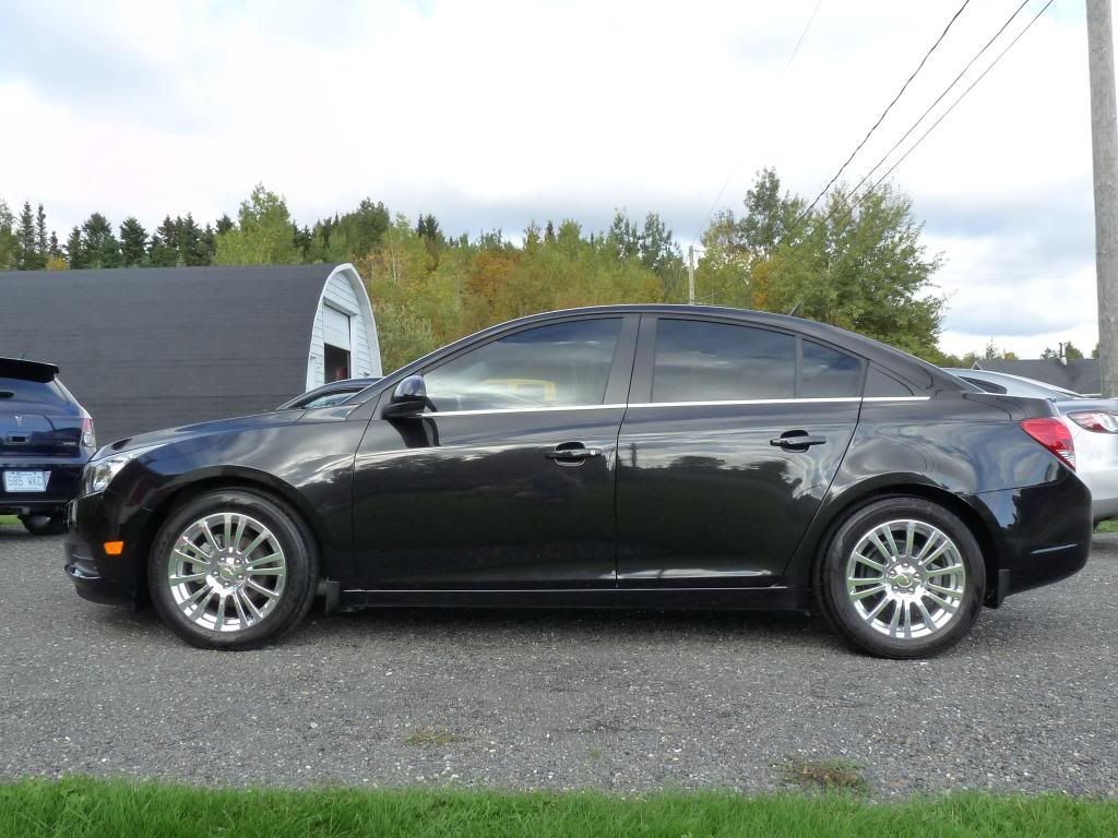

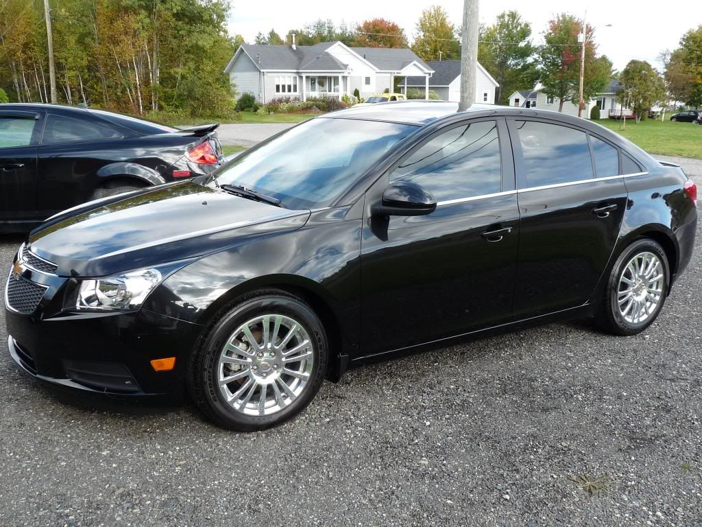

    Again, a before / after of the Cruze.
    The owner dropped the car at 9h this morning and he only needed the car back at 6hPM, so I was in less of a rush than when I detailed the trashed Pontiac G5 last week-end. The owner was very pleased and told me that it was like getting a brand car again !

          The Endurance Tire Spray in my new favorite also. It does last a while, even in the rain.
          I needed 3 coats on this Cruze to get the tires looking as good as I wanted them. Probably because they never had tires shine on them. On my car, I only needed 1 once in a while.
