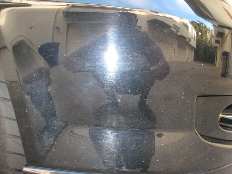

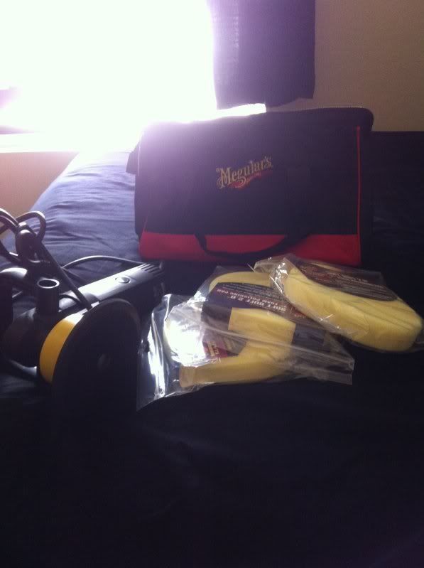

    So my detailing kit just arrived. Got a G110v2 meguiars DA with 3 w8207 polishing pads. I have a lot of swirl marks on my honda fit and i wanted to get rid of them using this set up by meguiars. Heres a detailed list of what I plan on using and what is going to be done to my car and I must say everything is going very well! Check out my process.

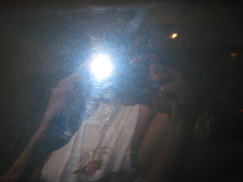

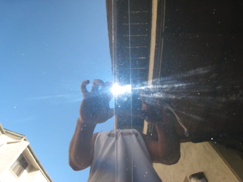

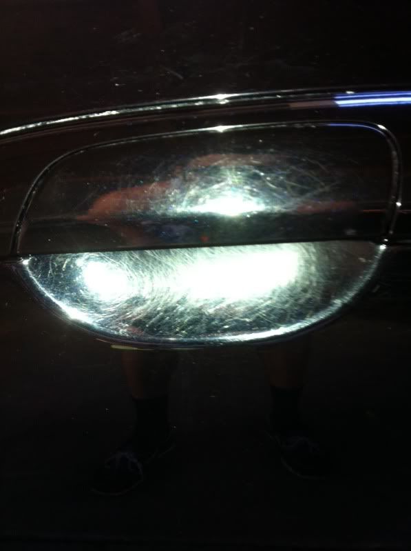

    heres a picture of the immense amount of swirls my door has
    the machine thats going to save my paint!

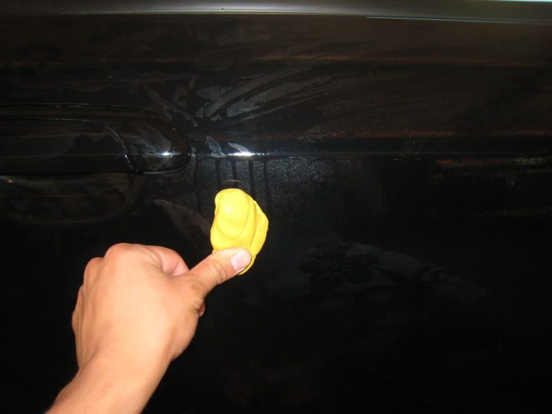

    time to clay bar after washing!

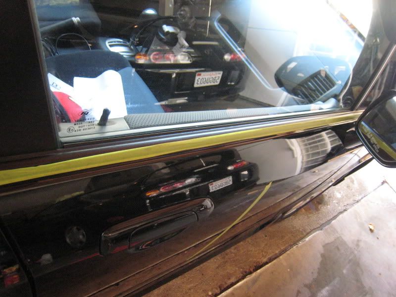

    gotta protect the weatherstripping and crevices so that compound doesnt get stuck inside

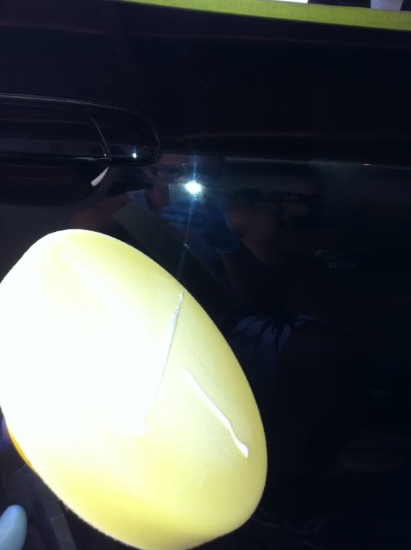

    Use the Meguiars g110v2 with W8207 pad

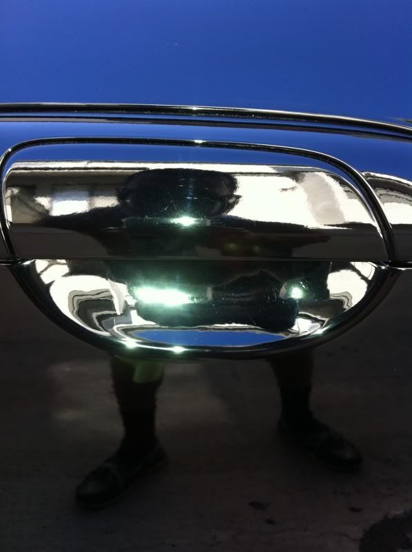

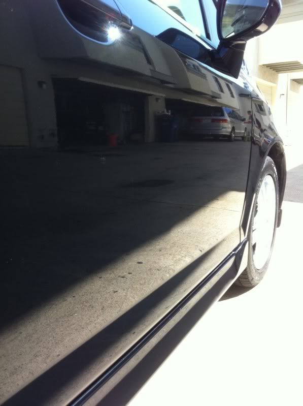

    After using Ultimate Compound and Ultimate Polish
    Tada!

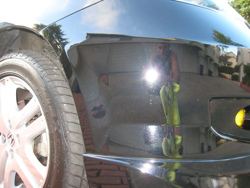

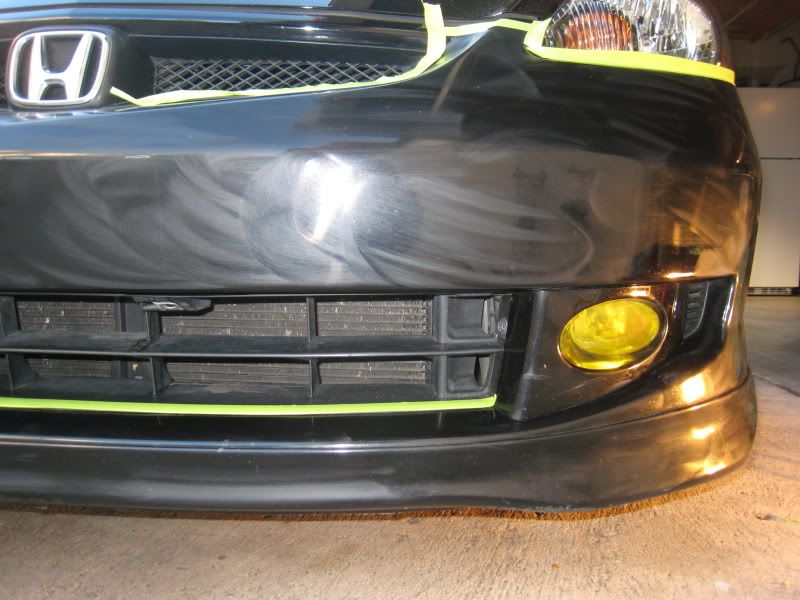

    front bumper ready for prep

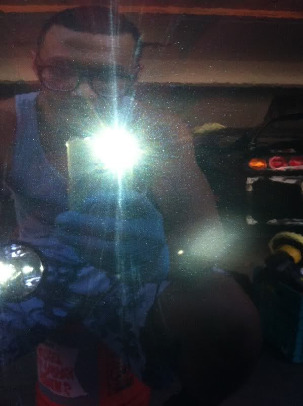

    swirllss!!

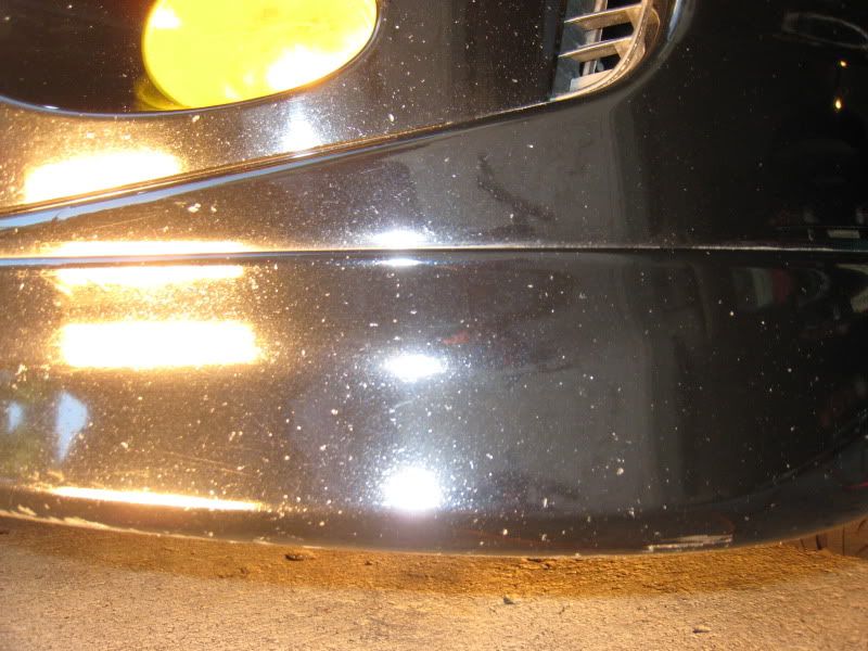

    anybody have an idea of taking all these massive rock chips out =(

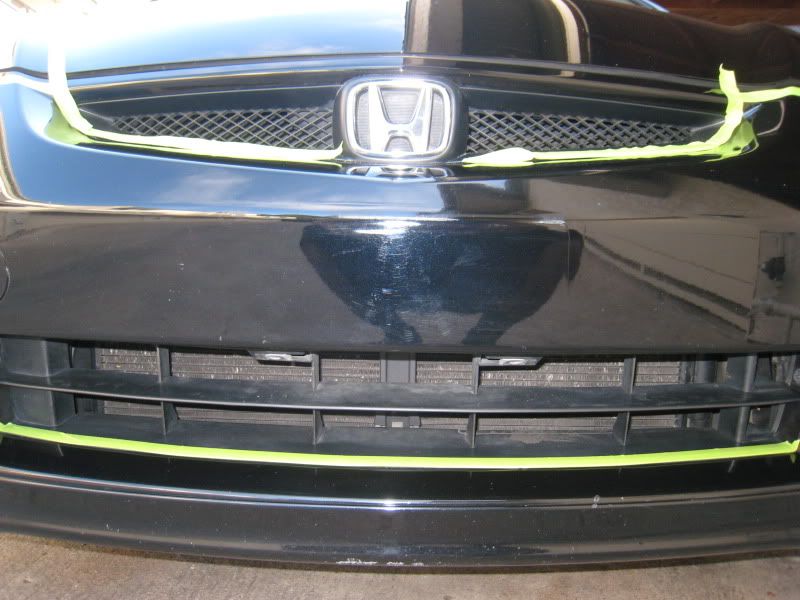

    ready for wax
    finish
    really open to advices. i was hoping my front bumper would have looked better. i guess its better not having swirls on it

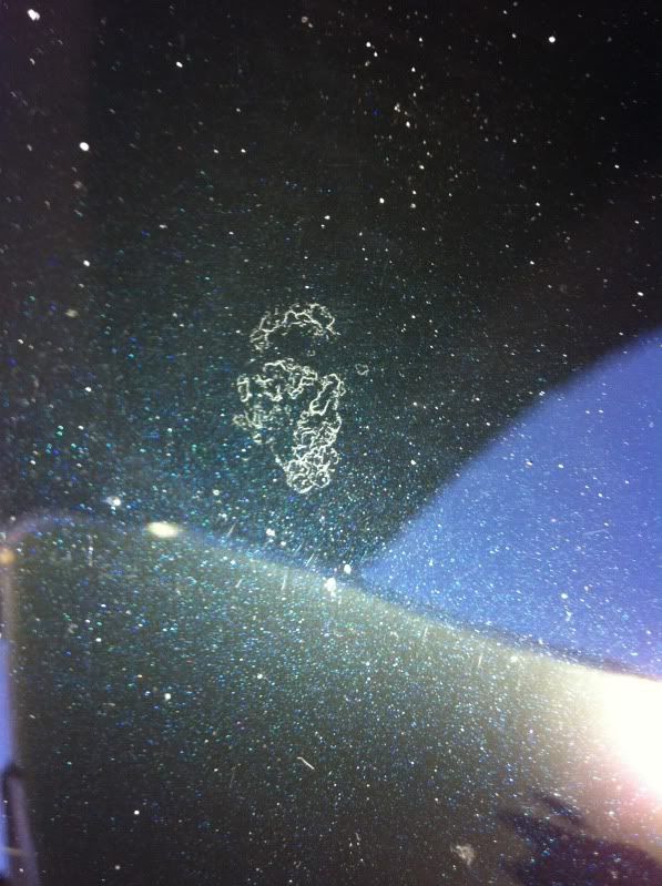

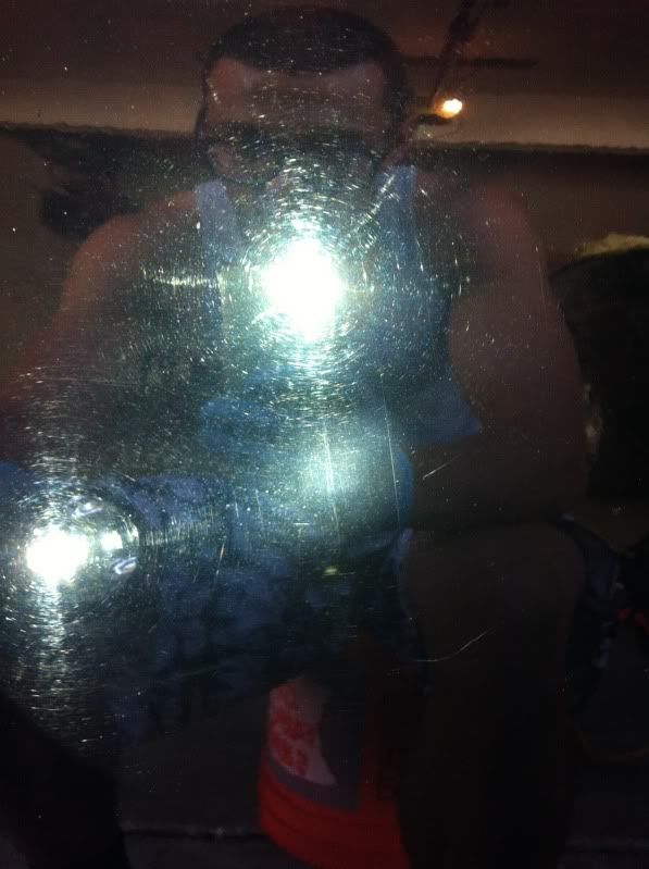

    anybody know what this is? i cant get it off

    I think you did an amazing job in detailing your black fit! That's the way a black car should look like!
    Meguiar's never recommended using the cutting (W7207) foam pads with the G110v2 or any other D/A because it can haze up the paint especially to the ones on the softer side. Mike Stoops has been using the polishing (W8207) foam pads with Ultimate Compound with great success in removing severe defects in his Saturday classes.
    The last picture you posted is unfortunately clear coat failure. Honda nighthawk black pearl pains are notorious for getting these micro-cracks. My friend has a '01 civic that has that exact same problem all over his front end.

      Nice job,I would say in the last picture...that is damaged left on your clear coat following after some bird poop sat on painted surface too long!

        Last pics looks like a bird bomb or paint failure? Can't see it clearly though.

          Looks like bird **** to me . Wet sand very lightly with 2000 grit . Follow up with UC and polish .BTW nice job!

            You did a wonderful job! Especially for your first time. UC and UP are SOOO user friendly and do such a great job that I often end up using them on clients' cars unless I really need to get aggressive. I am going to say that I think (not 100% sure though) that the spot in your last pic is in fact a bird poop etching. You could try to go over it with your DA and UC with a bit more pressure. I don't know if I would wet sand it unless you've had some experience doing so or you could make it worse. If the clear coat has in fact failed it may be better to just touch it up with some clear and let it go seeing as it's a daily driver For your front bumper, you could try a product called Dr. Colorchip as I have heard it works pretty well but for the future, on your next car you may want to consider paint protection film. I have it on the front of my vehicle and LOVE it. I can't tell you how many times it's saved my paint. In fact, on the ride up to my parent's this weekend I had a decent sized rock hit the film on my hood. There is a slight scuff in the film if you look at it very very closely but no dent and no chipped paint!
