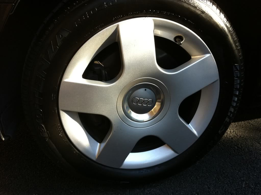

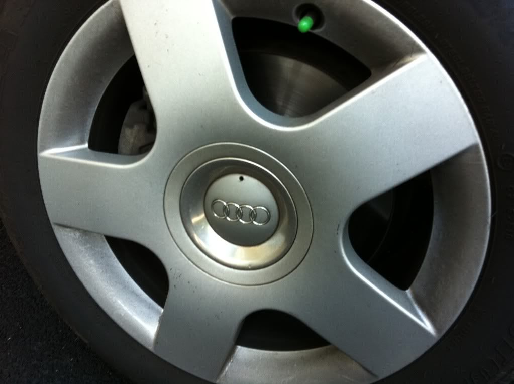

APC to the wheels and agitated with wheel brush. APC to the wheel wells too and left to dwell a bit and then sprayed off. The wheels actually needed to come off but I didn't have to time.

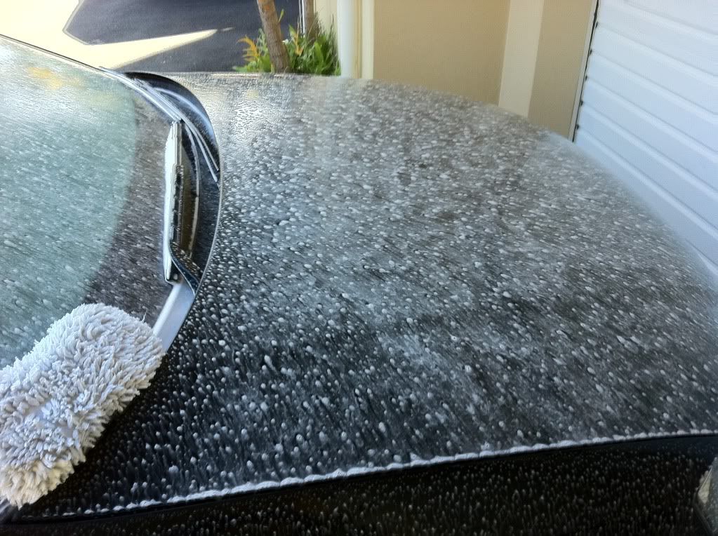

Foam gun used over the car (Ultimate Wash and Wax) and left to stand then washed with chenille pad.

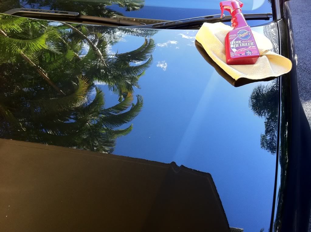

Clayed car with clay and Quick Detailer. (Destroyed the last of my bar! - See pic)

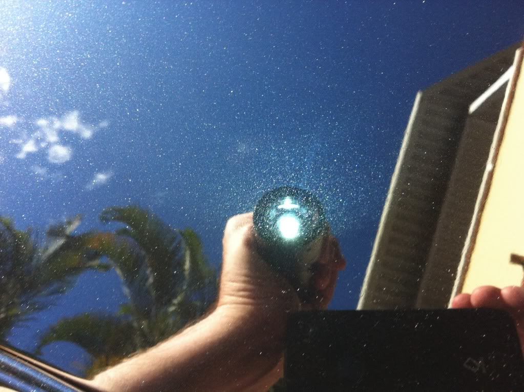

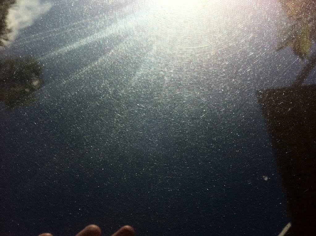

Dried with waffle towel and inspected the paint - cobwebbing and swirls galore with what looked like rotary trails on the roof.
Pulled the car into the garage, taped her up and started with a test patch - used a Yellow pad with speed 3-4 with Swirl X. Huge improvement but needed further correction. Then moved up to Ultimate Compound also speed 3-4 and this did the trick. Rest of the car then done with UC at varying speeds. The roof took quite a while.

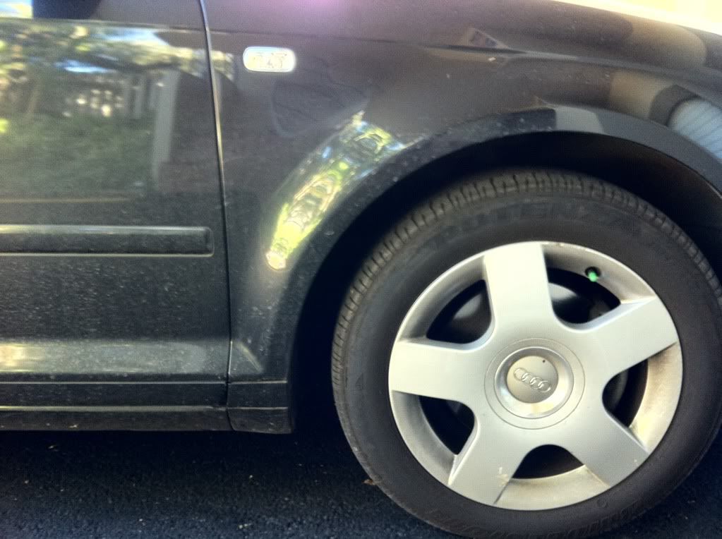

Before..
Then foamed

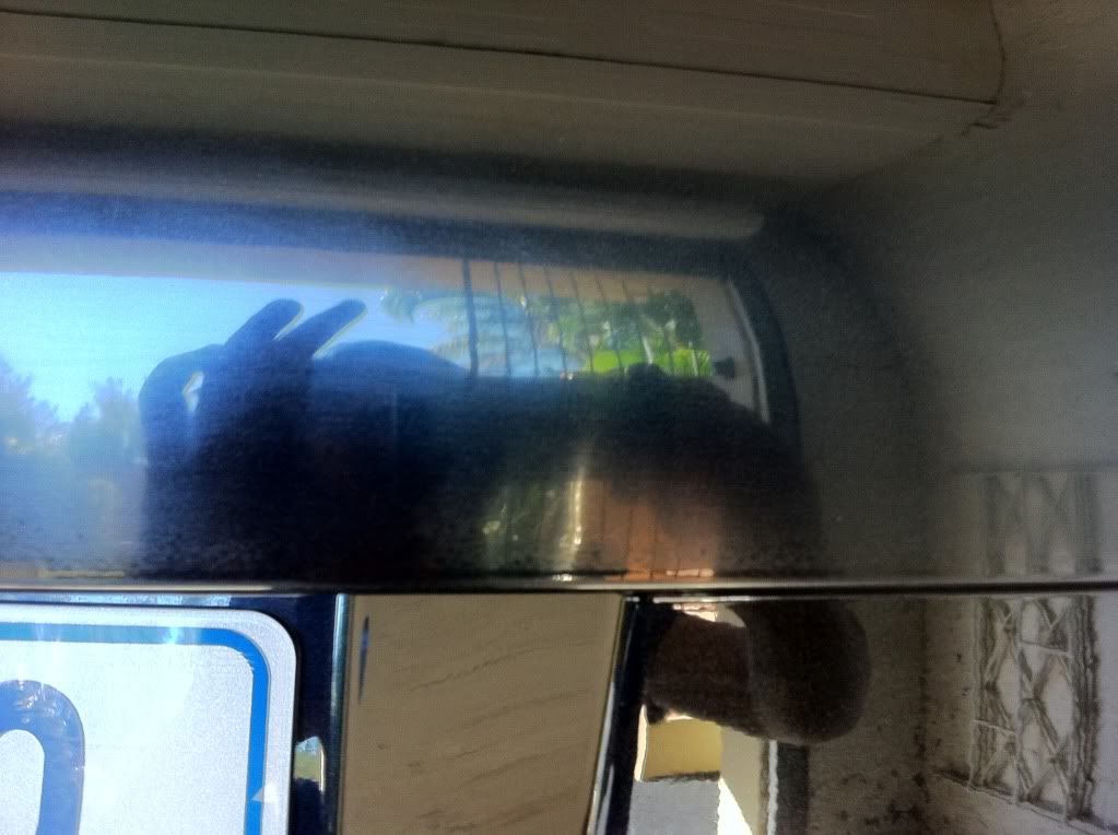

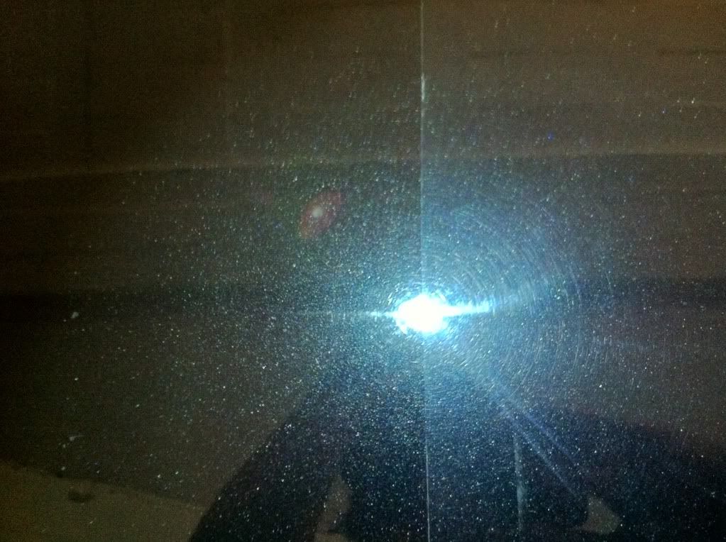

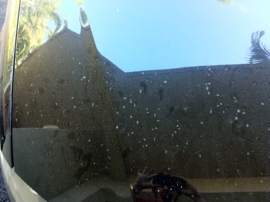

Paint defects, including a pic of the tailgate which looked as though it had been sanded in a respray and not finished off..
Clay

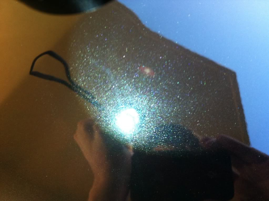

Comparison between left - Swirl X and right - uncorrected paint. Looking better but still some defect.

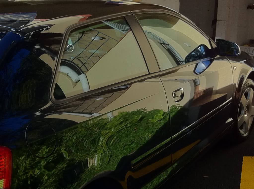

Finished product
I must say I was happy with the final result - not 100% perfect (the roof was quite difficult to do) but most of the major defects removed. I loved using the G220. Made a 12 hour job into a 6 hour one. Bring on the next car!

Then foamed
Clay
Finished product
