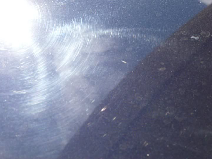

    Scratches and holograms on every panel.

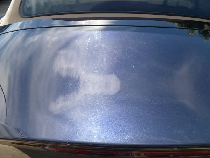

    First on the list was to clay the car to get rid of the surface containment's. Pic is after doing a 2x2 foot area.

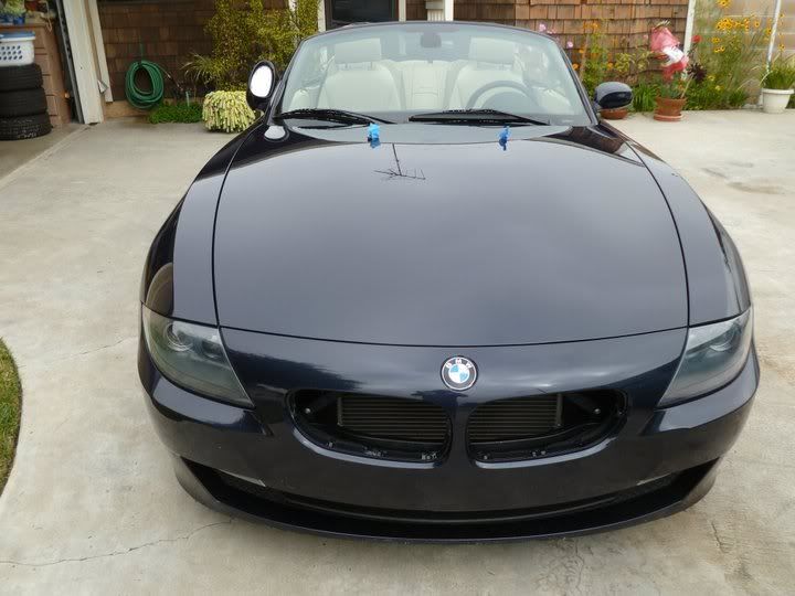

    Next a test area using #205, using the D/A and a yellow pad at speed 4, results was not what I was looking for , so yet anothe test area using # 205 at speed 6, still was not getting the job done.
    The end result was #105 at speed 5 to put a scary haze on the car, however, when followed with # 205, yellow pad at speed 4 , I was happy. Completed the car with #105, all panels.
    Followed up with # 205 and completed all panels.

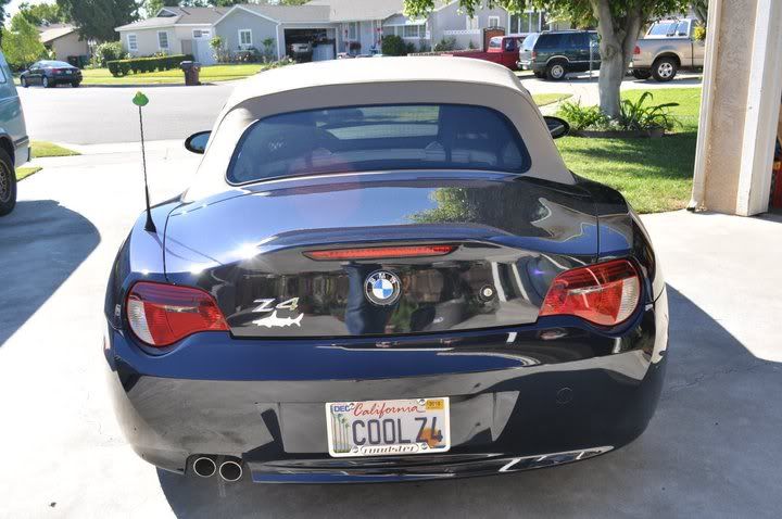

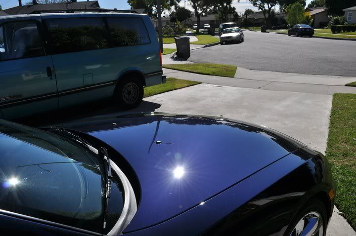

    The car now had all scratches and holograms removed and it was now time to apply the bling.
    I used car show glaze (#7) with a black finishing pad and the D/A on speed 3. This IMHO is what gives the car that wet look and depth.
    When completed the next step was to protect my efforts, so out comes the #21, the first product that was allowed to dry on purpose. D/A with finishing pad, speed 3.
    I followed it up with a paste wax using the D/A and a 3 inch finishing pad, speed 3.
