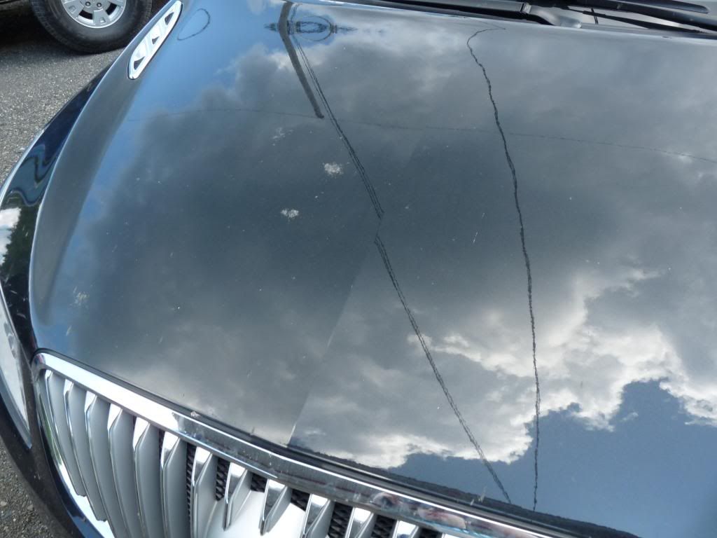

    The customer came to me at the end of May asking for a quote for a wash & wax. Unfortunately, he went to the local hand car wash to get the job done instead of bringing the car to me. And guess what ? He called back 2 weeks ago asking if I could do something with the swirls he now has all over his paint. Once the el cheapo wax/filler used by the carwash faded, he realized his mistake !
    Now the main goal was to remove those swirls and make the metallic to really pop.

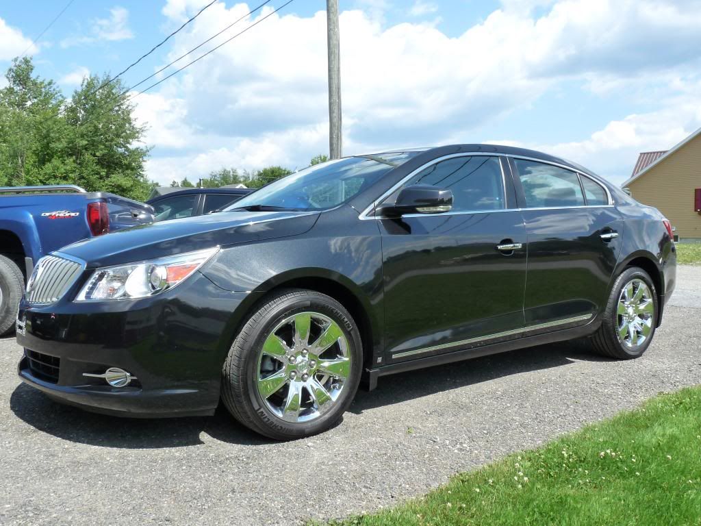

    Befores :
    Re: 2010 Metallic Black Buick Lacrosse

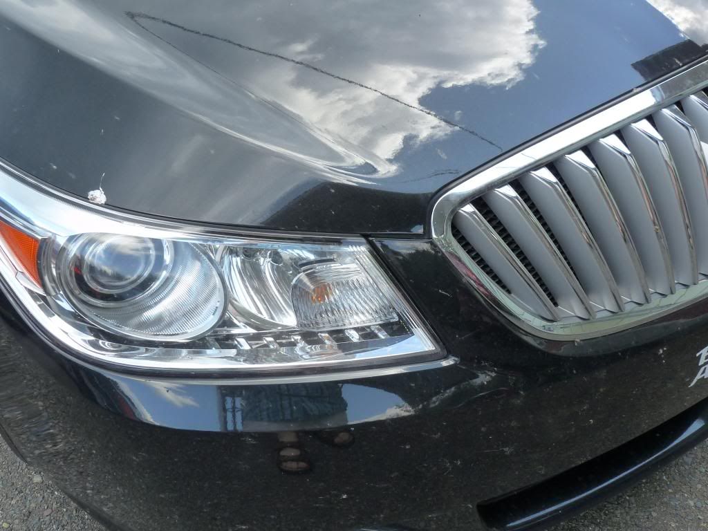

    But a closer look…
    Chrome rims that don’t look chrome at all.

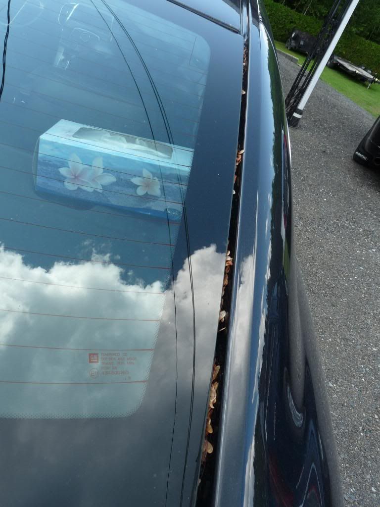

      He has a few trees beside his driveway.

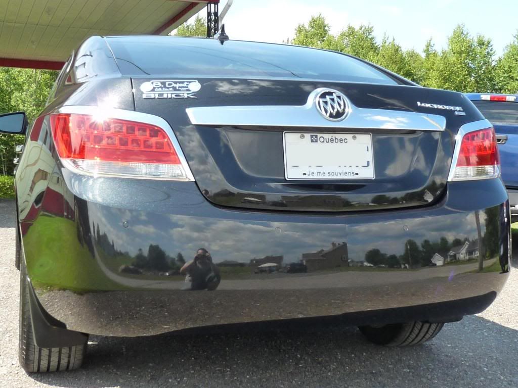

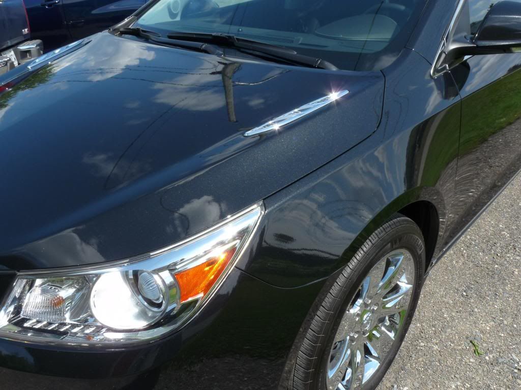

        Process:
        Began at 7h45 and was done at 2h30.
        Wash rims, tires and wheel wells with NXT soap and APC
        Wash with NXT and a few drops of APC for a stronger cleaning power
        Clay with Ricardo Yellow Clay and LastTouch 1/1 as a lube
        Rewash with Gold Class
        D300 Correction Compound with a 5,5 Correction MF pad on the back bumper and a few deeper scratches
        Ultimate Polish with a white 5,5” LC pad
        Gold Class Carnauba Plus Liquid Wax with a red 6,5” LC pad
        High Tech Yellow Wax M26 with a red 6,5” LC pad
        Ultimate Quick Wax in the jambs, rims and side windows
        Endurance Tire Spray on the tires
        Ultimate Protectant Spray on the flaps

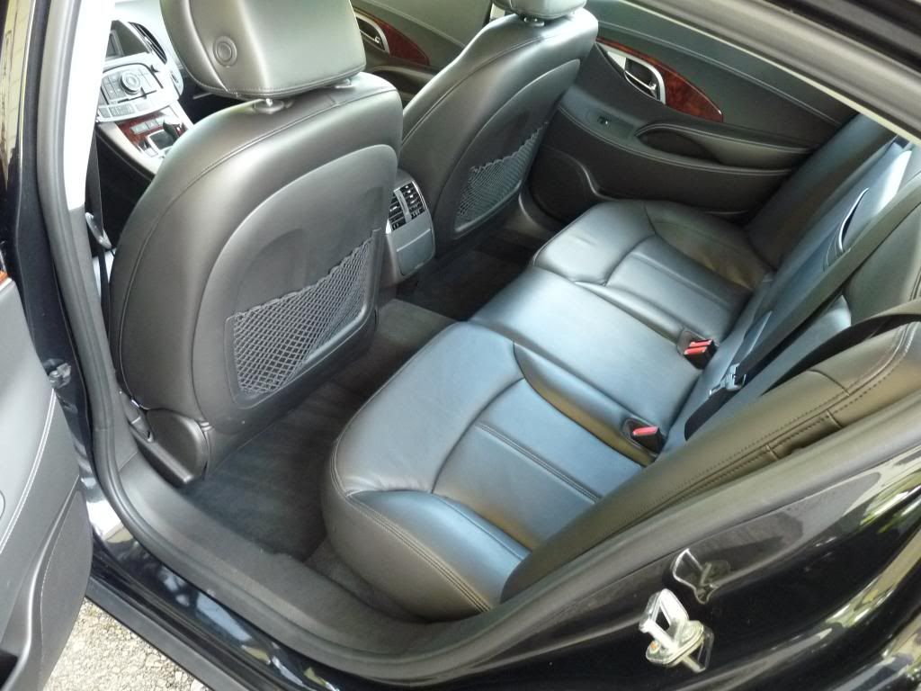

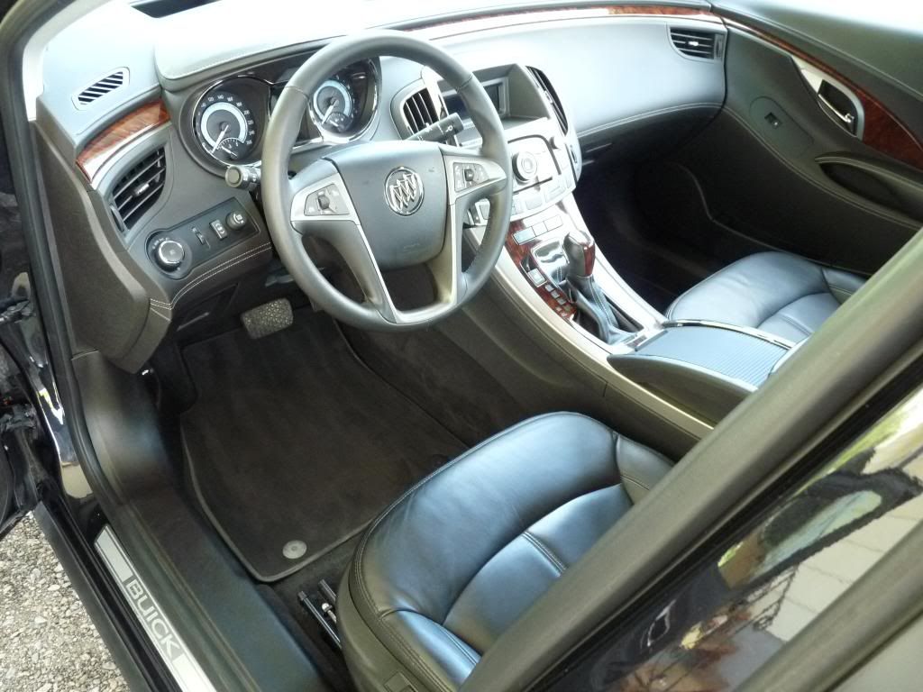

        Vacuum/dry brush/vacuum
        Spot cleaned with Quick Out Carpet Cleaner
        Cleaned windows using NXT Glass Cleaner
        Cleaned/dressed vinyl and seats using Quick Interior Detailer

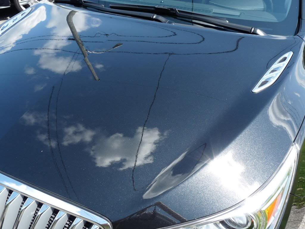

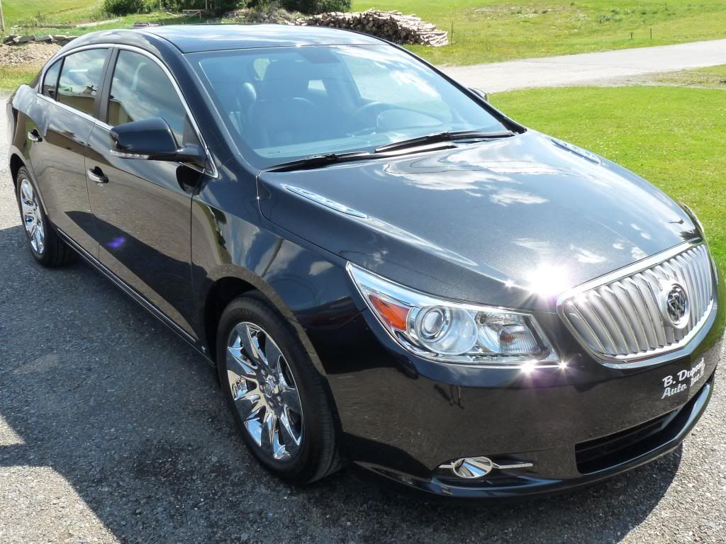

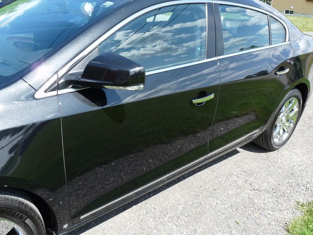

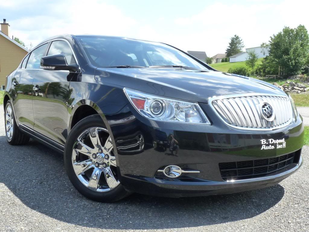

        Afters :
          With my “small” shopvac.

            All in all, I really enjoyed working on this gorgeous Buick. I like the look of this black one better thant the metallic white Lacrosse I detailed a few week ago.
            The owner was very happy with how the flakes in the paint were popping in the sun. He also told me that he should have come to me at first instead of going the cheap route and go to the carwash. He wanted to save and ended up spending more to get the car shining how he wanted it.
