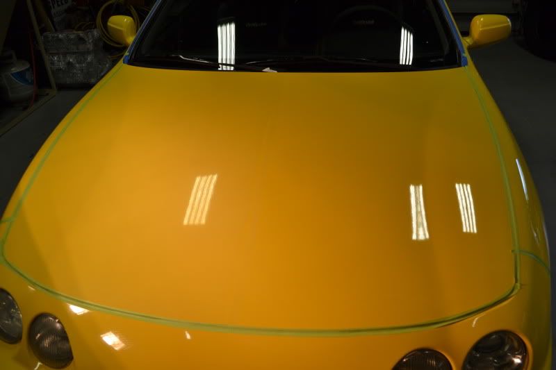

    -Single pass with M205 on a Black/Gray CCS Pad; Speed 6 on the PCXP.
    -Finished with AutoGlym High-Definition Wax for the added gloss and slickness.
    Before polishing, after wash only; you can clearly see the level of oxidation I was dealing with.

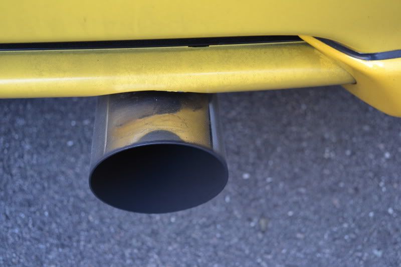

    The rear bumper of the car was covered in burnt oil. Even clay would not touch most of it, but the M205 took care of it right away!

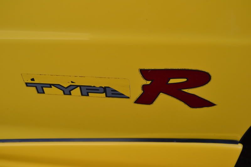

    Out came the heat gun and 3M Adhesive Remover.
    Again, this is the rear of the car.
    Taped up:
    50/50
    BIG DIFFERENCE. That combo worked very well, so it was used to complete the job.

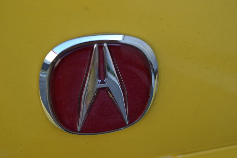

                Why did you remove the type r badge from the back?
                  Re: 2000 Acura Integra Type-R
                  The client requested all Type-R badging to be removed.
                  The car will be getting a full restoration following the completion of Type-R EXPO. So it will be getting repainted with a Base/Clear process, and new stickers for the sides and rear.
