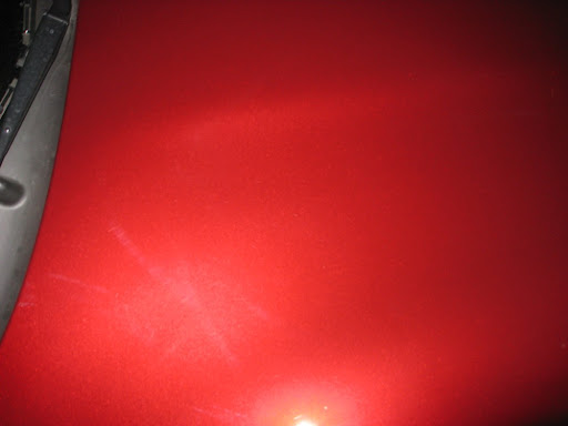

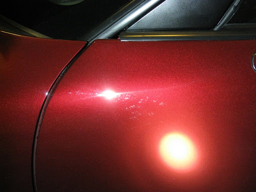

    After claying the car, I performed an IPA wipe down to see the true condition of the paint. More swirls showed up but it wasn't as bad. There were a couple of bad spots. It looked like someone dragged an object over the paint on some areas. Overall, the paint was in great shape and I was excited. Here are some pictures of the swirls I was dealing with.

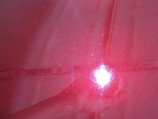

    I knew that corvette's clear coats are HARD. I went ahead and used M105 right off the bat. One some areas, I even had to hit the paint 2-3 times!!! There were a lot of deep RIDS that required wetsanding but I wasn't going to do that without a paint thickness guage. Those RIDS were annoying the heck out of me! Anyway, here are some 50/50 shots that were worth posting. Most of the pictures I took didn't really show the difference because the paint was flushing the light out...

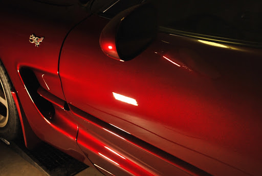

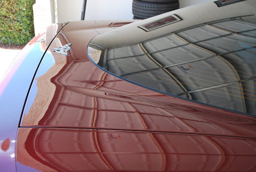

    Here are some photos of the car after removing the sealant. I was amazed at how it turned out. The reflections were crisp and clear. The shine was amazing. Too bad I finished the detail at night so there are no sun shots yet.
