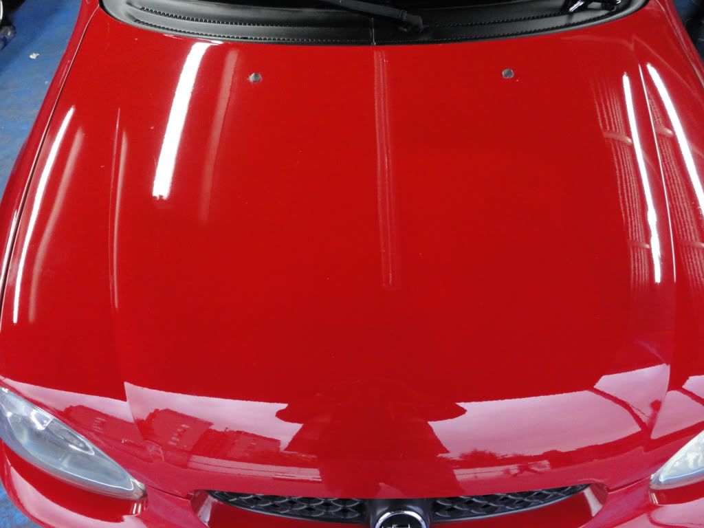

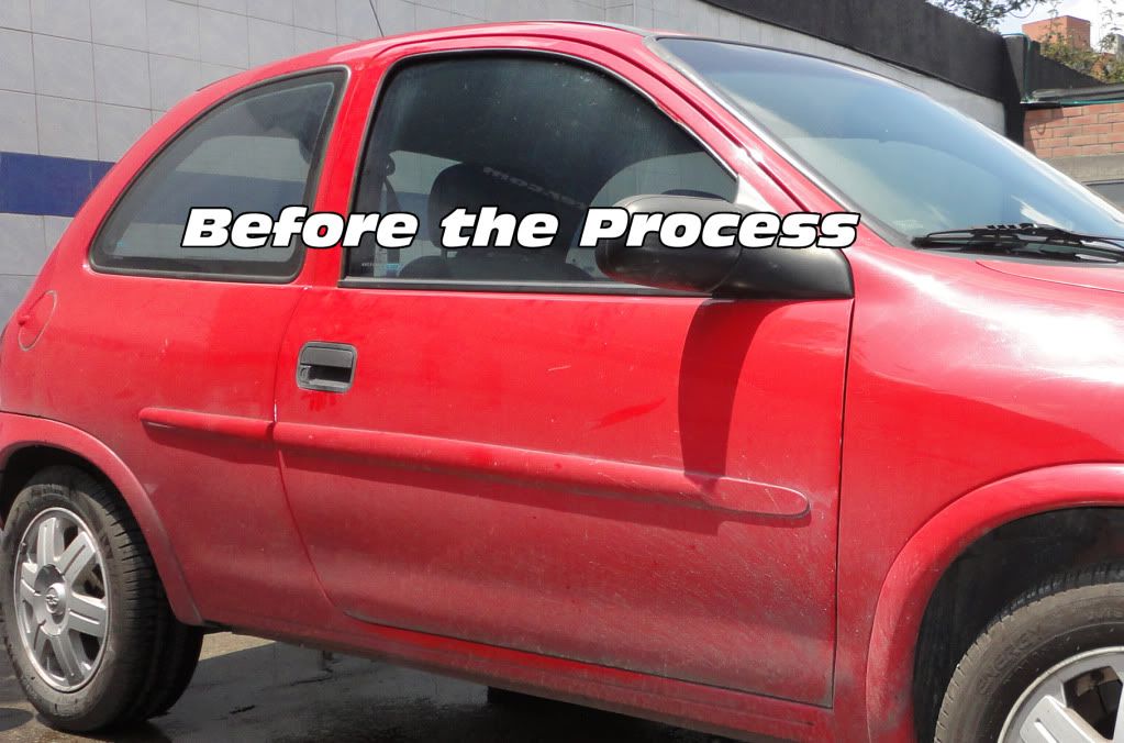

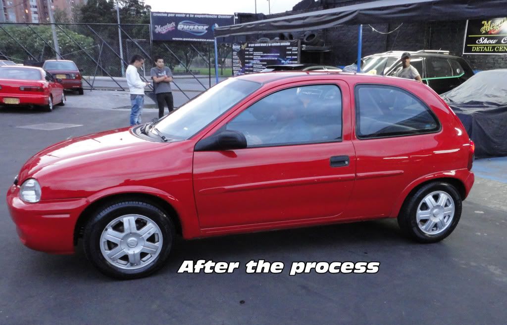

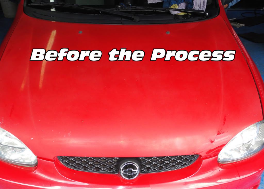

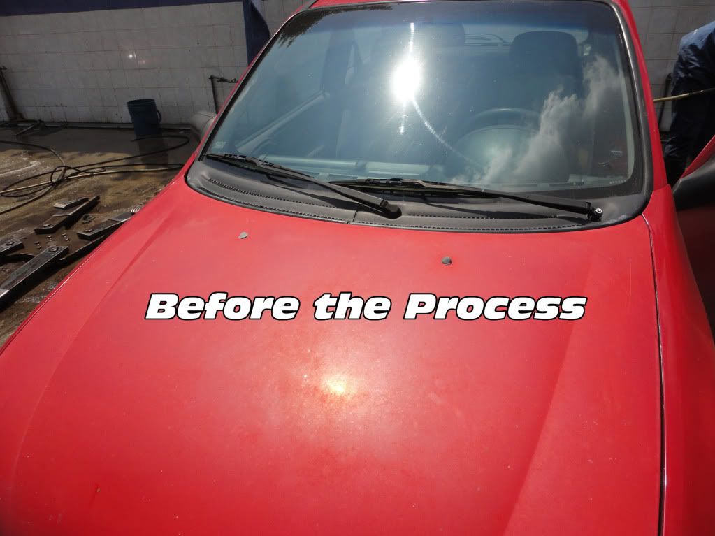

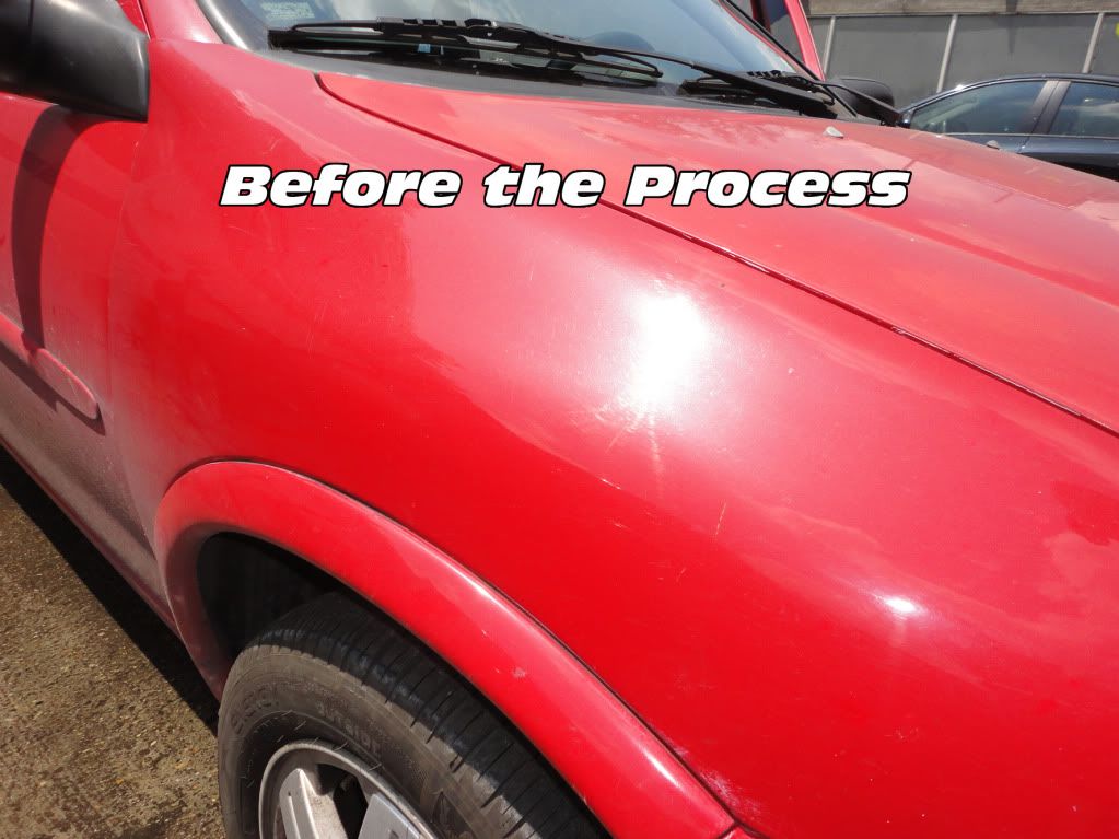

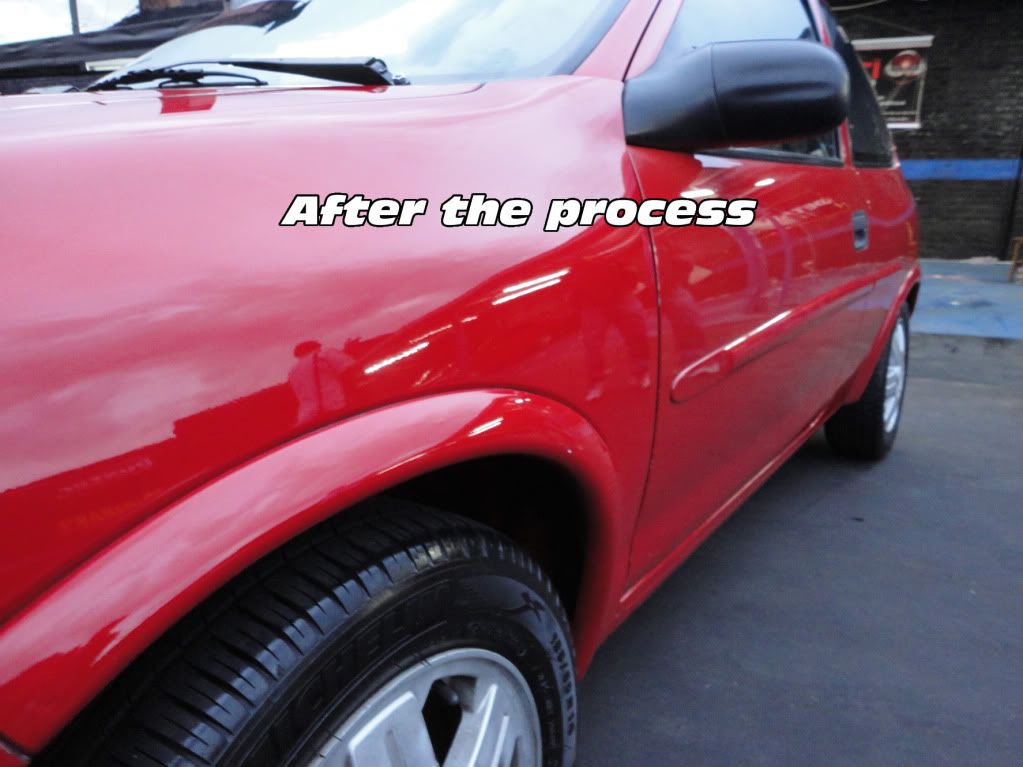

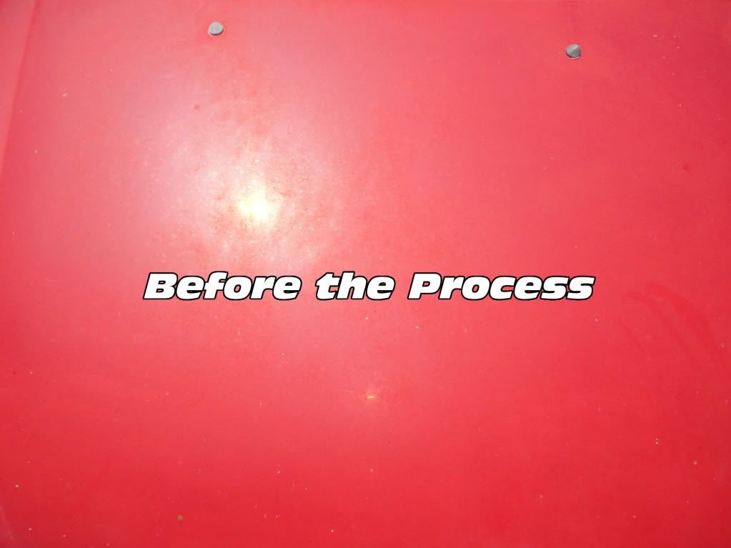

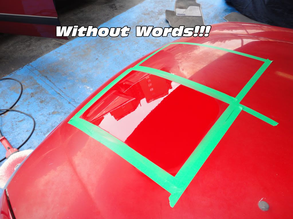

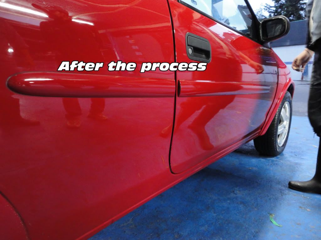

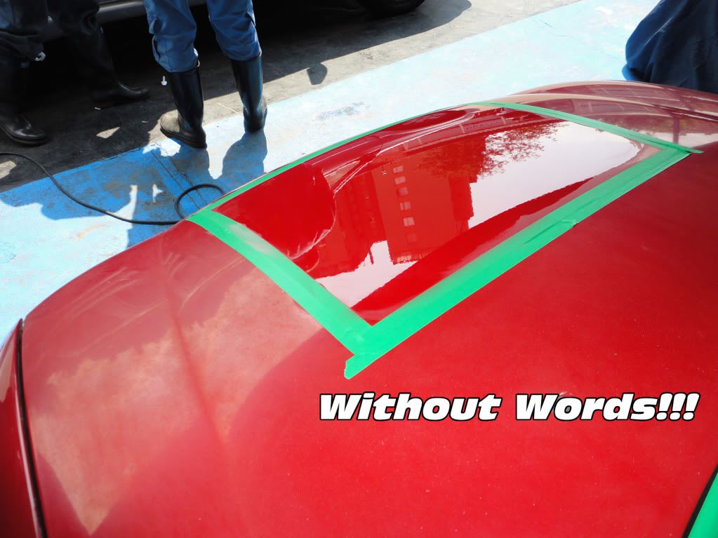

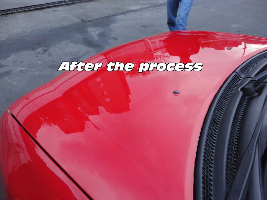

    Hi everybody this is our new work... Another paint restoration this work is from Bogota Colombia south America!
    :::: Duster Car Clean Experience ::::
    we just work with meguiar´s products
    soooo start!!!
    Body process
    1. wash with meguiar´s ultimate wash & wax
    2. 105 ultra cut compound with rotatory and wool pad (1 times)
    4. 205 ultra finishing polish whit rotatory and soft buff 2.0 yellow one (1 times)
    5. Synthetic sealant with DA and soft buff 2.0 black one (one time)
    soooo start !!
    Remember that this process was done with only Meguiar's products and workmanship 100% Colombian!!!
    Also remember to leave your message about our work

    Awesome work Kristhian
    Remove swirls my friends.
      Re: New restoration paint from Duster Colombia
      Wow Kristhian, nice work.
      2011 Jet Black 328i Touring
      2007 Jet Black 335i Sedan
        looks like a new car! nice work!
        1976 Cutlass S
        2001 PT Cruiser
        1990 454SS
        1989
        Suburban

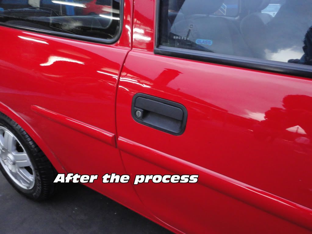

          Nice work man! Car looks great.
          Might want to try something on those door handles though. They look like they could be a bit blacker which would contrast really nicely with that deep red
          Tedrow's Detailing
          845-642-1698
            you lie... you painted it...
            No seriously, great work on cleaning up those oxidation.
            By one time, how many passes was there?
              Amazing turnaround! I miss Bogota, went there a few years ago (2004,2006) to visit family as an adult for the first time and it was amazing!
                HI executionerhk!
                Just one passes! each of the products.... but you know one very slowly passes! working with passion!! like meguiar´s works for us!!!
