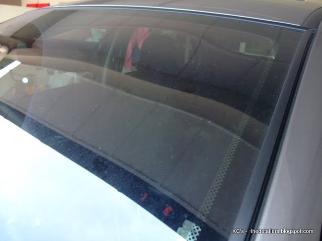

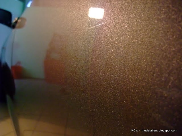

look at the amount of dust & dirt trapped
little bit more

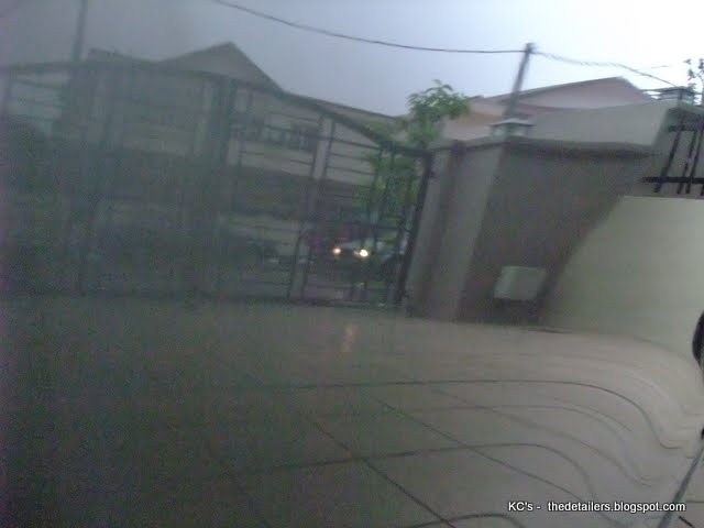

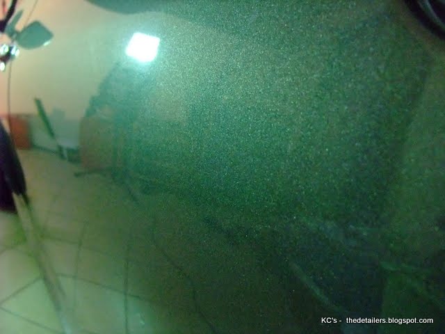

rain ....... & dirt
more the boot jams area

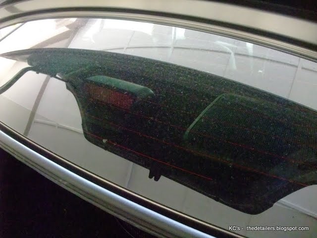

more on the rear

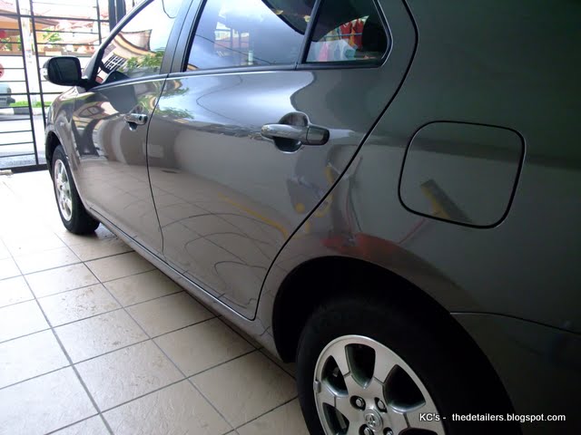

look at the amount of contamination picked up in such a short time
tars....& road grime
more things picked up along the way

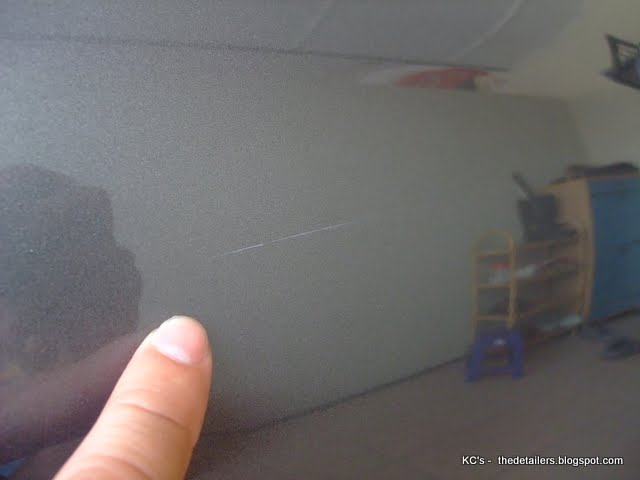

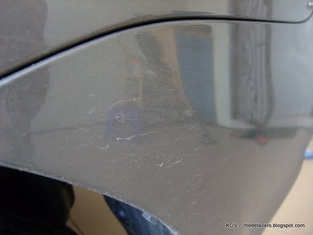

scratches already found - another abuse - far too much insane & vandaliser found on our roads
close up
another fine scratches found on the bottom of the rear bumper

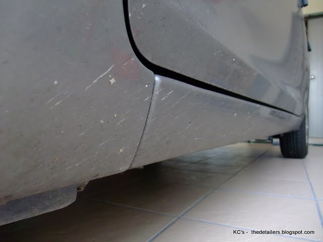

more picked up along the side skirt
more

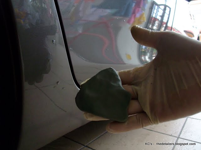

do you realised that - i was wearing a surgical glove while claying - coincidently while protecting a cut on my fingers & it seems to be the best for testing surface above contaminations.....I used to see others by putting on sandwich bag in their hand gliding on top of the paint to test surface imperfection ...but I have to agree with Matt Davis Meguiars Asia "less is more" why put our paint to more stress & danger
Apparently, i found an accidental hero - surgical glove.. if you cant feel it - you wouldn't know whether to remove.....* kindly rinse off prior moving on to the next area
*can you feel the love tonight*
feeling it

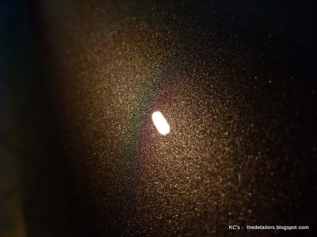

here is just some of the before & after pic - many more defect pics was not taken as I was fighting against time & deadline to deliver the car
some scratches found on the hood
ta da

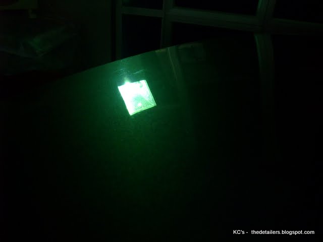

look carefully.......
nothing wrong...close up & proper lighting & angle
remember the scratches before
with proper lightings
more
ta da
ta da

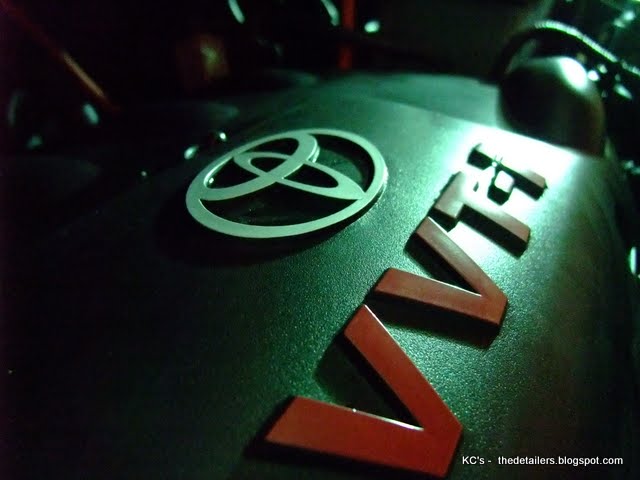

the detail engine bay
before
now
protected by Optimum leather protectant
before
now

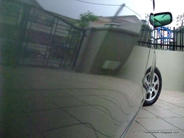

the gloss
