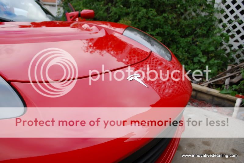

    Some more shots....finished up the correction.
    Interior Detail as well, we go above and beyond....
    Final inspection and wipe down...
    Final shots...
