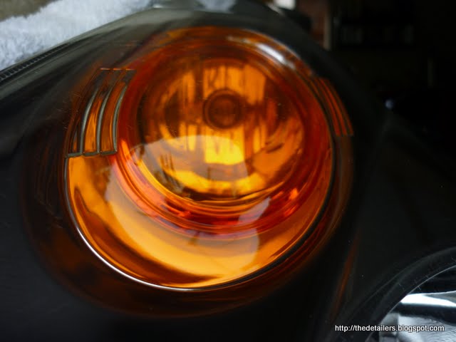

    moving on damaged oxidised head lamp
    closer pic
    take a closer look
    extreme close look.....cracks
    side view
    correction begins - sand down with 1000 grit sand paper - follow by 1200 grit & 1500 grits - ending with 2000 grits
    although is fine but the deeper crack need to be levelled out by continues of 800 grit sand paper

    50/50%
    after
    before
    the prefect 3" pad
    polished by the specially flown in pads from US lakers....Lake country
    for it takes a cobbler to know his tools
    ta da
    tada
    side view
    now
    extreme close up before & now
    Now
    remember before
    A restored head lamp
    ta da
    ta da
    this head lamp is coated & protected by Opticoat (one time applications)

    a restored head lamp
    right side lamp
    close up pic
