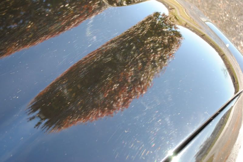

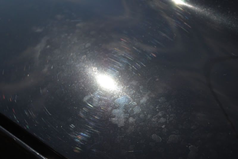

    This is my personal vehicle and it was in the possession of a friend of mine for a couple months. He was being nice when he washed my car, but I'm very particular about even ME touching it. So I had to resist cringing when I heard it'd been washed twice. My friend is trying to get better about detailing/washing, so he's learning and fortunately a majority of the "damage" was correctable. It also hadn't been detailed properly since early May since I acquired a severe injury from my other sport, horses
    I used a 7424xp with M205 on an orange waffle pad. I did not acquire a 100% correction or even a 95% correction for that matter, but it looked better than it did and that was the objective.
    Washed with a Dawn/Citrus mix
    Zaino RED clay bar
    M205 (2-3 passes)
    Finalized with Meguiar's Carnauba wax (3 coats)
    These haven't been altered by any means, no change of brightness, you're seeing the images as they were taken. May I also remind ya'll how much I hate black?

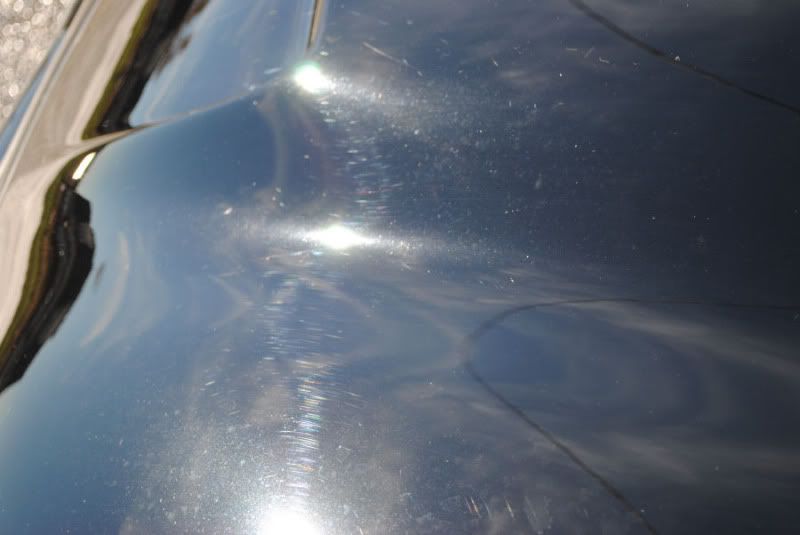

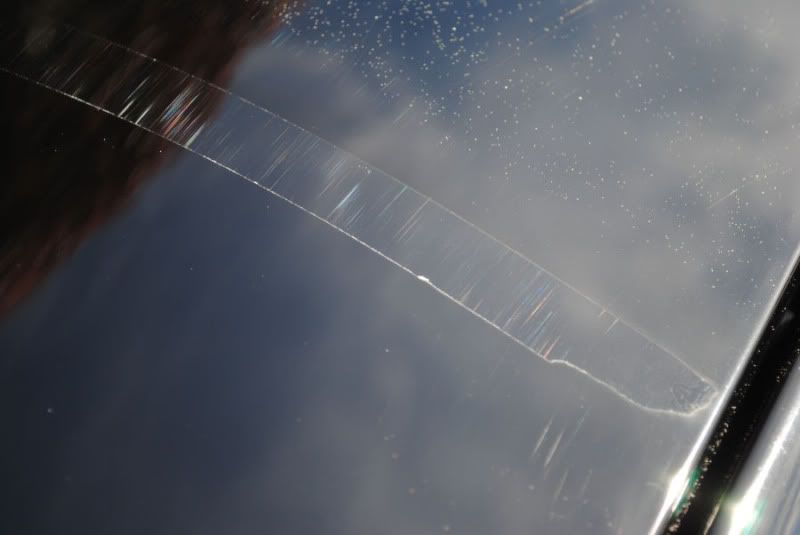

    You can see where most of the pressure was directed and where I skimped
    Again, the next two show where I focused more on and where I tended to "feather" over and not direct on the first/second pass.

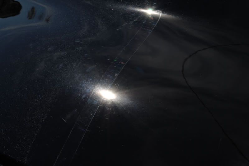

    Hood before:

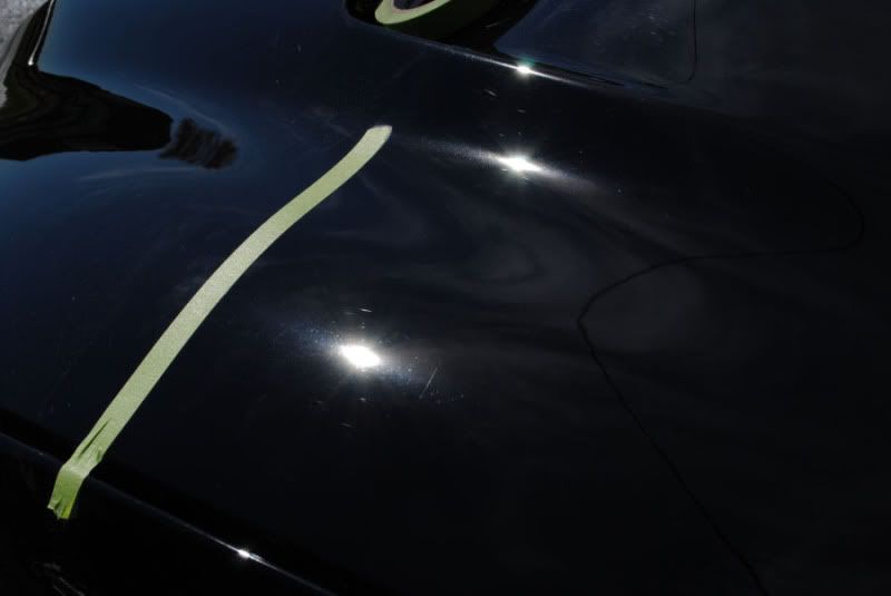

    Hood After:
    Needless to say another round of correction will be needed. I'm sure I could acquire it in a single run with a Rotary, but I don't trust myself enough yet buy one let alone use.

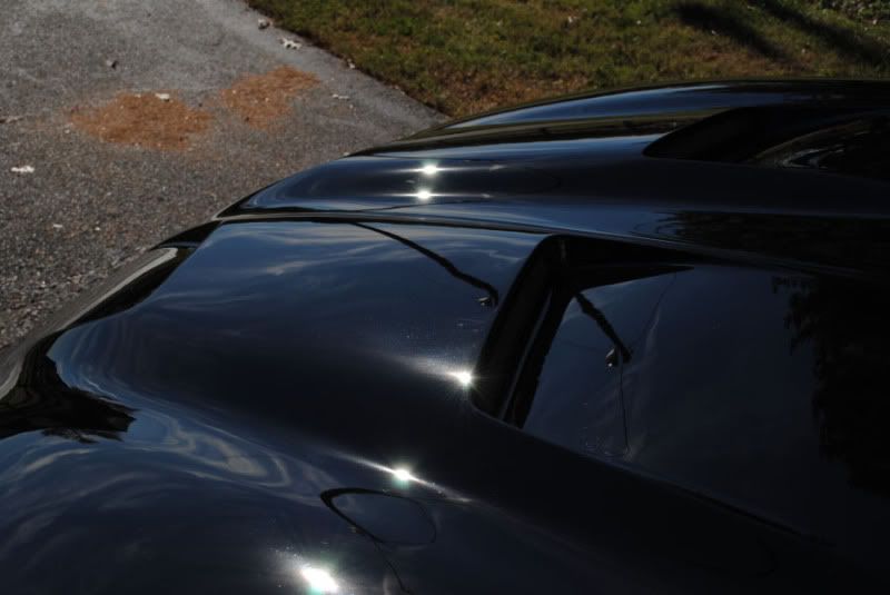

          I agree with Michael Stoops, try Ultimate Compound. I achieved this result with a single pass on a yellow Meg's pad:
