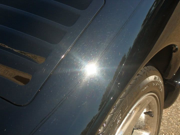

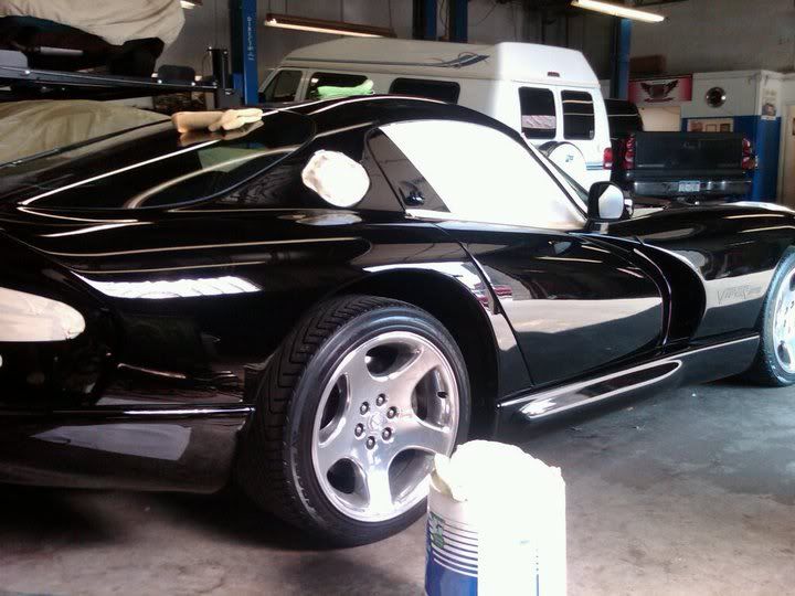

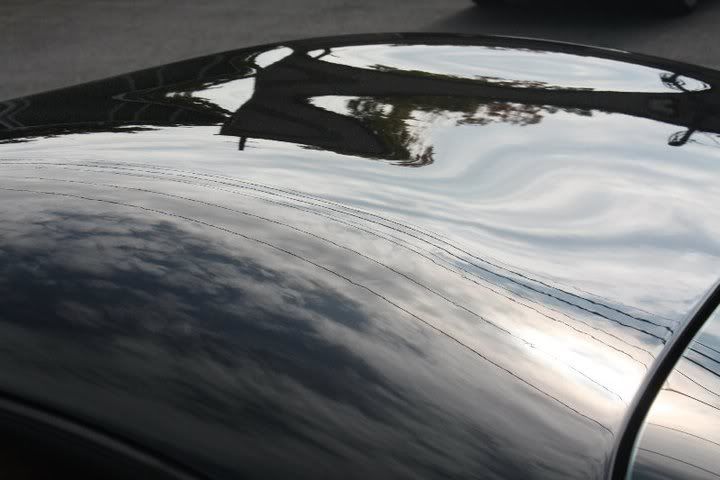

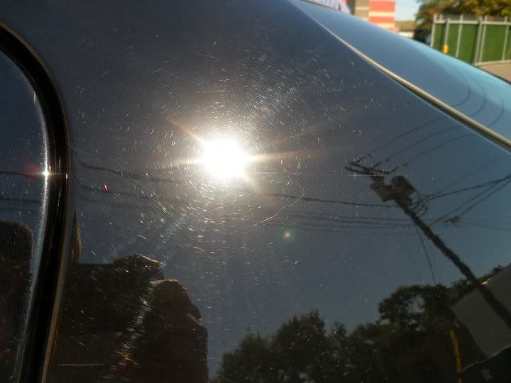

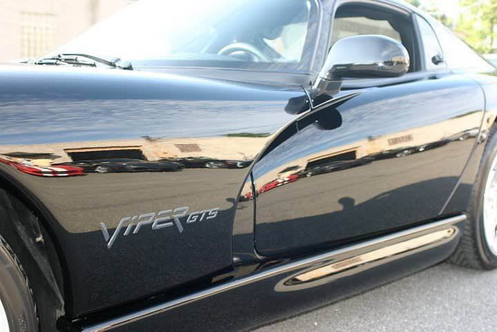

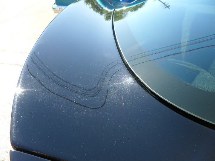

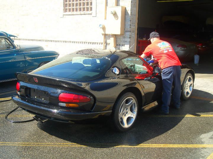

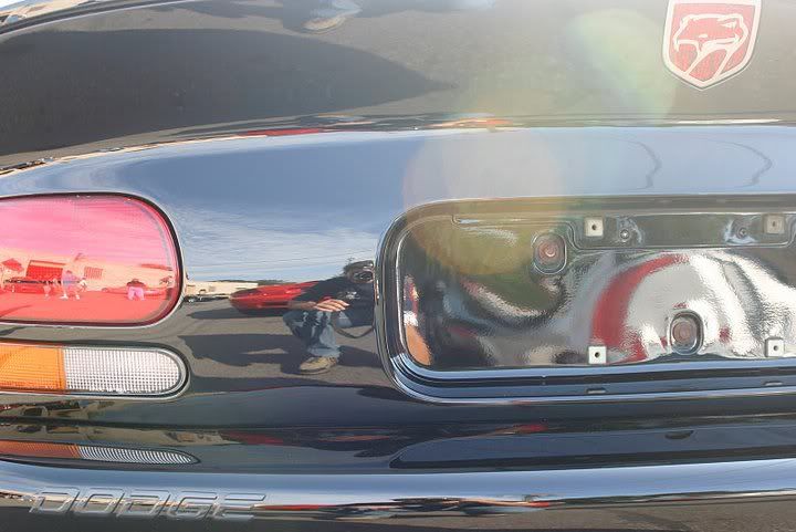

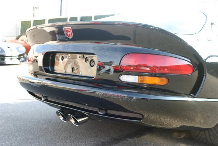

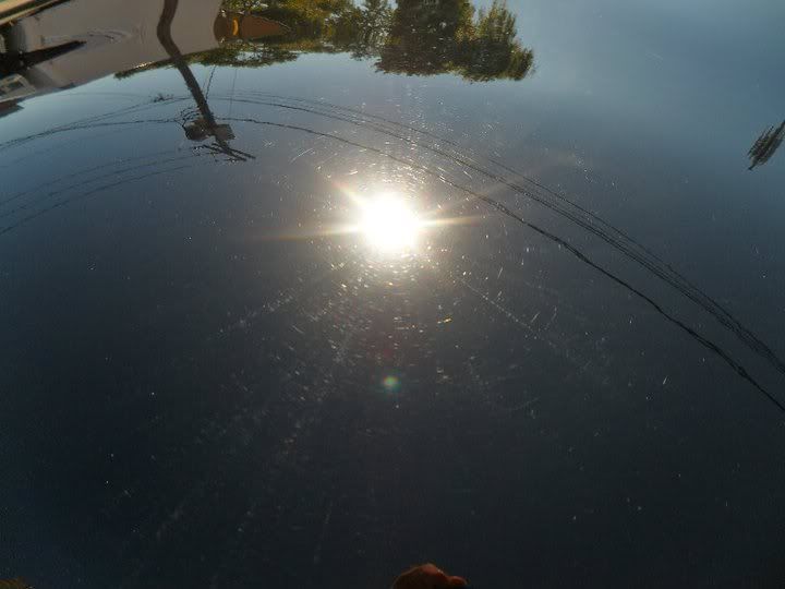

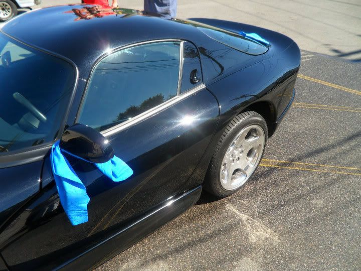

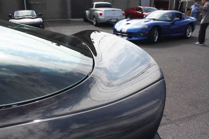

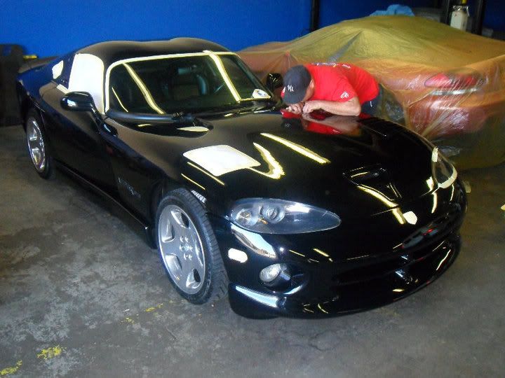

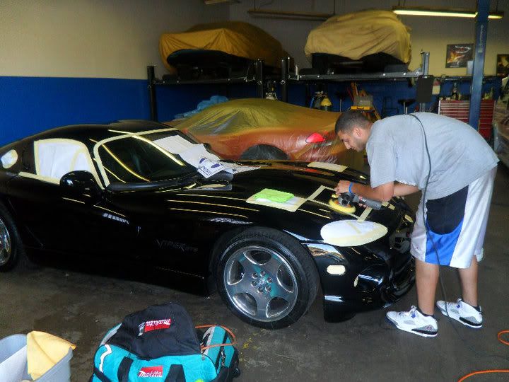

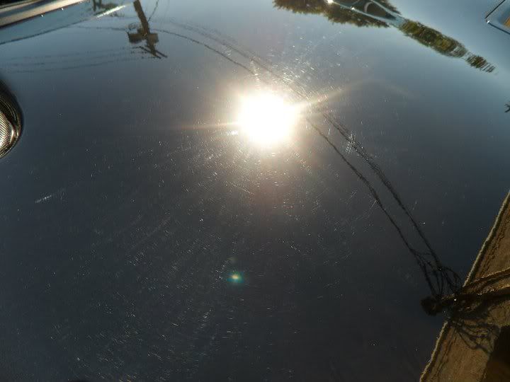

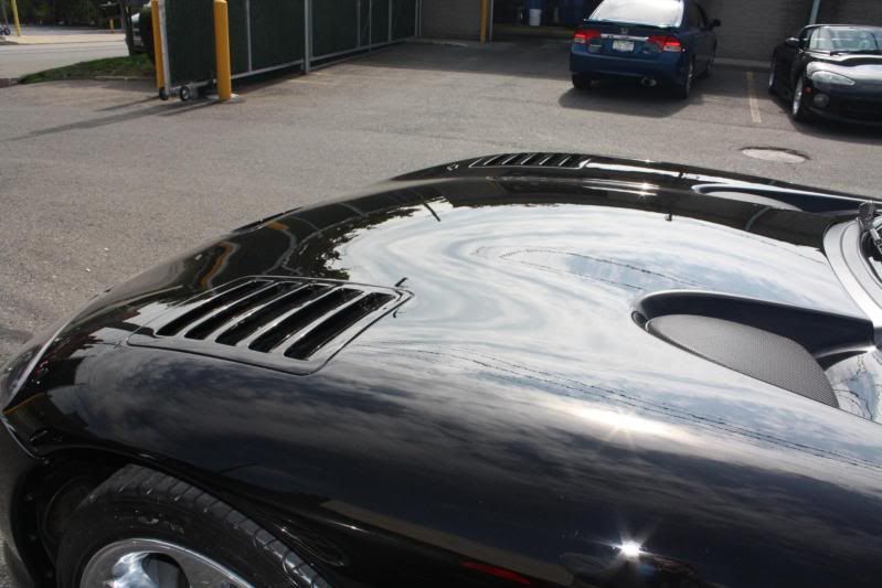

    We had this 2000 GTS Viper come our way last week and I actually took some pictures of most of the process so I figured Id share them with you guys. The Viper took a total of 15 hours to remove all imperfections in the paint and the owner (also the president of the club) was amazed! We recently became sponsors for the VCA NY/CT Region so we did this car the week before we hosted an event at Snake Pit Performance in NY for all of the VCA members to get a good look at what we do.

    Wow! Looks amazing. Looks like you guys had to fold yourselves in half to do the hood. Lol.

      Excellent work on the Viper!

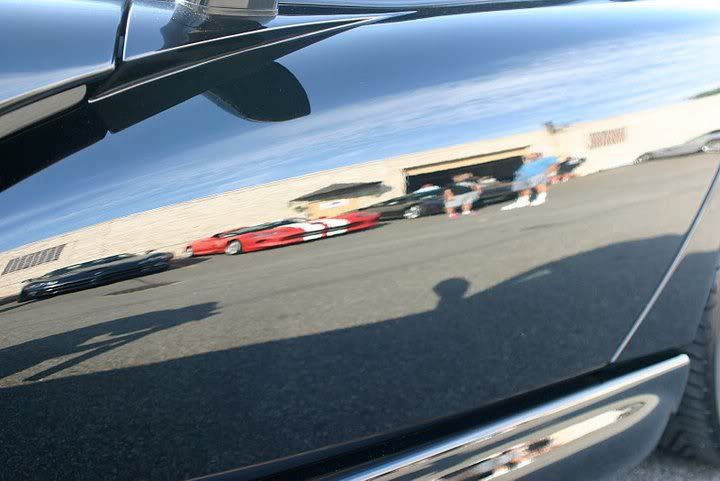

        Very much improved. You can really see the peel when the lic plate was off. I see what prep work you did but more to the point what pads, chemicals and so on did you use to get the results?
          Re: 2000 Viper GTS
          That paint looks amazing! What was your process?

            The viper looks great. Tremendous improvement.

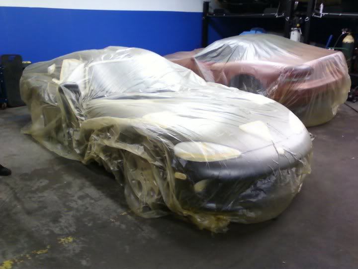

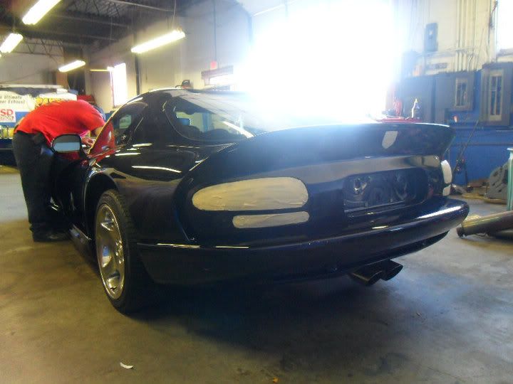

              How come you had it all covered?
                Re: 2000 Viper GTS
                Originally posted by aris View Post
                Nice work
                We were hosting a event for the Viper Club of America NY/CT members at Snakepit Performance in NY the next day. We had it covered so it wouldnt get dusty over night. We have some pretty cool pictures from the event including burn out pictures from a 1000 rwhp viper! There are too many pictures to upload so if you want search Synergy Detailing in Facebook to look at the album.
                As for the process and products, here is what we did.
                Wash using the 2 bucket method w/ Gold Class Shampoo
                Clay bar the entire car using Meguiars Aggressive Clay
                Tape up w/ 3m masking tape
                Compound using m105 w/ yellow LC and DAPC (3 passes on every 2 x 2 section)
                Take tape off
                Polish using m205 w/ orange LC and DAPC (2 passes on every 2 x 2 section)
                Sealed the paint with the new Gold Class Paste Wax
                Polished wheels using a foam applicator w/ Mag & Aluminum Polish
                Dressed tires with Endurance High Gloss
                Conditioned plastics, trim, and wheel wells with interior Natural Shine spray (It works awesome!)
                I think thats pretty much it. I wish I took some better pictures but time was limited! Thanks guys!
