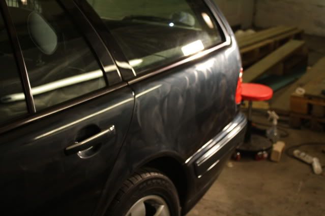

    The car looked pretty dull, it had a lot of swirls from bad washing, and some light oxidation that stole a fair bit of gloss from it`s reflection.

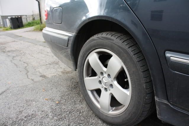

    Wheels were baked in burnt-in brakedust.
    A few before wash-pics:

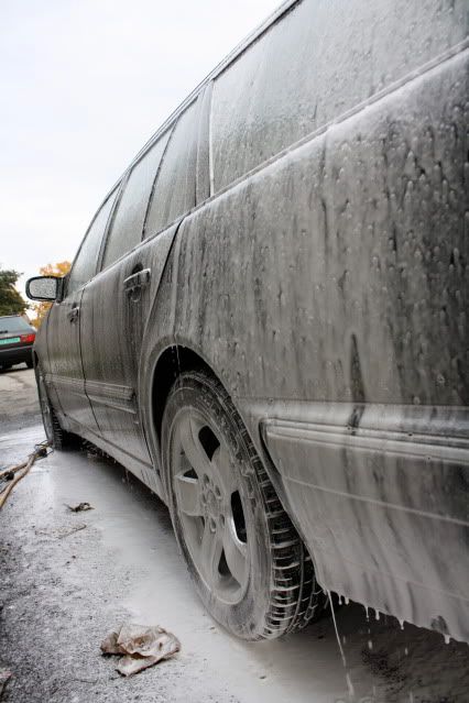

    Then, it was foamed, using a mix of Shampoo Plus, Hyperwash and water
    After foam was rinsed, the car was washed with a chenille washmitt, and NXT soap. Dried with two Watermagnets.

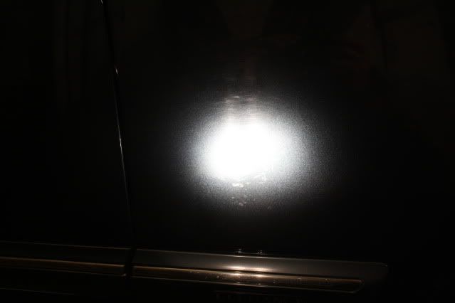

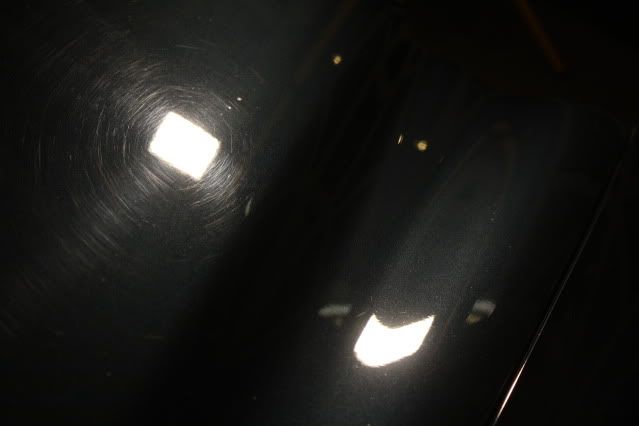

    Paint inspection:

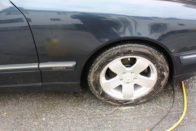

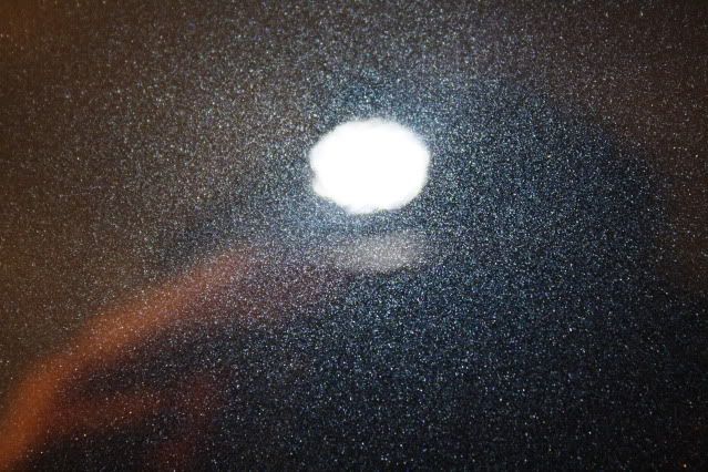

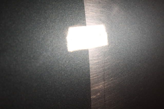

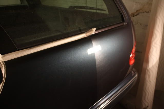

    I knew the paint probably was pretty hard, so the first weapon i tried, was #105 via LC orange pad.
    ended up with this: the smaller scratches are gone, but the pad left some marring. Expected? No -but it`s ok, since this was planned to be a two-step correction.

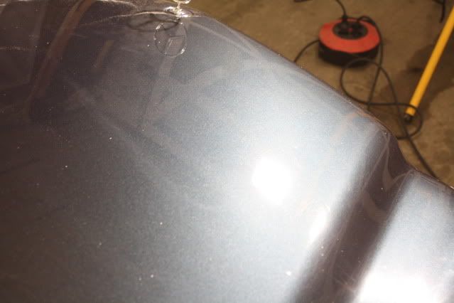

    For the curved part of the hood, i used a smaller LC pad so that i could get to all the parts, and to avoid burning the paint due to pad not being flat on surface.

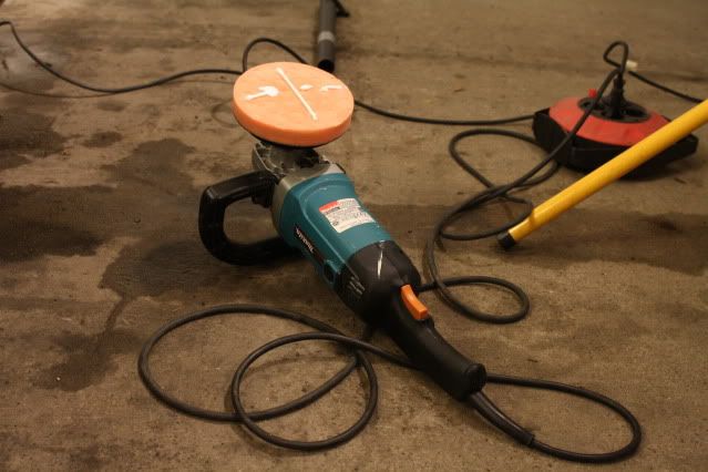

    Various pads were used for correcting, LC 4" and 6" Orange, Polishing and Cutting SoftBuff pads, and Burgundy Wool Pad

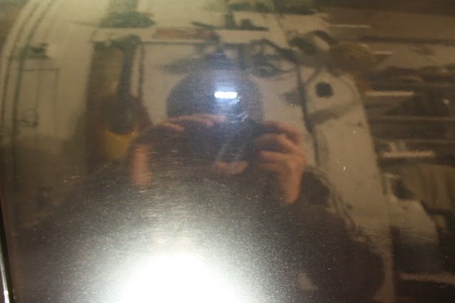

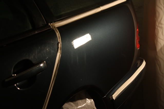

    a few pics from defect removal:

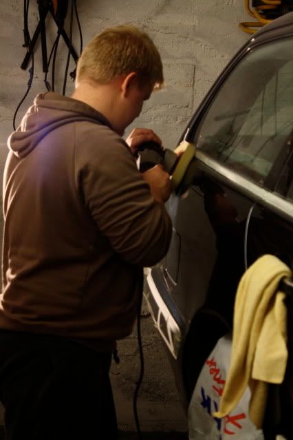

    after this, my trusted apprentice was working over all areas with the DA.
    #205 via yellow SoftBuff pad, mix of "205 and #105 on the heavily hologrammed parts (where the wool had been)

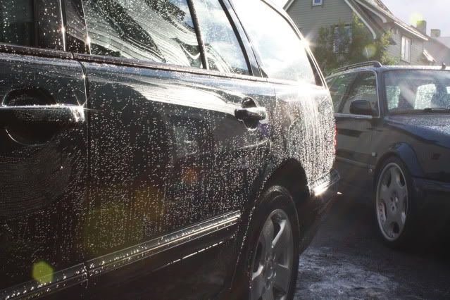

    Finished pics where different on this one. Since the rain was pouring down anyway, I decided to foam-wash the car to get all polishdust off

        Very nice work. I love to see those 50/50 shots. That paint was brought back to life.

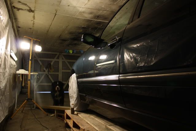

          Like the ramp you have. Makes everything a lot easier.

            Excellent job. (especially on black) Looks like a great workspace you have as well.

              Re: 2002 Mercedes E220 cdi
              Thanks everyone.
              The paint on this one was kind of weird. At first, I thought it was really soft, because all the swirls came out real quick, and i had some holograms even with just the orange LC pad.
              However, the RDS were tough. Almost seemed like the paint got harder the deeper i cut.
              Car ended up looking good in the end though.
              JA, the ramp was set up pretty easily an afternoon, and helps ALOT on my back, knees as well as the quality on the finish on lower panels. I would recommend building one for anyone who don`t want to cash out $2000+ for a lift.
              I even do minor repairs like oil and exhaust in my own car with this setup.
