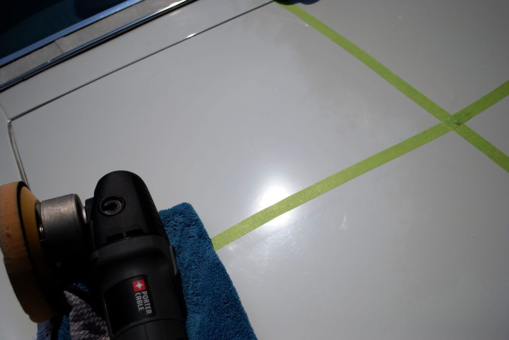

    The first round I did I used Ultimate Compound with an orange pad (7424xp PC) and did not acquire the results I wanted after half the vehicle. So I went back with M105 and an orange pad once again, rather than using my 4 inch pads I used my 6 inch, made things easier but I still got burnt out 75% through the car
    There was no denying a change in the vehicles paint as I worked on it and it was quite rewarding. I didn't aim for a 100% or even a 95%+ correction given the vehicles age and while it was cared for, I thought I cared for my '01 Grand Prix GT by just washing it

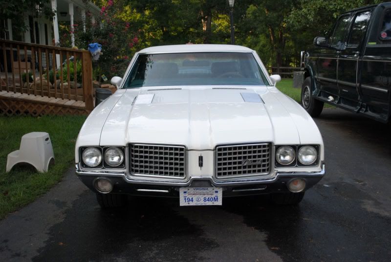

    Here are some of the before pics from the last thread and after follow:
    Before

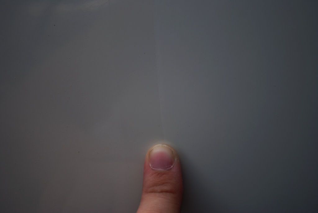

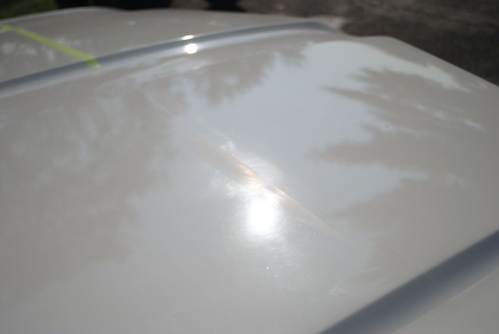

    I had difficulty acquiring an appropriate angle to get the 50/50 of the hood, but you can see a difference in clarity
    Trunk lid, again 50/50 was hard to acquire, no wax again.

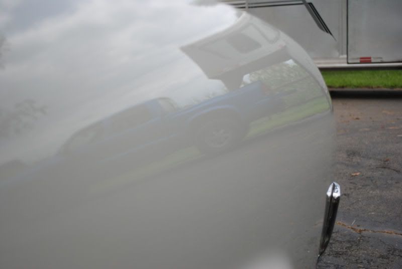

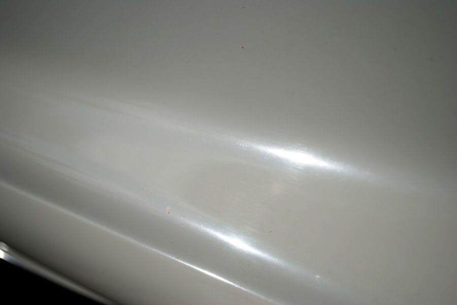

    Right front fender before it was corrected, not very vivid and relatively dull (as already noted)

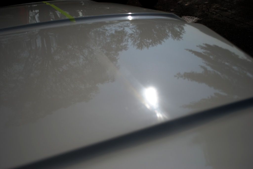

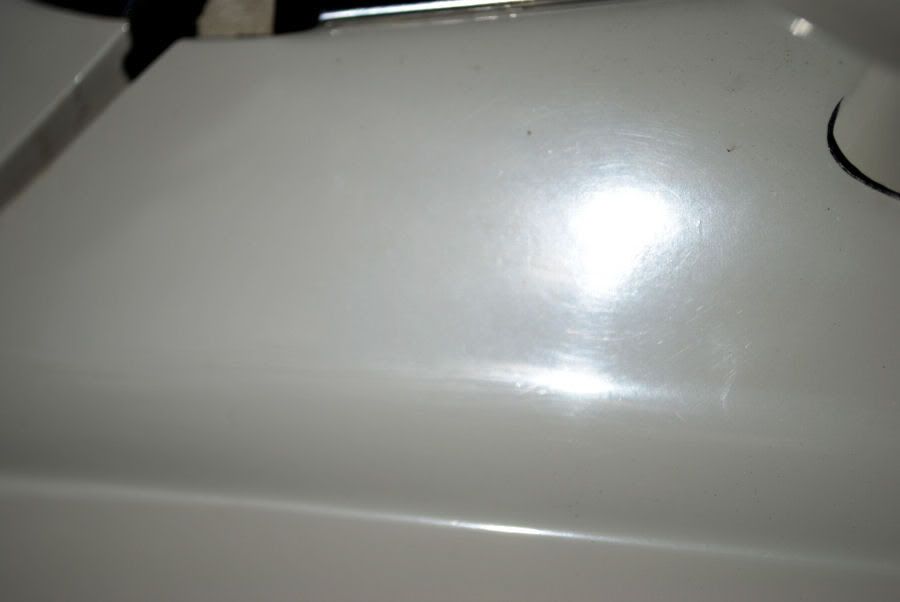

    Right front fender corrected with just M105, no wax. Clearly more vivid and apt to take a vivid reflection.

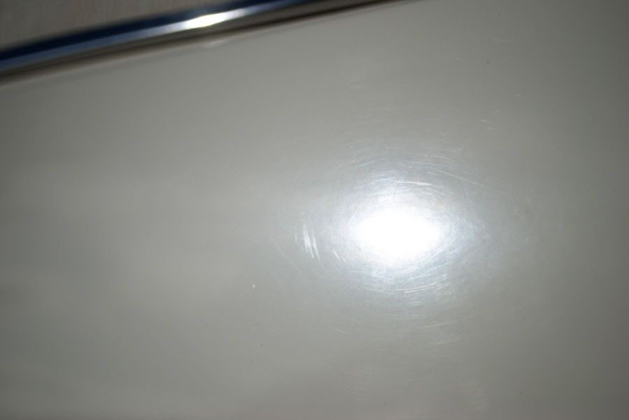

    50/50 of the left rear fender, left obviously not corrected. Nice eggshell white there

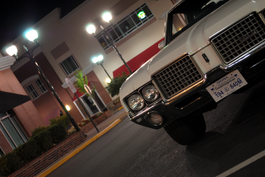

    After the detail, first show out:
    Yea, that's a "Z" tee-shirt, but the only white shirt I have to wear
    Overall I'm satisfied, the paint isn't as reflective as I'd like, but in comparision to what it was... I'm happy.
