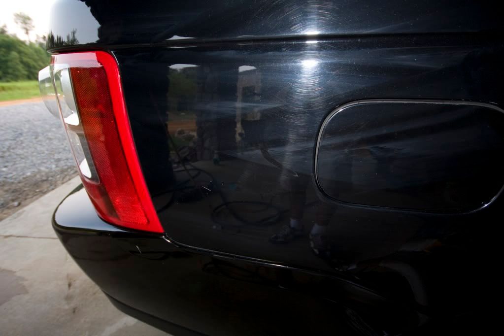

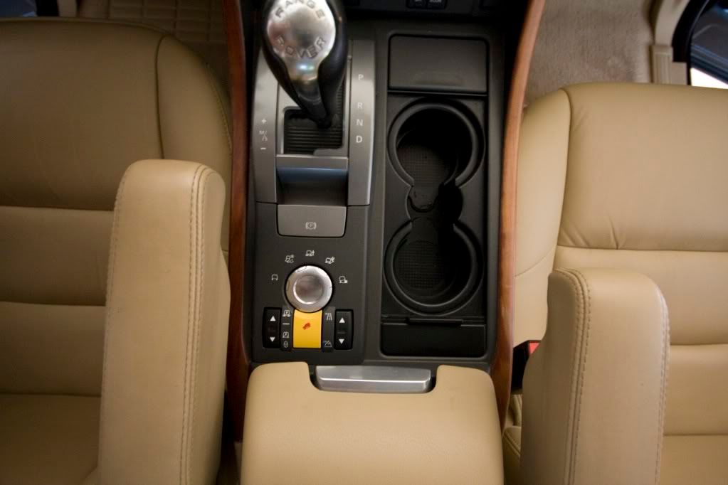

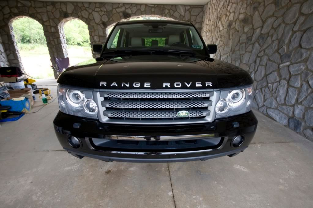

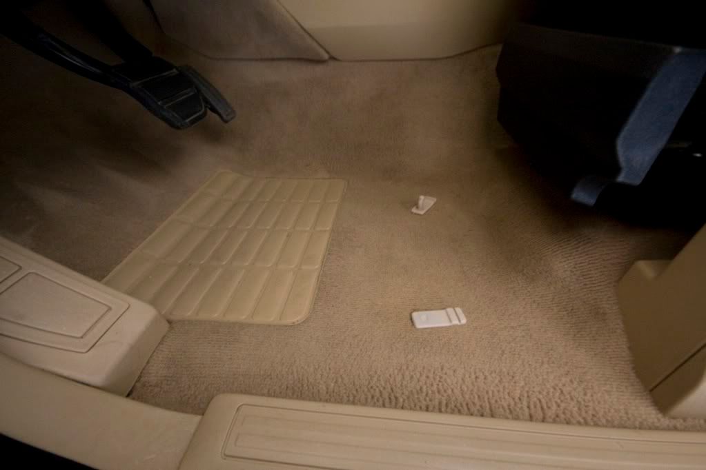

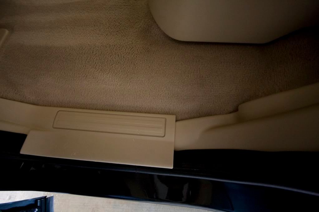

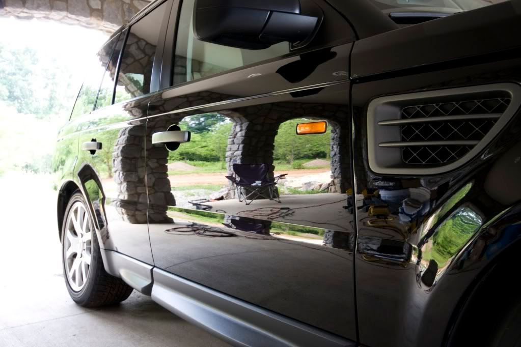

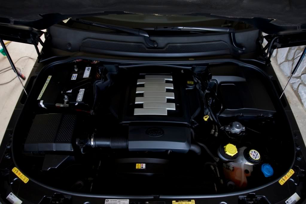

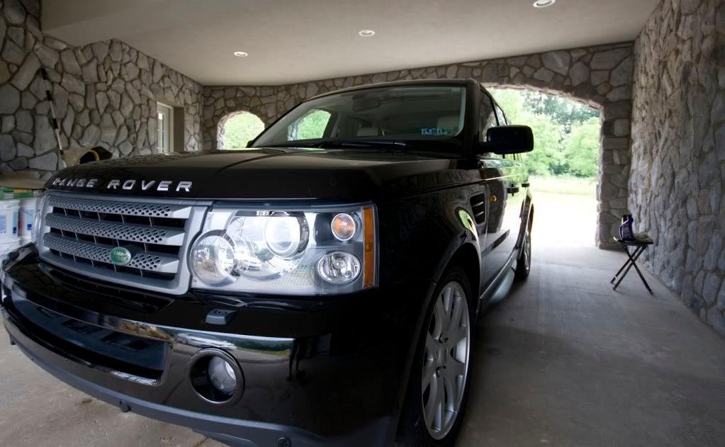

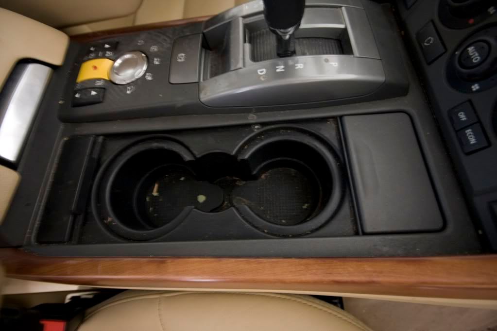

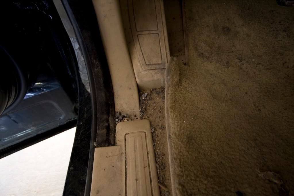

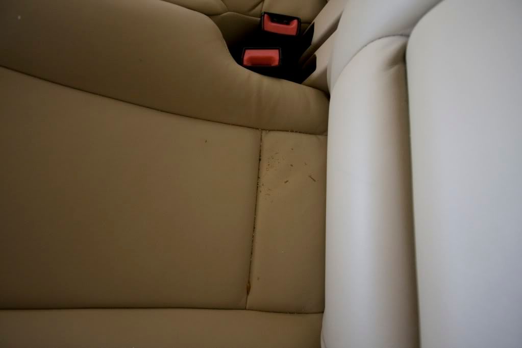

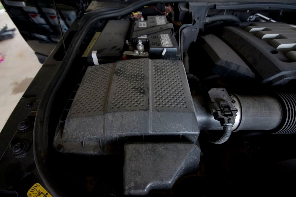

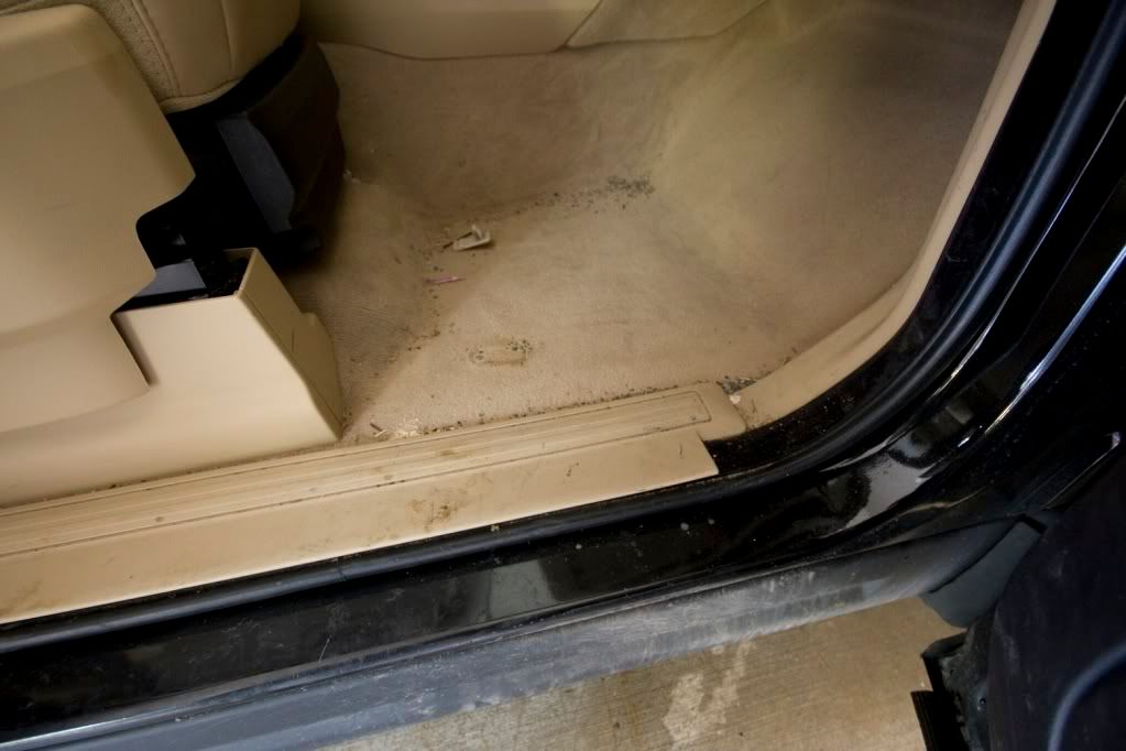

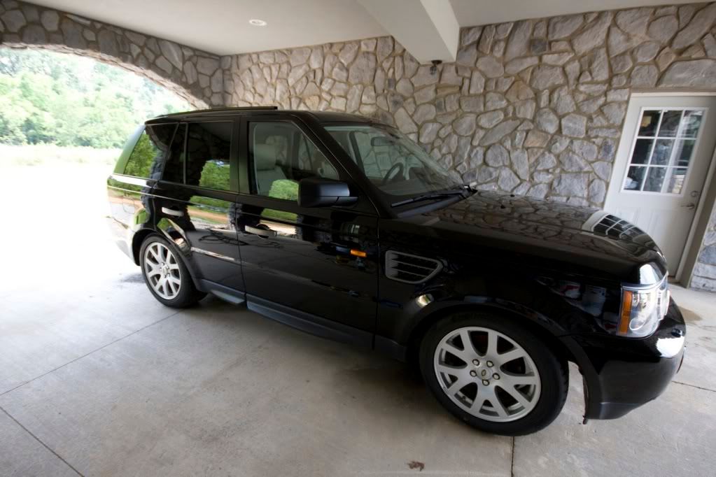

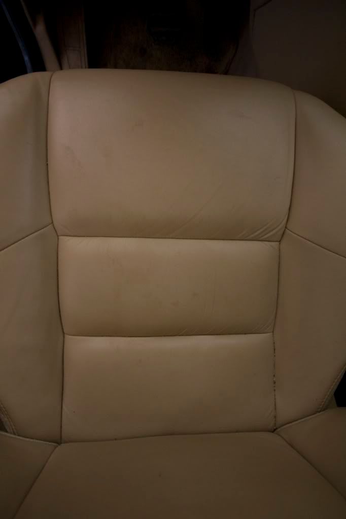

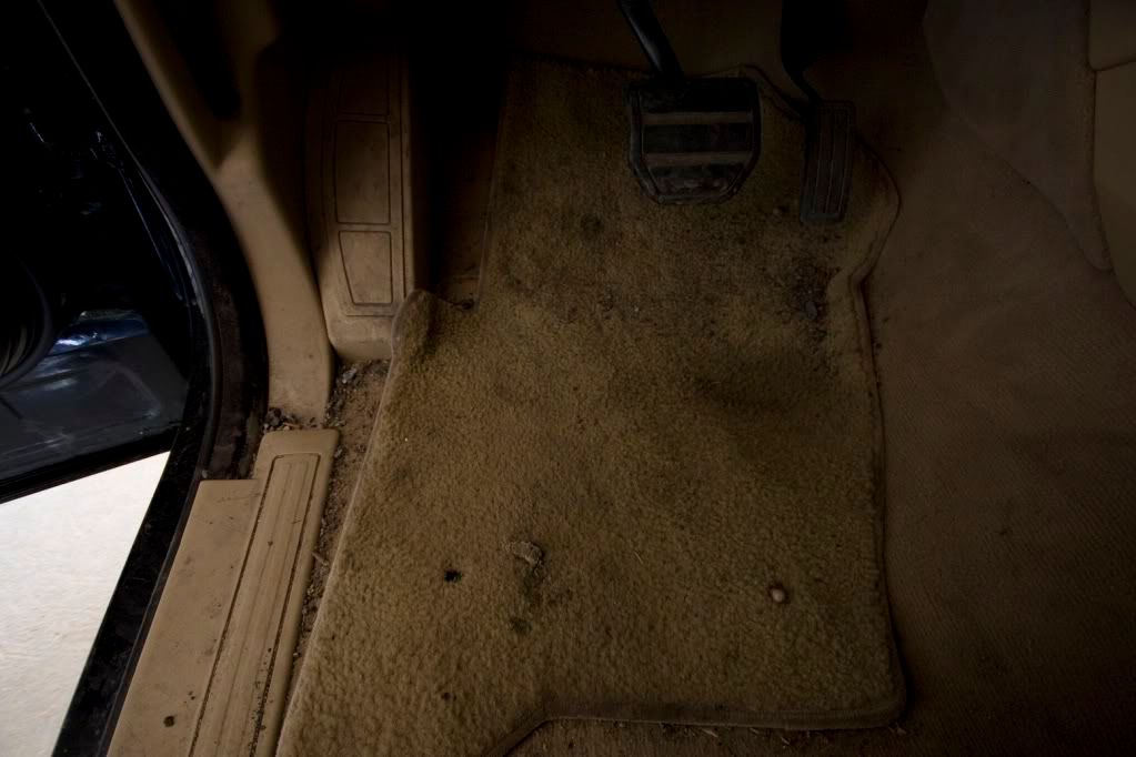

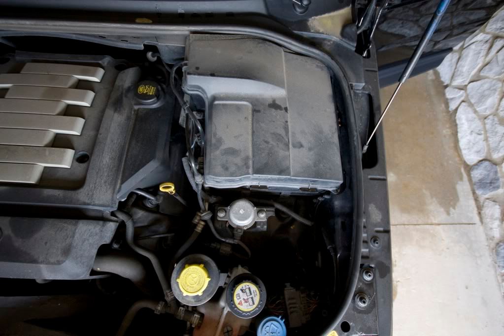

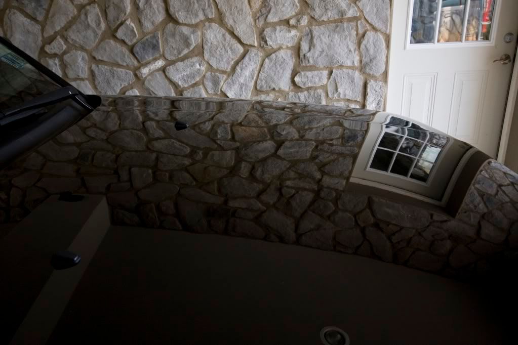

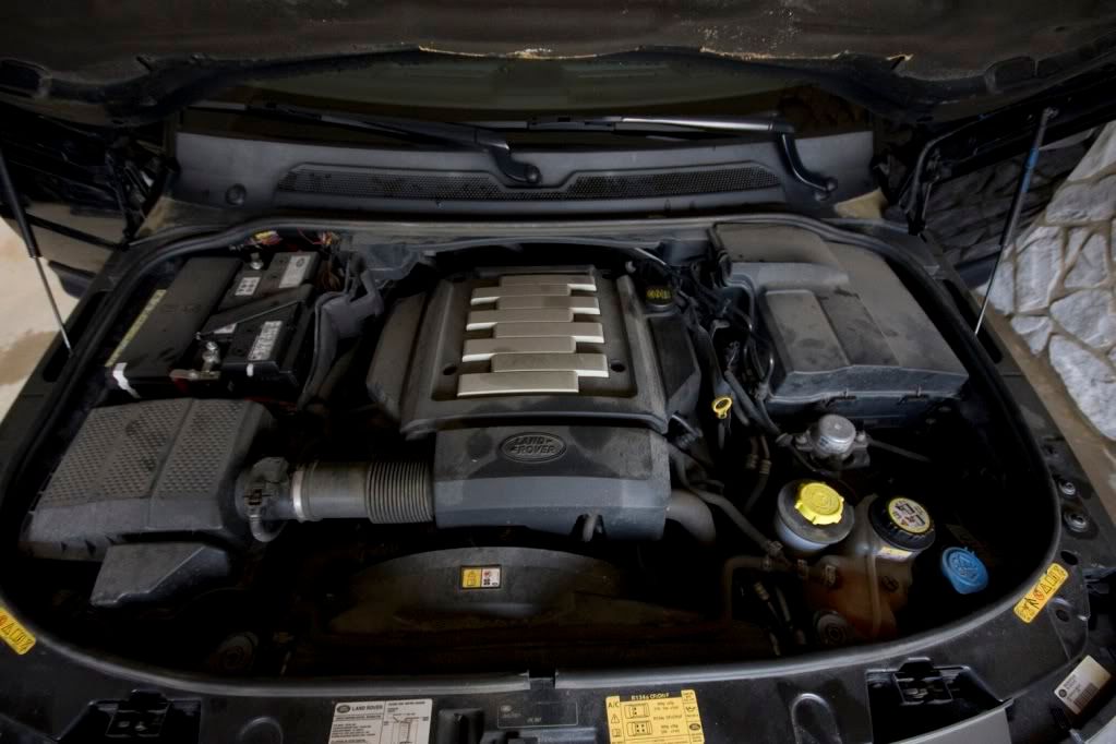

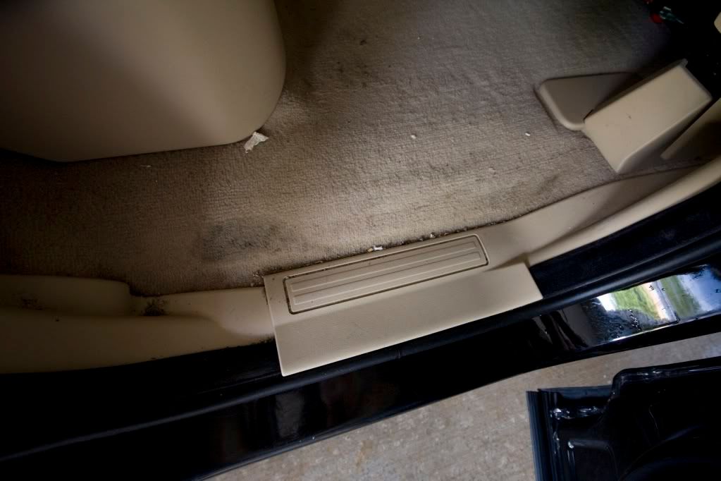

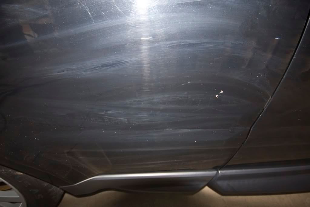

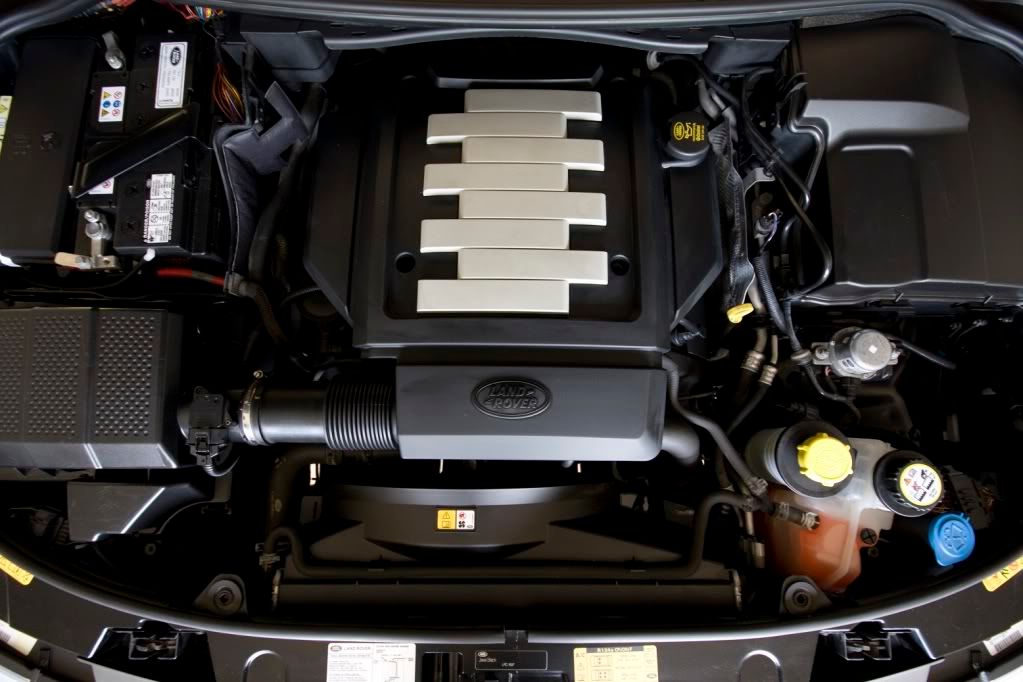

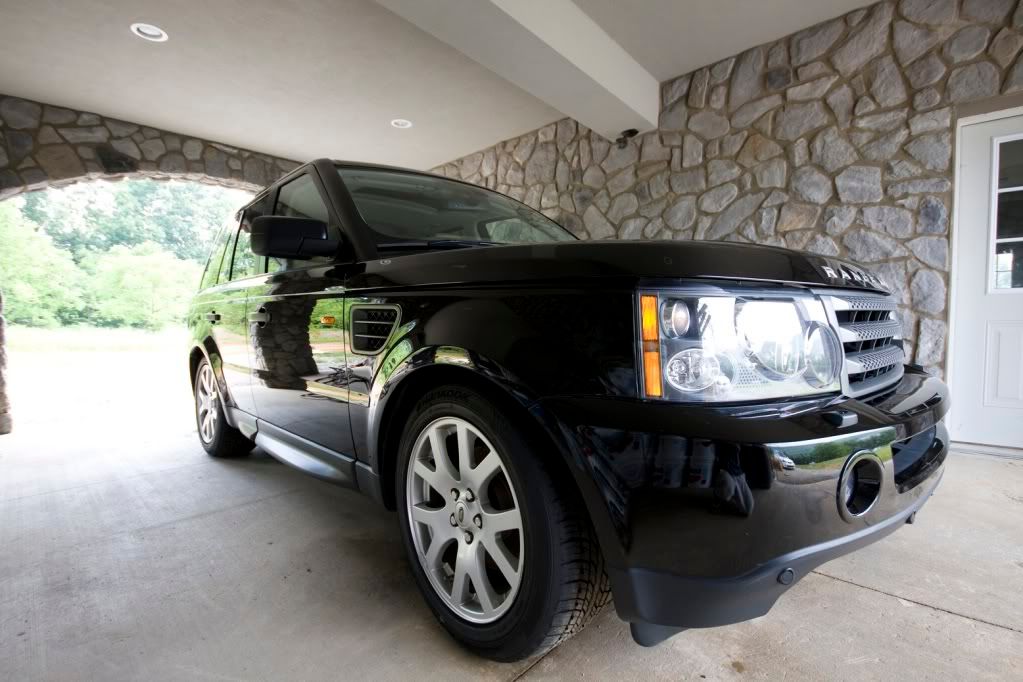

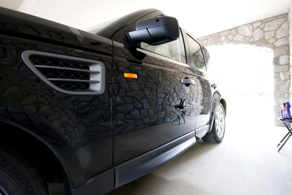

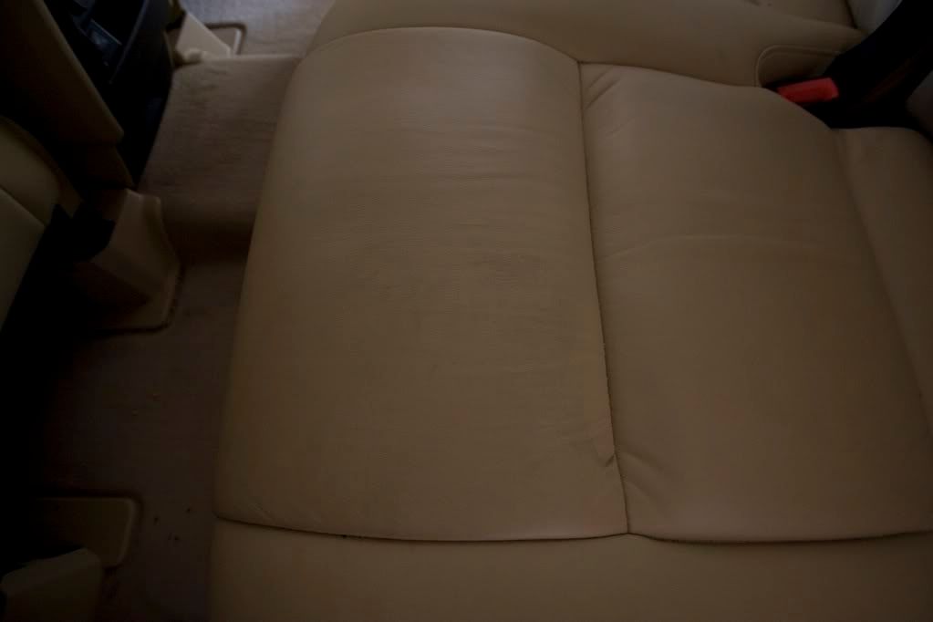

    2007 Range Rover Sport with 46k miles on it.
    Client wanted 1 step paint correction and full interior clean-up
    Process took around 9 hours.

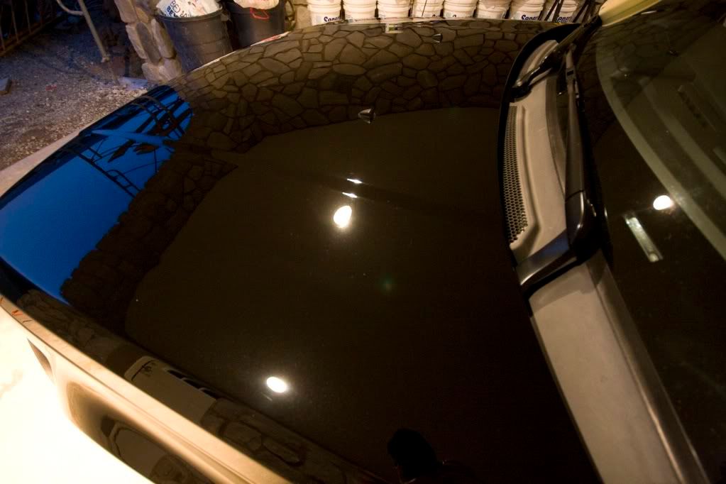

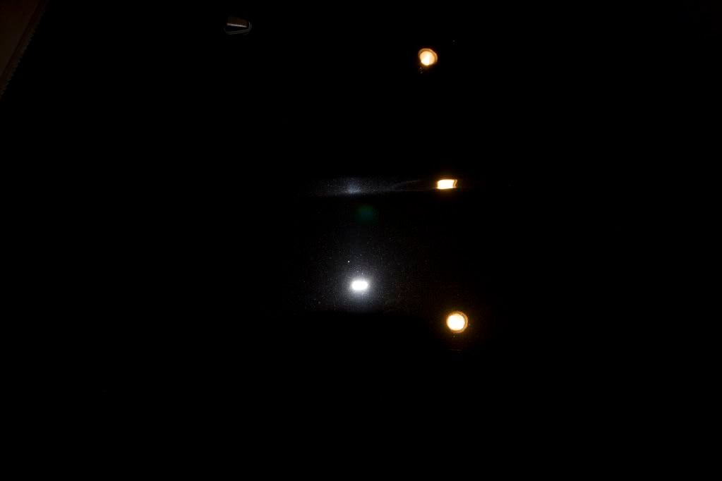

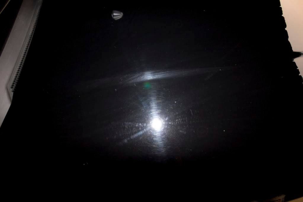

    Process:

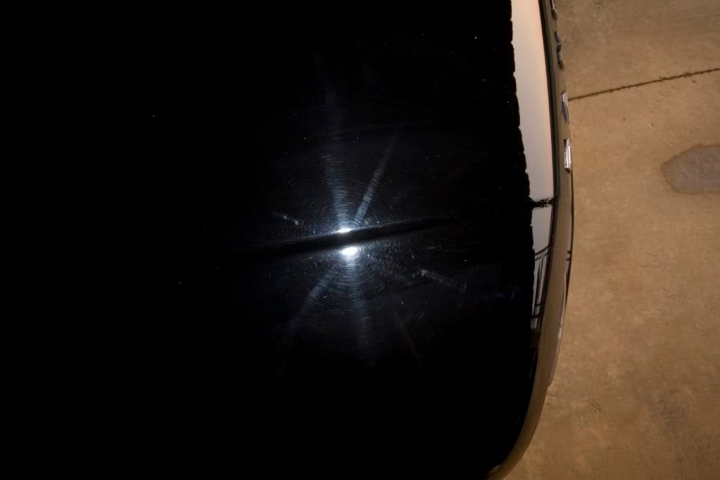

    UC on yellow pad (whole car with DA x2)
    NXT 2.0 wax on black pad (DA)

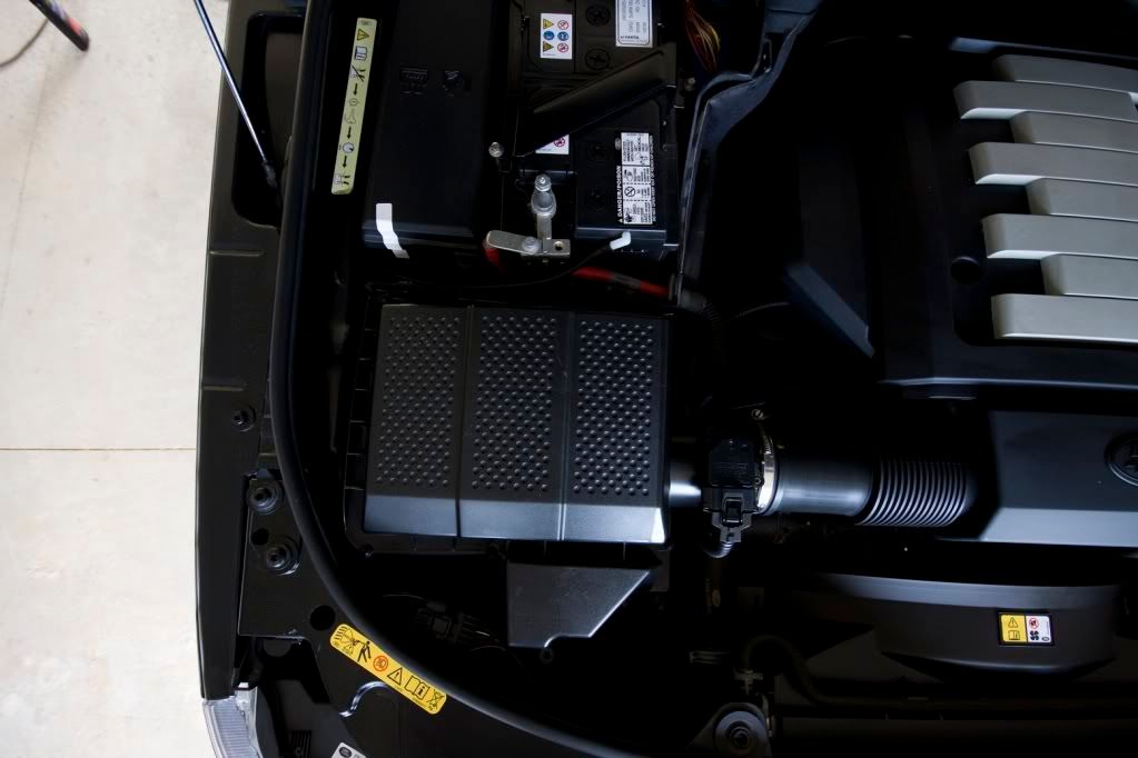

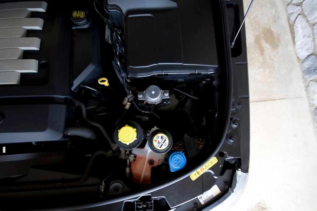

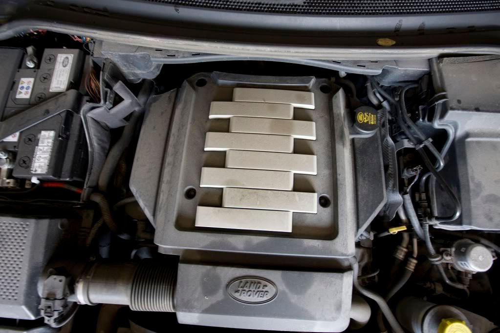

    HD 4:1 on engine
    Interior detailer on dashboard

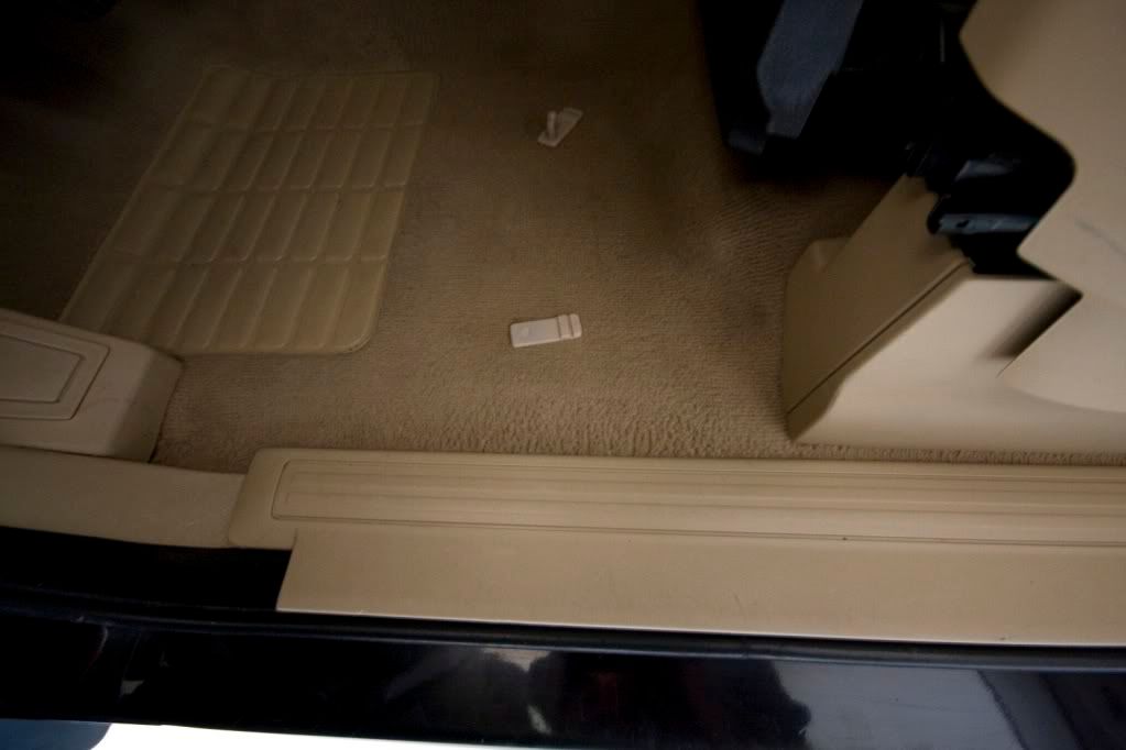

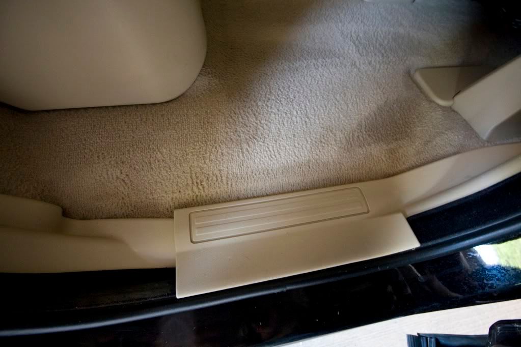

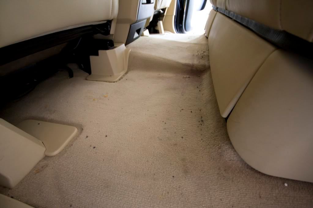

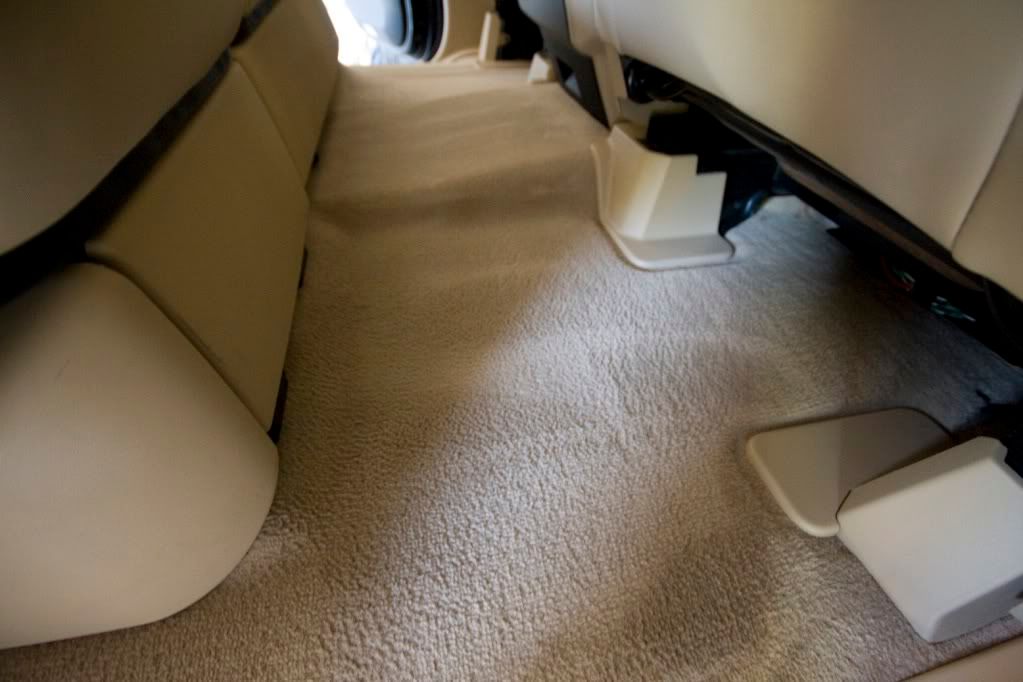

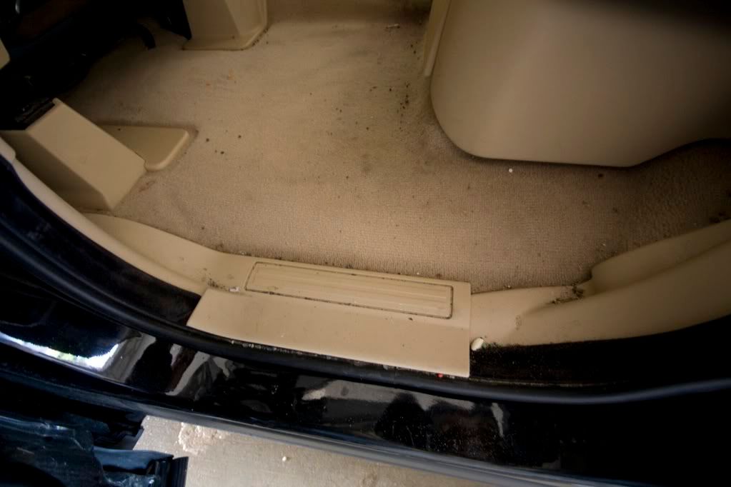

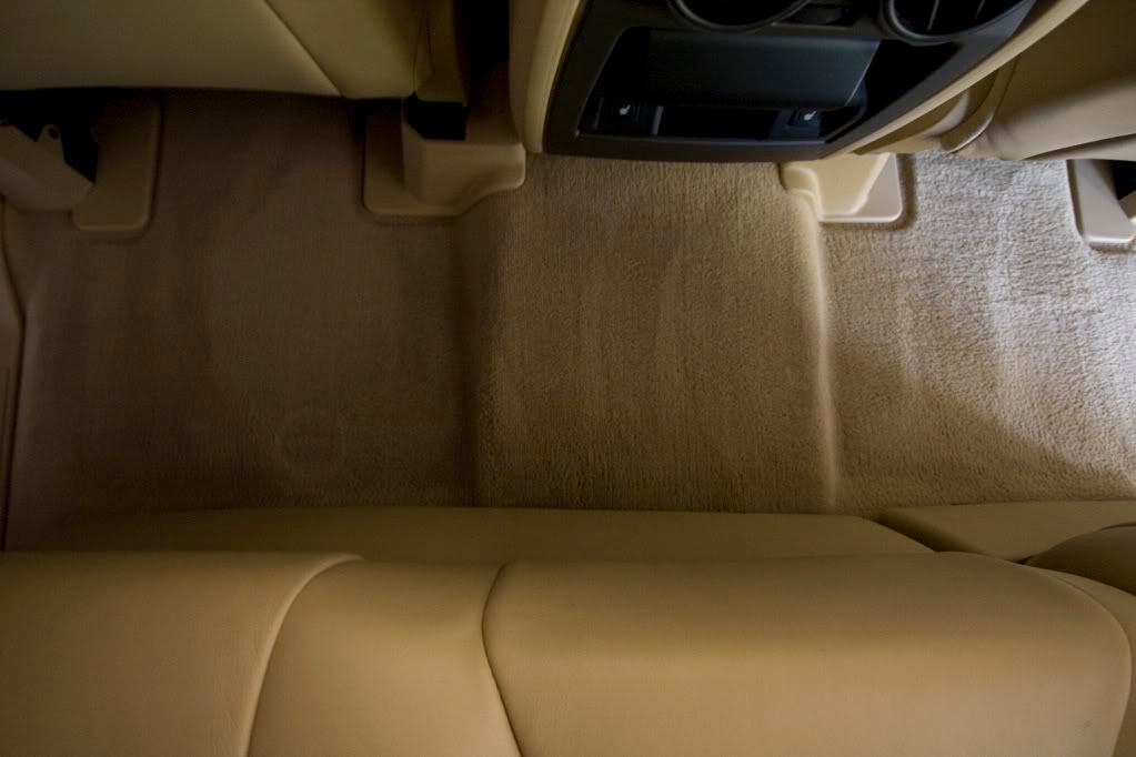

    APC+ on carpet and seats then vacuumed
    NXT Glass cleaner on windows
    Washed it and then took some pictures.

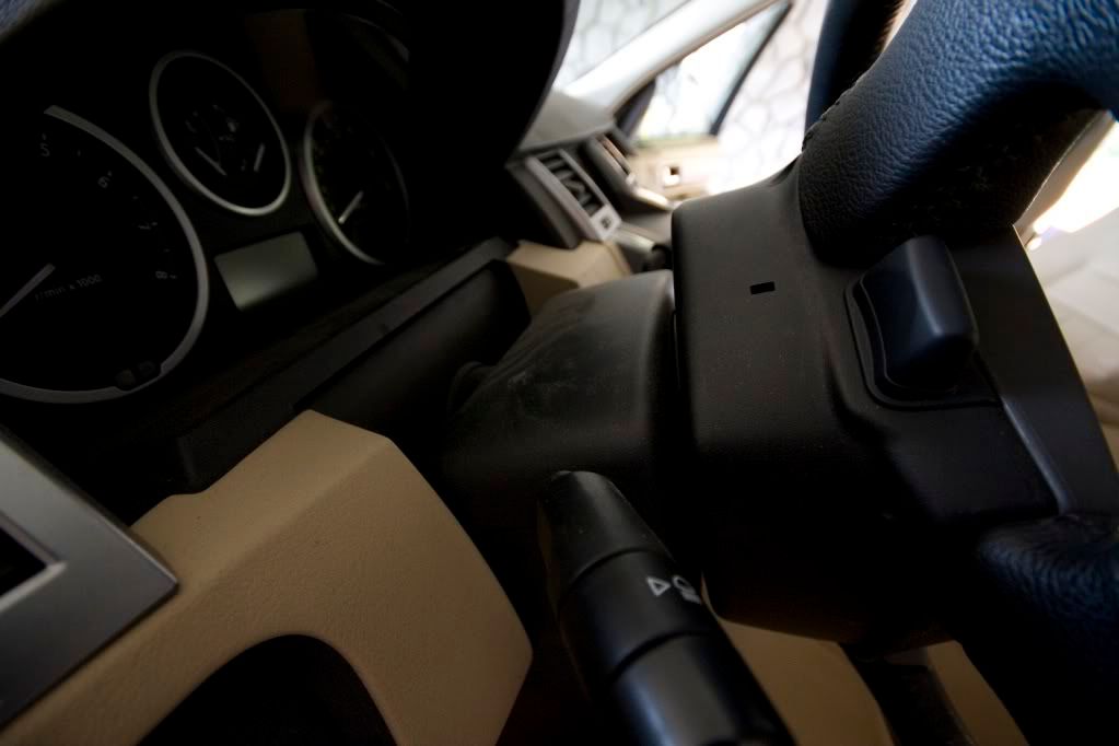

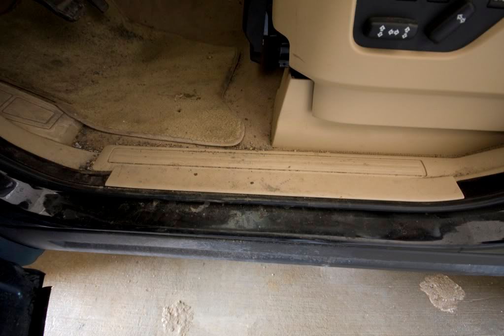

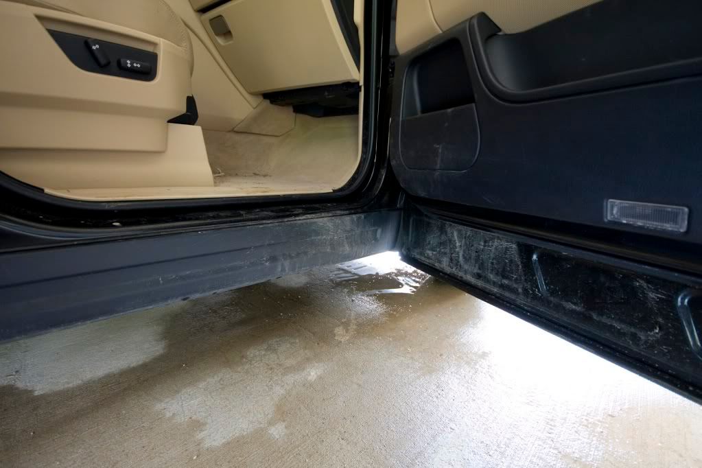

    BEFORE
    DURING

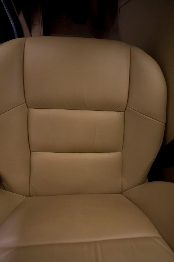

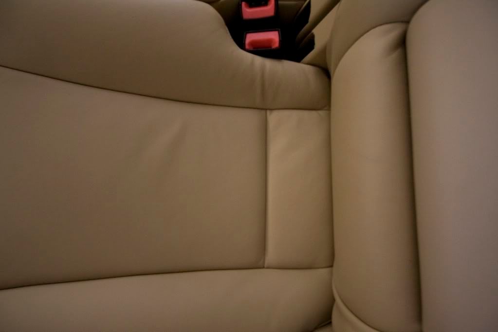

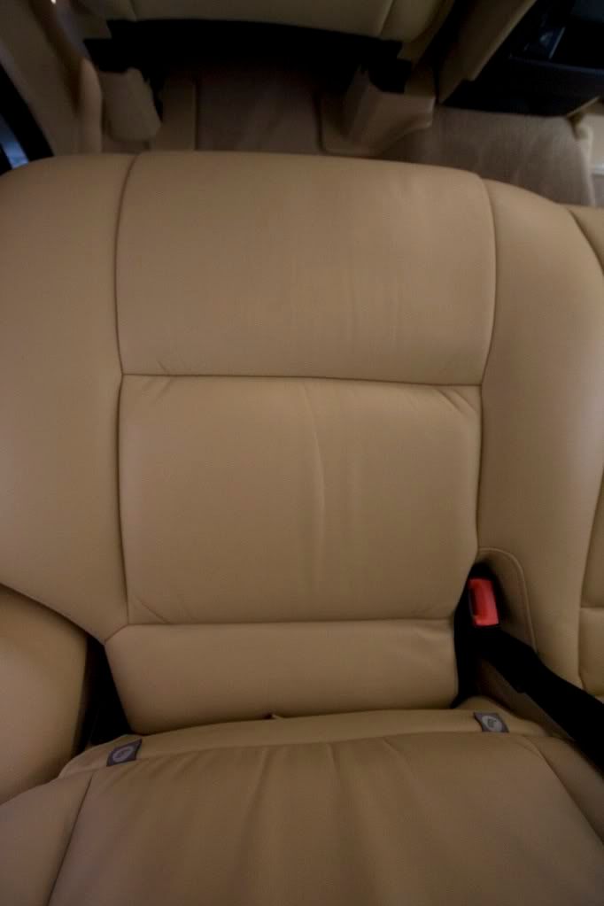

    INTERIOR

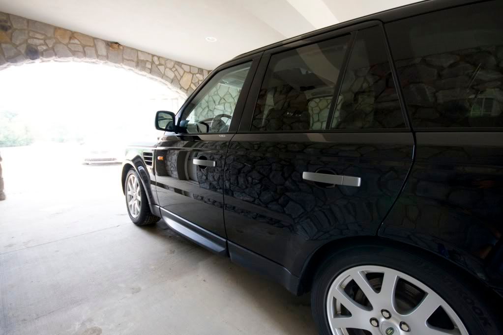

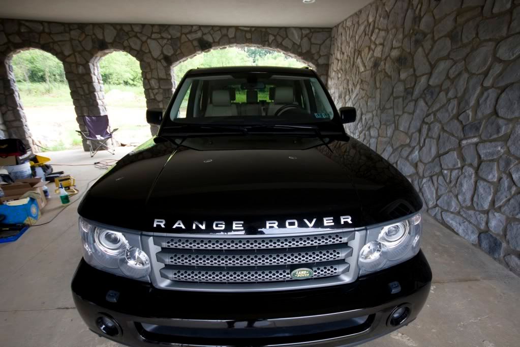

    AFTERS

      Great detail, the paint came out much more ''wet''. I love how you've dressed the engine too! I'll have to order myself some HD.

          Just wondering, can we use DA using LC Yellow pad+UC? I mean not making any holograms and that stuff?

              Thank you and yes HD dresses engine really nice.

              I don't think it will leave hazing or marring because that's what it says on UC lol and works very well with DA and yellow pad though I don't know if LC yellow pad is more aggressive then Meguiars.
              Also DA doesn't leave holograms, only left from rotary buffer if not used properly.

                    Amazing turnaround. I can't believe the condition of the inside....such an expensive vehicle.
                      Same here, but now its all good

                        Oh I thought you're using LC yellow pad. Because it's a cutting pad(equal with Meg's red pad/cutting pad).
                        Ok then. Use Meg's yellow pad next time.

                          When people state Yellow pad that means they are using Meguiars since its a Meguiars forum...
                          Otherwise they state LC yellow pad.

                            Great work. The rover looks wet. Awesome reflections.
                            Also, it Looks like a great place to work .
