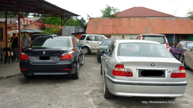

    Guess what we got…a E60…530 …thanks to our generous Bro A, so we onr washed the ride & everyone put their hand

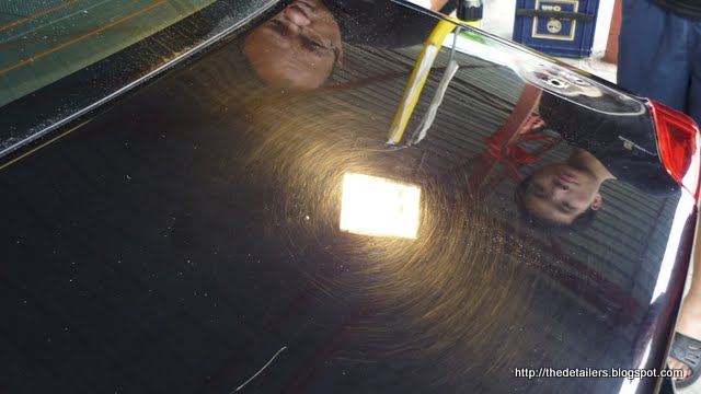

    now Master seech…explaining a rear scratches the owner concern & wanted us to remove…
    our brave Master wet sanded the car & show step by step…correction & till finally restores....sanding mark removed by Megs M105 & solo burgundy wool h & W8007 pad with # 205

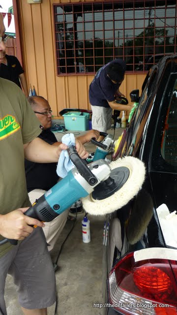

    indeed after that ,, every body got so fire up for rotary
    rotary rotary

    Paint correction with LC Wool & Megs M 105
    Step down to LC CCS polishing with Megs M 105
    Finishing off with Megs M 205 with Finishing pad
