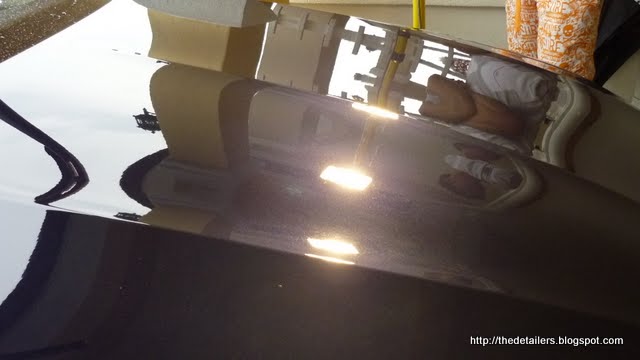

it is on a far left hood of the e60... BTW ....brand new ya..
the issue here is ...there was ann etch on bird dropping ...
i thik the detailing shop guys....do es not have the right tool & training ...ignorantly replied...even god cannot help
camera can hardly take any good shots...2 cents here..silver is fantastic to hide imperfection & consoling yrself by taking off you specs while finding yr paint imperfection...
but seriously i know its so hard to live with that...pay to get wack...kinda feeling
so as the results they might have tried correcting it but....either the cloths or pad...is dirty & contaminated...gave some scratches on the paint
50/50 % shots....bran new makita...wool pad..then ...cutting pad LC with M105 & finishing off withe M 205 & optimum wax
total time required 7.5 minutes

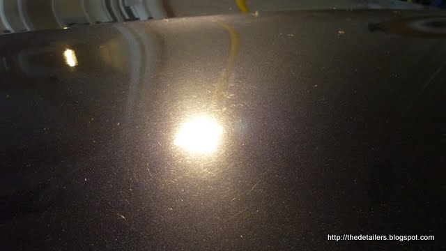

2ndl was bro R,,,E 92...just a few months old car...severly swriled & scratches by some vandlizer
close up...fasten yr seat belts
3 issue here
swirls from washing....RIDS...in the wrong hand & cloths ...Vandalized
