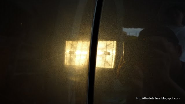

    this is a 16 years E class master piece....
    i wonder how can one just live to scratched & drive the car at the same time
    this is the most most most
    most horrific paint damaged i ever seen in my life...more compact than any Compact disc
    as water cover 70 % of the earth more swrils scratched & RIDs covered this ride

    its unbelieving right..look at the hood
    the hexagon effect is the latest hype in decoration paint....better than mat or vinyl CF??
    the hexagon effect was created / damaged by the carpet which the owner left on ther bonnet to dry at hot sunny day
    "believe it or not - ripley's"...the new owner was told that this is the original paint....Hmmmmmmm...maybe the blind cant see...but they can feel with their finger tips
    "believe it or not - ripley's"...the seller actually claim this is original paint???
    u dont need to see just feel it with your finger tips ...as the tape mark ..prior painting...

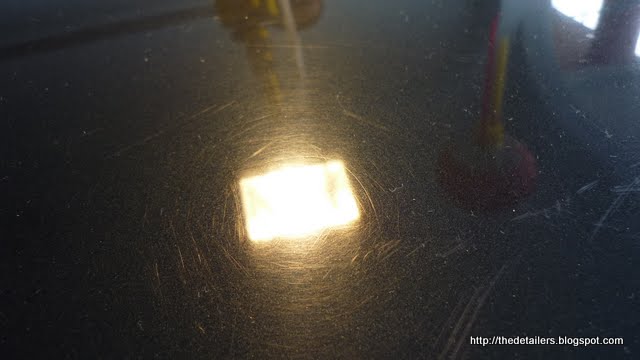

    more scratches
    dogs scratches
    human scratches
    more & more scratches ...if ever that there is an award for most scratch ..this will certainly win..i double nominate her
    more & more

    Correction work......
    whole car - Optimum Compound & wool x 2pases & more follow with LC CCS cutting pad x 1 passes
    back hood even more with Finishing 2 3/4 inch Backing plate & 3" polishing & finishing pad with Optimum compound & polish & finishing polish
    for front hood - Megs M 105 with multiple wool passes & cutting PAD with LC ccs & Megs 205 LC polishing pad - Optimum polishing & lc ccs polishing & Optimum finishing polish with glazing pads
    Optimum polish with CCS LC polishing pad
    Finishing - optimum finishing with LC CCS, RED & Blue pad - glazing pads (stepping in a finer finishing)
    Optisealed - optimum opti seal (whole car - including all rubber , vinyl & windows)
    Wax - Optimum car wax
    Meguairs UQD on all windows
    pls HUNT & look out for the numbers of pads i use of

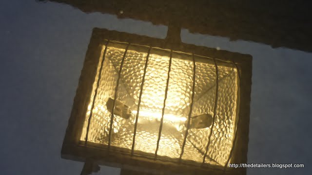

    look at the pads & the right combinations of products & pads make the corrections prefect
    day light pic of the hood after correction...like about 8 passes altogether???
