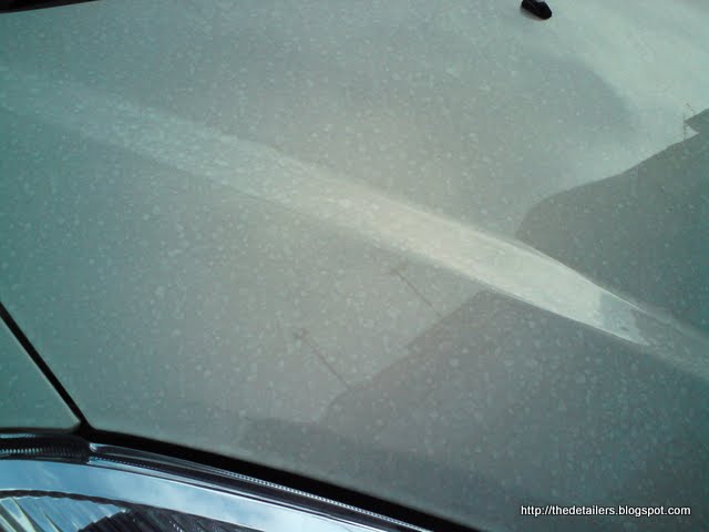

    It is very Normal to see such a paint condition if the car is not wash for weeks...the amount of acid contaminates the paint
    after ONR wash
    clay begin & contminants picked up
    my intervention plan
    Quick wipe down with ONR rinseless wash & 2 micro fibers to dry
    Optimun no rinse was as Lube with mild clay
    Paint polishing
    Rotary with Lake country white colour polishing foam for with Meguiars M 80 polish ....speed 600 to spread, 1400 with gradual movement & speed , finishing off at 900 with moderate movement
    just prior before i can wax the rain came,,,:-(
    total time spent : 4 hours ....exclude waxing
